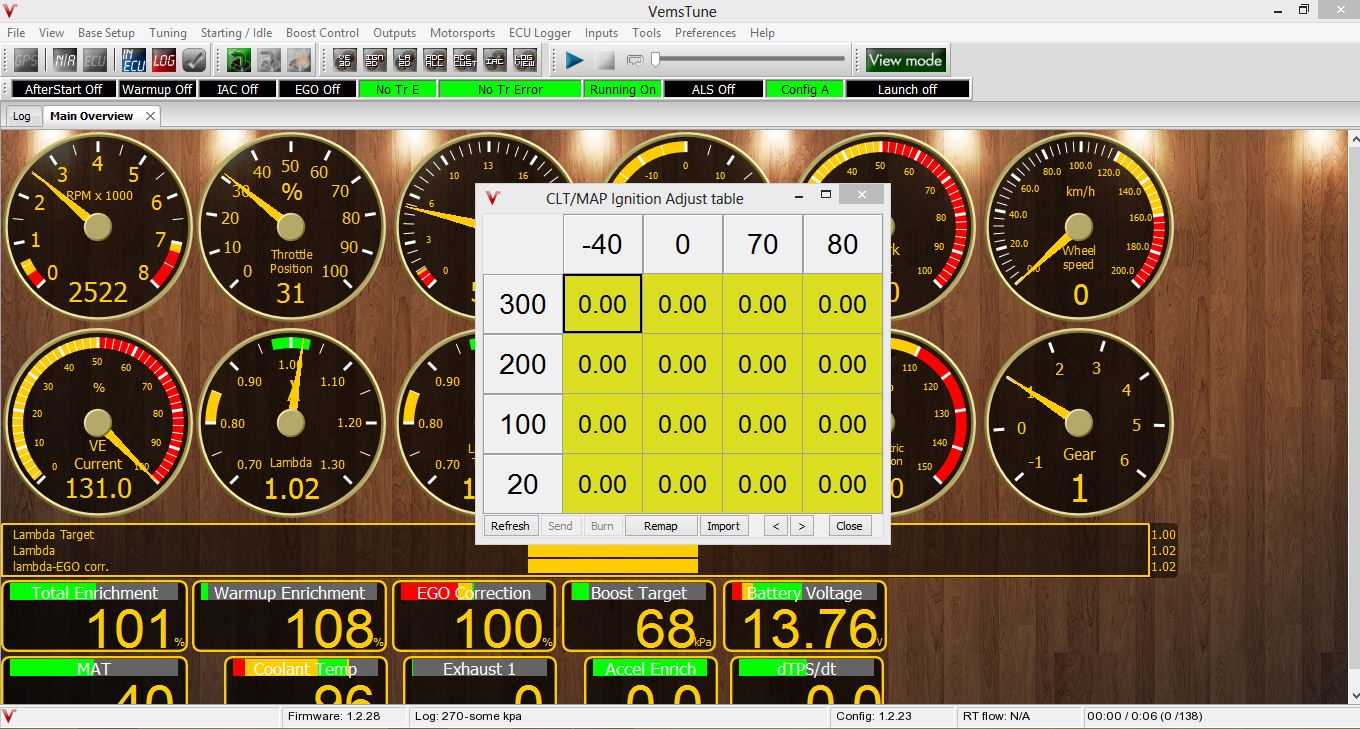

Any time, happy to help! I just looked at your CLT table and it is all zeros, so that probably isn't the reason you're seeing power loss.

CLT vs ign.JPG (230.3 KiB) Viewed 30099 times
Also, good that you have a 1.8t IAT sensor. Do you know if it's calibrated properly?

Oh boy. All I did was start using the new OEM 1.8T table values as per Marc

88a5tq wrote:Oh boy. All I did was start using the new OEM 1.8T table values as per Marc
Do any temperature reading limit boost? I hit 268 kpa in one log.
OK, you should be good then if you got them from Marc.
Not that I'm aware of. Your MAT vs. Ign retard table is pretty aggressive though. Send a log when it's happening and we'll see what it's doing if anything.
