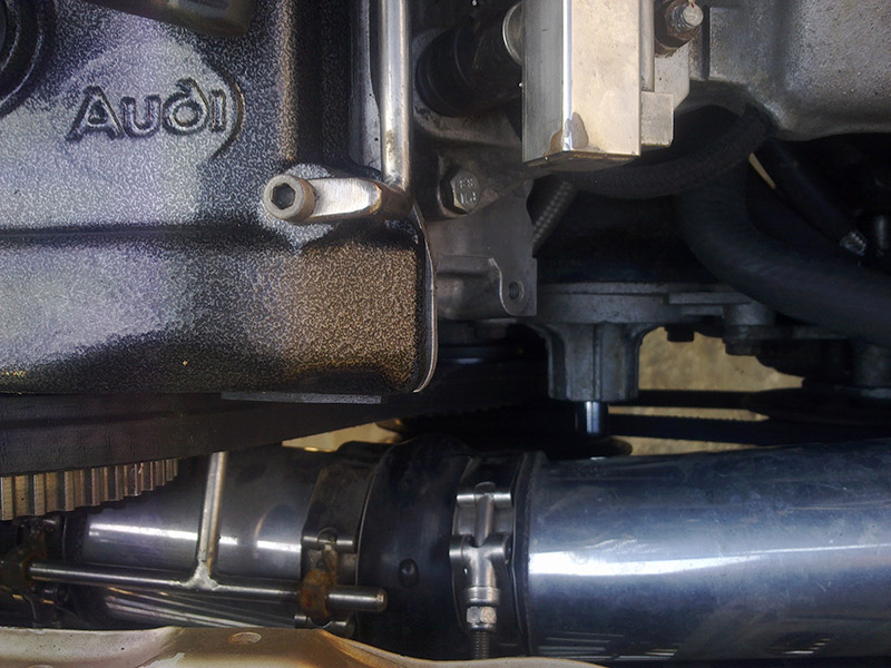

Anyways i was greeted with this yesterday:
:bangshead:
Probs some bent valves, etc. Happened on a almost new geba water pump, press fit pulley spun off, effin sucks.
Pump turns smooth by hand.

Yea, i sure learned the hard way on that one, funny thing, the audi sign is stamped on the back of the geba pulley. New graf pump on it now, adding a bolt to make sure next time it doesn't spin off.
Looks like all intake valves touched the pistons. The exhaust ones seem ok, well pistons and valves are unmaked and they seem straight so far. If that's the case, not so bad.
