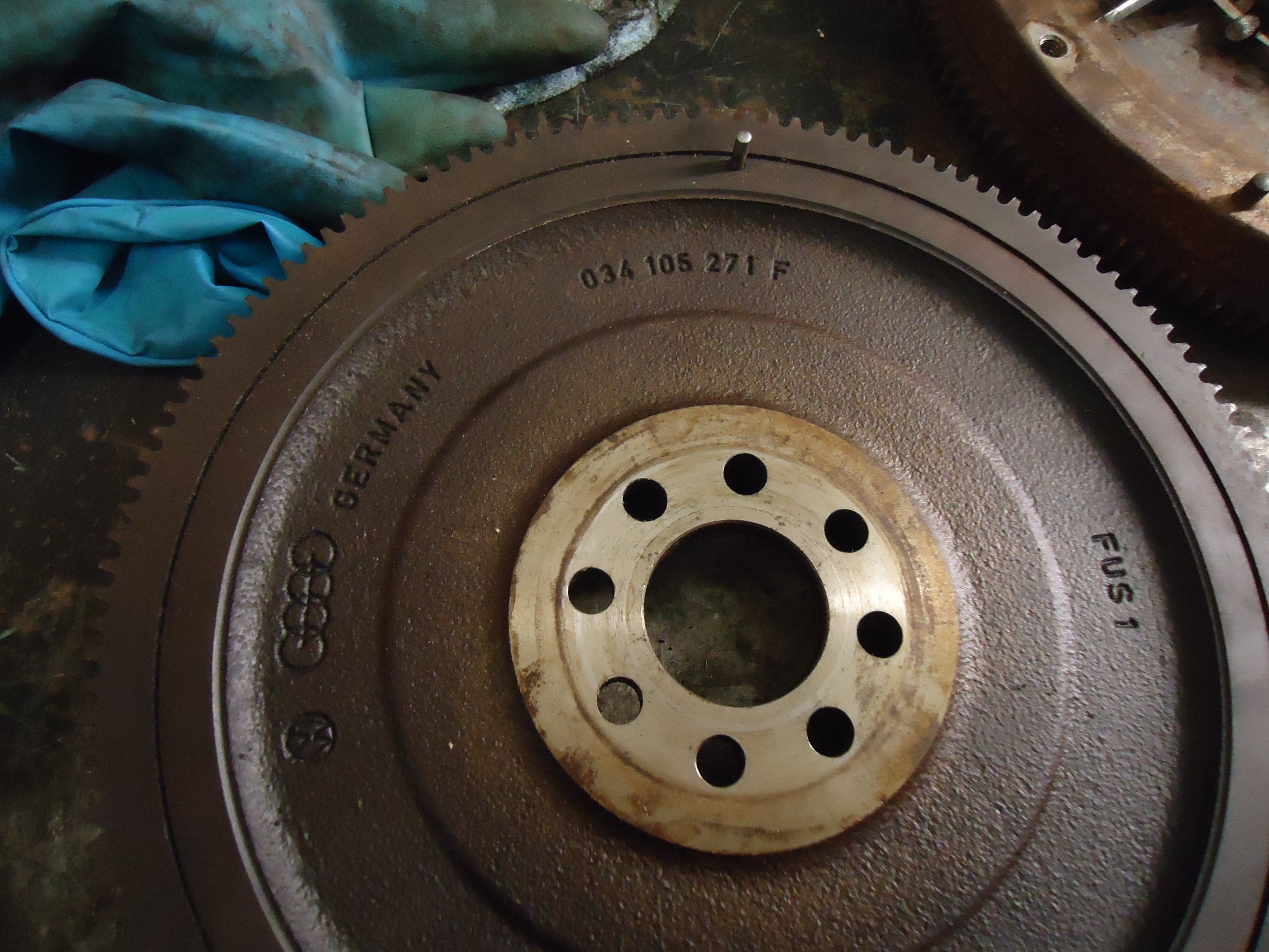

My flywheel weight data:
Stock 7a- 25lbs 6oz

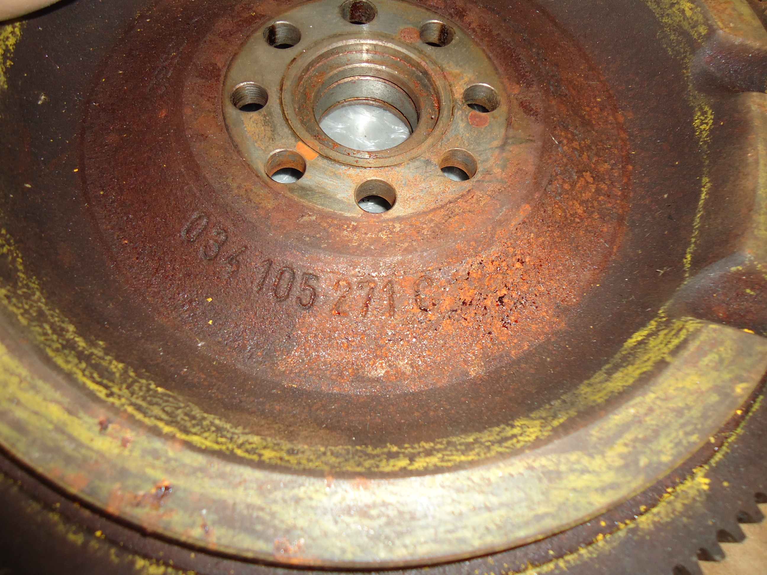

"Lightened" 7a flywheel- just knocked off the weight ring off the engine side. 22lbs 13.2oz. Definitely did not remove enough material.Before picture
Before
Before

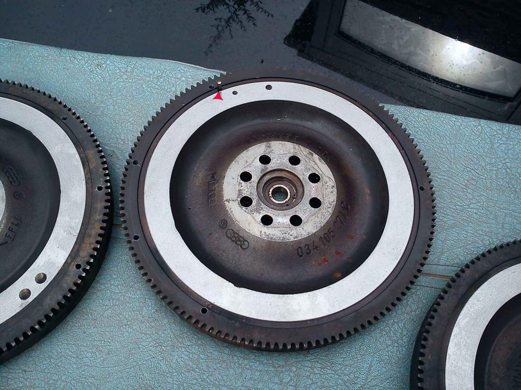

After
After. Note this picture is not mine but shows what I had machine shop remove.

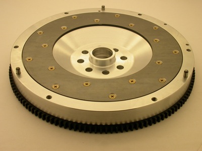

Fidanza- 10lbs 9.2 oz

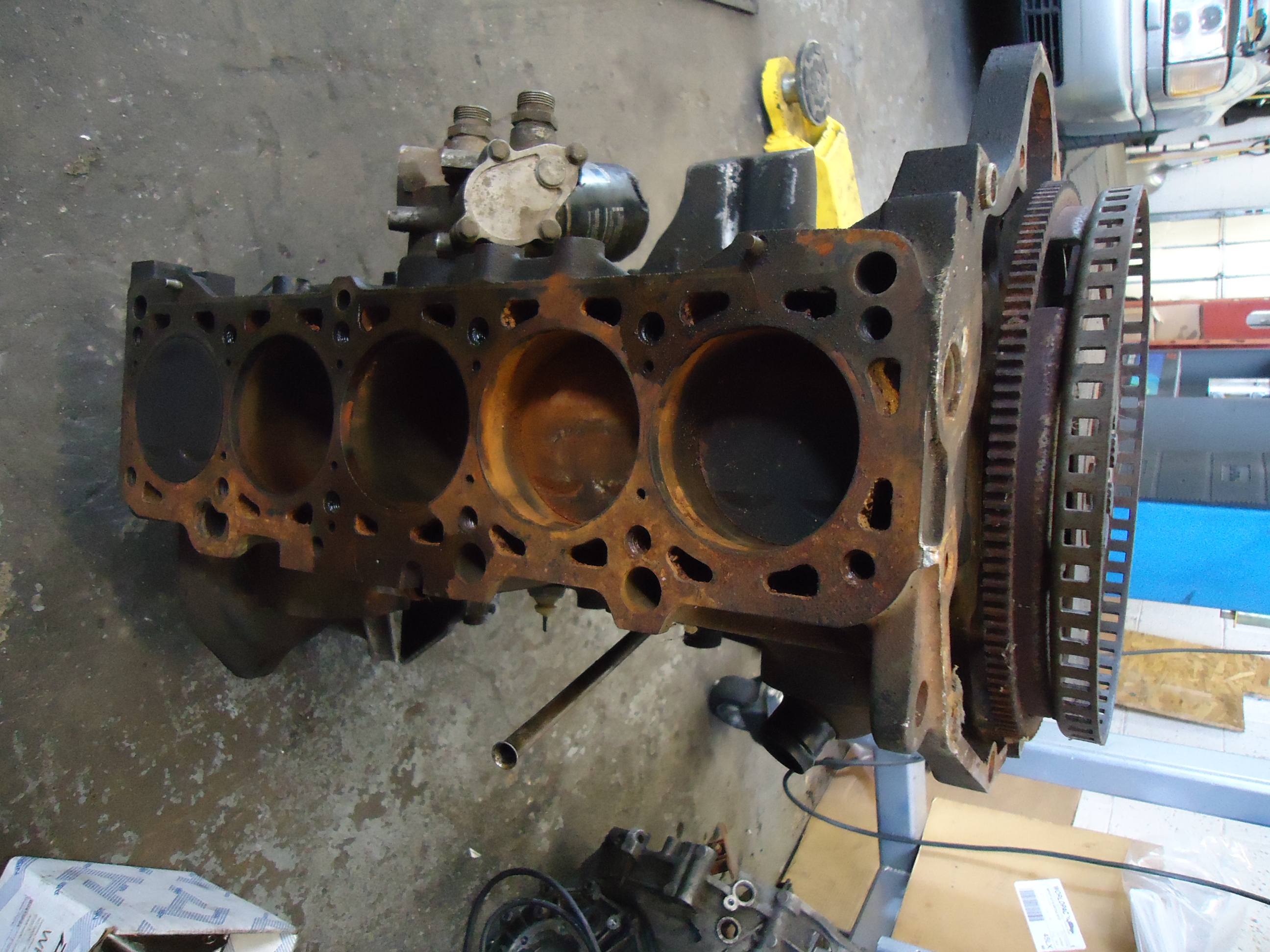

Next is a little something left over from snatching the 3.0 liter crankshaft out of an AVK motor swap we did.
AVK with automatic flywheel on a 7a engine. 22 windows between the -2 slot & the TDC timing pin on a standard flywheel. More suitable for a stand alone fuel system. Just add longer flywheel bolts & a small flywheel to attach a Tilton clutch.

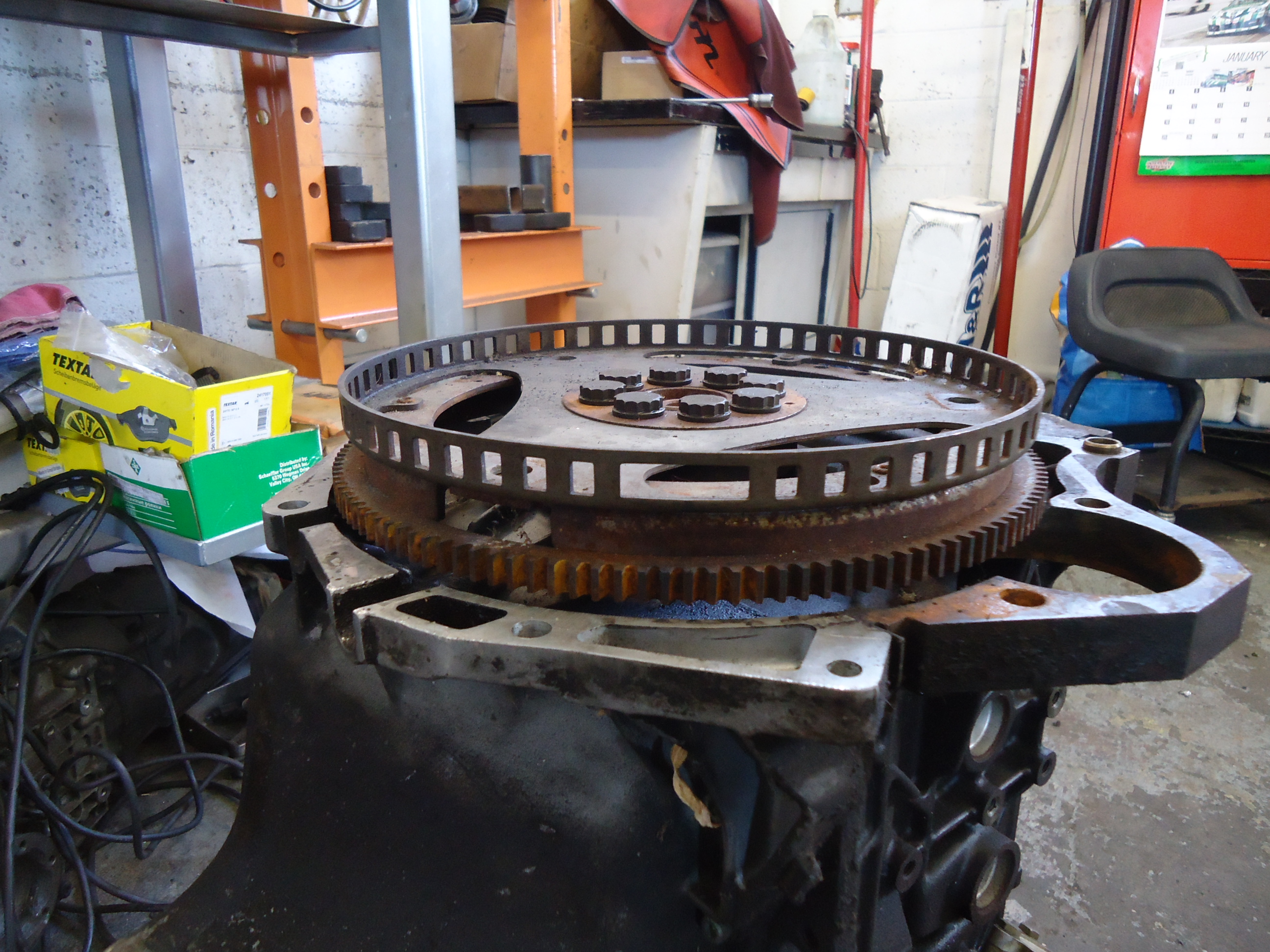

More pictures of the AVK flywheel on a 7a block. This better shows the relationship with #1cylinder @TDC & -2 window on flywheel.

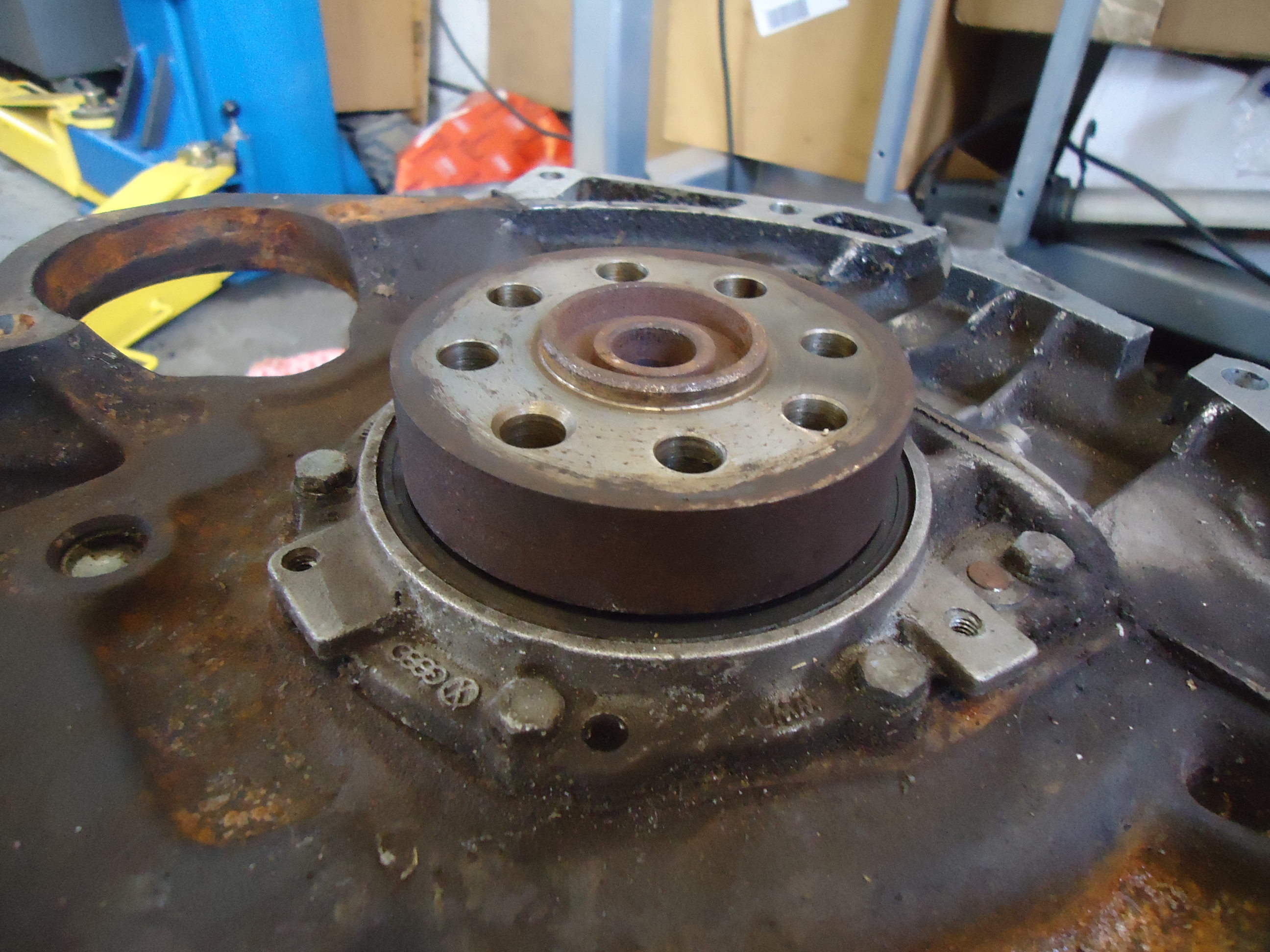

Spacer used on AVK is needed for correct ring gear location on 7a crankshaft.
