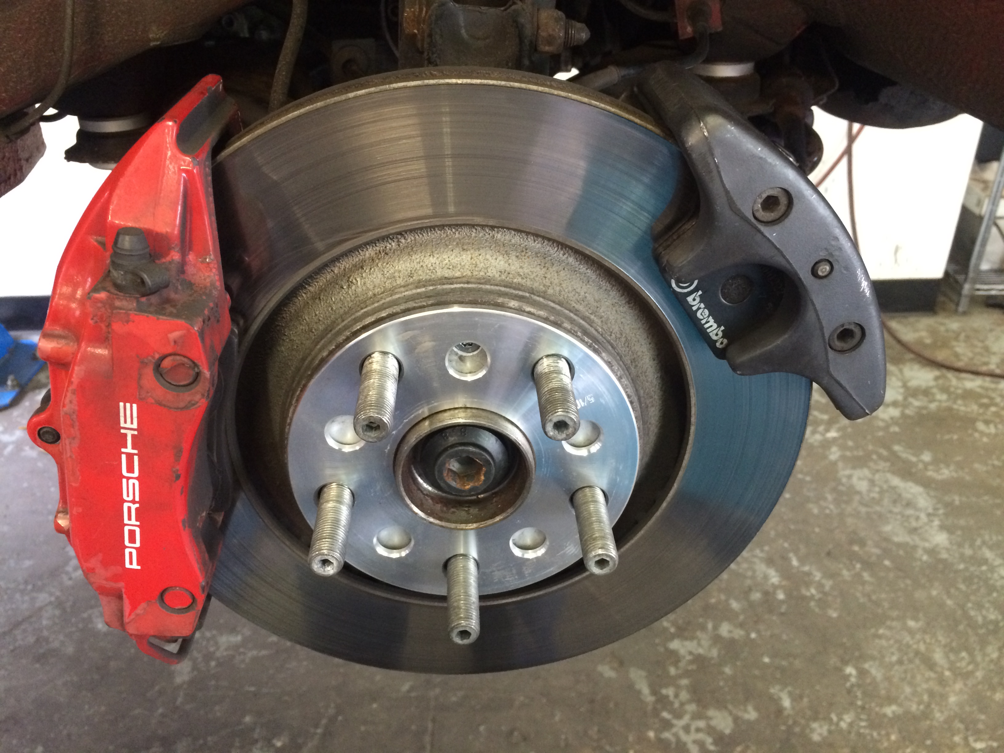

It is nice to have a working handbrake on my Coupe again. Brake upgrades are complete on my eS2 project. At least until I need new rotors ;)

Nice, Chris. I have the same setup I got from John B. I just have not gotten around to doing an install. I may be emailing you down the road for some advice about the e-brake cable install.
Did you take off your hubs to drill and tap the splash shield bolts to hold the adapter? Is that the B6 S4 rotor, 300X22?

A1QSHIP wrote:I will follow up with a handbrake cable modification & e-brake install. I followed John B's write up on the S2 forum & have a better idea on how best to accomplish the cable mods. When I was doing the 5 lug swap & Boxster S brake upgrade I had already decided then to drill & tap the hub carriers in the event that I could source the handbrake parts. I purposely had an extra set of front & rear hub carriers to work with so everything was remove & reinstall with ready to go components. In hindsight, I would have spot faced the holes that the bracket sets upon. At least then I would not have needed to fiddle with the bracket spacing as much.
Hubs will have to be removed to drill & tap the bracket mounting holes. Yes that is the old tried & true 300X22mm rotor. I used Apikol brackets to mount the Porsche calipers.

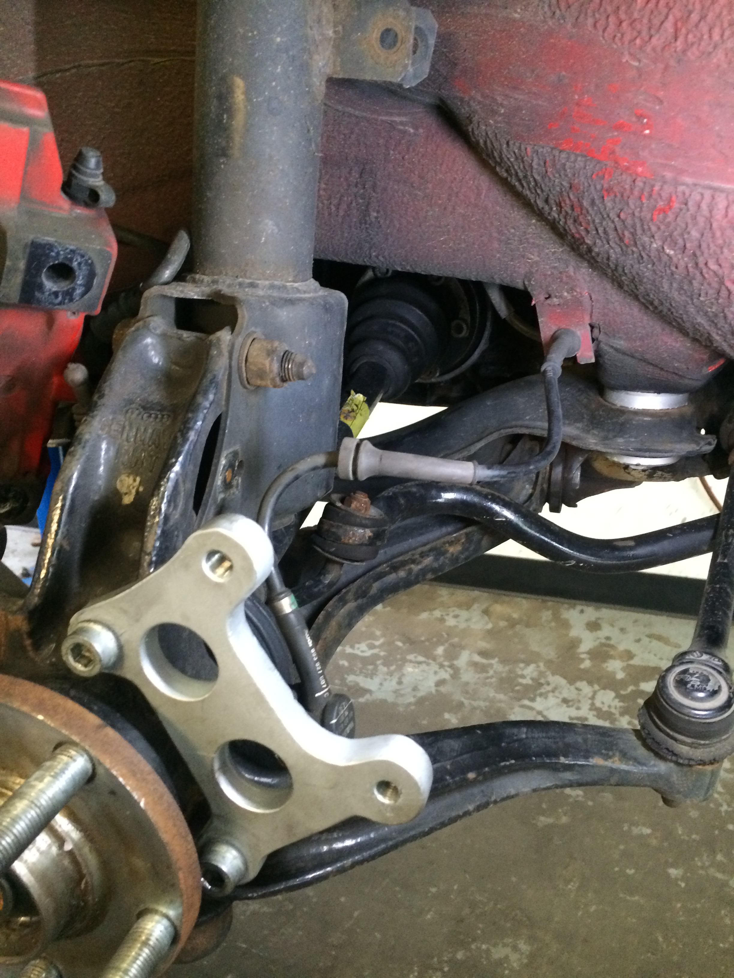

Secondly, I do not want to make another set of these brackets. It took me way too much time with the tools I had to work with.
I have S2 hubs front & rear installed when I did the 5-bolt hub swap. The A4 hubs commonly used on the rear "should" work without any issue.
Found the Viper handbrake calipers from a salvage yard listing on e-bay & sourced new e-brake cables thru Amazon that came from Shokan. Acceptable pricing for the Viper calipers, the cost of the calipers was still as much as I paid for the Boxster S brake calipers. Hardware, calipers, cables, steel plate for the brackets amounted to under $700. The heart wants what the heart wants.

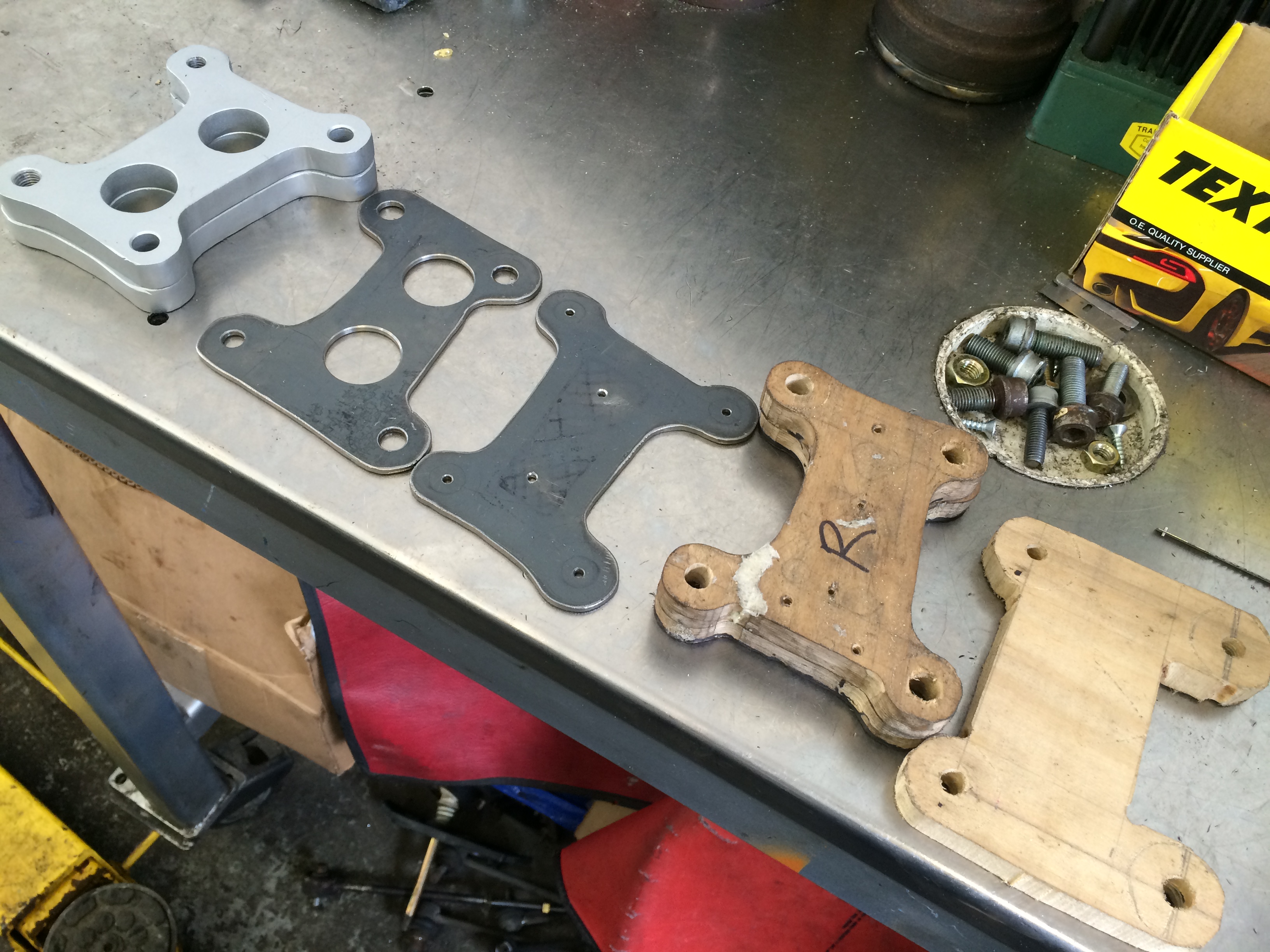

I tried to source the brackets from Bambridge but I ended up making my own.

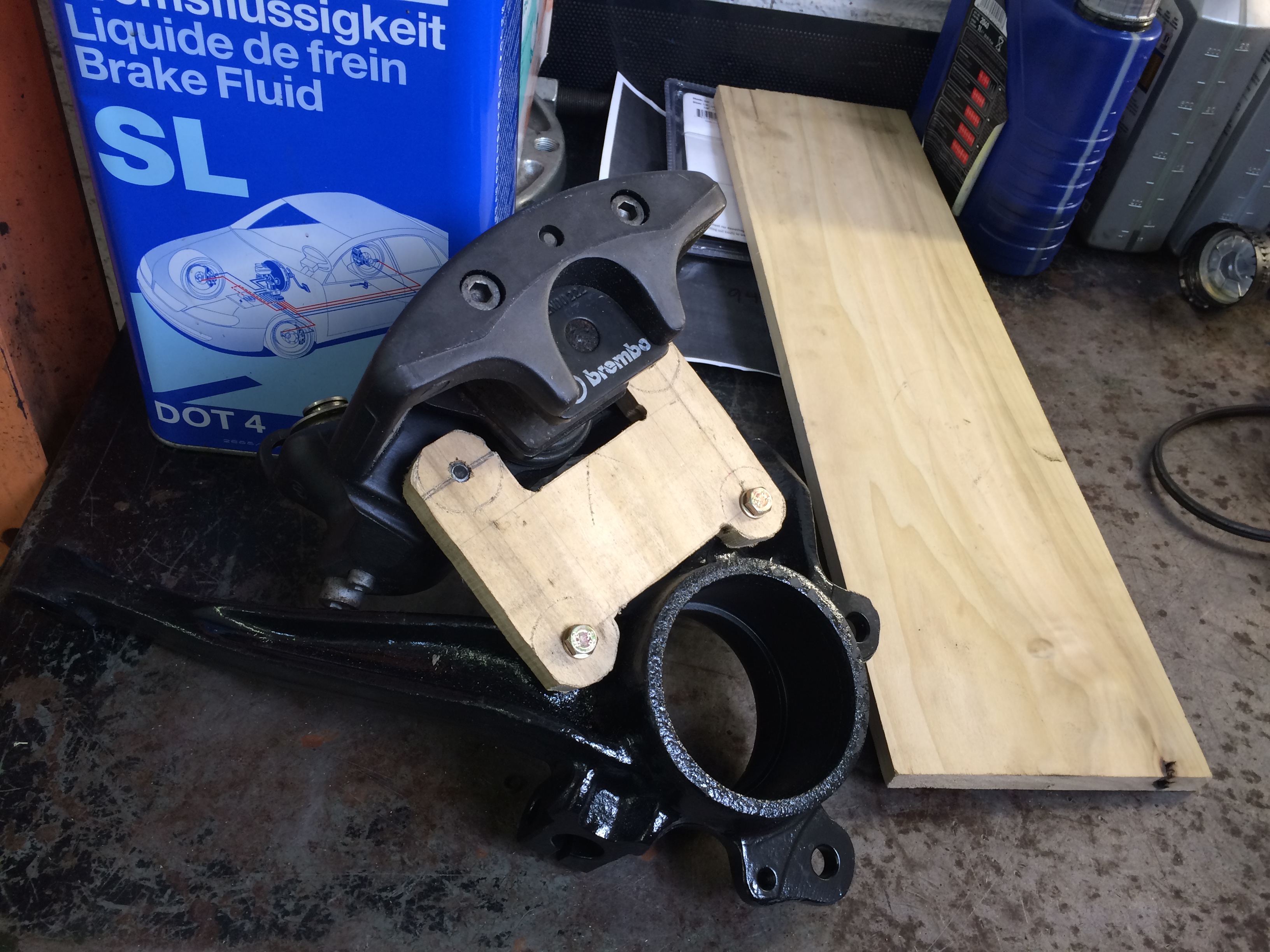

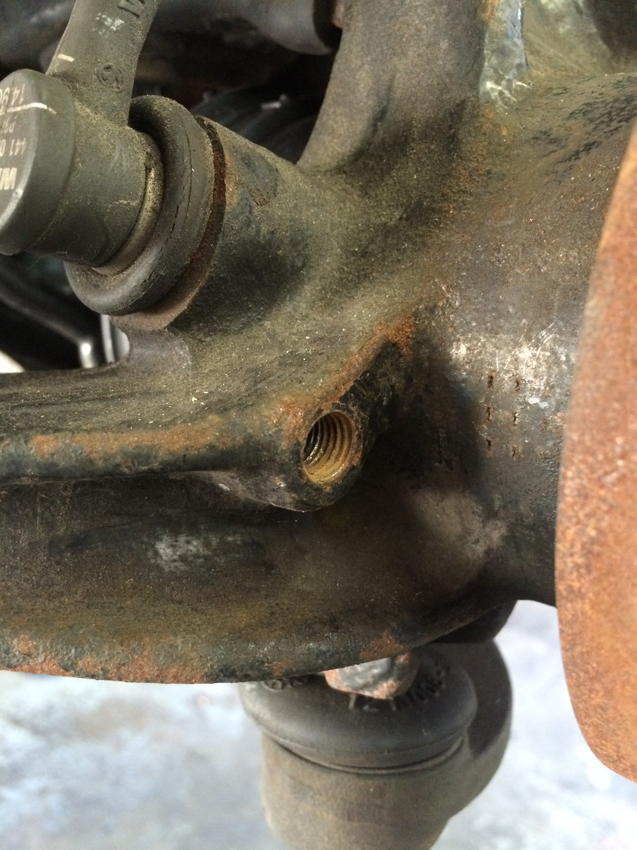

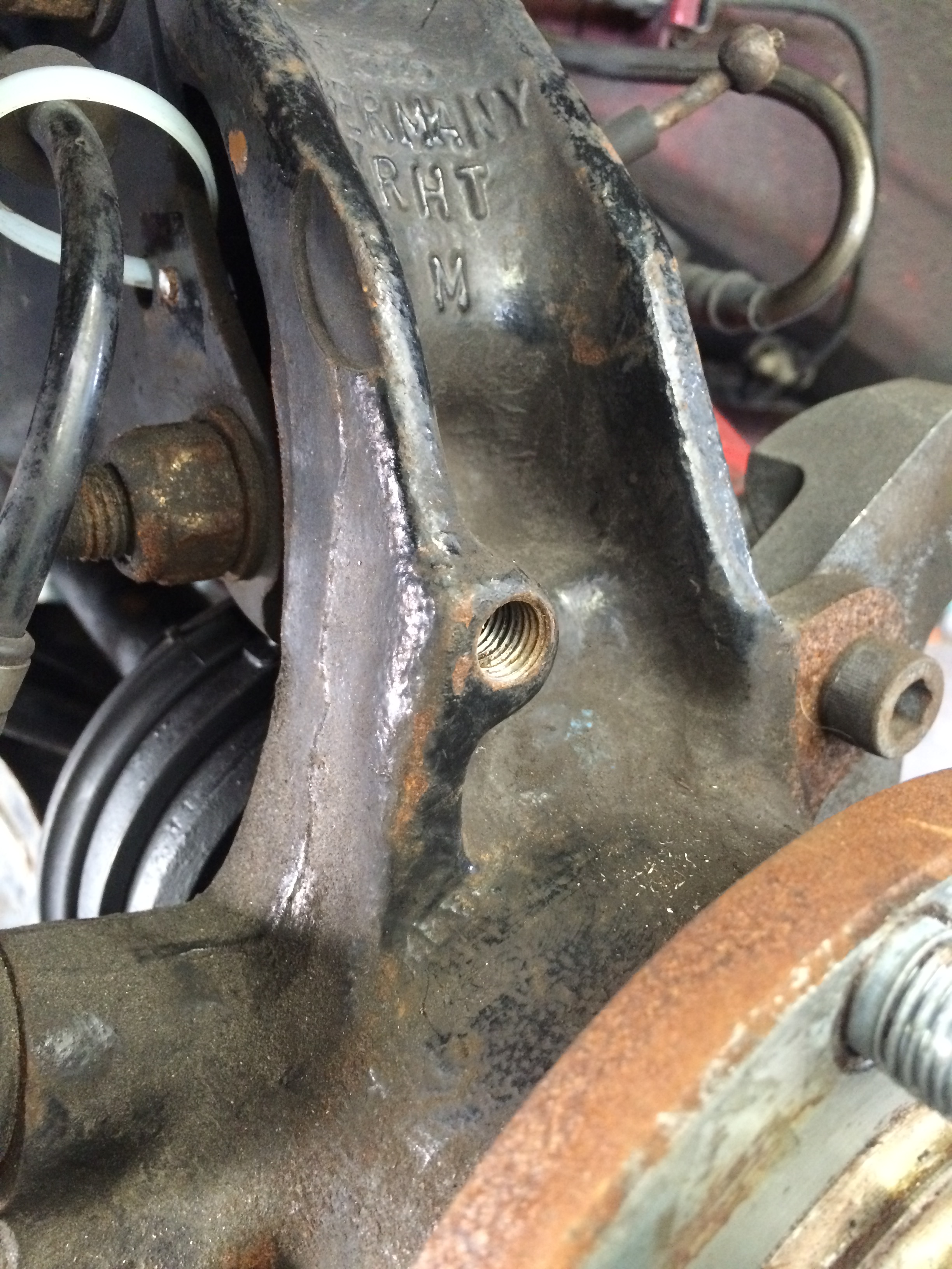

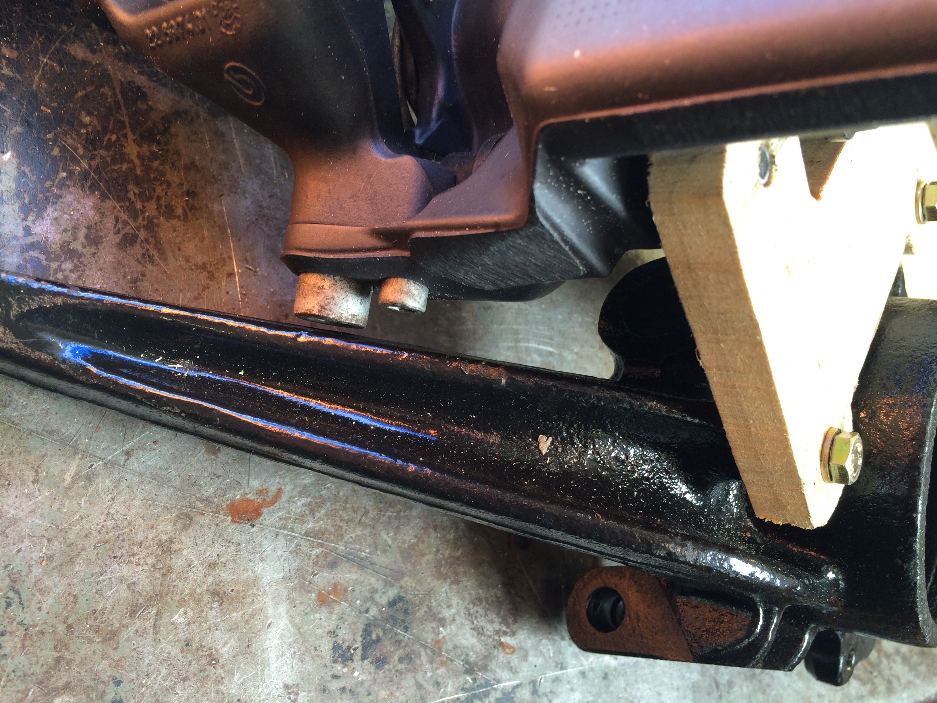

Started with a piece of Poplar wood to make my initial design. Easy to work with & cheap enough to try different designs. Moved to 1/8" steel plate for a pattern & then on to 1/2" plate for the final bracket. Maybe 3/8" would have been enough but I wanted to have at least 6 full threads on the 10X1.25mm bolts that held the calipers to the brackets & the thread depth should be at least the diameter of the fastener.
I torched the rough design out of 1/2" plate steel as I do not have a plasma cutter. I used a Harbor Freight bench top drill press for my "machining" work & an electric grinder for my finishing operations.
My first attempt placed the caliper too close to the hub carrier arm.
My first attempt.
My first attempt.
August 9 107.JPG (2.49 MiB) Viewed 50710 times
Evolution
Evolution
August 9 206.JPG (1.68 MiB) Viewed 50710 times
Mounting hole drilled & tapped
August 9 131.JPG (1.35 MiB) Viewed 50710 times
Lower mounting hole drilled & tapped.
August 9 132.JPG (1.34 MiB) Viewed 50710 times

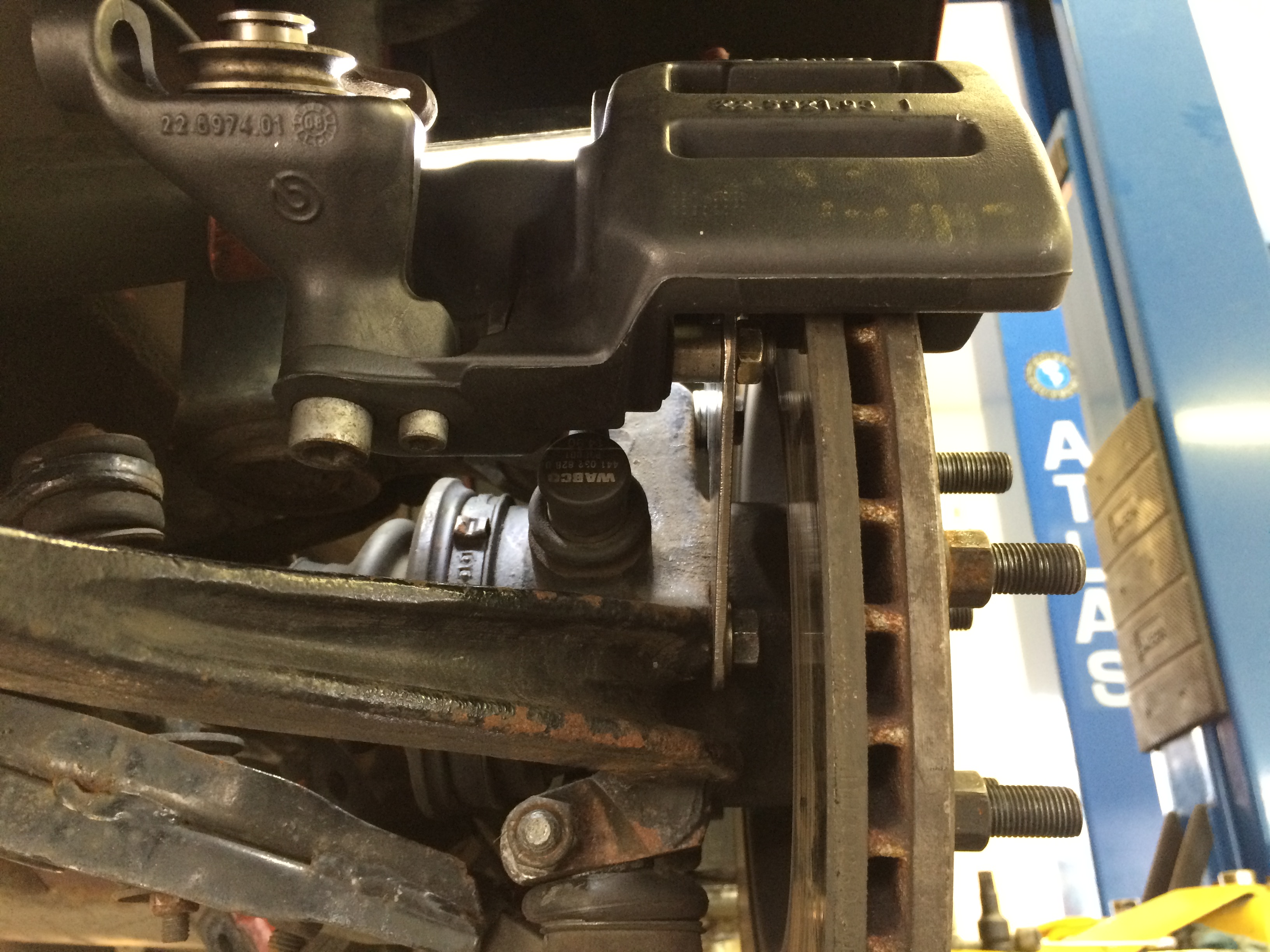

Metal mock up bracket
August 9 144.JPG (1.25 MiB) Viewed 50709 times

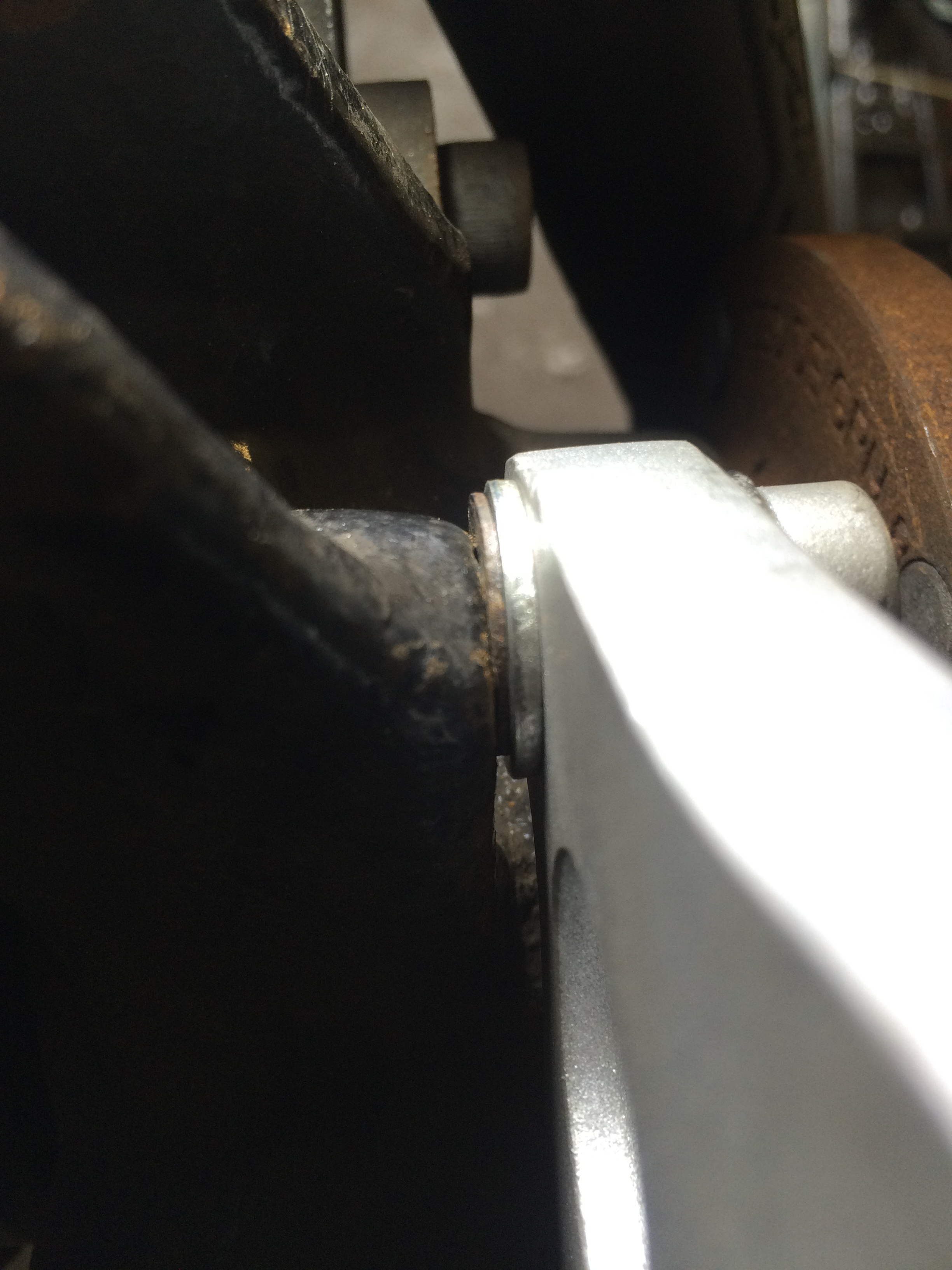

Showing pad contact rotor concentrically  & not overhanging rotor.
August 9 213.JPG (2.13 MiB) Viewed 50709 times
Mounted to hub carrier
August 9 212.JPG (1.29 MiB) Viewed 50709 times
Spacers installed to keep bracket in the same plane as the rotor. Only needed on upper mounting point.
August 9 216.JPG (1.45 MiB) Viewed 50709 times

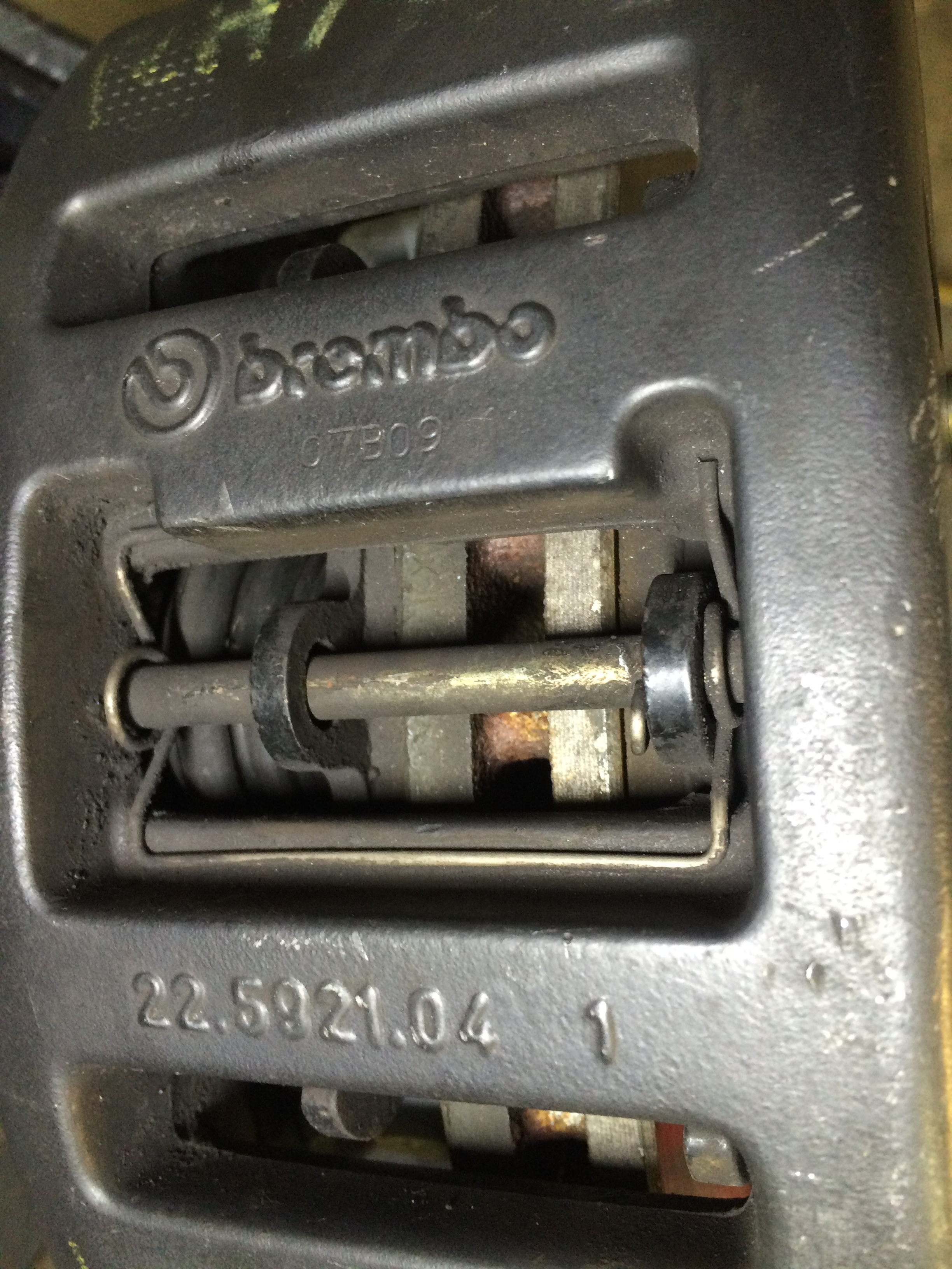

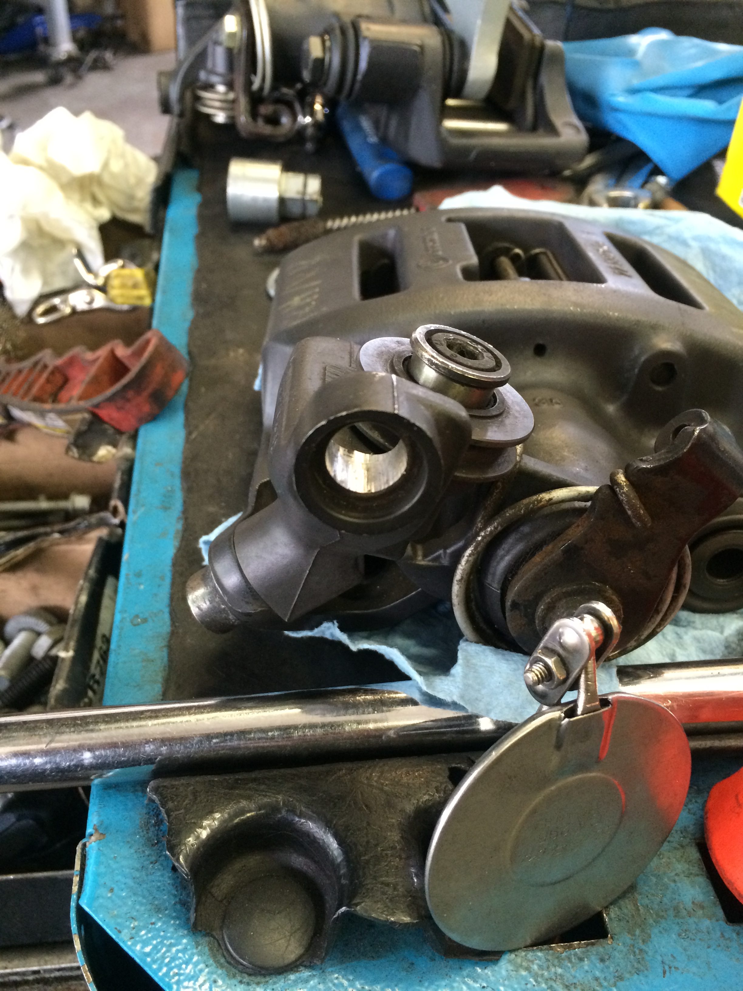

Modified caliper for B4 cable to fit.
August 9 211.JPG (1.83 MiB) Viewed 50709 times

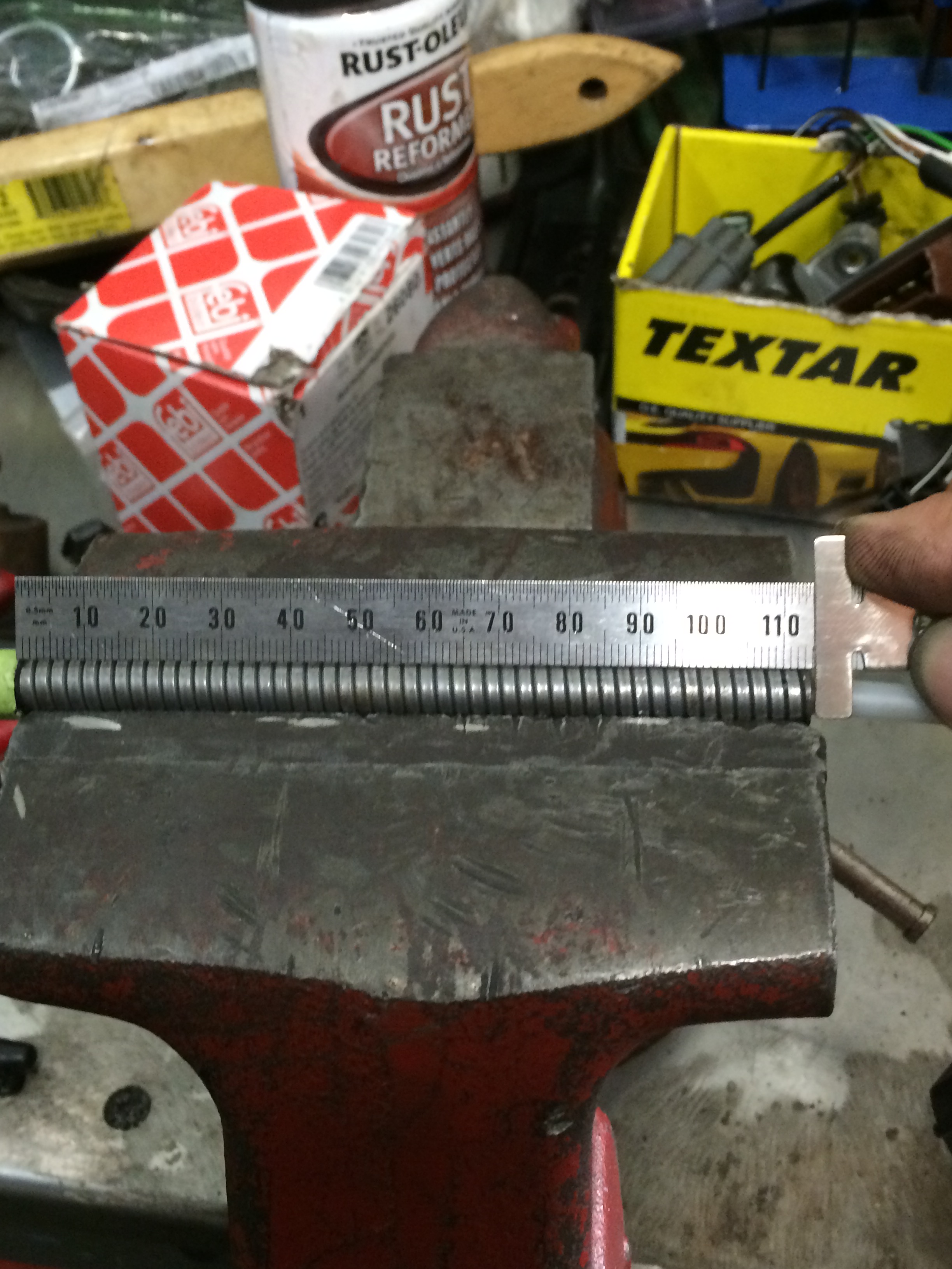

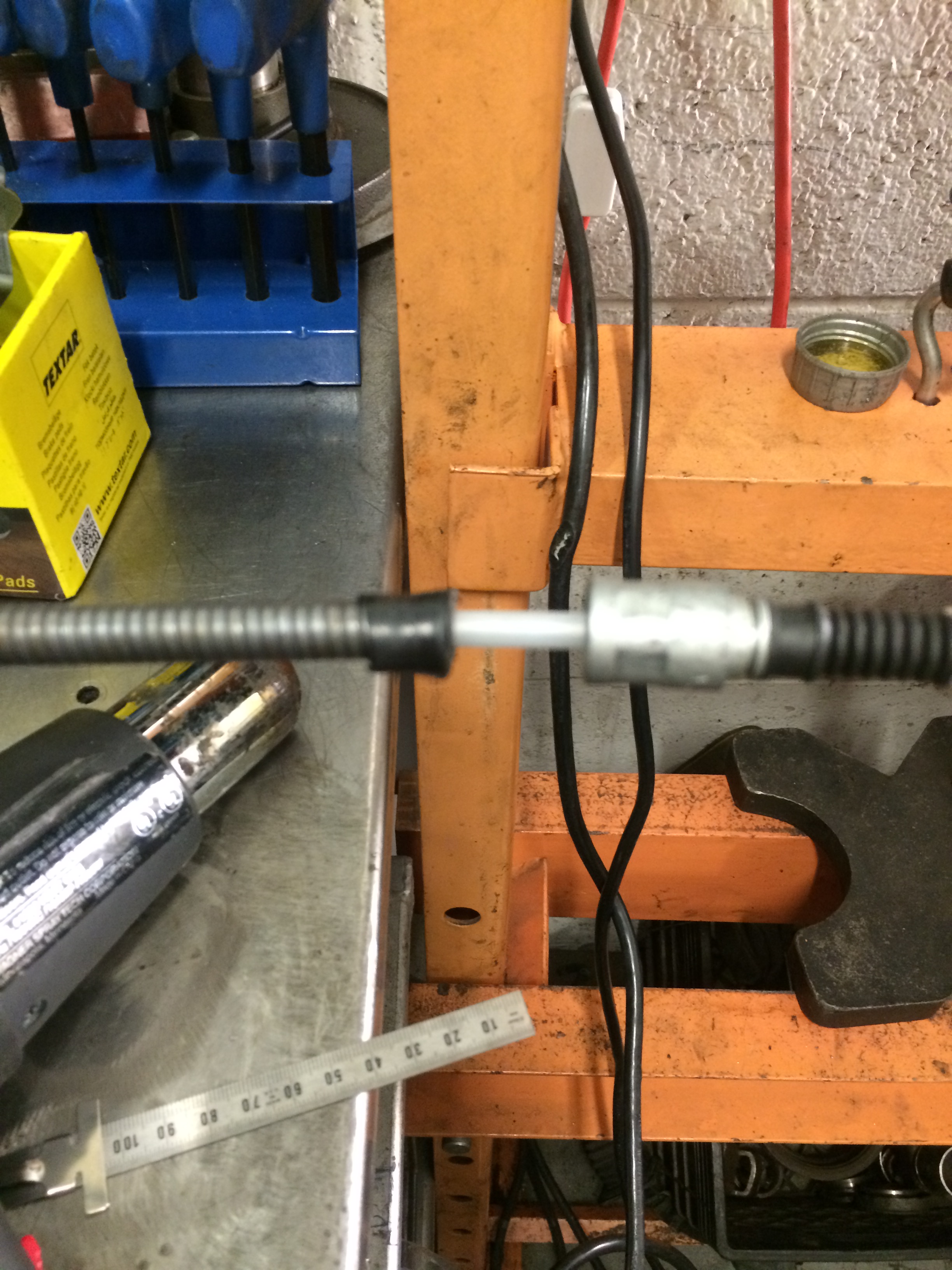

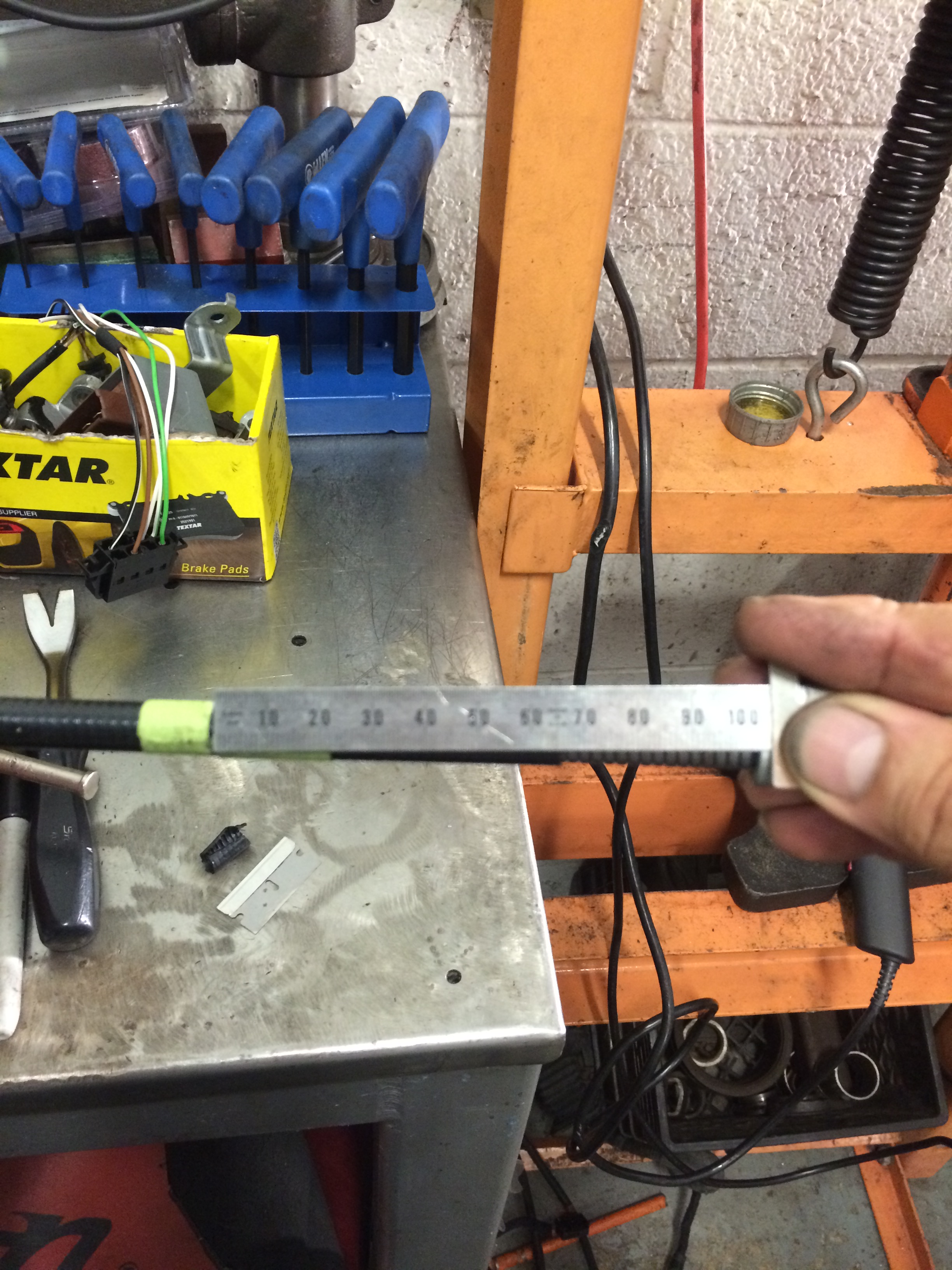

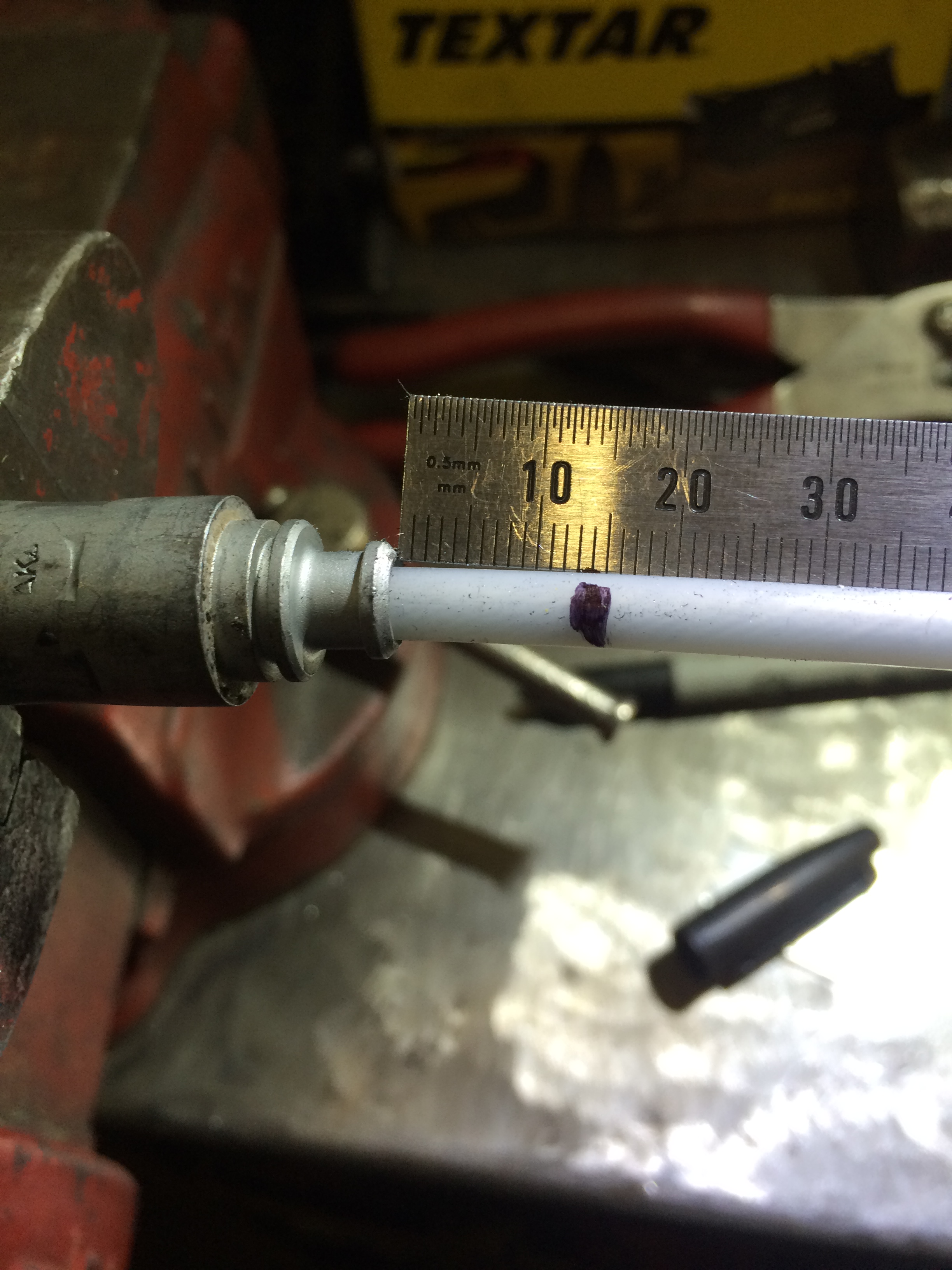

On to the cables.I want to clarify first that the brake cables ends will be referred to as the caliper end (CE) & the hand brake adjuster end (HB). Also, there are the parts of the hand brake cable that makes up the hand brake cable assembly. We will call them in order, firstly, the outer covering with the metal spiral wrap. The spiral wrap covers the inner sheath with Ferrule on the CE end of the hand brake cable. The inner sheath covers the plastic covered cable that imparts motion from the hand brake lever to the brake caliper arm. The write up by John B left me with questions about the brake cable modifications. (You did read it thoroughly, Right?) He mentions to remove the extra length from the caliper end of the cable. I believe that the hand brake adjuster end will be the better choice. There is a metal Ferrel on the CE that holds the inner sheath in place. As you remove the 100mm of outer cable sheathing from the CE you risk the chance of melting the inner sheath as well as needing to move the Ferrule. After removing 100mm of length from the outer cable sheath you are faced with how do you get it off. I used an air powered cut off wheel but had to be careful to not melt the plastic inner sheath that the inner cable rides in. If you do melt it then you will need to transfer the Ferrule on to the newly cut part of the inner sheath. No fun. If you work from the HB end then you can let the inner sheath protect the inner cable when you cut the 100mm section out. I used a heat gun to heat up the metal end of the CE off the cable body while twisting off metal end with a pair of pliers.
Mark cable 100mm from end of metal end of CE
August 9 219.JPG (1.26 MiB) Viewed 50698 times
CE metal end removed & showing extra bit of outer cable housing
August 9 220.JPG (1.15 MiB) Viewed 50698 times

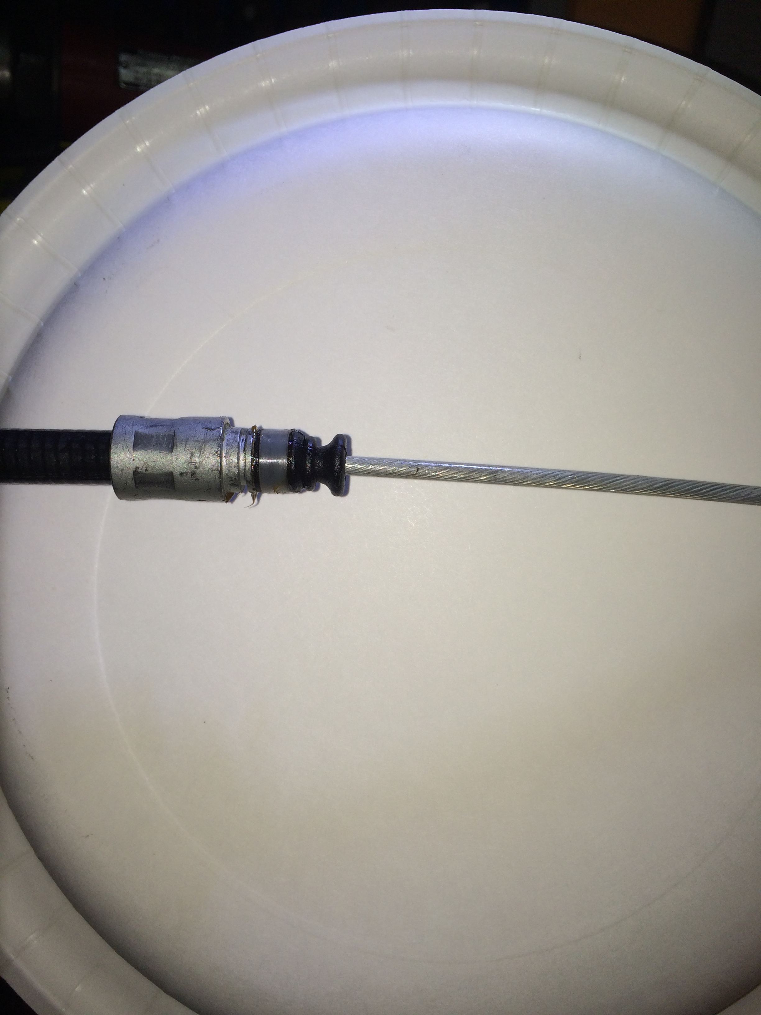

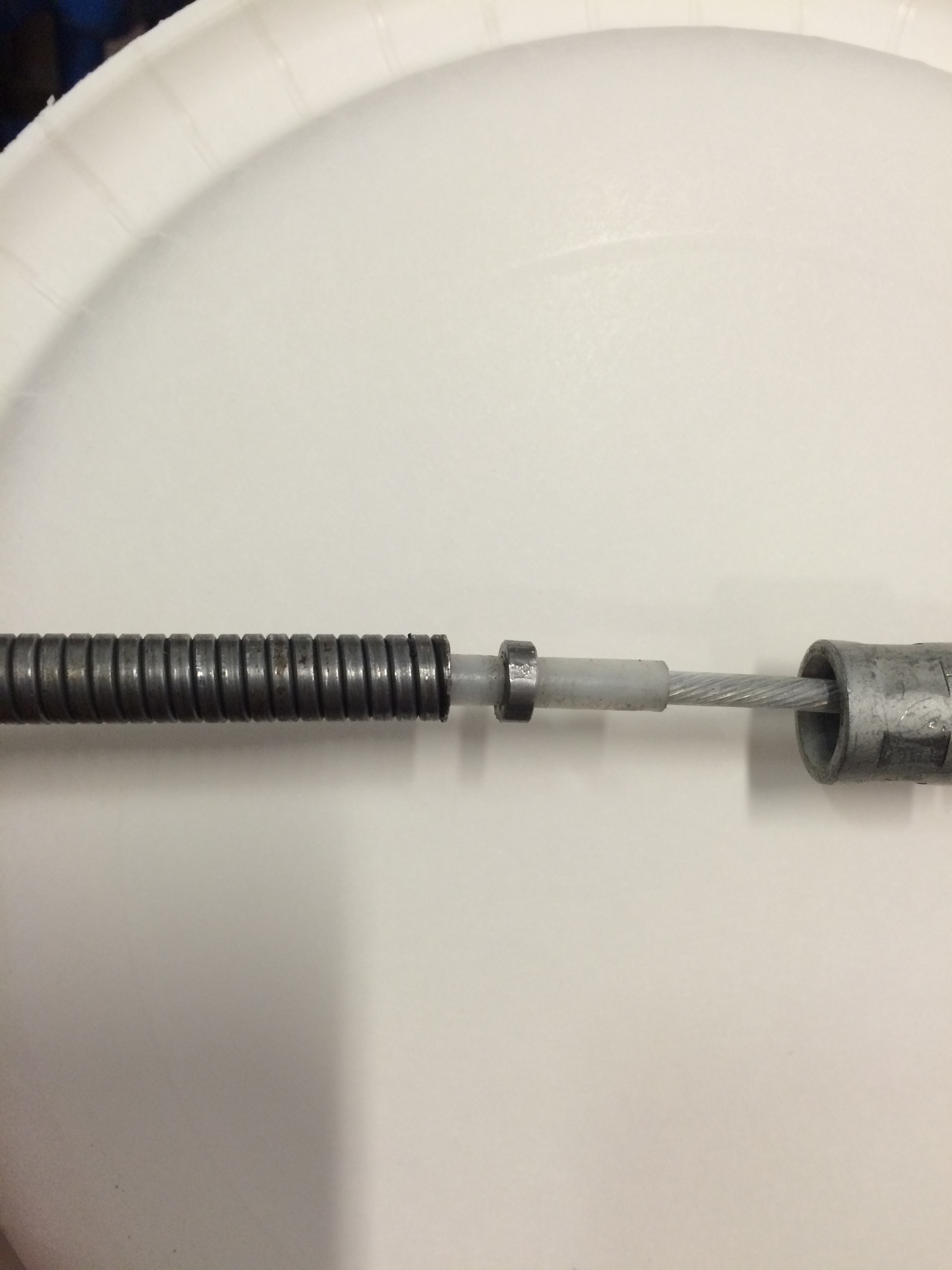

Showing Ferrule on CE end of cable.
August 9 221.JPG (837.85 KiB) Viewed 50698 times
Need to cut this out without damaging inner sheath.
August 9 222.JPG (1.01 MiB) Viewed 50698 times

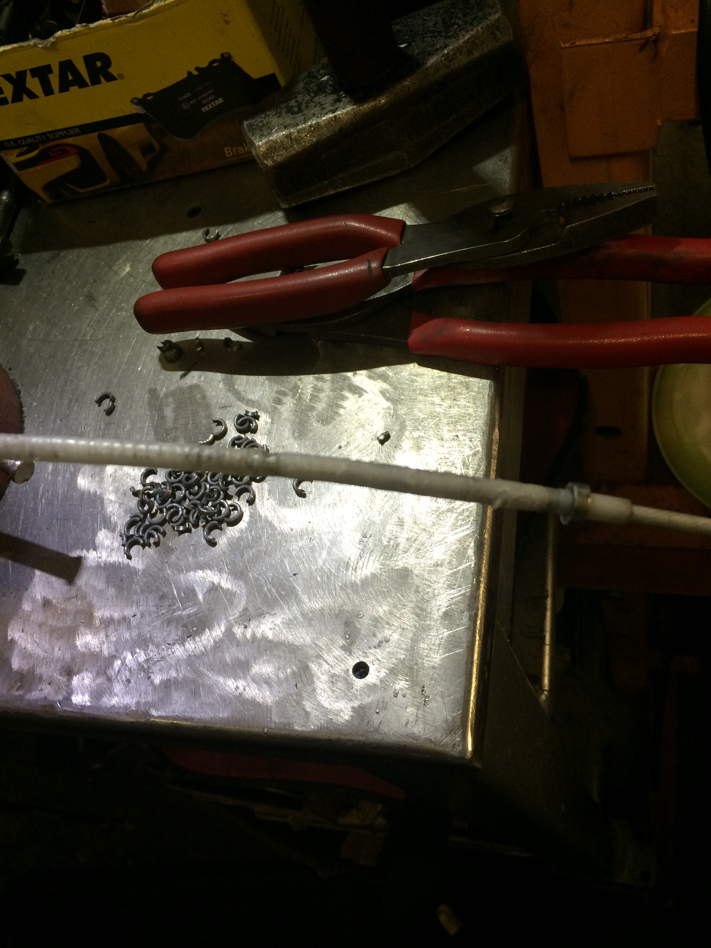

Metal spiral wrap removed.
August 9 224.JPG (1.71 MiB) Viewed 50698 times

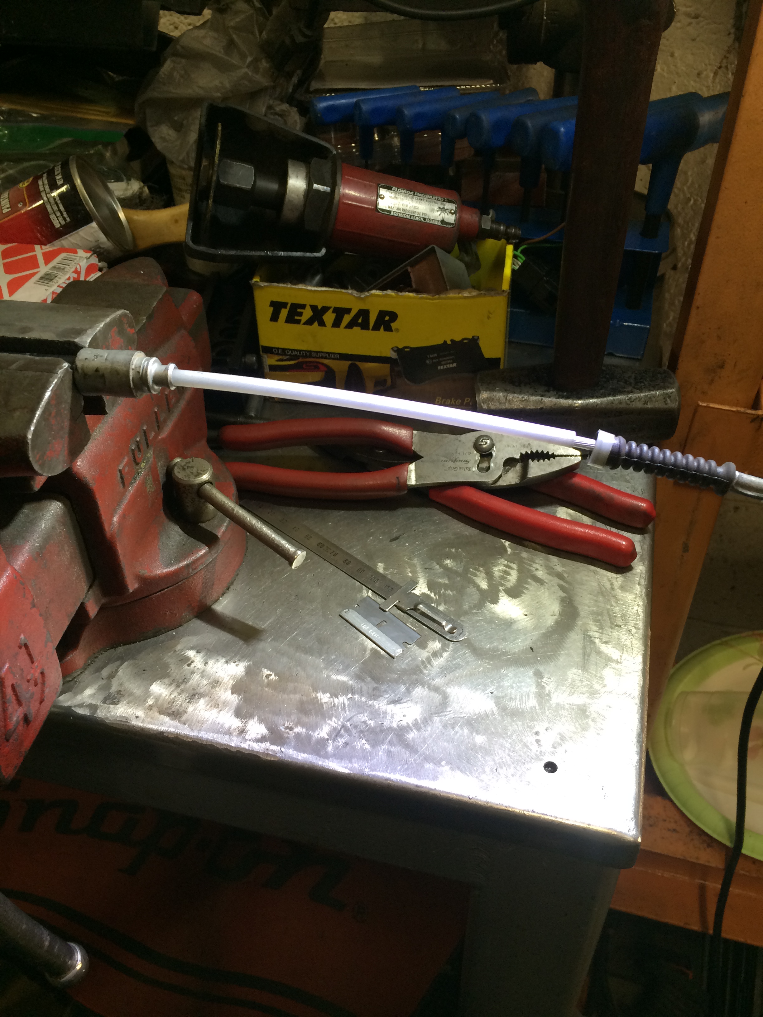

Working on the HB end of the cable.
Extra bit of inner sheathing to be trimmed off. I used a razor blade & carefully "fillet" it away.
August 9 226.JPG (1.72 MiB) Viewed 50698 times

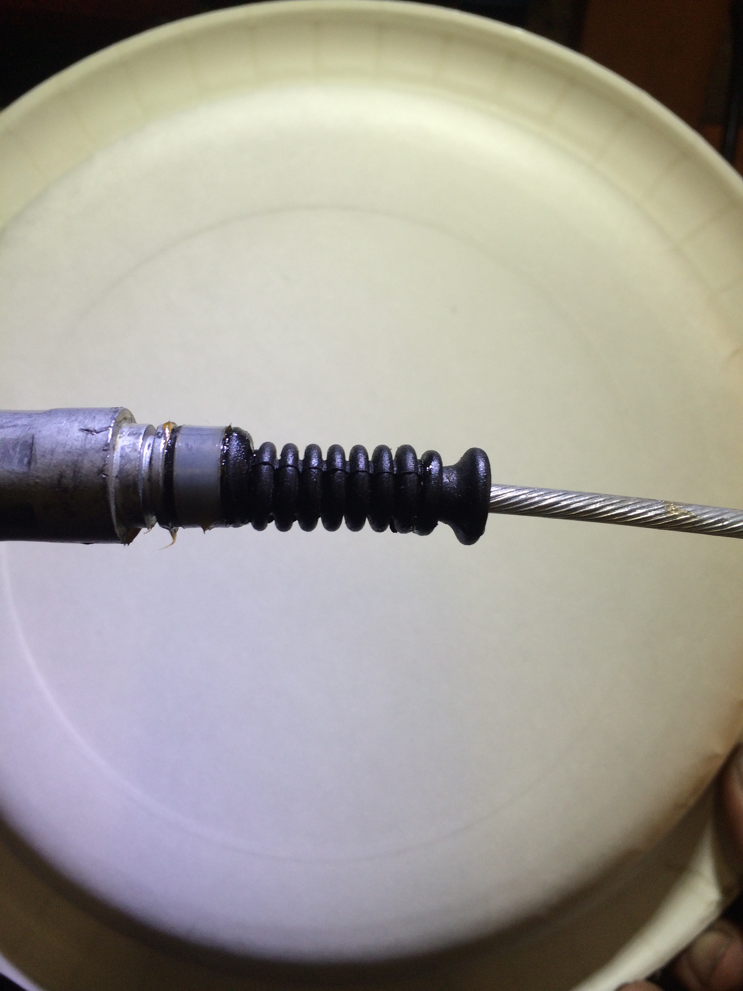

Back to the CE end of cable.
Boot trimmed on the CE end.
August 9 231.JPG (1.28 MiB) Viewed 50698 times
Boot trimmed to prevent interference with pulley. I left both ends of the rubber boot & trimmed away the inner section of the boot. A bit of grease to help seal the end & all is good. The pulley tends to keep the boot in place.
August 9 234.JPG (1.2 MiB) Viewed 50698 times

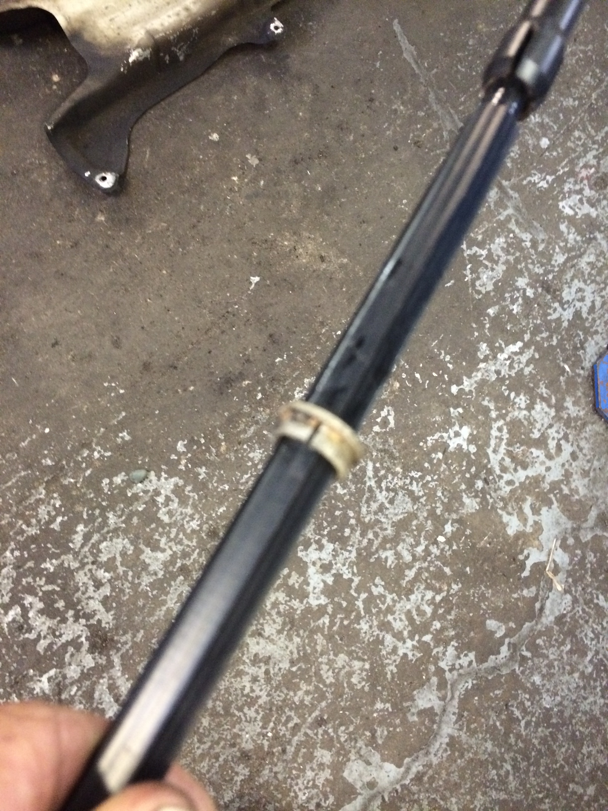

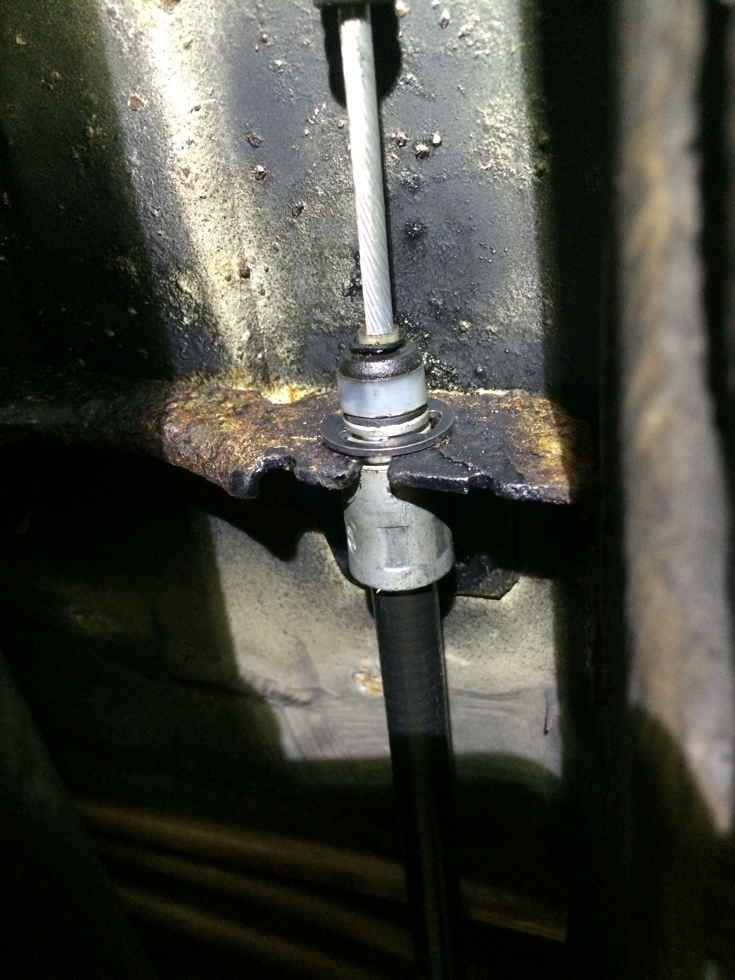

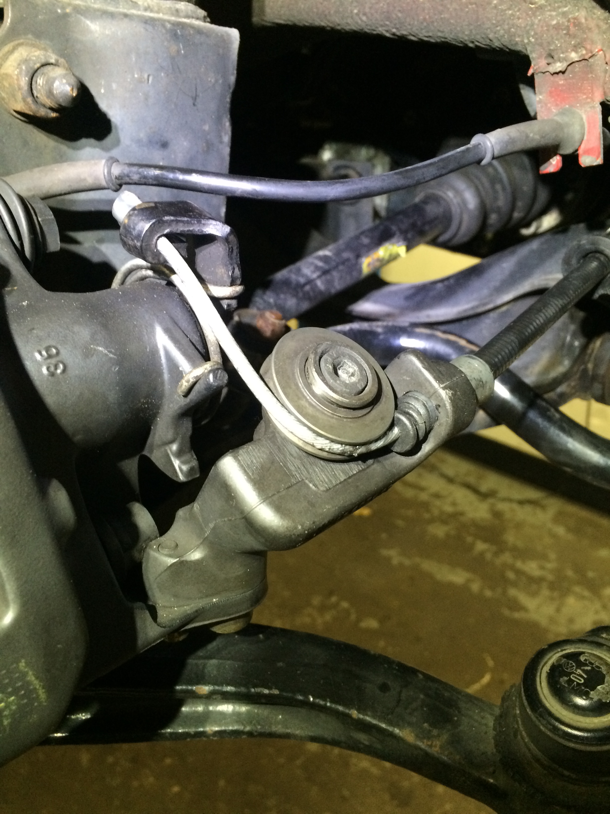

Right, continuing on. The bracket that secures the forward end of the hand brake cable will need to be enlarged for the B4 cable to fit the B3 chassis. The B4 cable end is slightly larger than the B3 cable bracket. You can reuse your old cable clips from the B3 cables if they are not rusted away as mine were.
Bracket needs to be slightly enlarged for the cable to mount properly.
August 9 233.JPG (1.31 MiB) Viewed 50689 times
Cable with new clip.
August 9 232.JPG (1.33 MiB) Viewed 50689 times

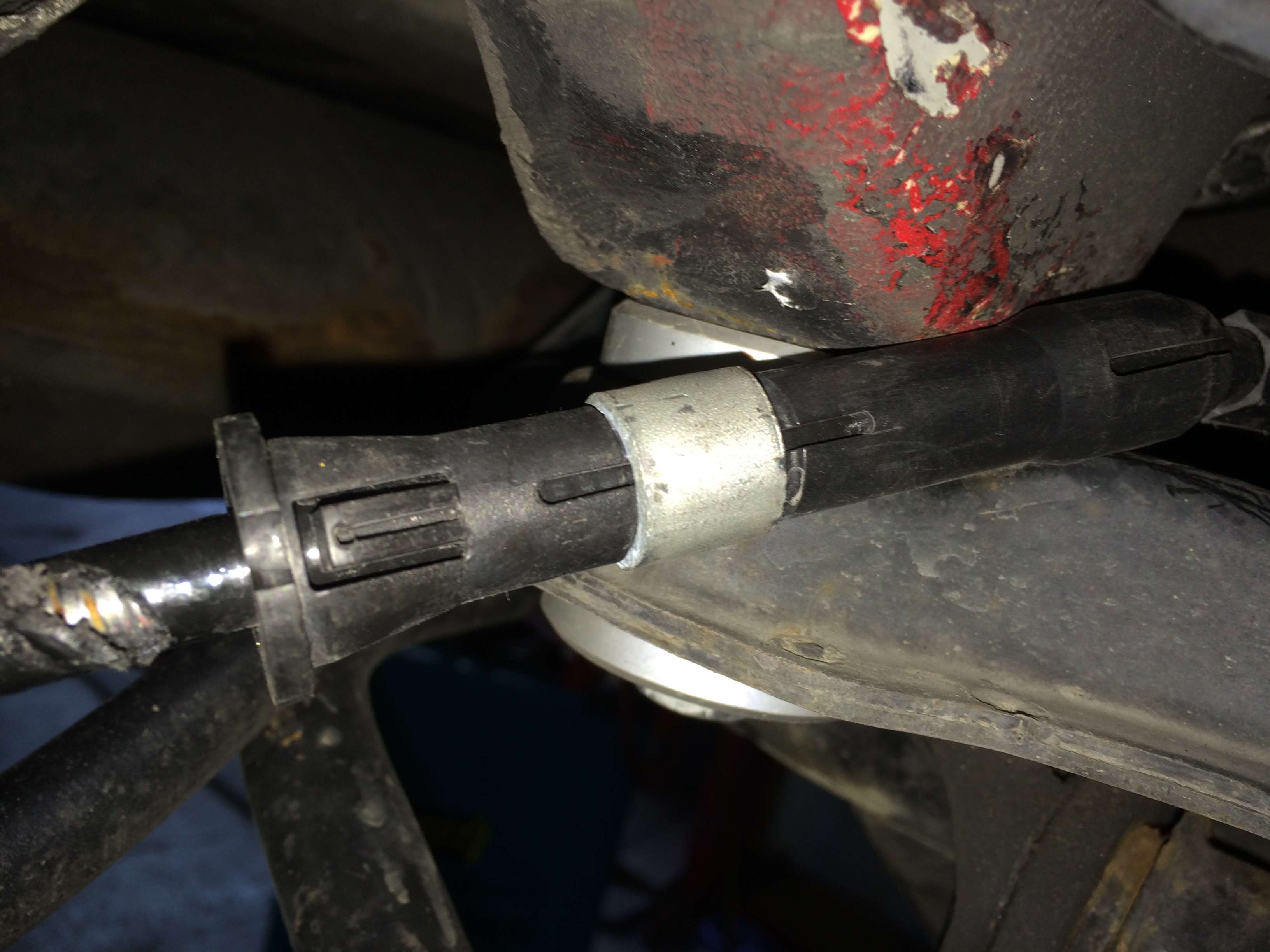

You will want to use these plastic sleeves from the B3 chassis. The cable passes thru these on their way rearward. Not bad for 26 year old plastic.
August 9 217.JPG (1.54 MiB) Viewed 50689 times

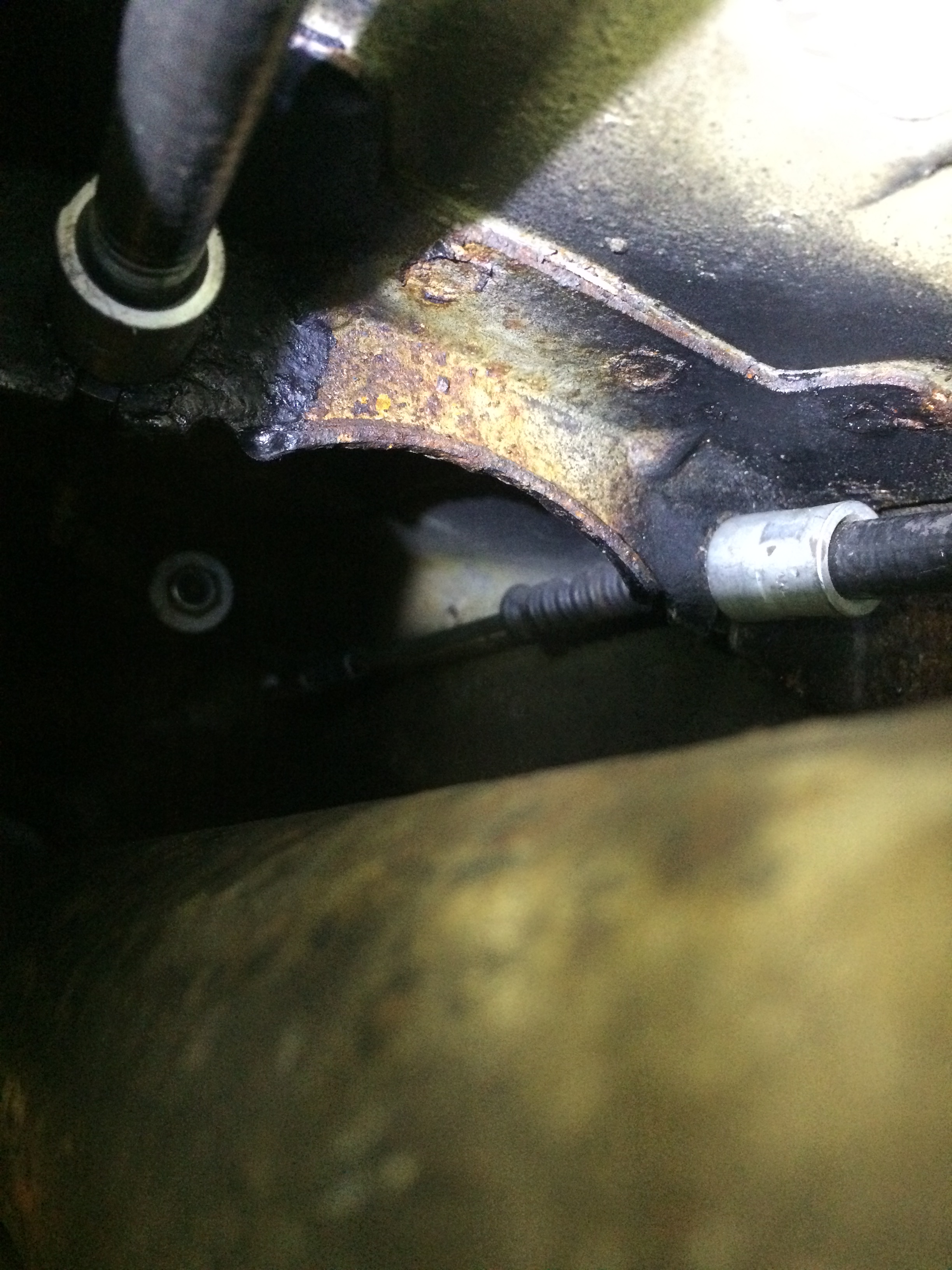

Plastic guide for fitment to the B4 chassis. Cut this off now as it will be in the way later.
Tweak the factory cable guide bracket so it supports new cable & does not cut in to outer cable covering.
IMG_1631 (2).JPG (1.23 MiB) Viewed 50689 times

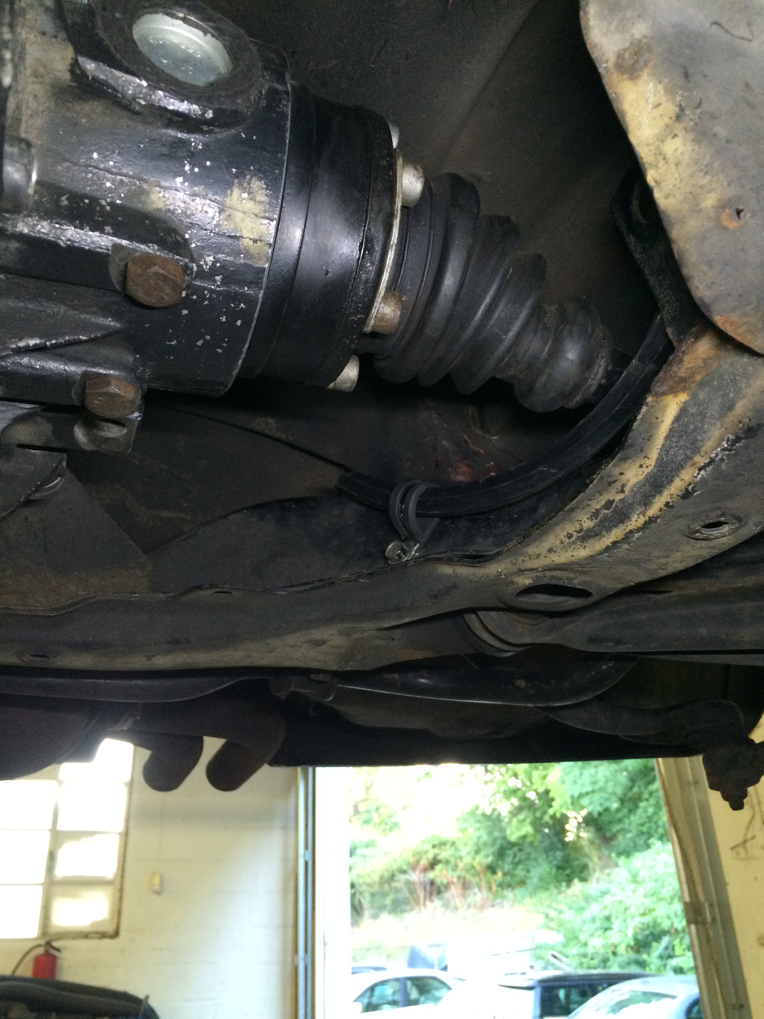

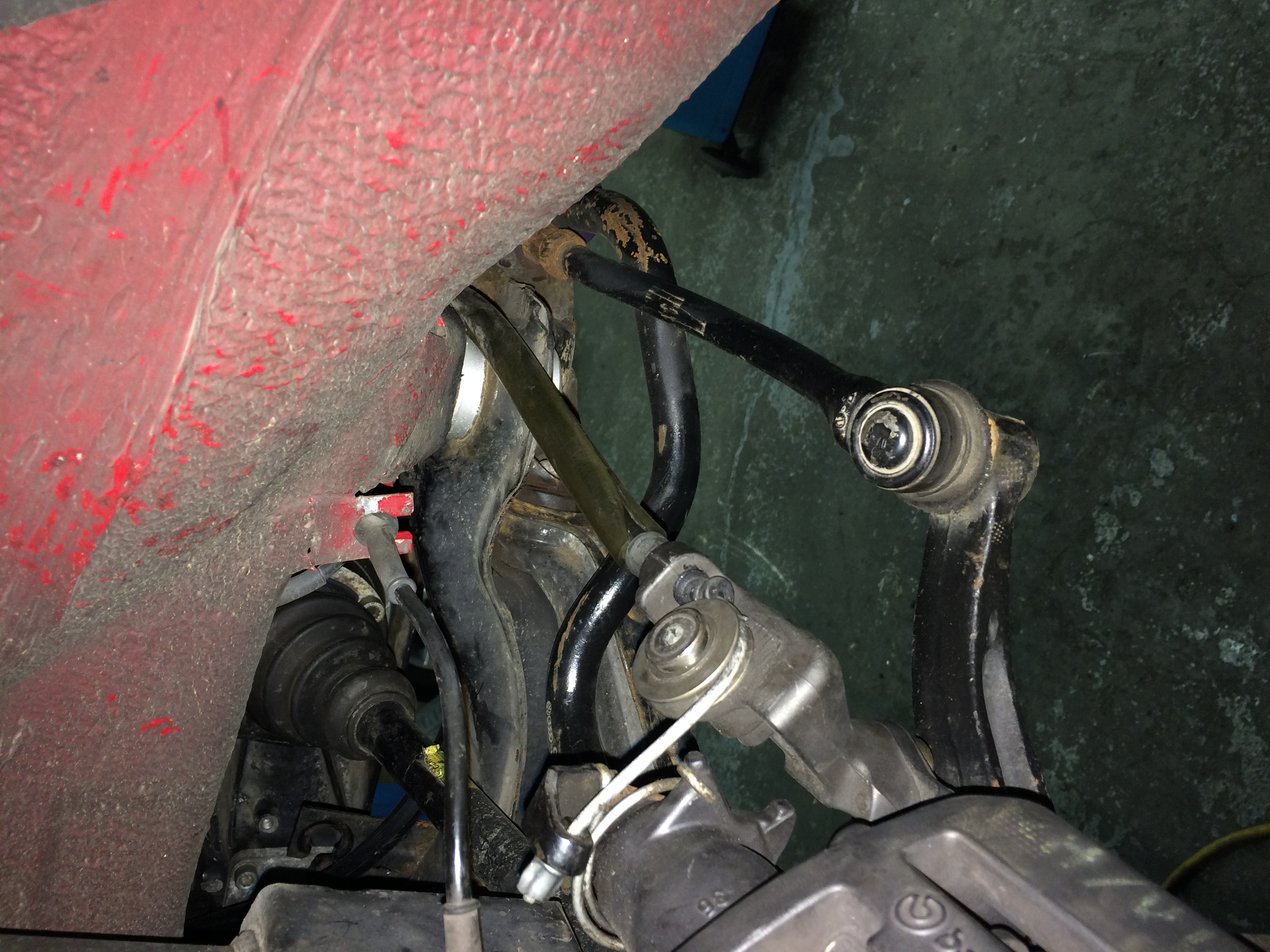

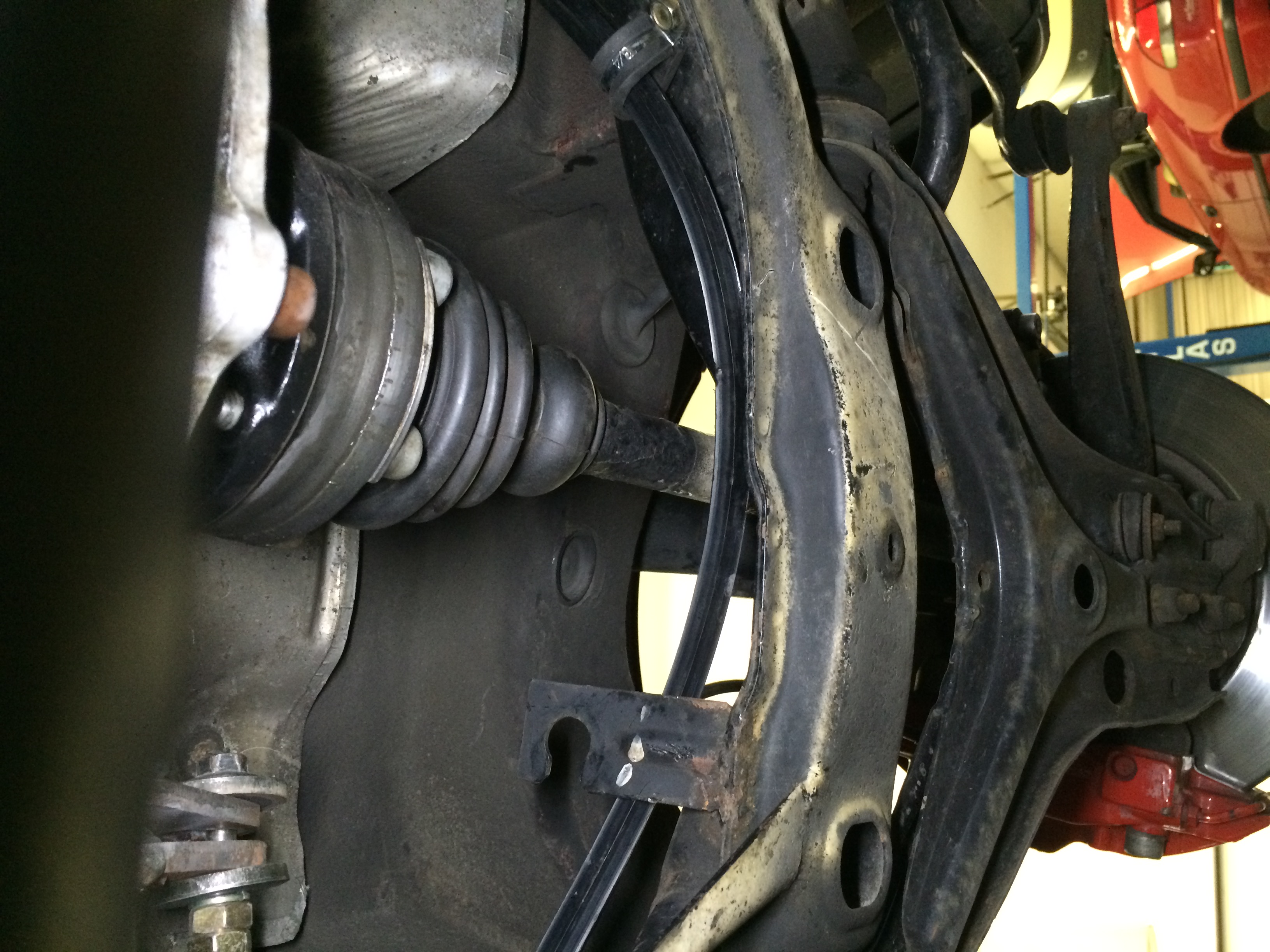

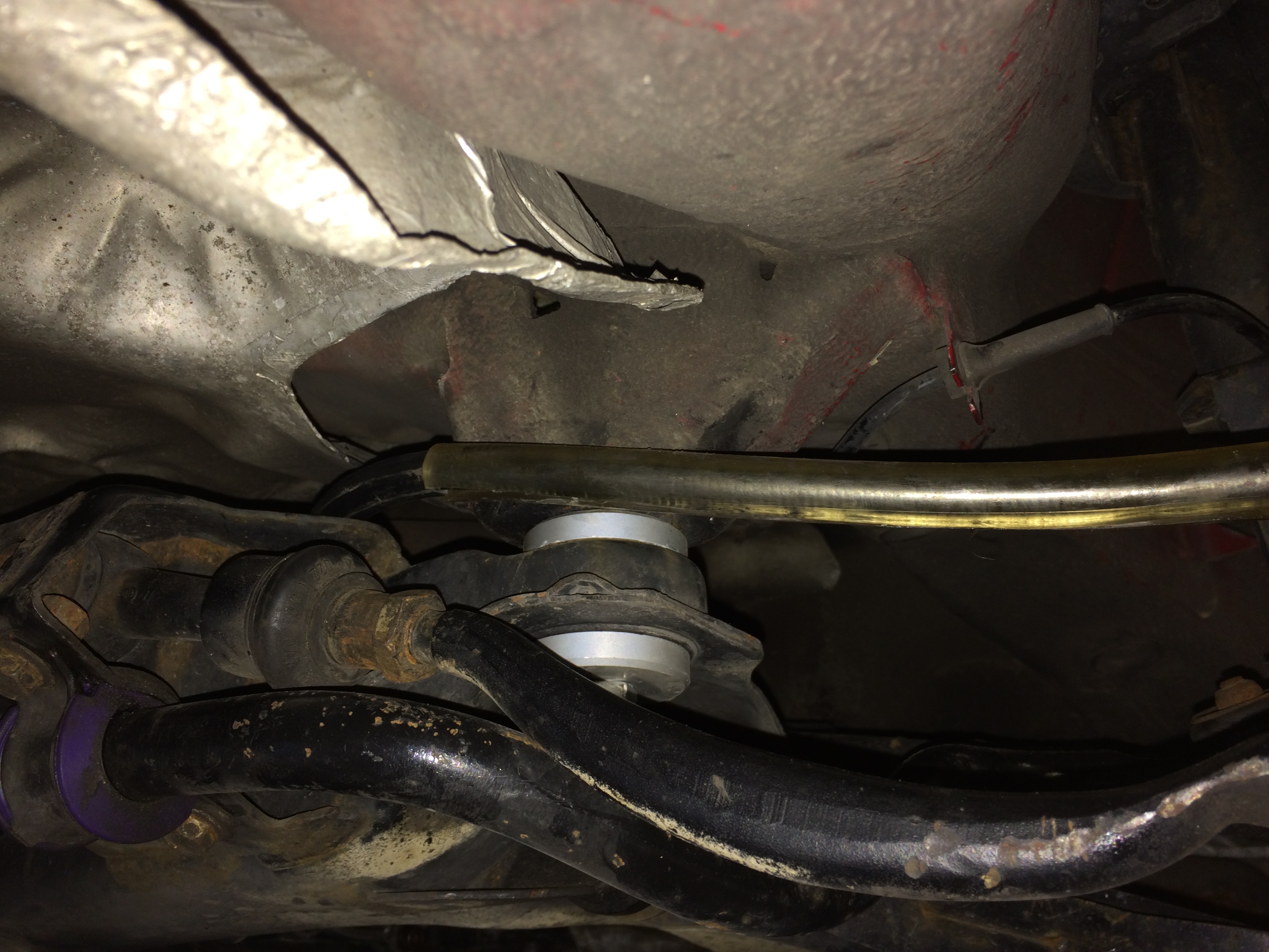

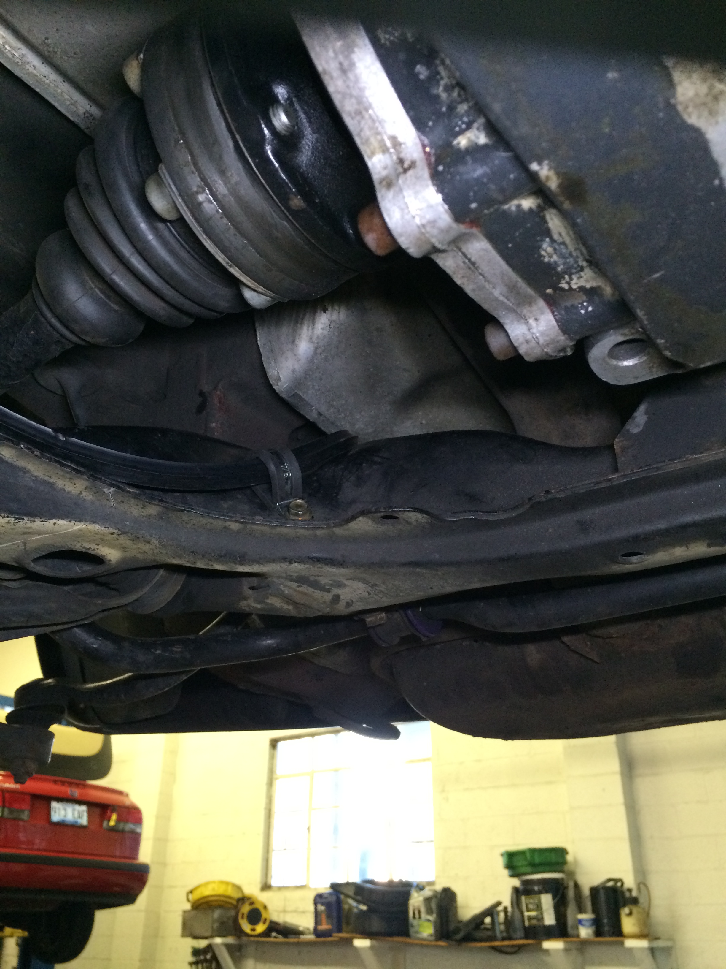

Almost done.
Cable routed Behind back end of subframe. Plastic tubing cut to fit over new parking brake cable for protection.
Another angle.
Another angle.
Adel clamp to hold cable to subframe on left side.
Adel clamp holding cable on right side.
And there you go. Questions? Comments? Criticisms?
