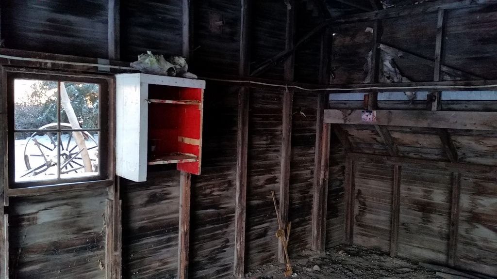

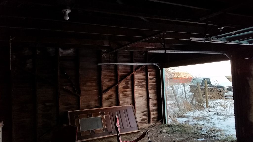

Current state of the building is a bit rough:
-- needs new roof, shingles
-- not insulated
-- no power
-- dirt floor

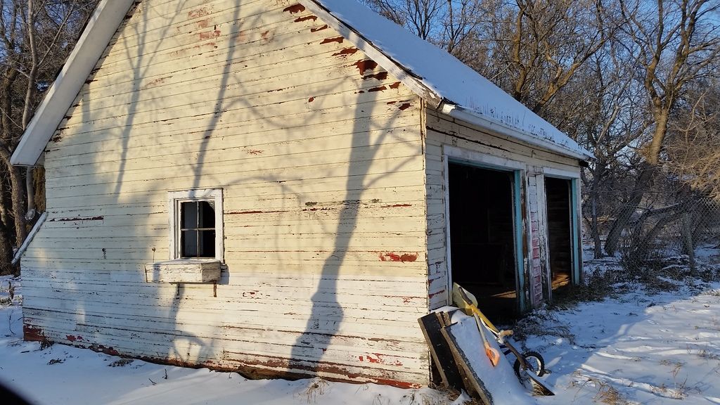

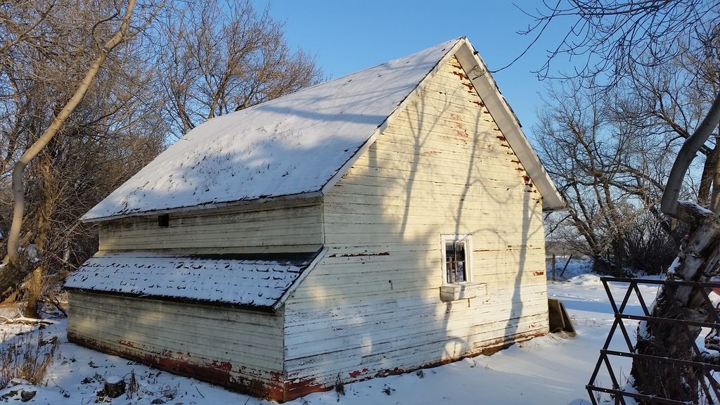

Went out for the home inspection yesterday, had a better look at the garage. Came up with a plan.
Building sits on 8x8 Fir beams. The bones are in good shape. Plan is to just update the garage as-is, and when more space is required we'll build an addition. So no lift for now, but I've somehow managed to survive this long so another year or few won't kill me.
The build out at the back wall is about the right size for a workbench and tool boxes. Which is nice, because the garage footprint stays at 20x24.

Not to be a deutshenbag, but I would knock that shit down and rebuild exactly how you want it. Fuck renovating old shit that needs everything. I would also go bigger. My shop is 24 x 32, and I wish it was at least 40' long. Also, I personally HATE garage doors that are under the roof edge. I think doors should go in a gable end, but that is just me.
Just glancing at the pics, I don't see much worth saving really. The finishing of things is what costs the big bucks. You dont save a whole lot by re-using a bare bones structure.

Haha Dana you basically nailed it.
It's a tear down, unfortunately. It will basically just serve as a good supply of aged wood to sell to hipsters.
