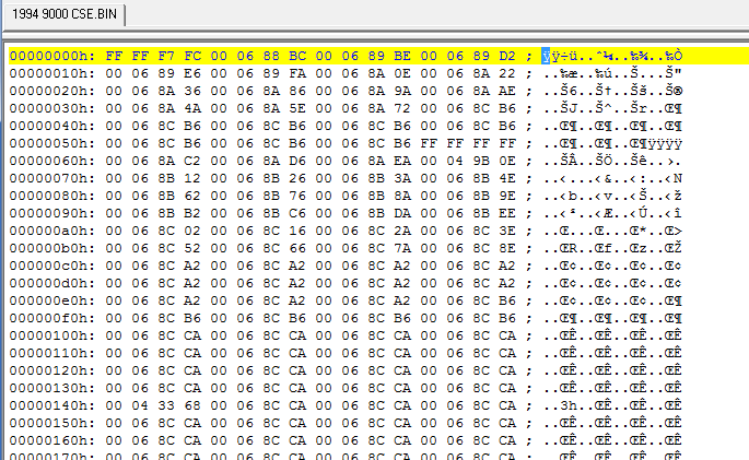

This is the procedure i use to correct the checksum for the boost chip. The first thing your going to want to do is go download a copy of HxD hex editor.
Here's a link to the download page for it, pick the language that suites you best.
http://mh-nexus.de/en/downloads.php?product=HxD
once ya have that open your modified 32k boost chip BIN file in HxD. highlight from 0x0000 to 0x3FFF. next you'll want to click analysis up top and pick checksum. with the little window open pick "Checksum-16" and make sure the region radio button is highlighted. and say OK. after that a window will pop up showing the 16 bit checksum.
That part of the checksum goes at at offset 0X3FFA and ends at 0X3FFB. now for the next 2 sets of bits in the checksum. these have to be inverted and to do so you must take the checksum you calculated with HxD and subtract it from FFFF. once you have those values input them into offset 0-3ffC and offset 0x3ffD. Oh and the last to sets of bits ar ethe ECU's internal number. To do this math easily you can simply use the calculator in windows. To do that open it up, click view and than programmer. once that is up make sure you click the radio button on the left for HEX and your good to go to calculate the second half of the checksum.

when i do binary comparison my choice program is a program called HEXcmp. pretty simple to use and will show you what differences there are plus you can offset one BIN to another because no 2 versions of motronic are laid out the same even though they all are all mostly the same with minor revisions.
http://www.fairdell.com/hexcmp/
One other program i use is winOLS. this is a great map discovery program and it will correct the motronic 2.3.2 checksum for you.
http://www.evc.de/en/product/ols/software/
