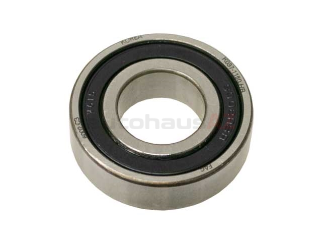

While everything is apart, I'm working on a list of things to replace. I plan to use the Spec clutch and PP and have the flywheel resurfaced. Even though they have less than 40k miles on them, I'm thinking new TO and pilot bearings would be a good idea though.
Can anyone confirm this part number for a 7A pilot bearing? (034 105 276B) I found it in a search on MG and plugged it in on AutohausAZ, but their site says it won't fit. And that number is shown in the cross reference.
https://www.autohausaz.com/pn/112117203 ... ZbjU_9LJ6U
