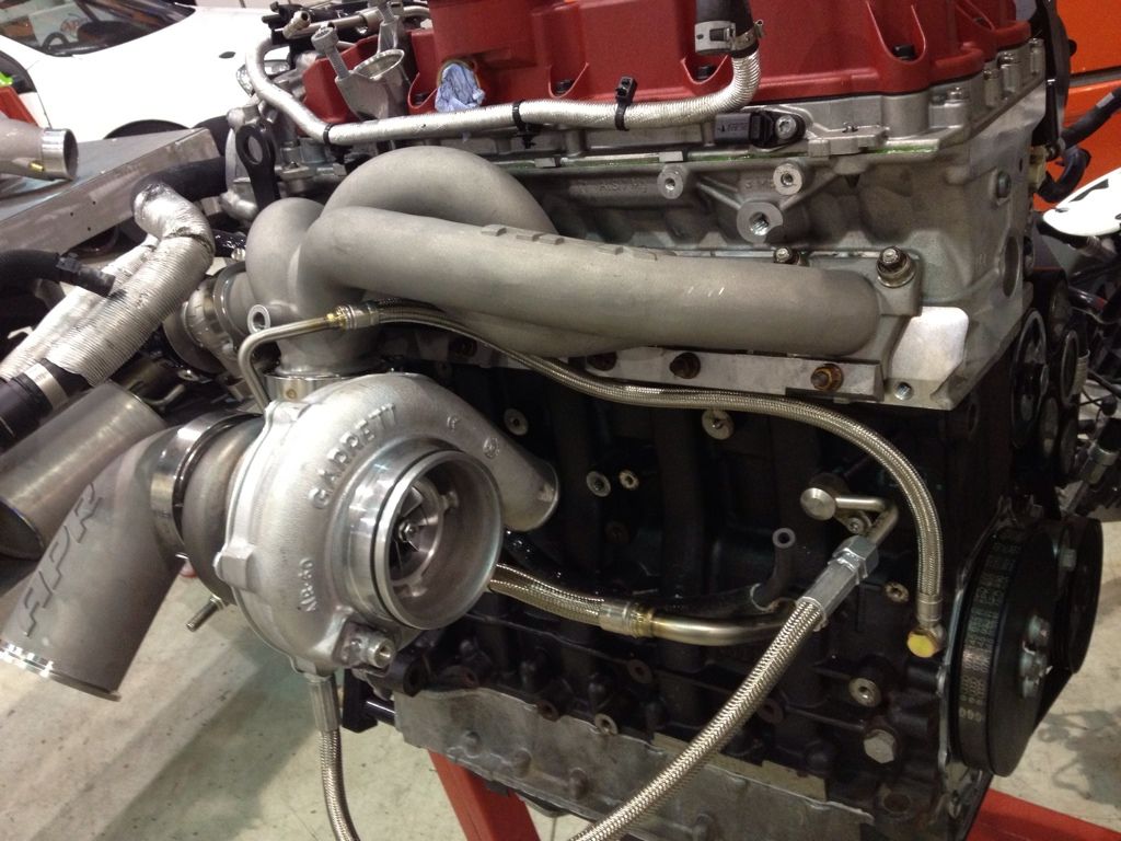

Postby Wheeljack » Wed Mar 06, 2013 11:01 am
I'm still patiently waiting to see how this setup is going to perform...GTX3576R...with some real nice looking castings from APR...
Build thread here: http://www.audi-sport.net/vb/project-room/160466-**ttrs**-project-750hp.html
http://brydon-eng.com
Wheeljack
Posts: 314
Joined: Feb 28, 2013
Location: Ute Territory
Re: TT-RS PDF
Postby Hank » Wed Mar 06, 2013 2:04 pm
:drool:
That is gonna be awesome. Looks like they are using a .63 exhaust housing though?
