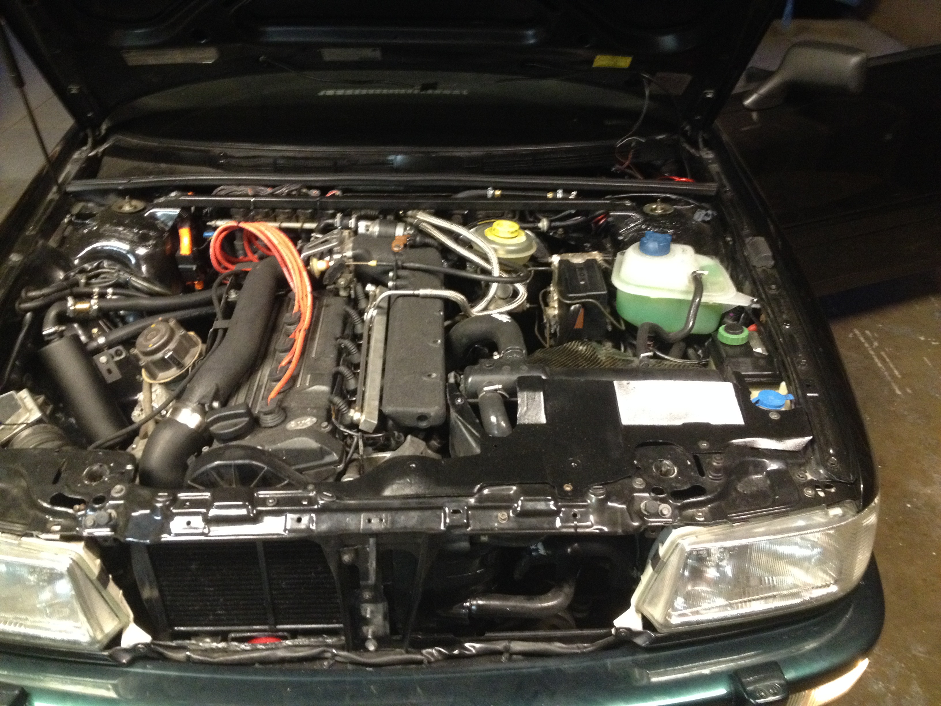

Installed the vacuum distribution log:
- IMG_0346.JPG (1.61 MiB) Viewed 41686 times
- IMG_0347.JPG (1.65 MiB) Viewed 41686 times
