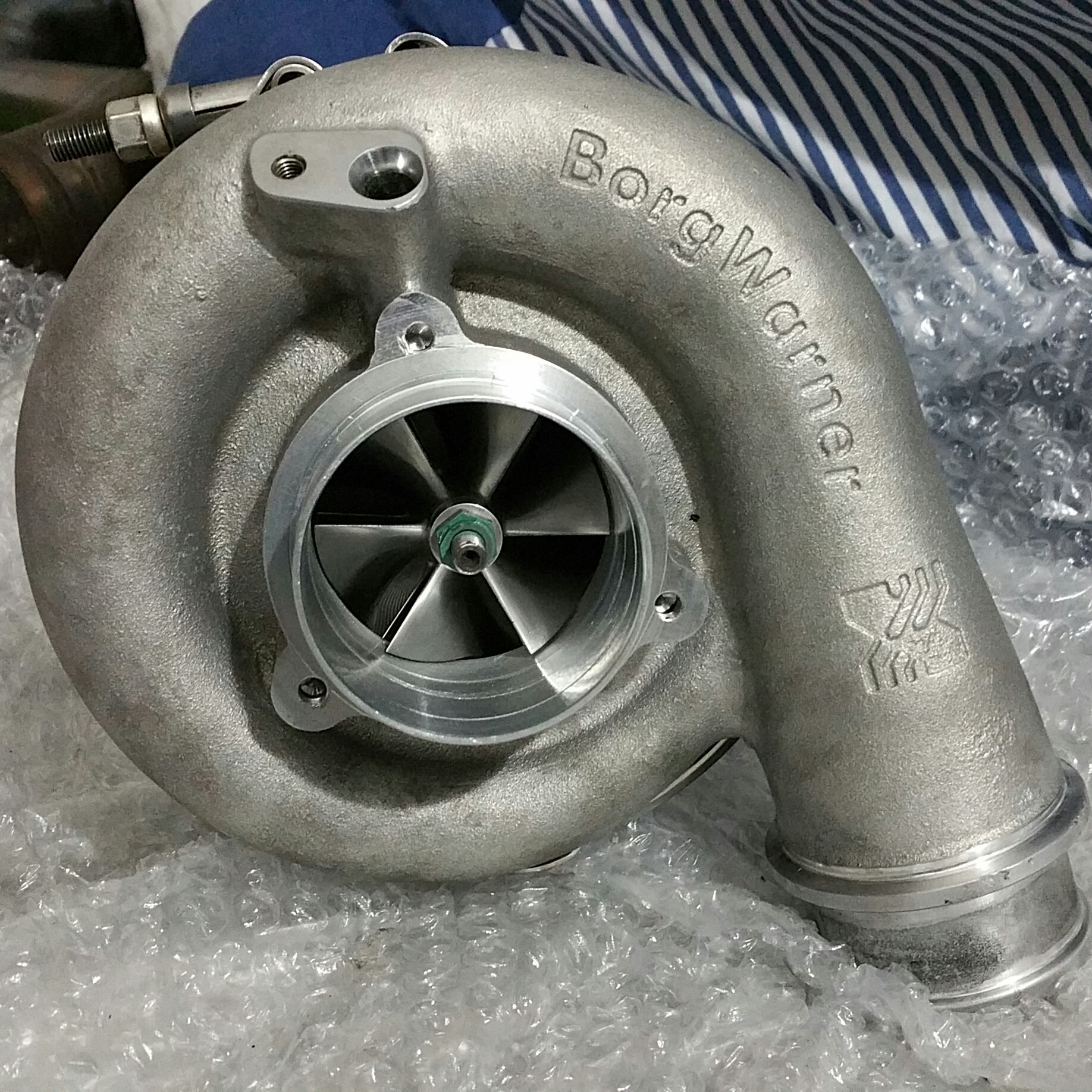

Hi
- 20160716_223130.jpg (2.2 MiB) Viewed 34588 times
Hmm
- 20160716_223130-1.jpg (2.34 MiB) Viewed 34579 times
Someone had a good waterfest
Did you choose an EFR?
Is that a 9180?
Is that a 9180?
Haha no, just a little 6758.
According to Marc, spools like stock but then HOLY S****!
loxxrider wrote:Haha no, just a little 6758.
Can confirm
they're a damn hoot and a half.

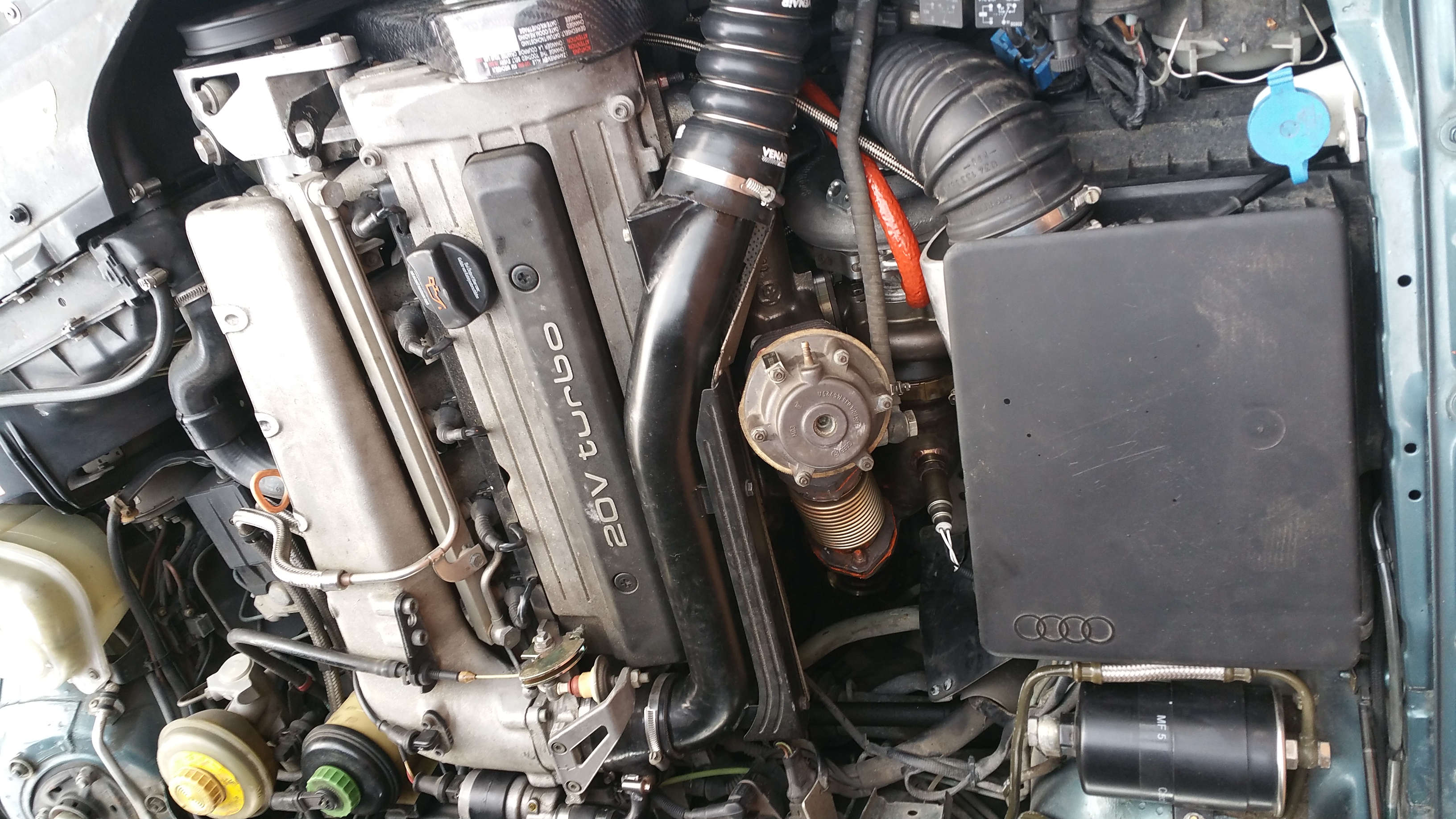

I do have at least a picture of the manifold and one of the car to hold you over.
- 20160722_235228.jpg (1.85 MiB) Viewed 34415 times
Rennwgn
- 20160722_074826.jpg (2.46 MiB) Viewed 34412 times
Yup.
And now we need some vids, please.
Welp, it's in but not without its problems. Still have to fill with coolant tomorrow, the rear section of the exhaust is bungee corded up near the transmission, the wastegate reference line is plugged because I didn't have the right size hose for it, and... Wait for it...
