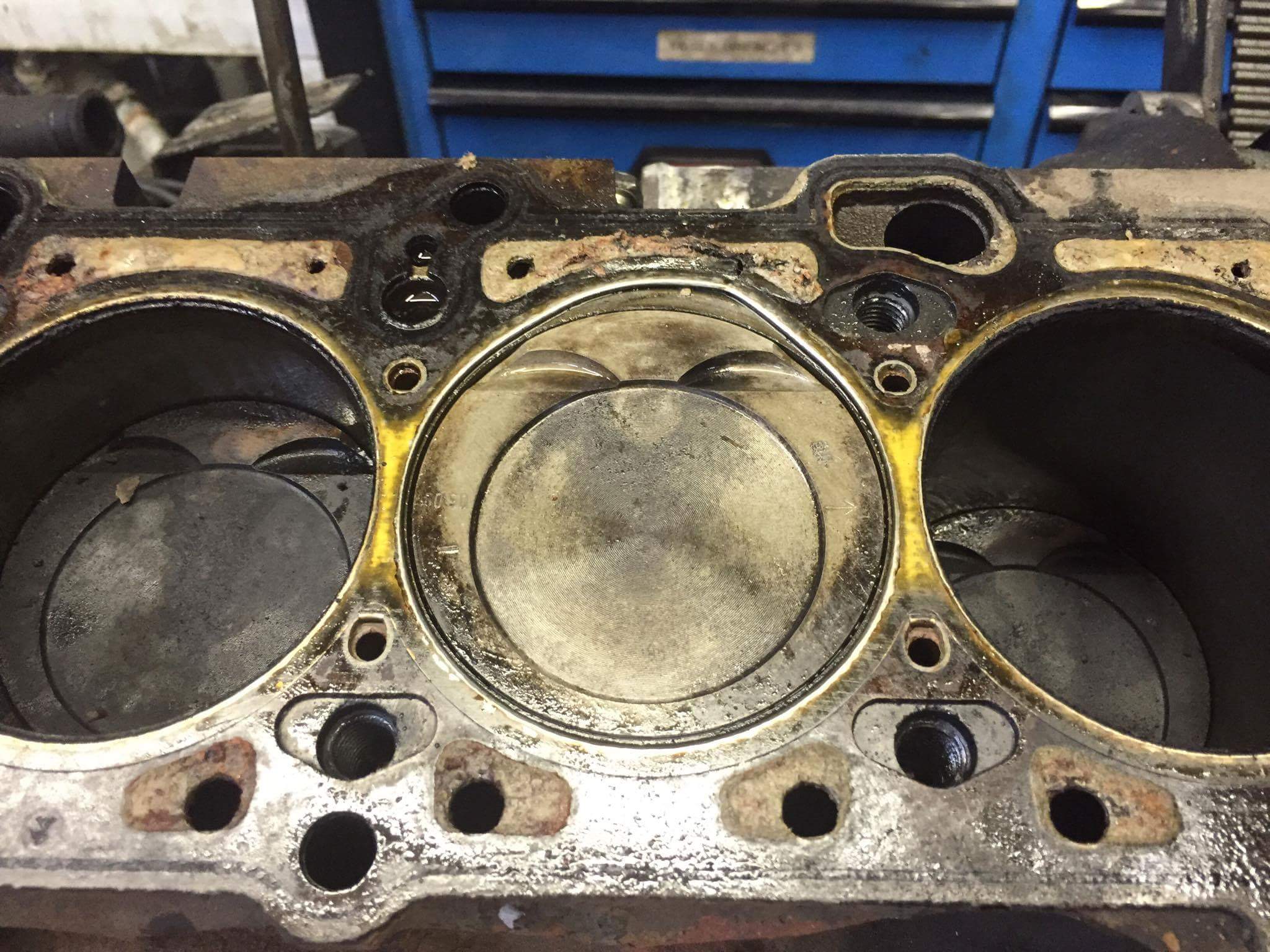

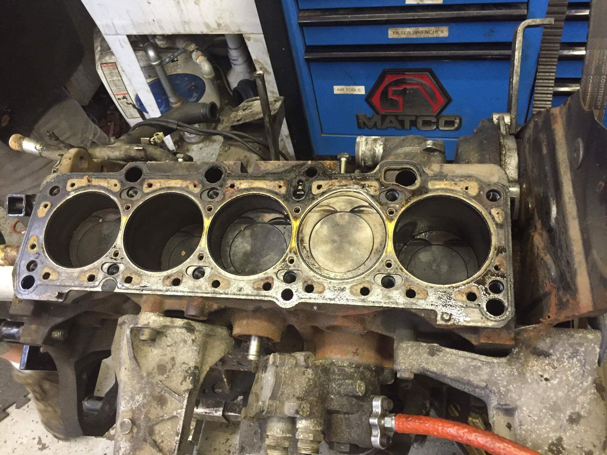

Re: Chris' 200 20v Avant - RENNWGN - Blowed Up
Steam cleaned!
- received_10155167755597786.jpeg (358.43 KiB) Viewed 39970 times
- received_10155167755457786.jpeg (336.79 KiB) Viewed 39970 times
Dang! I dont know if I have seen one, is that what the stock HG looks like?
That happenes, how does the head look?

Sorry to hear the bad news Chris, I totally understand your pain! I blew the headgasket in my truck, after putting new injectors in, 4 days before I had to tow a contractors trailer to Mexico for work... No fun.
Any news on if it bent a rod or not?
