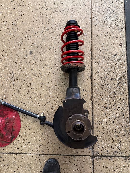

Now to decide what steering arms I want to run for the front.... I have new 85+ 4kq arms and new OEM in the package urq arms. I believe with the EFI MS downpipe I can run the 4kq control arms and not have to use the bent urq unit. I hope that is the case. Guess I will find out.

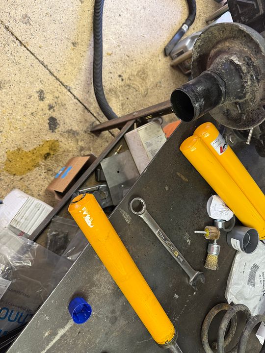

Ended up going with Koni shocks for the front and rear. Rears are internally adjustable and fronts are externally. Paired these with new H&R springs from tire rack. I have Verkline strut mounts on order for well over a month, but they did not show up in time (back ordered). So I went with Meyle HD units for the rear. New dust boots and bump stops as well. I will put the front shocks together maybe next time. Rear has spherical tie rods since stock units are NLA and new ball joints.
There was Konis on the car with stock springs, but they were toast. Waterfall of oil came out upon removal.
All back together.

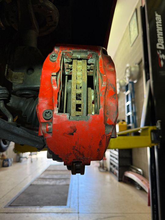

Picked up some rear V8q calipers. They seemed to be in good shape but one of the E-brake mechanisms was loose in the caliper. Looked online and found a new pair for 130$. Done. Rear calipers installed with vented rotors now instead of the stock solid rear rotors. Just need to get some brake lines for it. Have 8N TT lines coming that look like they will work. Stock lines are too short as the connector on the caliper is now at the bottom instead of the top. E-Brake cables are still good and the rod is rusty enough that I prefer not to mess with it right now.

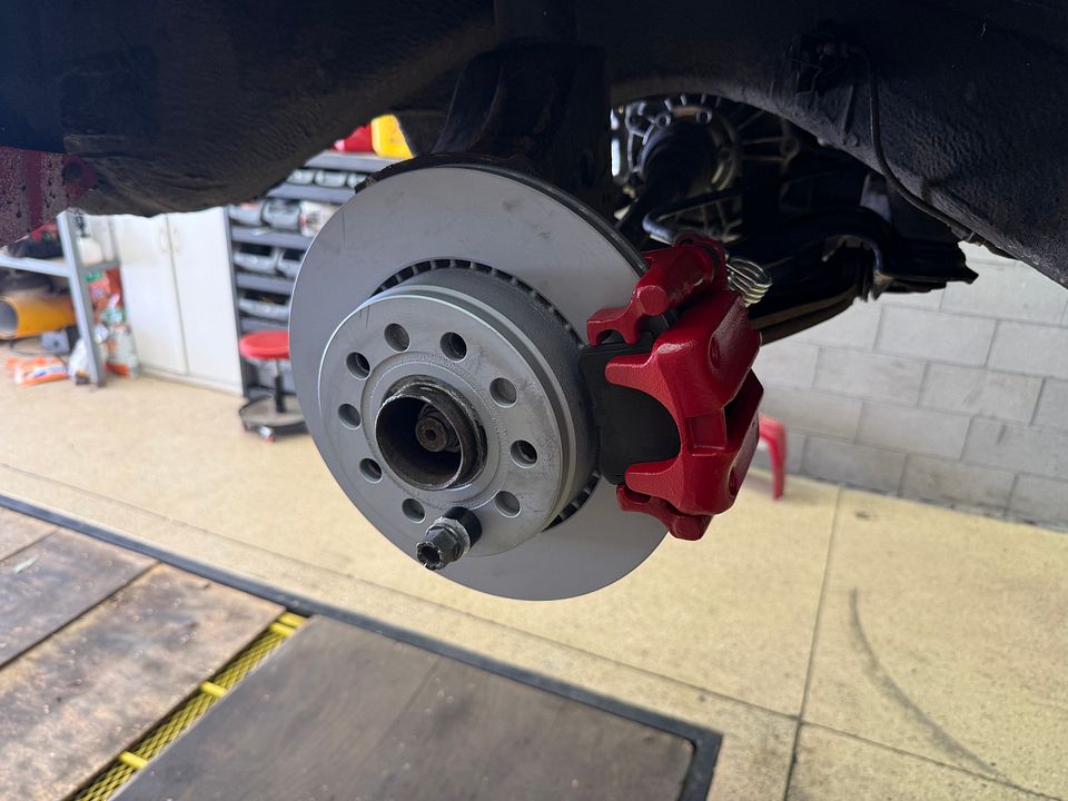

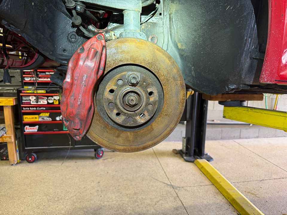

So I had a set of Big red caliper adapters from my urS6 that worked with a smaller rotor (312mm D2) to fit under the 16" Fuch wheels. Reached out to apikol and they suggest a B5 S4 rotor may work on my urq. Since i was going to grab my rebuilt 01E from S4Parts down in Tucson anyways I grabbed a junk rotor from him. Did some test fitting and they will work great. At 321mm tall I doubt I can stick a 16" wheel on the car, but I am prepared for that with wheels on deck in 16's and 17's for it.
Yes, they are pretty ugly right now. Since I now know they will work I sent them off to projectB5 for a rebuild and powder coat in original red.

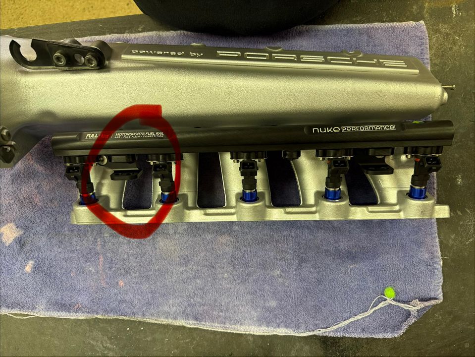

A good bit of my order showed up from Marc. Next was to install the Nuke fuel rail. The rail came with 60mm tall injectors. Got it put together but the mounting brackets to the intake manifold were not lining up.
After some measuring and messaging with Marc we found out the 3B/RS2/ABY Nuke fuel rail is made to use standard size injectors, 48mm tall. Marc has new injectors on the way and should be at my house by the time I am back from this work trip. Included in that package will be the turbo with lines and the downpipe. Once the down pipe is here I will then get it and the exhaust manifold dropped off for cerakote.
