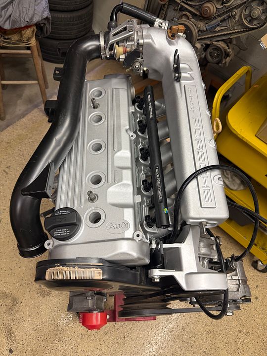

That covers the most of it. Here are some pics of the engine progress.
test fit LS2 coils from my urS6

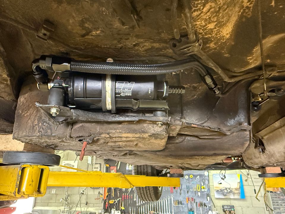

When I got home this past week there was a nice box of parts waiting for me. The downpipe and exhaust manifold are now out for ceramic coating. So the only thing that could really be done on the engine is get the fuel rail installed. When reinstalling I added the 034 intake spacer. Also delivered was the RR black intake pipe from Audi Tradition and some q script seat and door material.

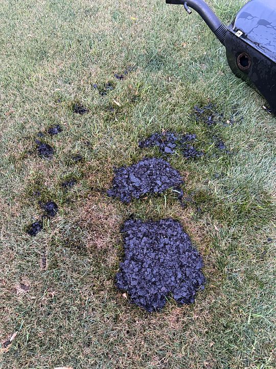

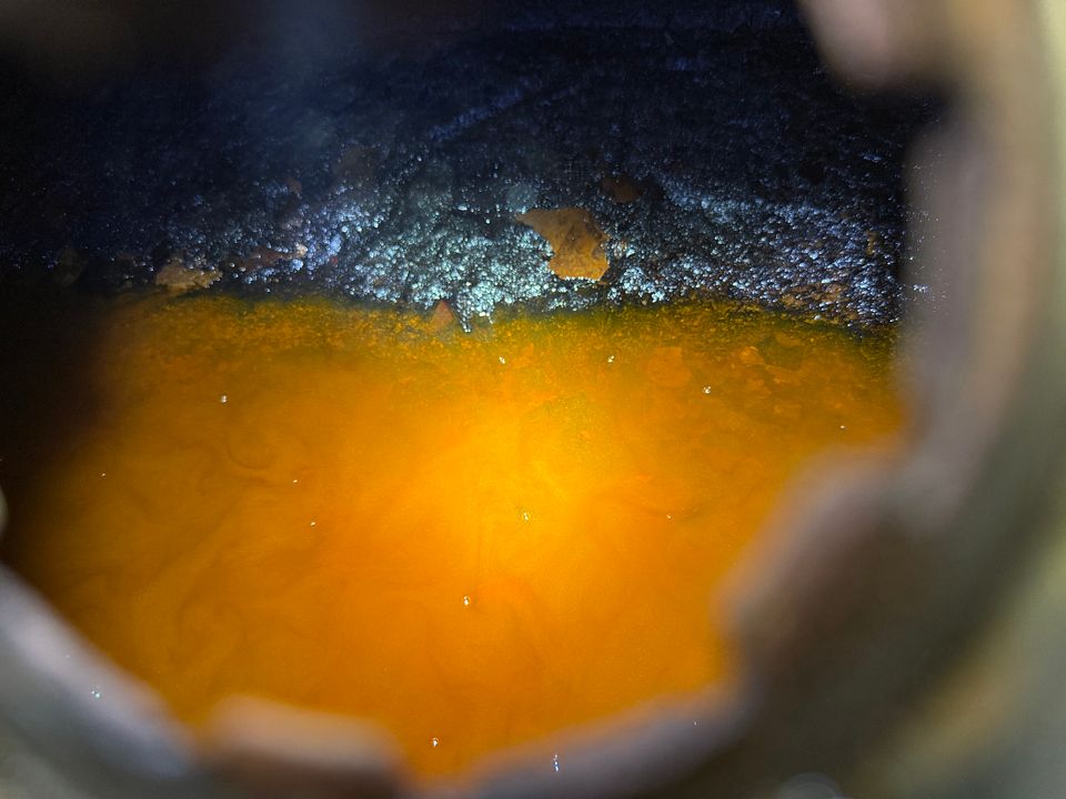

Now onto the fueling. I removed the old FP, accumulator and filter. Cleaned the brackets and installed new. The old filter was dated 94 with 67k miles. I went a head and added a mini bosch 30a relay off the battery and ran new wires down to the pump. At this time the decision was made to use AN line from the pressure side to the factory hard line. This is my first foray into AN lines. I like how they look, but do not love installing the fittings on the hoses...

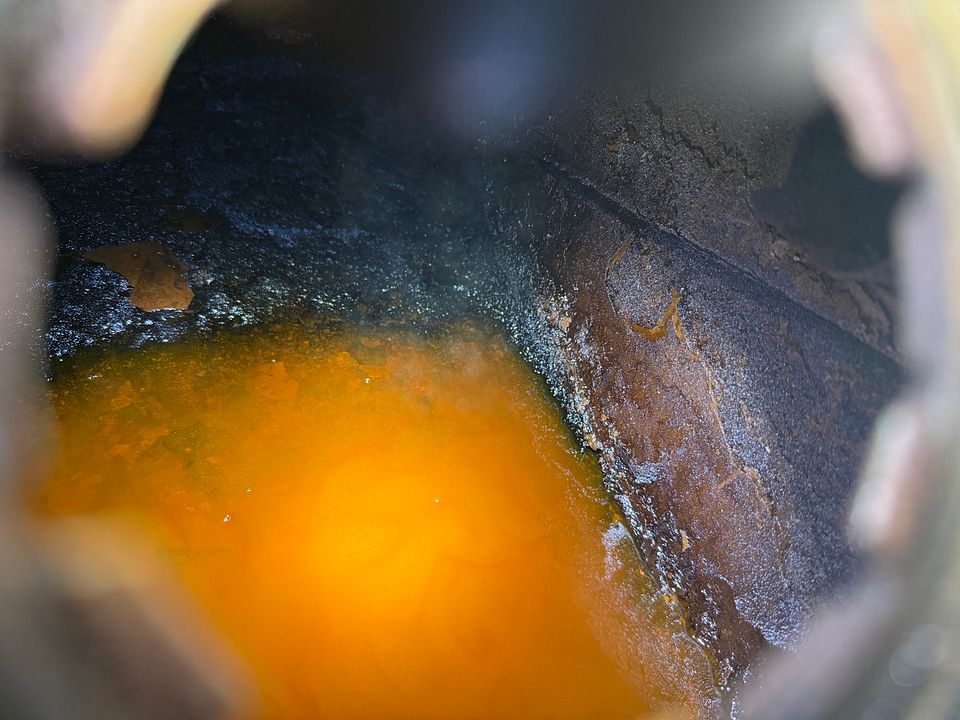

When I had removed the feed line from the tank at the pump very little nasty liquid trickled out. I knew the tank was going to have to come out. So out it came. Once removed and I looked inside I found it way worse than I thought it would be....
This is most of what I got out of the tank after a few rinses.
Luckily I have found a shop locally that "restores" old fuel tanks, so I dropped it off to them. Hopefully after the acid wash it is not swiss cheese.

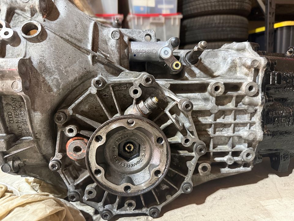

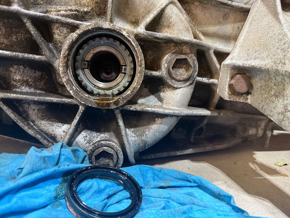

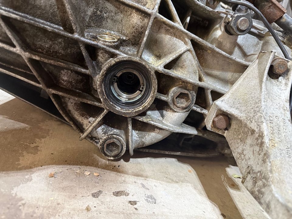

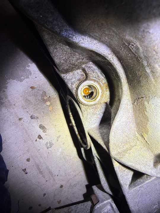

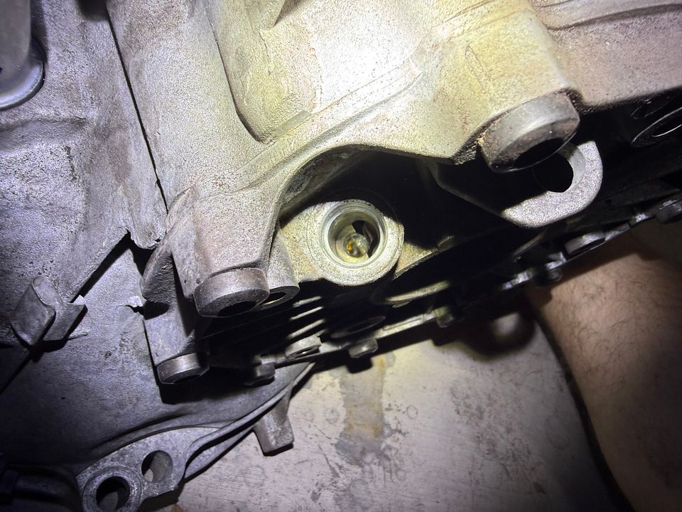

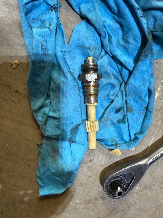

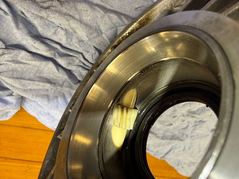

With that nasty tank out of the shop I moved onto setting up the 01E to accept the cable driven speedo. I found an old post from Hank on how he did it, but no pictures. Basically the 01E digitally reads a smooth ring and the urq unit uses gears. So you need to swap the gear ring behind the passenger CV flange from the urq unit into the 01E. When removing the geared ring you must pull the gasket to get it out. On the 01E you remove the entire cover plate. Once that cover plate is off you need to drill and tap out the hole on it to accept the cable drive mounting adapter. Drill and tap is M18x1.5 Tap and 16.5mm Drill. Here are some pics.

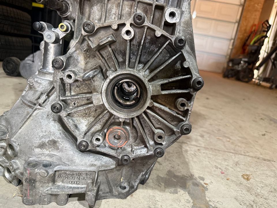

01E with axle flange removed
Looking down the speedo hole of the 01E. you can see it is not threaded. You will need to drill and tap it to screw in the female cable fitting.

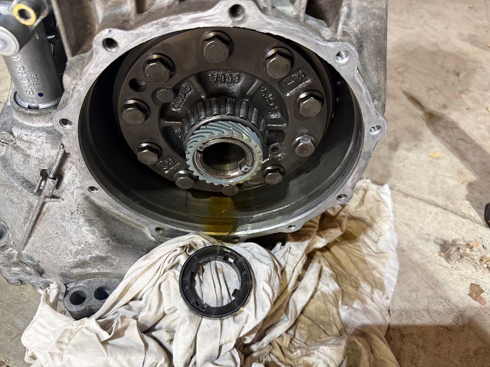

urq unit with axle flange removed (this will be the same as the B2 016 as well)
Looking down at the speedo gear
This is what needs adapted to the 01E
The gear you need sitting in its home in the urq unit with the axle flange seal removed.
Gear installed in the 01E
Male gear sitting in its new home
Ready to go
