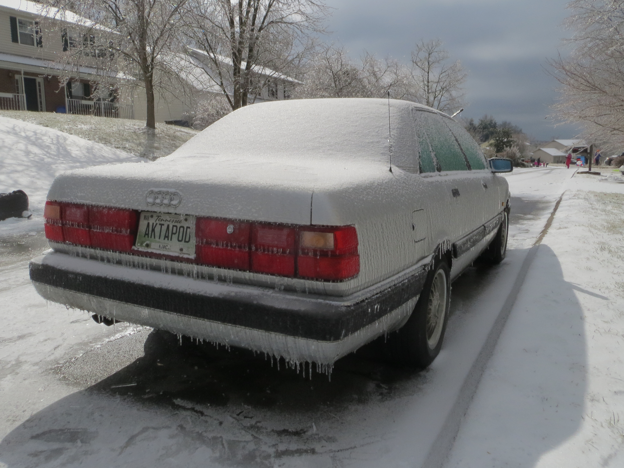

Awesome shot!
You have more snow in Tennessee than we do in Edmonton! LOL!

^Haha, that's crazy! We get about one good snow a year, and it took some serious willpower not to go play with the car!
