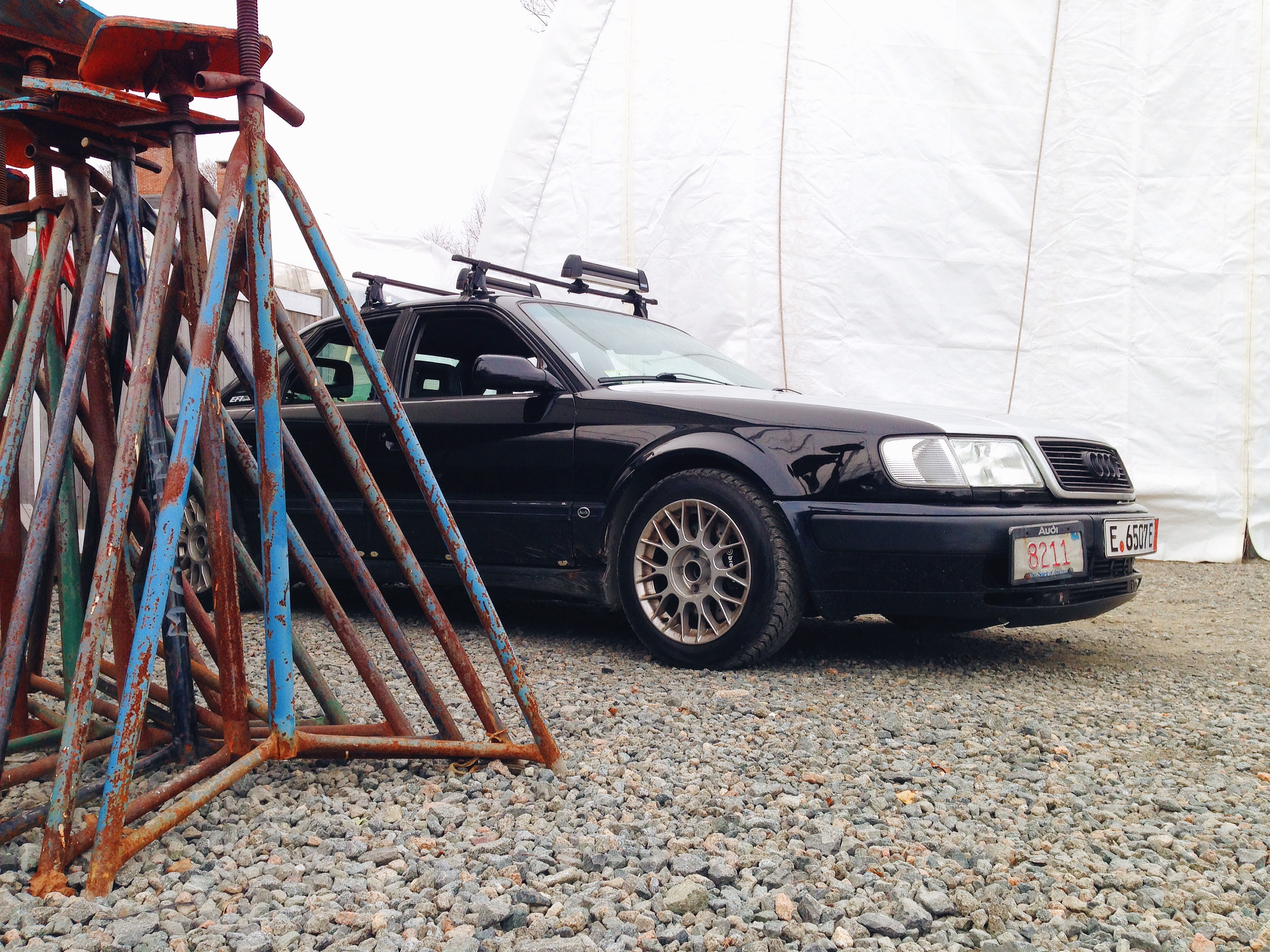

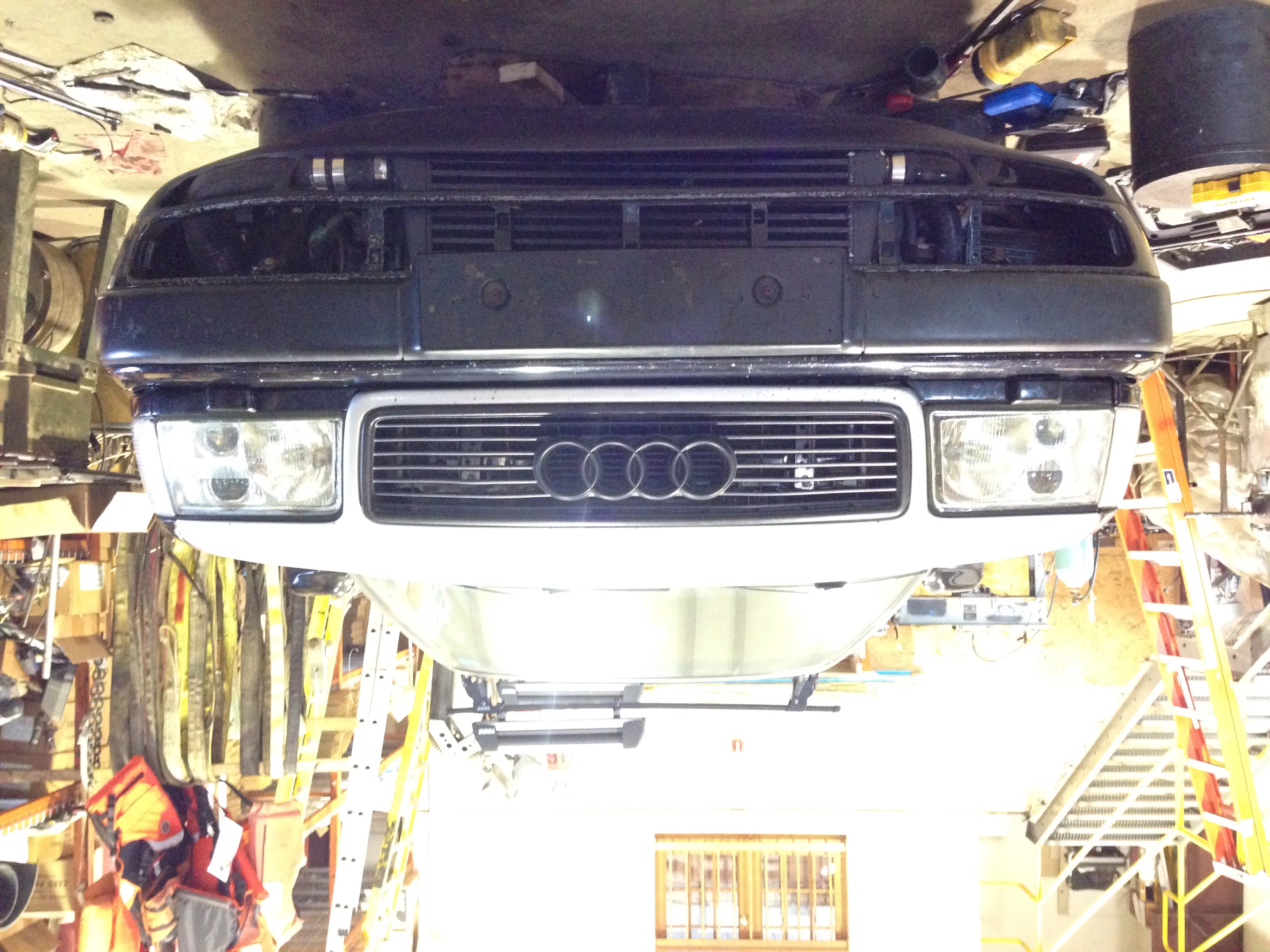

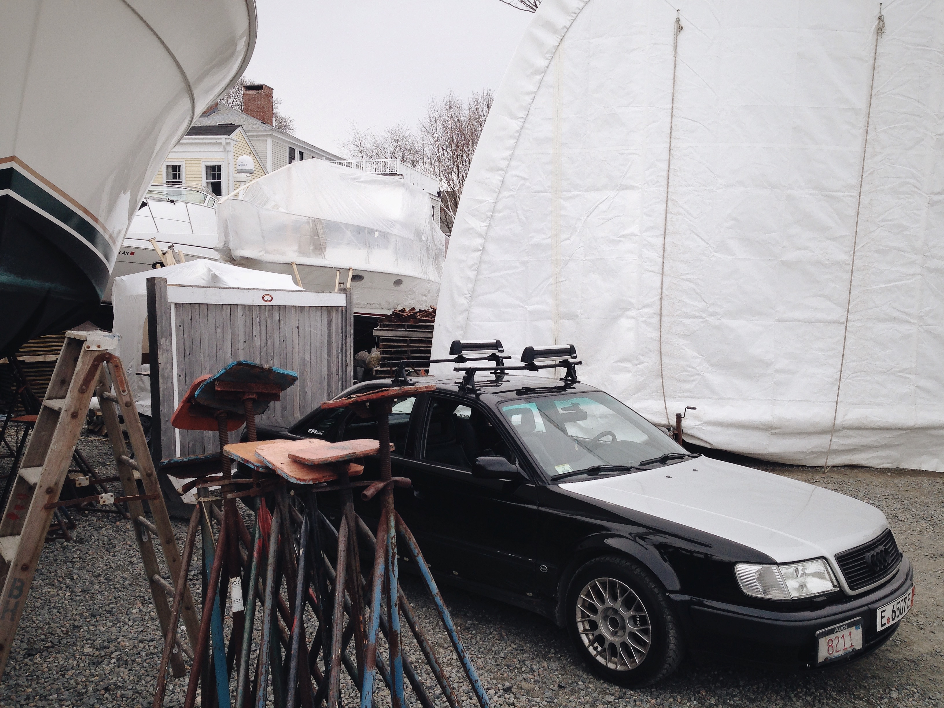

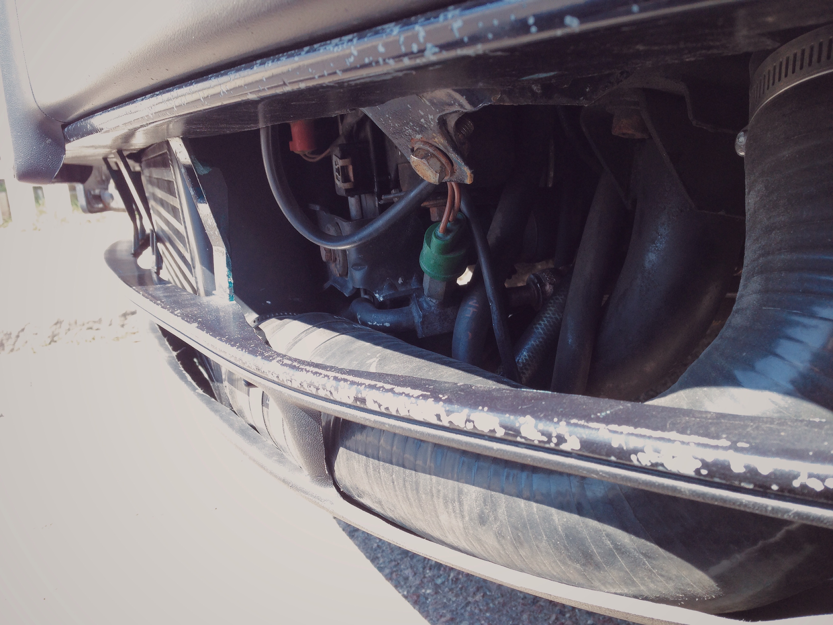

Re: Matt's billet HX40 Super URS4: Moving On To Bigger...
Post by lucidmatt »
So I've had the nostalgic pleasure of actually driving my old girl without fear of death, and I've been loving it. I finally got around to taking some photos of how she sits and exactly how tight the squeeze is to fit that FMIC. Drivability is comfortable but firm. Still some bottoming out "issues" that I put into quotes because its mainly because the roads here are unforgivably horrible. The car is pulling super strong, no more CEL's, 25 PSI all day. She is running well, handling well, and has me feeling as good as she has since I bought her. That is why I feel it is a perfect time to step away from the automotive projects to focus on something bigger.... literally. It's in the background of one of the photos below, wrapped up in plastic! (Maybe I'll start a separate project thread for it:hide: )
