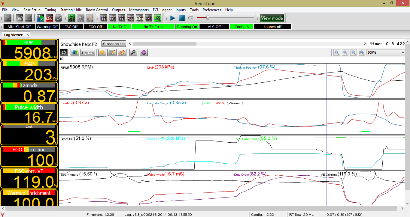

Also, your boost is dropping off so much at high RPM because the boost refDC and boost vs RPM are set that way. The reason someone has set it that way is because of your stock injectors. You can see they are at 85% duty cycle already! Still, you can squeeze more out of them until about 5500 RPM. You should be able to hold 20 psi until then at least.
When you're working on these kinds of issues, put boost DC and boost target in your graph so you can see what they are doing. See attached. Also, PID boost control will really help keep the boost up in the higher RPM when you get this sorted out a bit more.
Finally, you don't have to post a log and a config. The config is already contained in the log file.
If it were me and I was trying to diagnose boost, I'd set boost vs TPS to 100% everywhere and same with boost refDC at 800 RPM (it can't hurt). You should see 100% duty cycle as soon as you go 100% on TPS regardless of other conditions. Your spool will surely improve. Your fuel looks OK. If you do a full pull I'd be happy to try and help clean it up. It's been a long time since I've tuned on VEMS so I'm getting back in the groove here
- vemstunescreen.PNG (159.5 KiB) Viewed 45787 times

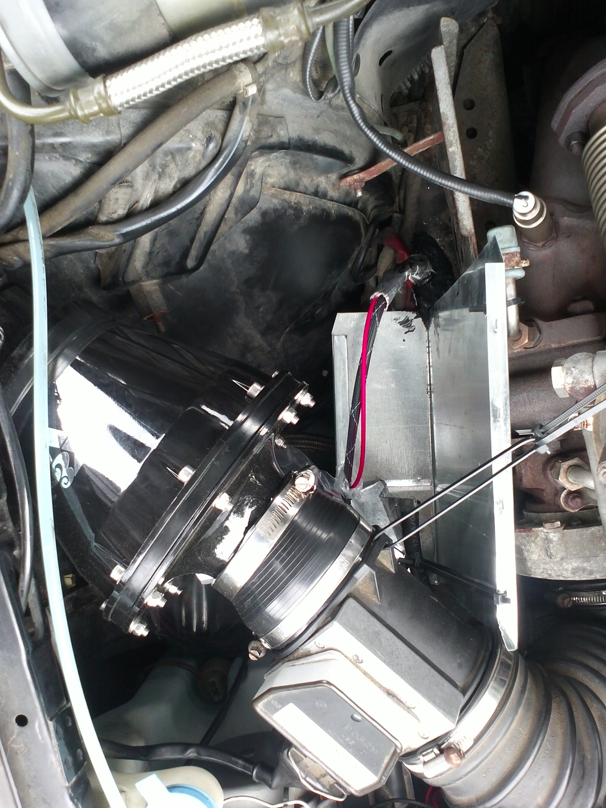

Here's the filter in question, its about 3/4" smaller diameter than stock turbo inlet hose. Its HP restricting on turbo cars somewhere below 400. If anyone else out there has VEMS tuned for the k24 please let me know! I since removed the crappy heat shield I made so that's not rattling. I really need help on my ignition table too. Thanks all
- IMG_20140719_115128.jpg (1.22 MiB) Viewed 45740 times
Easiest way to find out of its being a restriction is to just take it off! You wont hurt anything doing that. As ricer as it looks, I dont really believe it is restricting anything.
