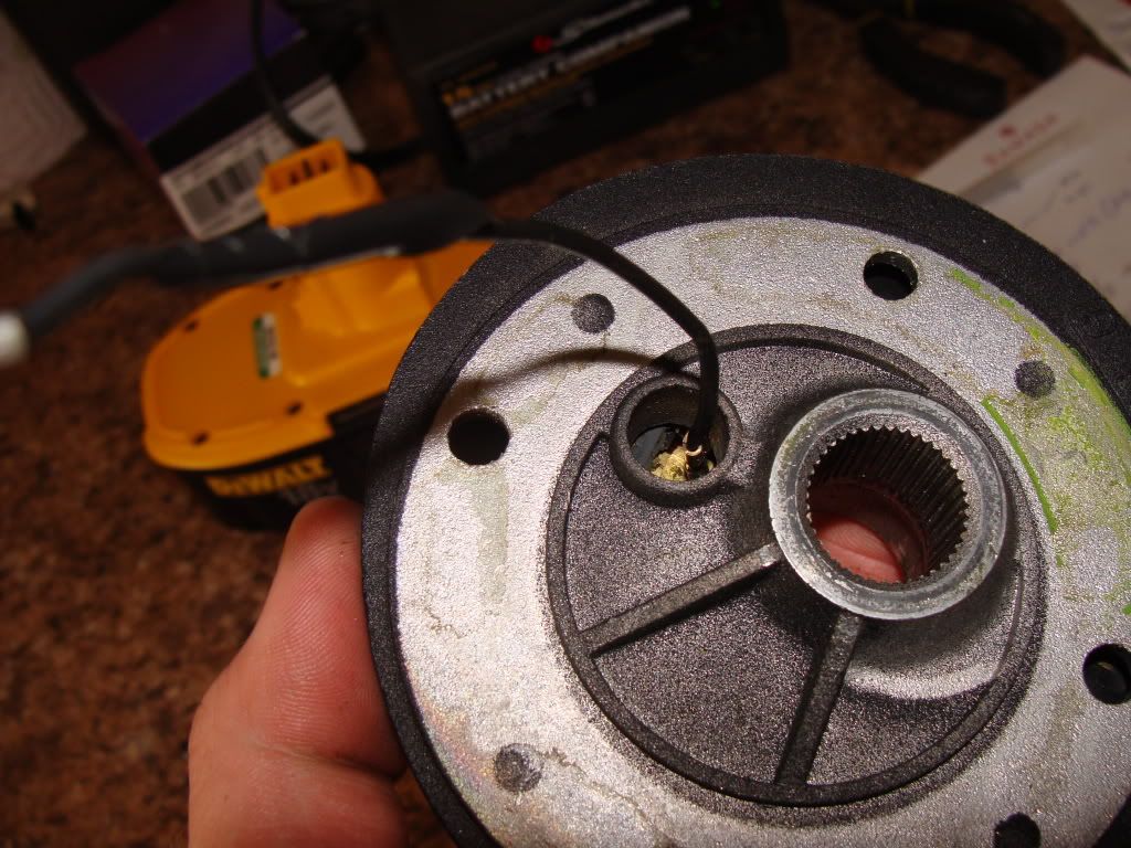

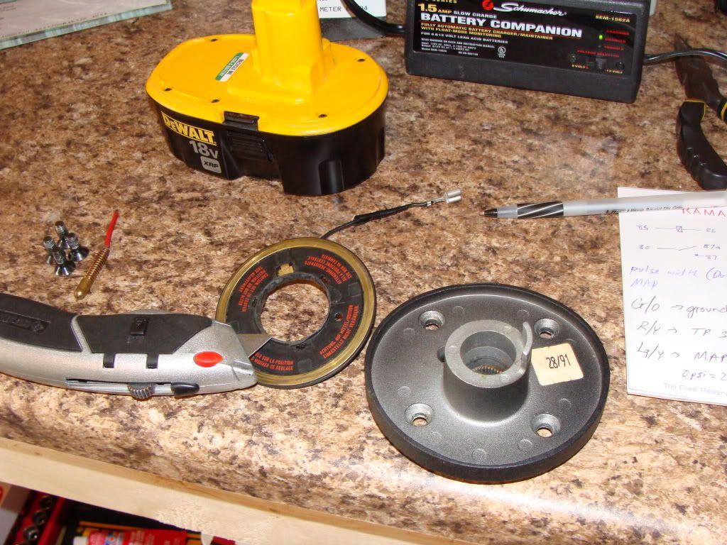

I finally got around to modifying the horn contact disk thing so that it would fit to the back of the Nardi wheel hub. While I was in there I discovered the fuse on the relay for the ABS was out so I replaced it and no more idiot light! Here's how the process went:

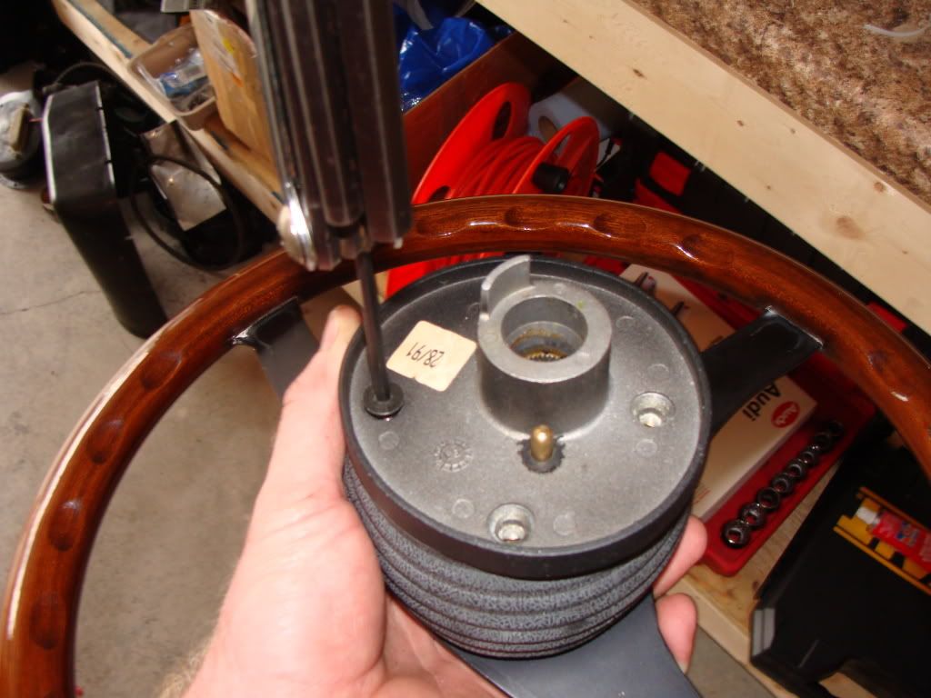

Removed the mounting plate from the rest of the hub to drill out the spring contact which made room for the lead wire from the contact disk to come through the hub..

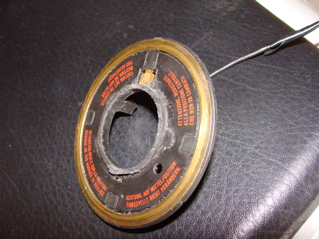

Cutting and shaping to fit around the hub..
And it fits well! The horn finally works!....only took me a year to get to it. No adhesives used, it was a snug enough fit to keep itself in place

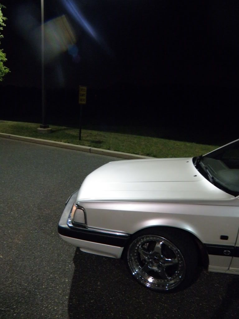

Not that making it onto audiworld is a big accomplishment, but it sure does make me feel good that they felt it was worth taking a picture of!
I definitely dropped the ball leaving the passenger side headlight trim drooping.... :roll:
