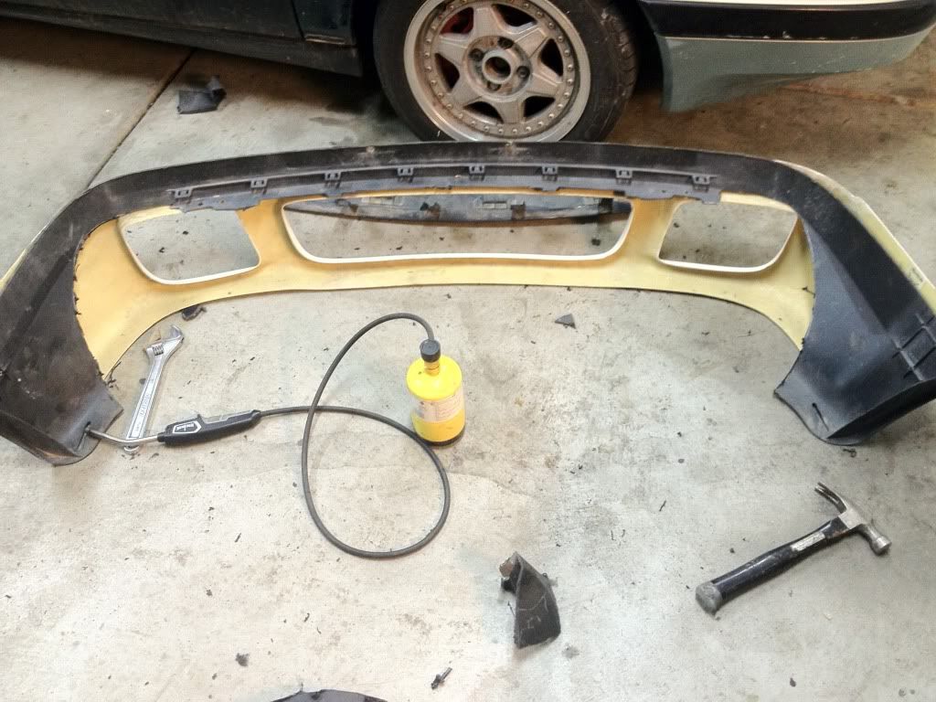

here are a few pics of how it's supposed to be done:
Attachment ( 30900 ) : ImageUploadedByTapatalk1337701002.798957.jpg
Attachment ( 30901 ) : ImageUploadedByTapatalk1337701019.193361.jpg

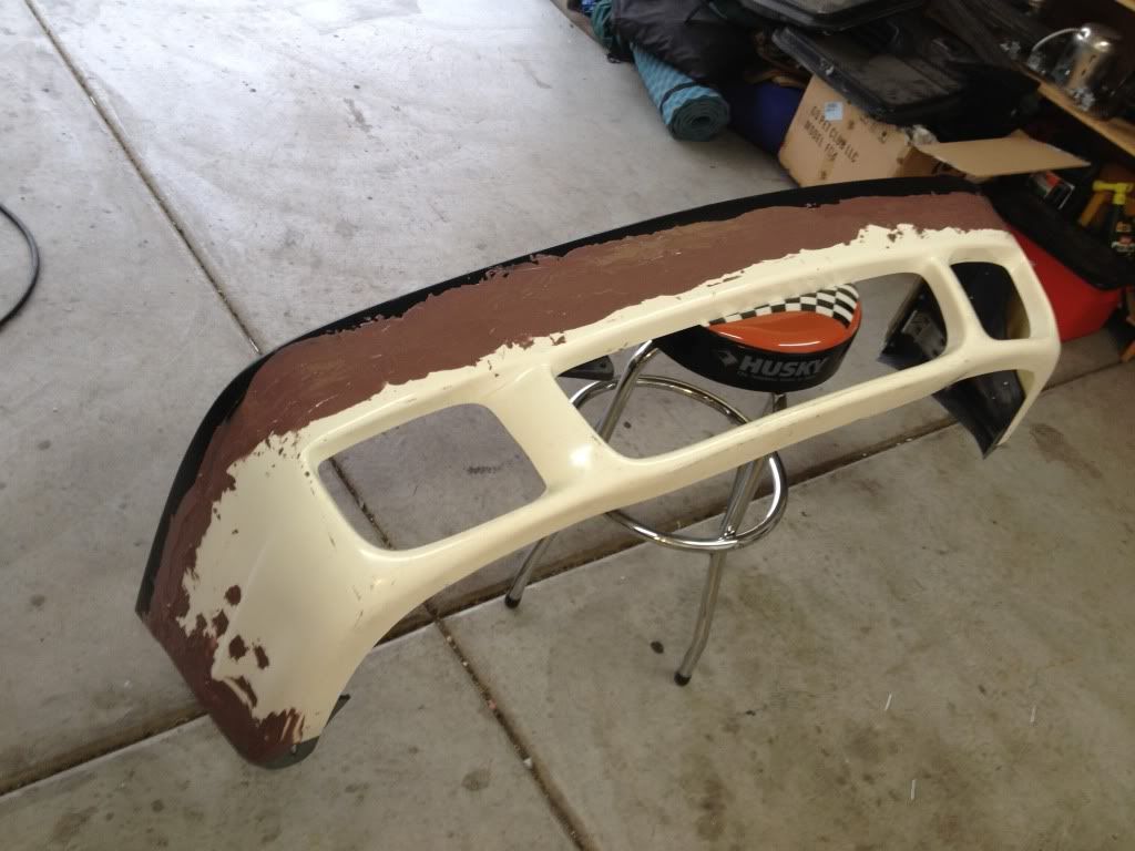

Had some time last night to demo fit with the bumper I previously ruined. It looks like things are going to work out fairly nicely. There will be quite a lot of filler and sanding to do but in the end I think it will be worth it. I'm hoping to start surgery on the actual bumper tonight but most likely it will be when my wife goes out of town for a week in July.

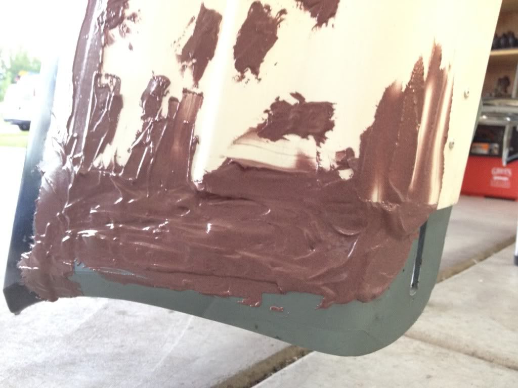

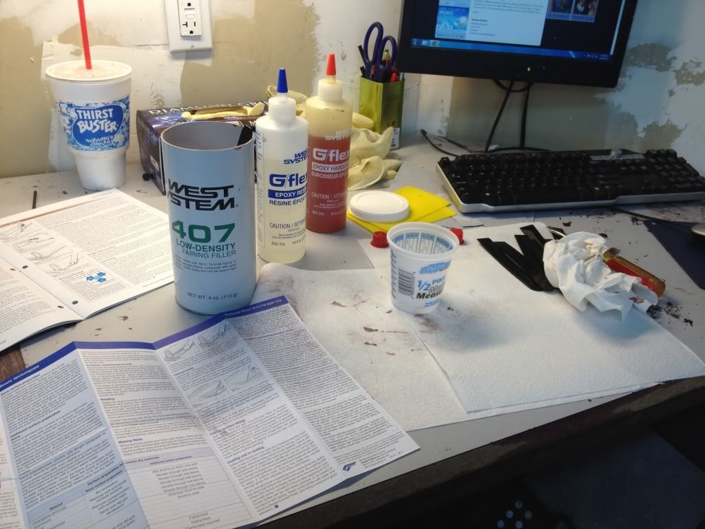

After some good talks with the folks at West System I have decided to go with their GFlex (http://www.westsystem.com/ss/g-flex-epoxy/) product to finish up the ends and fill the gap across the front. The reason for using that is because there is fibreglass and ABS to deal with. Having never done any fiberglass work I am will be doing a small test run to see how it works before doing the bumper. Wish me luck!

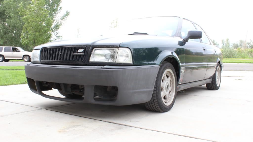

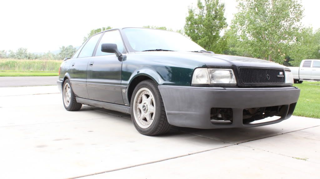

After selling our A4 and with the threat of rain today, the bumper got a few more rivets and off I went to work. Good thing is it's only a 6 mile drive and a few co-workers live in the same area so if it didn't make it I was covered. Seems to run good considering it sat for 8 or so months. I forgot how cool it sounds and wanted to just keep driving

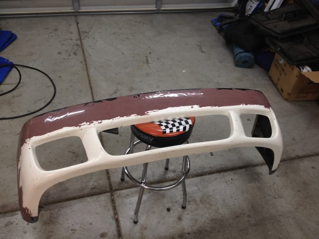

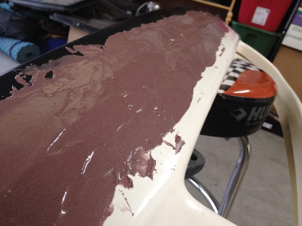

The G-Flex seems to be working nicely. I am only mixing about 50ml at a time and then letting it tack up before going over again. Hopefully I'll be able to get all the epoxy down tonight and then sand in the morning. And with a shred of luck, paint tomorrow night!

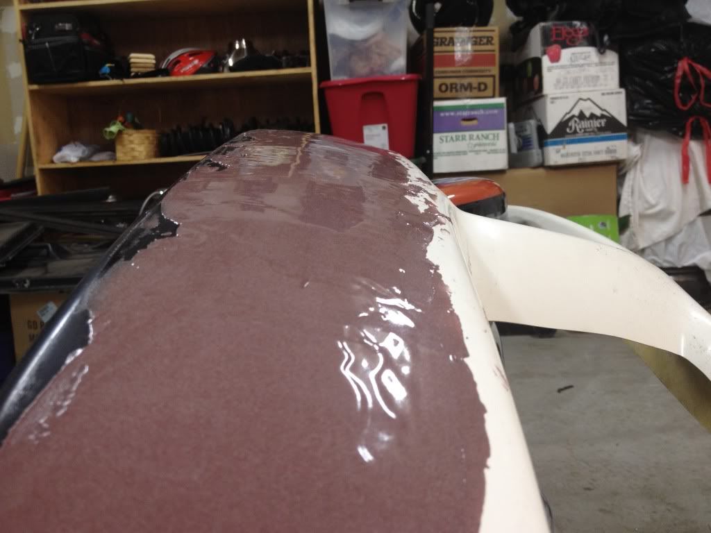

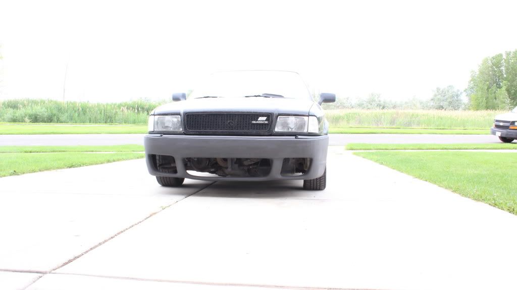

Finished (hopefully) with the epoxy coat. Tomorrow afternoon I should be good to sand it down and shape the two sides, which will be the most difficult part probably. Here are the end results of tonight's work:
Re: Nick's Black 90 - On the road again!

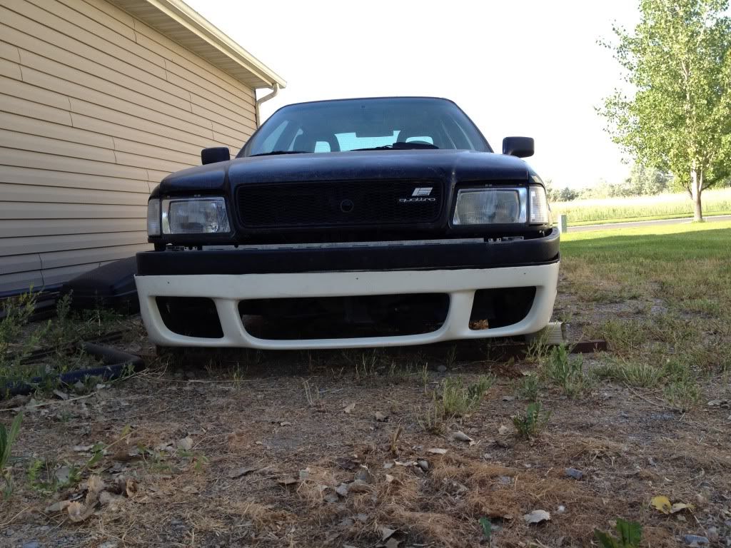

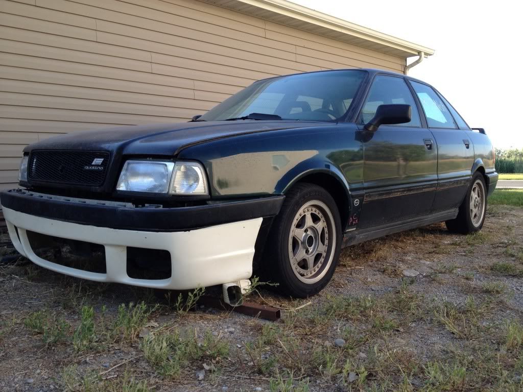

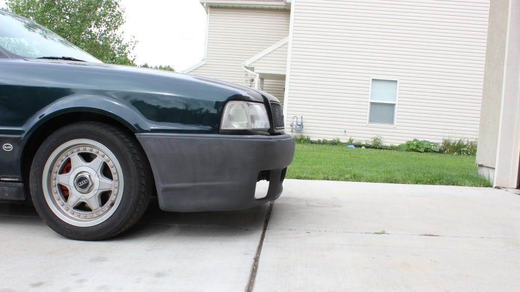

Got the first coat of primer on last night and couldn't wait to test fit to see how it looks! So far so good, I may do a bit of sanding on the pass side to even out the lip thing, but other than that it is what it is. It will look even better once the car is all one color and a certain set of 17's are installed
Having driven it already up to Salt Lake I found out quickly that the front is pretty low and things like speed bumps and angled entry ways are going to be a problem. And it's not even lowered! I guess that means bagging it is out of the question :wink: I guess if a set of coil overs makes it onto the car it will be still sitting at stock height. This has been a fun project to work on and I hope to get the rest of the body ready for vinyl. I would really like to at least get started on vinyl this week as I have all the time in the world between the hours of 17:00 - 08:00. I just wonder how Hank goes without sleep, how do you do that again??? Onto the pics:

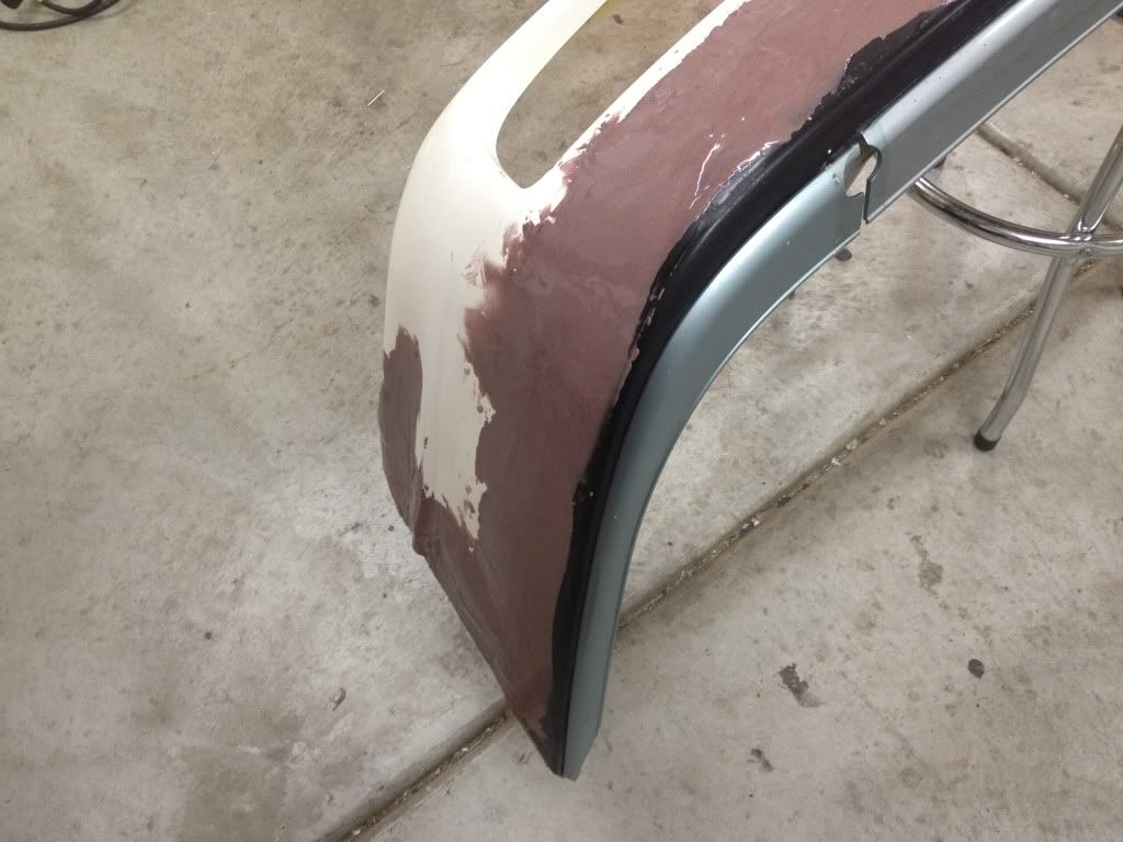

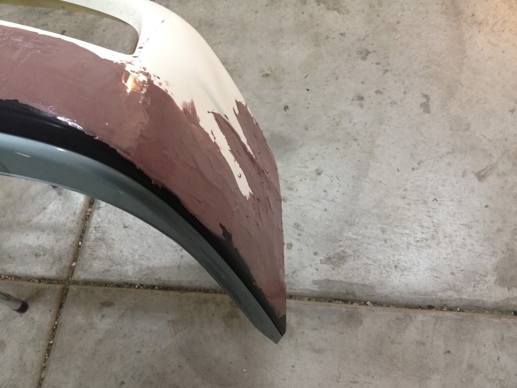

This one shows the lip that could use some sanding/shaping. This side I went a little overboard with the rivets which resulted in more build up of epoxy which then led to this. It doesn't look horrible, but does need a little love:

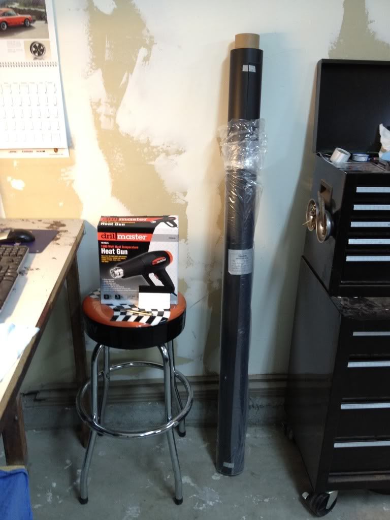

That there is a roll of 3m 1080 vinyl wrap that will be going on the 90 over the next few days
