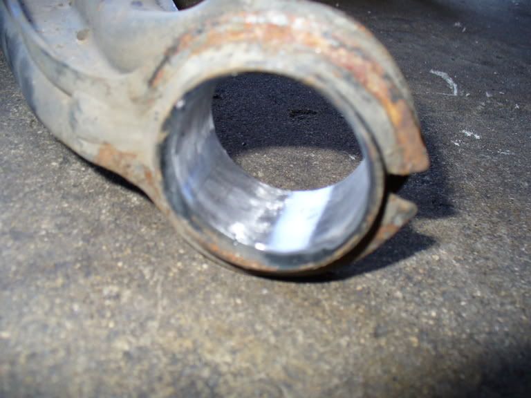

ok, now i don't know who at meyle thought they should call the new control arm bushings "improved" because as you can see in this pic....they aren't all that hot, and they are only one year old, never seen slicks or a race track. never any issues to wear them out except for hard driving, and even so, they still only have about 5-6k on them...

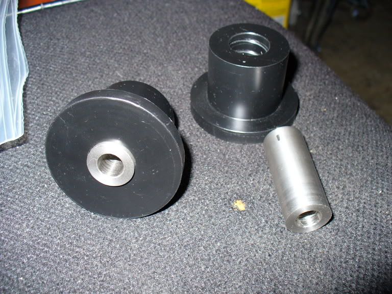

i installed a set of delrin bushings...
they've even got grease zerks to make lubing them a breeze :)

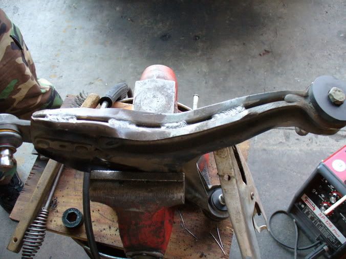

then i broke out the welder to try my skillz with the mig some more (this is like my third welding project so bear with me if they are terrible)

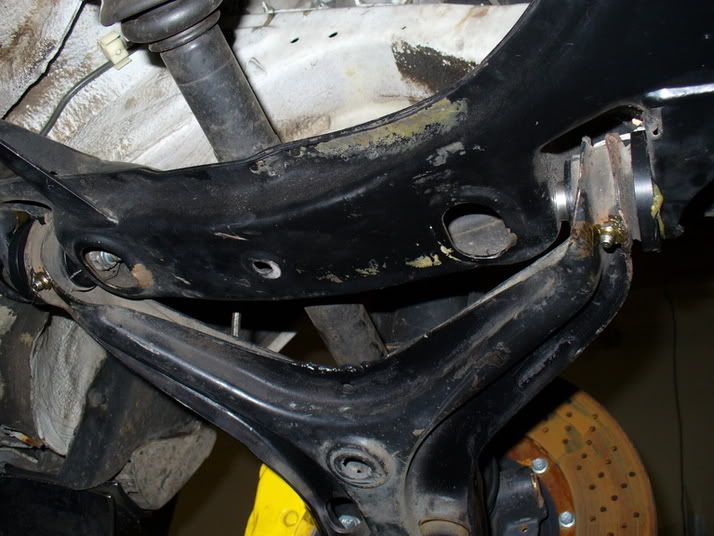

i also never had the proper pieces to install the poly front subframe bushings back in the summer when i did the whole suspension/brake upgrades, so i took care of that at this time as well.
so, that's it for now. i should be getting another set of delrins for the rear this week and i plan to install them and weld the rear control arms up as well in preparation for going out to thunderhill raceway this upcoming weekend.

Cool. Were the zerk (sp?) fittings your idea, or are the bushings designed to be greased?
derracuda
Post by derracuda »
they originally were my idea, but billzcat (who made em for me) changed the design a bit in making it have a spiralled groove to ensure more even dispersal of the grease, it works quite nice i must say :D

Delrin is supposed to be "self lubricating", but well, it still tends to "dry out" and needs greased from time to time to keep them quite.
