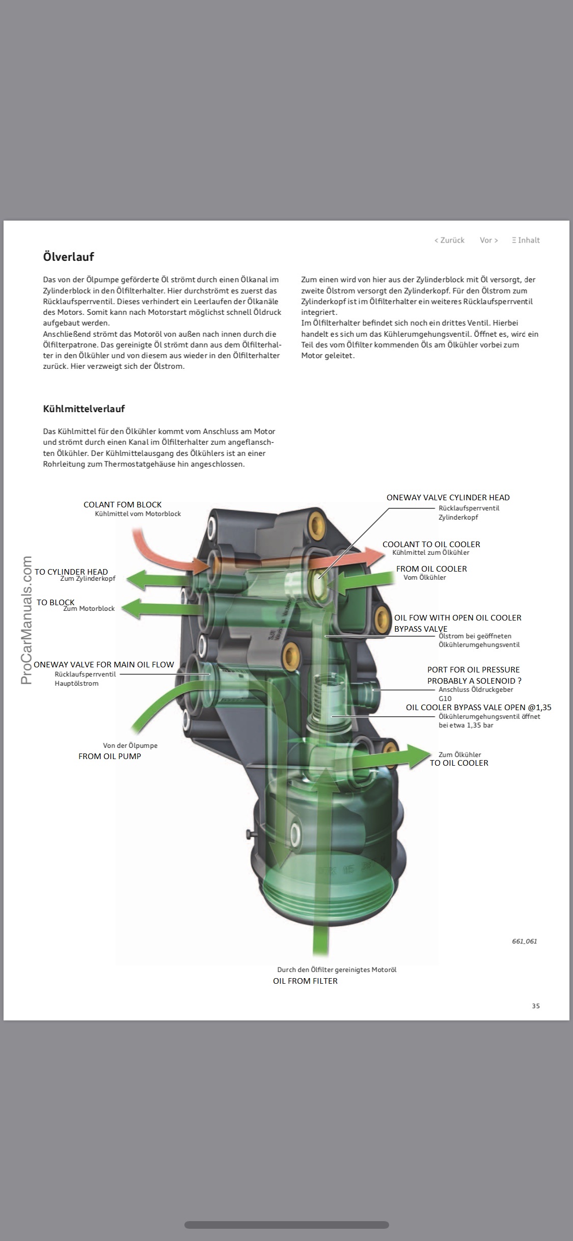

Sonofbitch I finally found it . I wasn’t totally wrong . So this is how the older version pump works I think it’s 05-07?
The mid pump really doesn’t look any different than the early but maybe I’ll take a look at one. and the late pump definitely won’t fit .

Re: The 90
Posted: Thu Sep 19, 2019 10:30 pm
by Einbilden
Hope this helps.
Re: The 90
Posted: Thu Sep 19, 2019 10:32 pm
by Afterthought
It does help , yeah . Thanks!
I was trying to use google translate .
So I don’t have any sort of check valve on the main oil supply like is shown there . I wonder if the filter due to its location way above the pan would drain down then ? Or maybe most filters already have internal check valve I guess
Re: The 90
Posted: Sat Sep 21, 2019 10:03 am
by audifreakjim
The filter should have a check valve, use a big TDI filter if you can. I always pre-lube mine with the accusump. The oil does drain down, but I think your adapter has the check valve in it, correct?
One thing Hank and I always bounced around was adding tension to the control pressure spring to increase oil pressure. I'm going to add a port of some sort of port to the oil pan if I ever have this think apart again. Basically a way to access a preload screw added to the control pressure spring.
By the way, you will never see 3.7 bar at the port on the front of the head that most people tap into. I'm lucky to see 1.5 bar there when hot. Which also reminds me, I have been meaning to move the feed line to the turbo from there. It may be adding to the pressure drop, and I'd rather see a bit more pressure going to the turbo.
