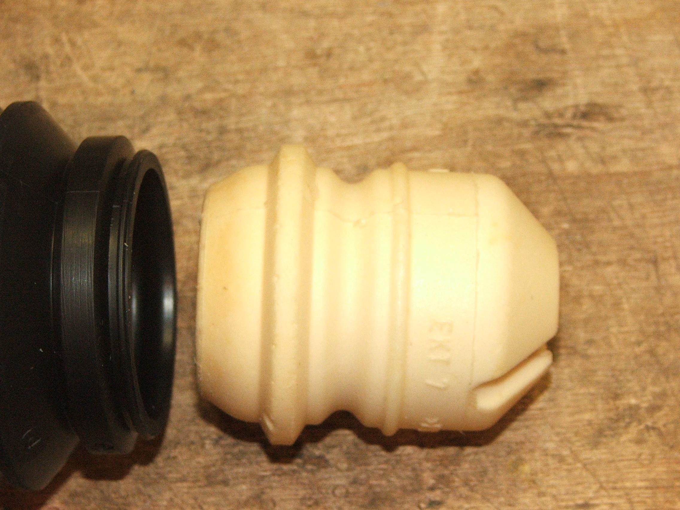

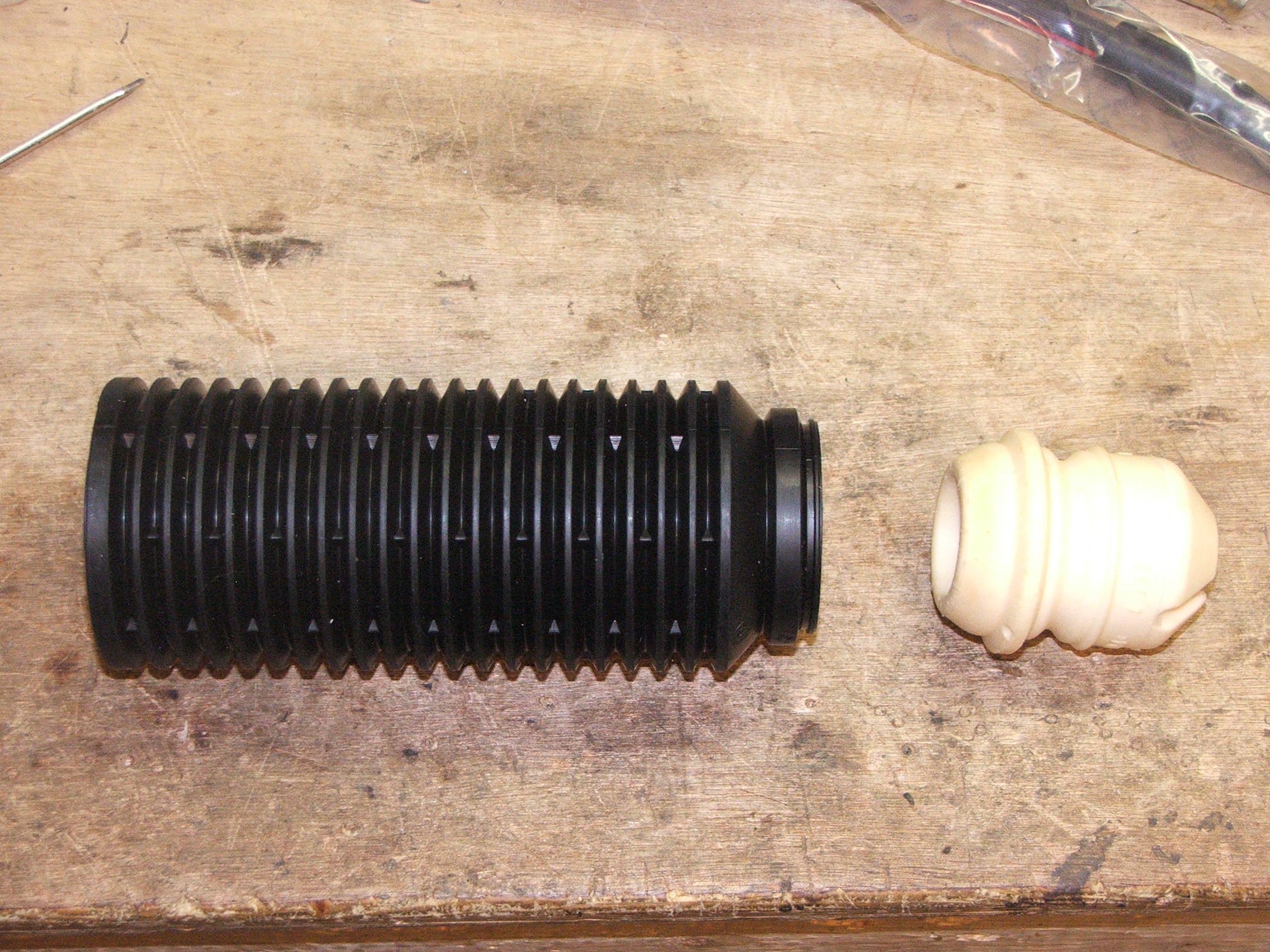

So... as previously discussed it's time to replace my front strut bump stops, and I've got my hands on a Sachs 900 002 kit which hopefully maybe might be the right thing. :?
The last kit I used had dust covers that looked kind of upside-down plastic Dixie cups and it was fairly clear how they attached to the bump stops (the covers had a lip that sat in a groove in the bump stops).
With these... it's not so obvious. I actually ordered some other parts (FEQ that I decided were junk and don't want to put on the car) that have a bellows that apparently covers the entire bump stop. But I'm not sure these are supposed to be set up that way.
Does anyone know for sure?
Since the car is lowered (not a lot... 3/4" or so) I'm debating cutting a bit off the bump stops and putting the bellows in the highest possible position. But before I do things "wrong", I'd like to know what the right way is!

That looks just like the kYB ones I picked up for mine before I went with the bilsteins. You will want the bellow as high as you can get it, so the bumper will be down in the blow. You should also have 2 different types. The one you have there, and the ones you described as the upside down Dixie cup. I don't remember off hand which is front or rear.
And yes, you should cut some off due to being lowered. With being down about 3/4", I think you need to ahorten them by about 1/2".
