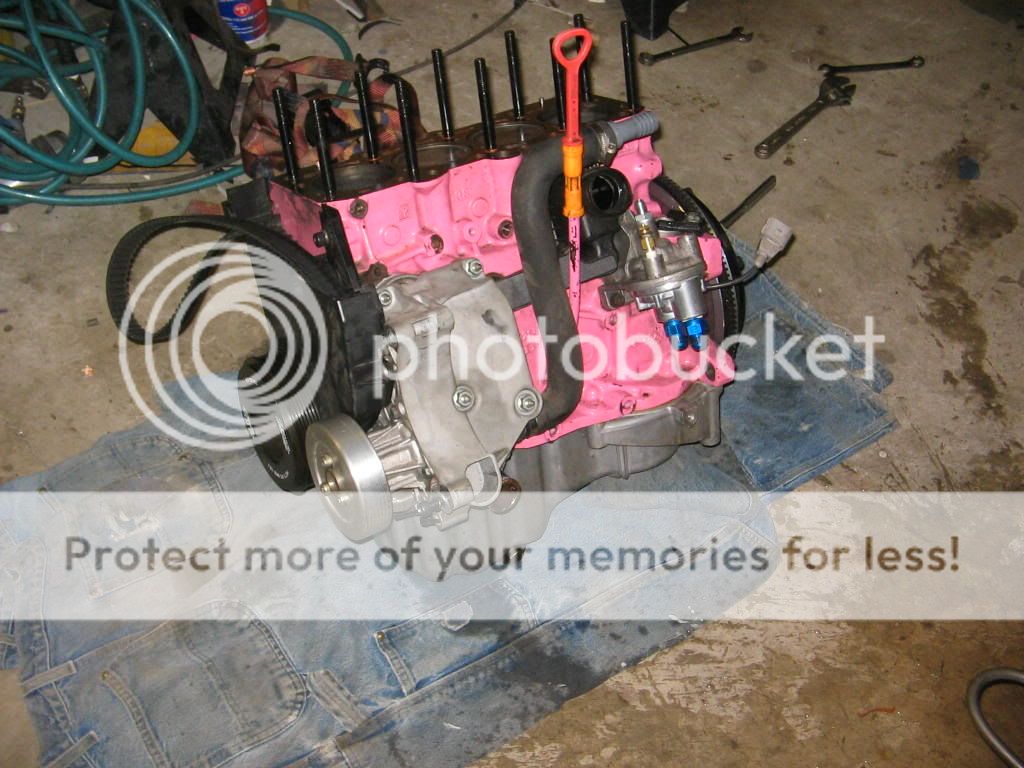

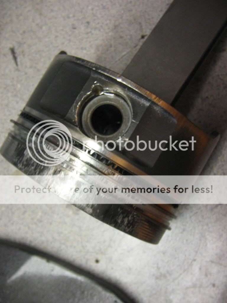

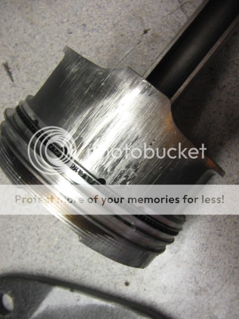

so i got to the bottom of it, sort of.
#3 wrist pin is snapped in half. bushing is toast. skirt is scarred up some on the piston. cant get broken pin out of piston?
