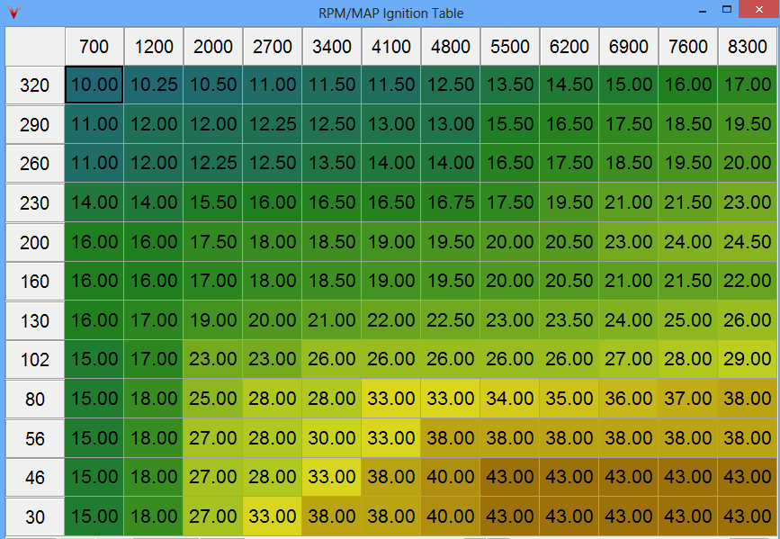

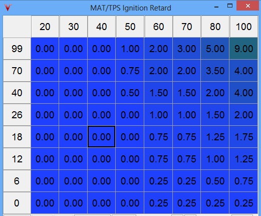

I'll post a screen of my timing map. It's NOT aggressive. Here's the thing.. my MAT IGN timing retard table was pulling 6+ degrees out. AND I had removed two degrees from Marc's base. So we upped the timing table four degrees and fixed the timing pull. This yielded an approximate 6-10* (depending where) increase in timing, which made the dyno go WOO WOOOO
Re: 4 FOX SNAKES - 360whp@23psi
Okay, timing map and mat ign retard tables:
new mat timing pull.PNG (25.99 KiB) Viewed 26012 times
new timing table.PNG (74.29 KiB) Viewed 26012 times
I need to email Marc about the MAT sensor discrepancy. I might try the 1.8t one that dad had in his car and see if it's any better. Also, from looking at the logs, MAT was 73 on the dyno, and 53 on the street. Need more fans Brady! :D

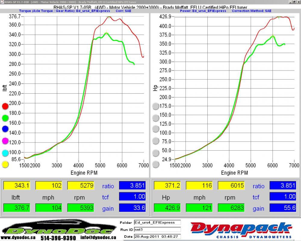

I think I can pretty safely up the boost... Martin emailed me asking why my torque was so low. Probably not in the greatest spot on the efficiency map at 23psi for one thing. I think with a PSI or two I'd start seeing some pretty healthy gains. Anyway, I'm super happy, car is a 450+hp monster, party on Wayne! :drunk: :guns: :drive: :beer:

For comparison purposes, this is 28psi + meth on da fridge with 30R. Also on Brady's dyno.

Re: more fans :D , if the intercooler and intake were always cool or not hot to the touch, then WTF? 73C should be pretty warm.
I think we were on the right track that there is a sensor calibration curve issue (or maybe sensor ground).
