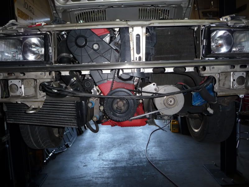

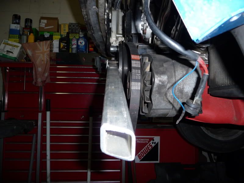

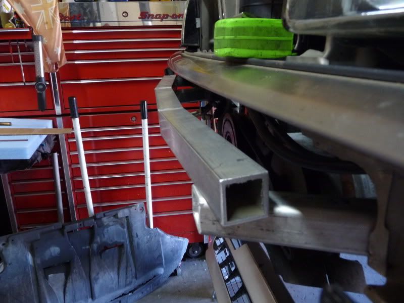

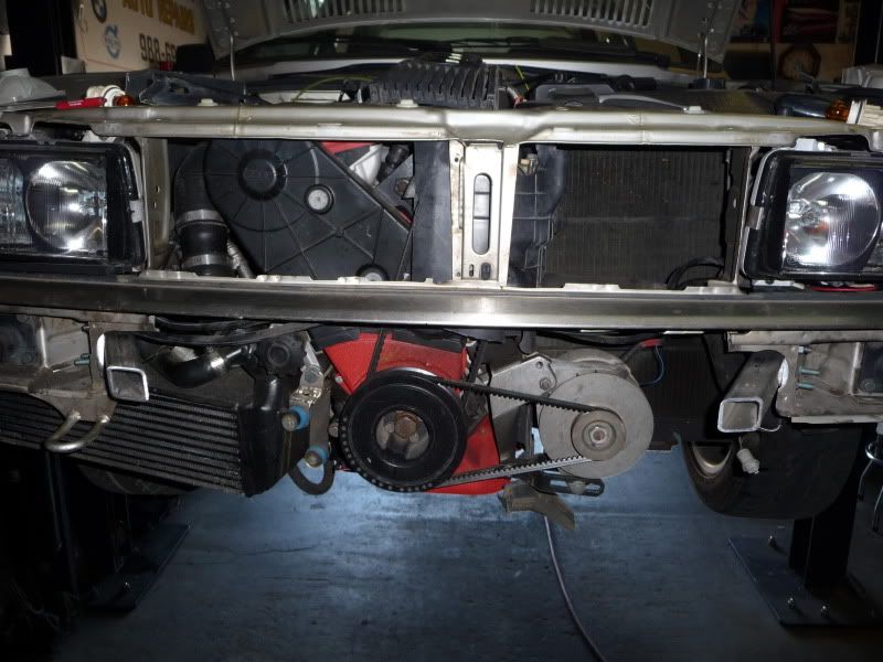

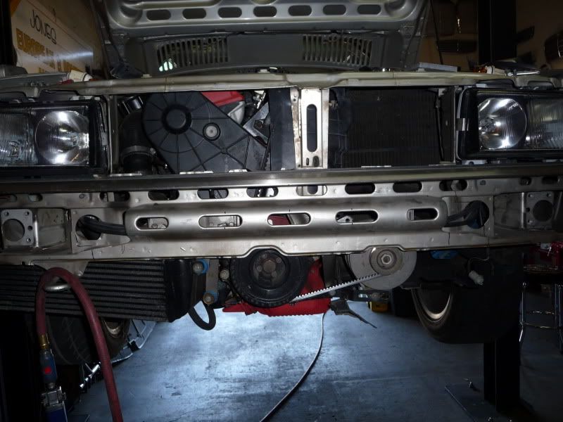

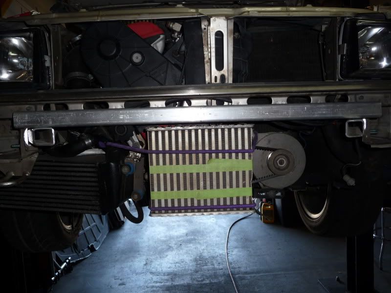

a little more IC update.

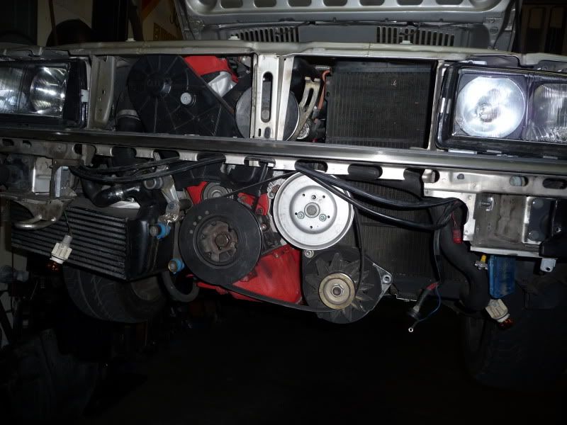

three things are happening here at the same time. i'm building a new intercooler, cross bar, and serpentine belt system for the PS and Alt. so that i have a little more clearance, and i have the old original PS mounting spot cleared up for my future intake manifold with the TB right there.
here we go again...

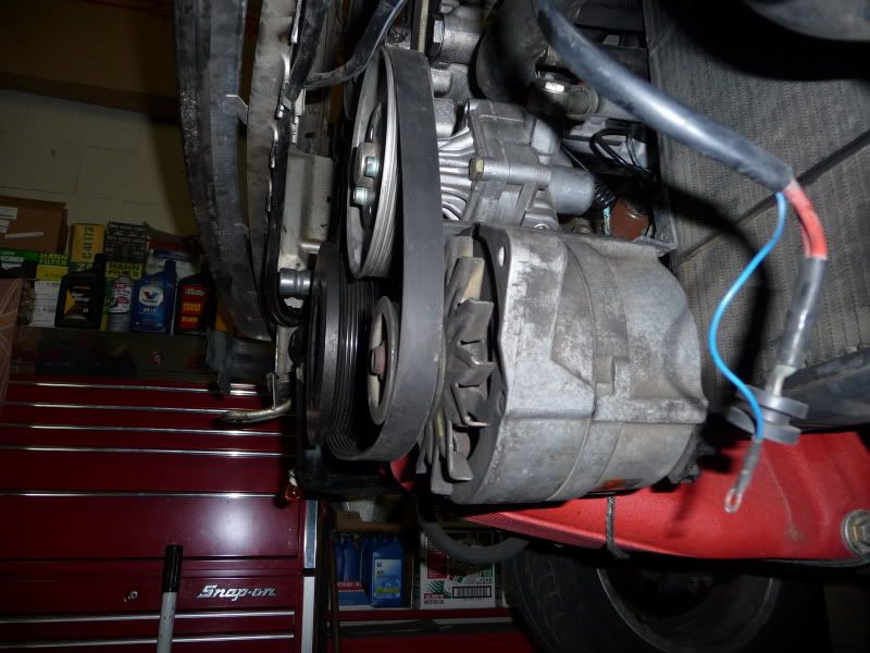

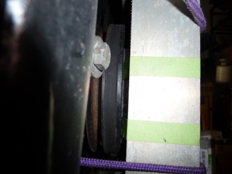

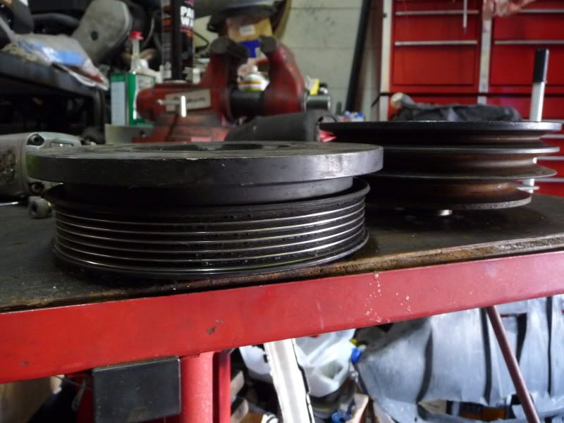

AAN vs. 3B pulley...

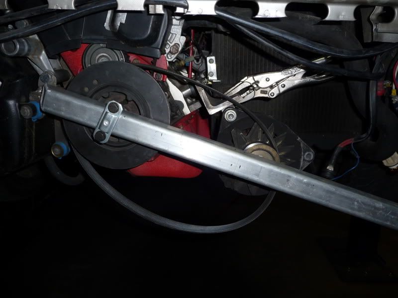

AAN alt. (the alu. bar is for checking the straightness of the alt mounting in relation to the crank pulley)

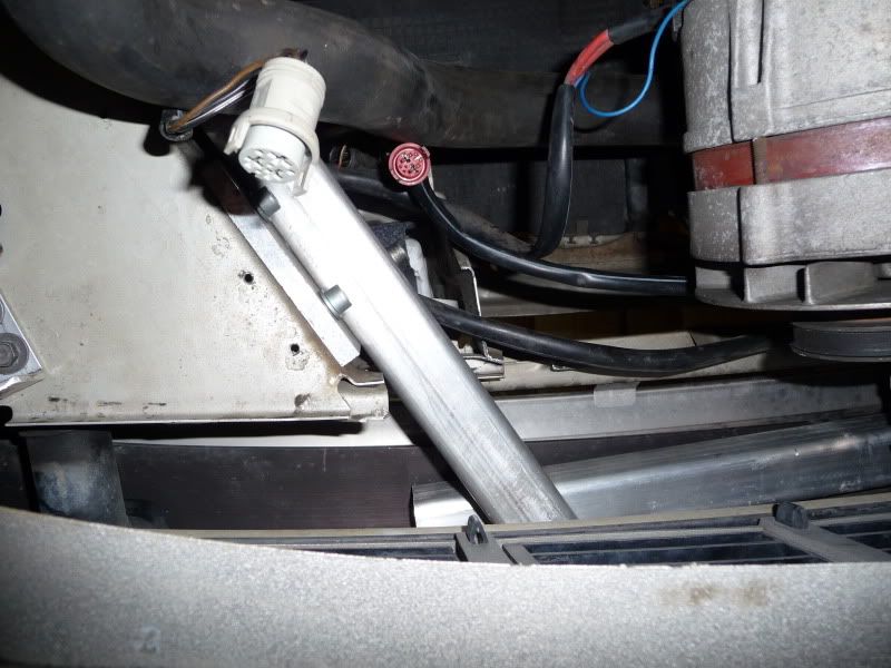

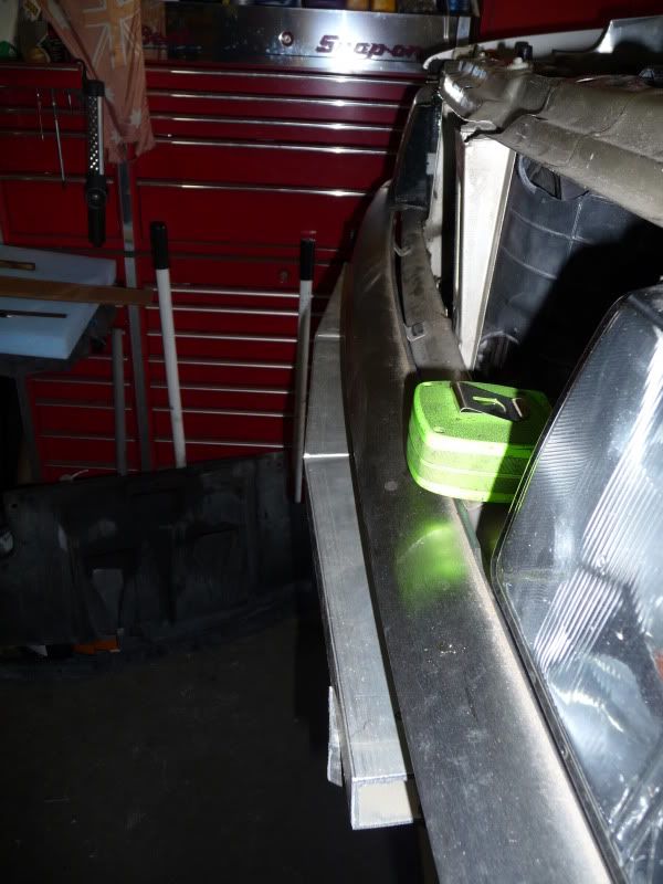

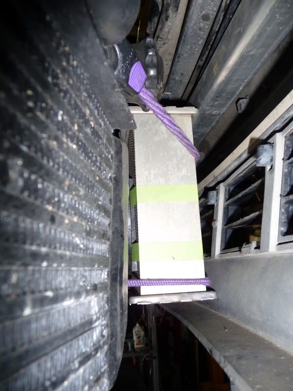

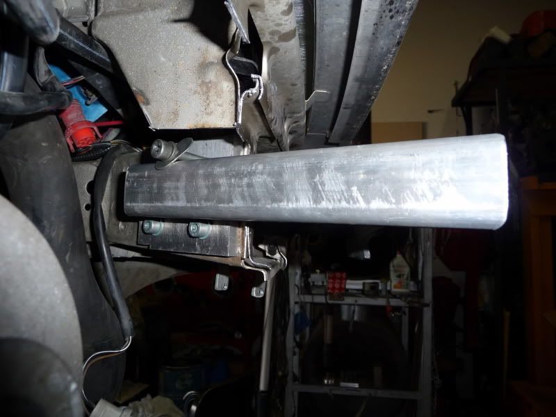

i have to finish mounting the PS pump, then i can set the IC in it's final resting place and then mount the cross bar as tight as possible. it's gonna be a tight fit!

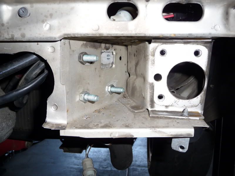

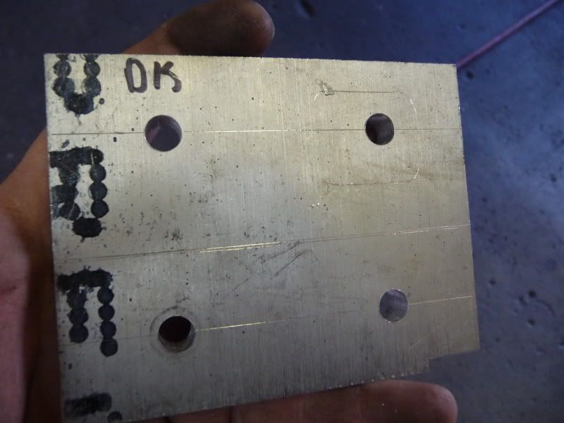

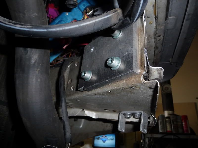

after some extra thinking about the snub mount, i think i figured out a trick way to build a nice new alu. snub mount 8)
that's it for now. hopefully more tomorrow night!

Nice work Derek!! I keep wondering what I'm going to do once I get the Urq's basic body work done as far as the I/C, A/C, alt, etc. What are you going to do for end caps? You may be engaged, but it's obvious you aren't done building. I like it.
derracuda
Post by derracuda »

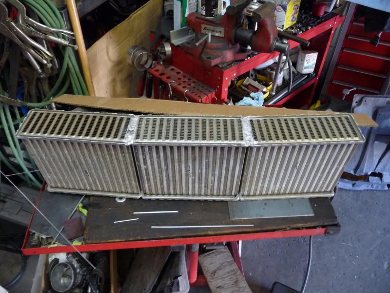

the end tanks will just be 3" tube.
3" tubes? so liek a 3 into 1 manifold design? or what im not quite following?
derracuda
Post by derracuda »
no, a single 3" tube, cut in half, then welded to the top and bottom of the IC.
ah ahha ok sweet, you think that it will flow enough to the sides jsut via the pressure difference? dont you think it should taper a bit towards the sides?
derracuda
Post by derracuda »
most OEM IC cores have the same size tanks all the way along the core surface, and on both sides, i don't see how it will make a big difference here.
but arent you going 3 times wider?

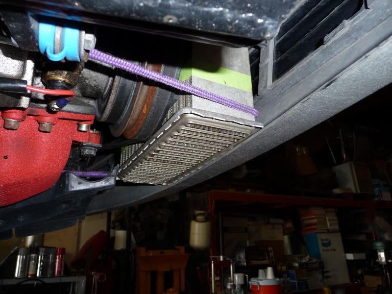

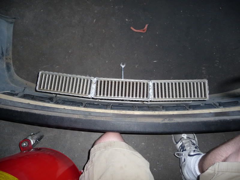

I like the idea of more intercooler, but I have to bring up the question. With things so close how are you going to get good pass through. You can throw TONS of air at something but if there is no good pass through the air will not efficiently go through to cool.

this might be silly math, but each of these cores is designed for 160hp(iirc) for a factory saab 900 from the late 80's. those cars, just as a 5kt, can be tweaked to 200hp or above with increases in boost, on the stock IC. i ran two of these cores on my old 20vt setup, and the IC temps were solid with a k24 at 15psi, even in warm weather. i don't feel it ever was a restriction to that engine and turbo setup.
granted i am now going to be running a bigger turbo and pushing a good deal more air, i don't think i was at the limits of my old IC setup, the new turbo will be more efficient at higher boost, and one more core will add some extra "new" surface area. i've ridden in a few 20vt's that have giant FMIC's, and they don't seem to suffer from having long tubes which create drag and pressure drop, so i'm not terrribly worried about this setup.
also, i had been toying around with some interesting end tank ideas, but we'll see what the finished product reveals 8)

I don't think it takes a massive core to avoid pressure drop, at least with a halfass'd decent core like those Saab ones. Looking at Bell's site with their matrix of intercooler cores, you can flow 450hp+ with a pretty tiny core, especially when the core has a short length (measured along the direction of flow). Beyond that it's just a matter of how much thermal capacity you want--I'd say you should be pretty set with that setup d-man, just put some decent endtanks on it.

Sam, i didn't mean that a large core overall prevents pressure drop, i meant more short rows instead of less longer rows will help that aspect. i read somewhere awhile back that in most cases, 6" of row length is all that's needed, the charge air doesn't drop much in temperature very much beyond that. these saab cores are 8" in tube length, so i think it's right in the sweet spot for that. more rows just help with the overall unit being able to shed heat quicker and do it longer, which is what i'm after. i want to be able to track the car for 30minutes and not have IC heat issues.
