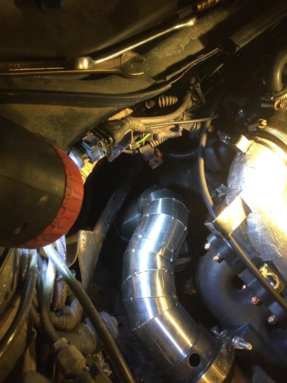

So dome of you may notice I have this hanging off the turbo and nothing else. It also has the o2 sensor in it. Driving yesterday, would the exhaust pulse be able to pull pure oxygen back in towards the sensor at idle causing my lambda to read full lean in vems? Car ran great despite this. Could see lambda dip to normal when on go pedal as well or revving.
Could easily be lean because it's breathing much better with the bigger turbine and no exhaust.
88a5tq
Posts: 1553
Post by 88a5tq »
Can't remember you being wrong yet :)
Think it's safe to wait until the welder finishes before tuning it? It's about 15 blocks away lol
If it's only at idle and cruising, then it's no problem at all.

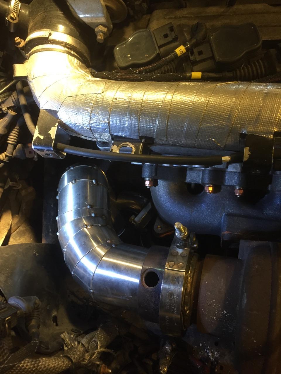

I grabbed the car away from the slow welder since he omitted info that he'd be down 2 mechanics over the next week so my DP would take forever to even get to. I took it to a pro being laid off from GE out here who will have it done by the weekend. No mandrel bending either. All angular cutting/splicing :) He will tie the WG exit back in as well.

Who's this guy think he is, ashing on my turbo?!
lol that's a lot of damned welding!
Well... I'd say this is a lot of welding:
Courtesy of the shop I want to do my exhaust when I get the Coupé going, Unobtanium Welding.
(Not to say I'm going to go full retard and get titanium. Yet.)

Yes I know, and will pay dearly for this :( It was my request though. I said "no mandrel bends"
Now I won't want to wrap it!
Lol holy sh!t that's much "worse" than mine!
