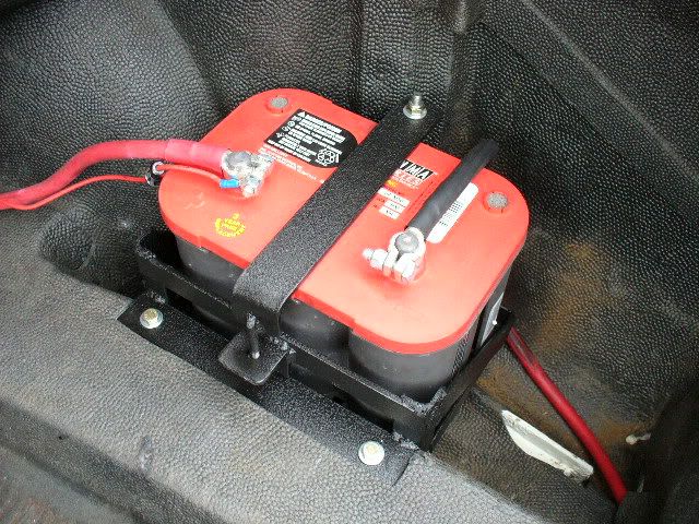

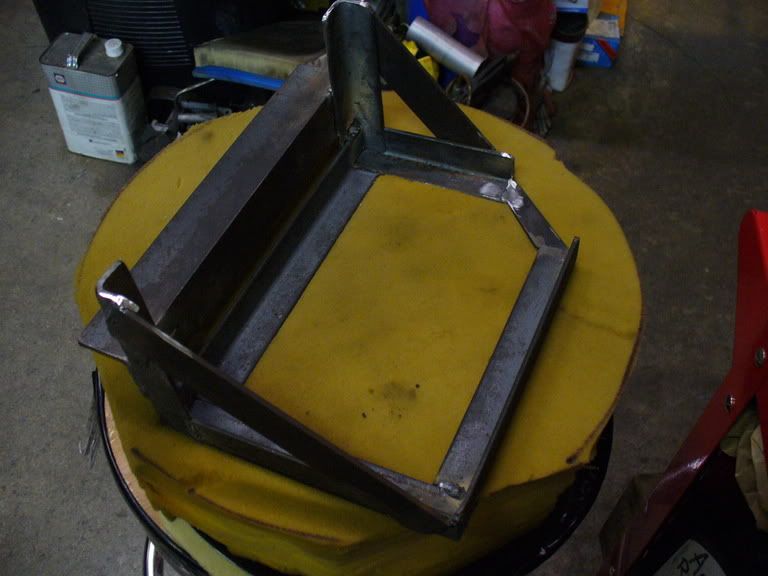

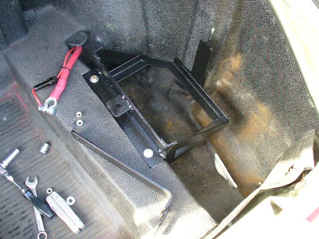

then i got on with building a new battery tray. all i had before was one of those crappy plastic battery boxes and the battery sorta slid around a bit. i still need to make the holding down portion and mount it up tomorrow, but then i'll be ready to go :)

today i finished up the battery tray, it turned out pretty sweet!

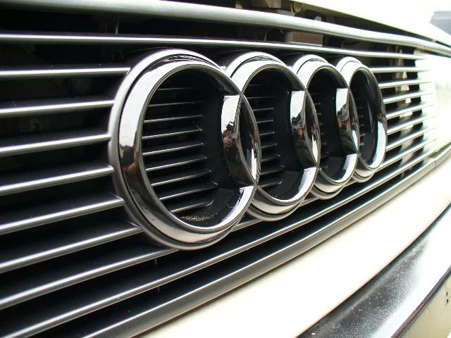

i also painted up the grille and rings. it was about time, plastic dressing just wasn't lasting anymore...
Nice job on the battery box. Looks good!
dets
Post by dets »
yea, 2nd the battery box. looks secure

Nice battery tray champ! :-)
derracuda
Post by derracuda »
that was the idear :) there's three bolts holding the bracket to the frame and the inside fender support so it won't wobble. i built it so i wounldn't have to do it ever again! HA :)

Nice work Derek... I think that battery tray will survive the apocolypse!

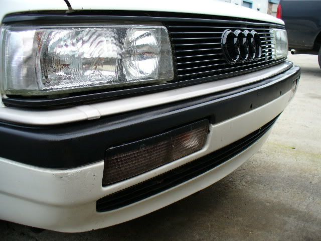

Love to see a wide shot of the front with everything blacked out...

i'll get some front pics here soon :wink: and the v8 swap is in the works. it's being put off for a couple of reasons...track event, ECU swap to Ib for the future owner of the engine, and it's hard to let go of a running car :P

Both pieces look awesome Derek, I'm really diggin the glossy black on the rings. Looks sweet!

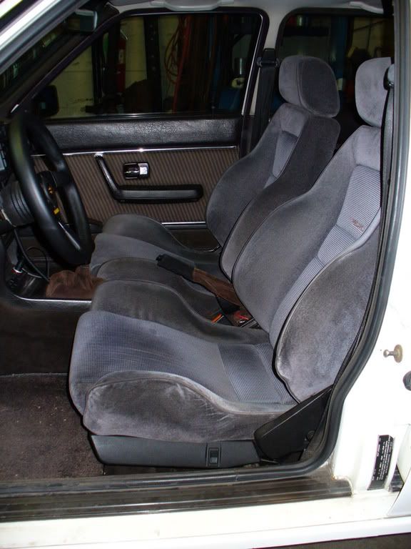

annnd to finish off this weeks upgrades.......*drum roll* the piece de' resistance! RECAROS from a jetta Gli
about one of the most comfortable seats i've EVER sat in, hugs me toight, supports my back properly, and only comes in the wrong color :( sokay though, i may have them recovered....haven't decided 100% yet.
