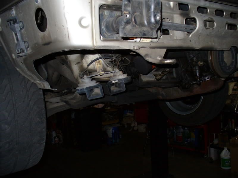

I figured they were plugs, but what are they exactly? Where did you get them? :-D
derracuda
Post by derracuda »
i got them from the drawer! haha, believe it or not, we have a section in one of the toolboxes here filled with all sorts of various plugs from parts we install on cars. no sense in throwing them away :) so... as to what they came from, i don't know.

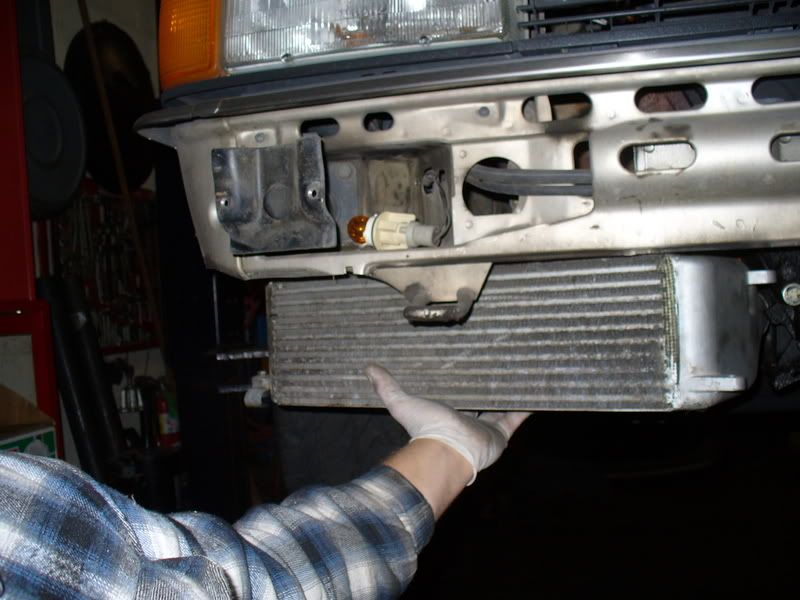

made a little progress last night in preparation for the 3B swap...
it's gonna be a tight squeeze, but it looks like the 951 IC i have will fit the bill perfectly and should be a very nice upgrade from a stock 200 20v IC.

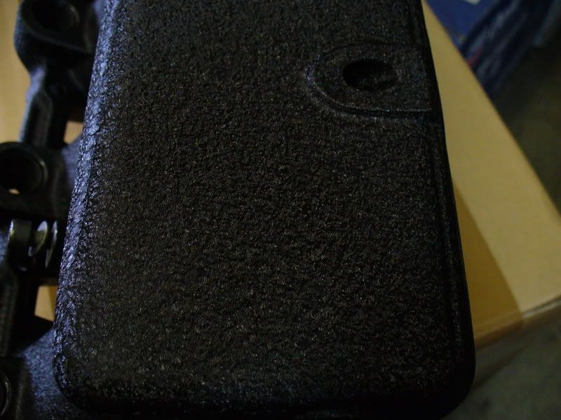

also finished up the IM
gotta love the wrinkle 8)
i :heart: the wrinkle

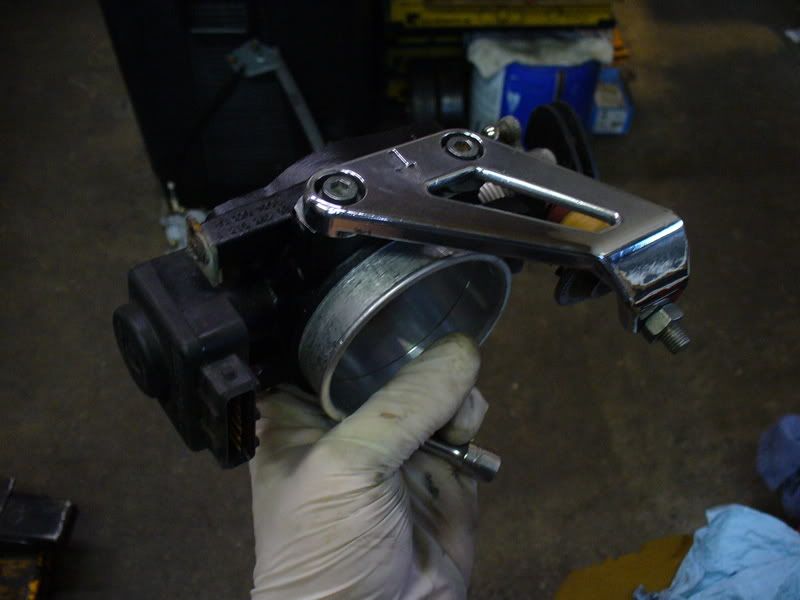

last night i dissassembled the throttle body, cleaned it inside and out, masked and then painted it black so it wouldn't stand out wierd on a black IM. i polished the little aluminum bracket on top too :)

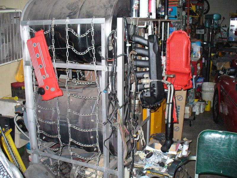

i also got my oilpan cleaned and painted last night.
all my painted bits so far curing up by the heater :)

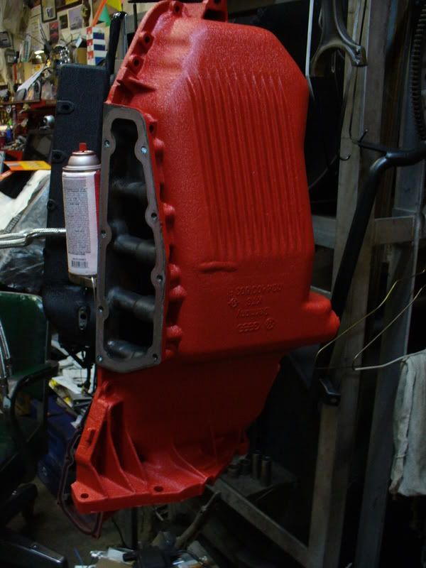

what are you using to paint those pieces? looks great
derracuda
Post by derracuda »
krylon wrinkle paint 8)

Do you clear coat the wrinkle paint at all? Do you use any primer? Very nice!
psychorallyfreak
Post by psychorallyfreak »
Now, myself, I would've polished that IM, but you're not me, so hey. That's gonna look menacing all put together!
derracuda
Post by derracuda »
nope! no clear. the wrinkle is kind of a delicate paint, if you put other paints and stuff over it, it turns out weird. and for the red, i didn't use a primer of any sort, just some light tack coats to make sure there weren't any fish eyes. if you go to the general forum section, there's a sticky on wrinkle painting right here....
http://www.motorgeek.com/phpBB2/viewtopic.php?t=4529
as for polishing the IM, i've seen it before, and while it's cool, it's a HUGE pain to do the whole thing nicely, and it takes upkeep. the paint is low maintainence and understated (cept for the red :P i know that).

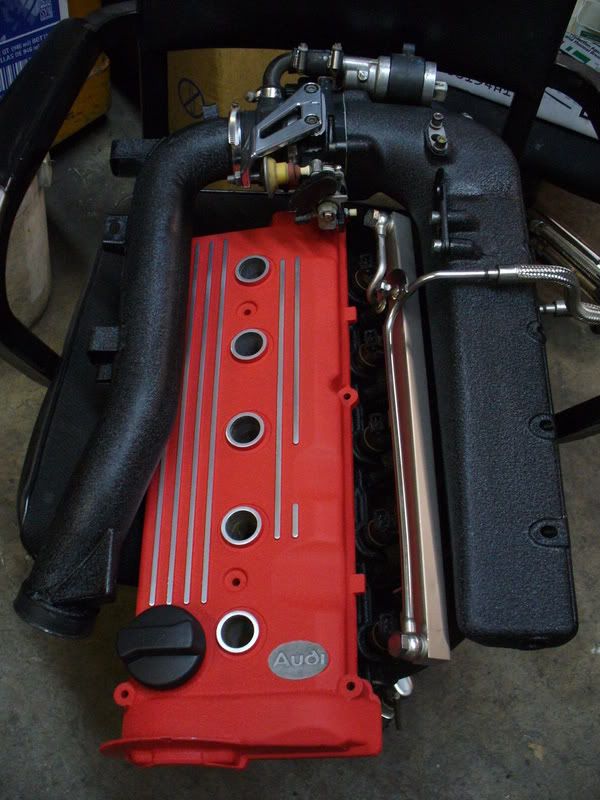

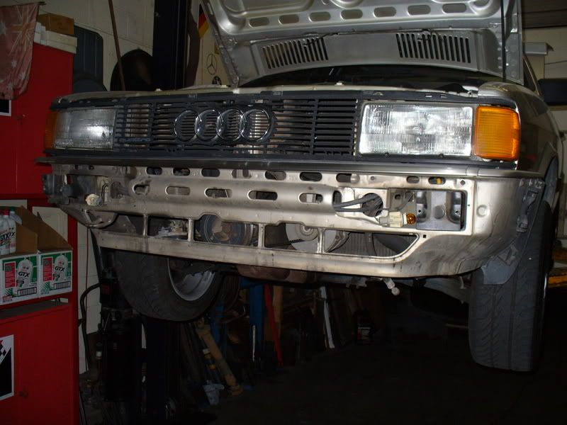

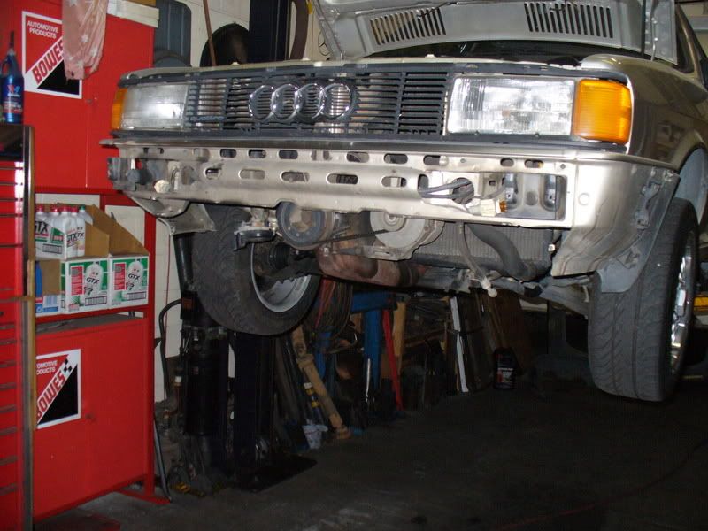

:drool: sorry guys, had to do a mock up shot, it's as close as i'm gonna get for a few weeks to the real thing :P
