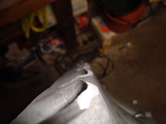

Zerb
Posts: 858
Post by Zerb »
got that box out of the car, lol

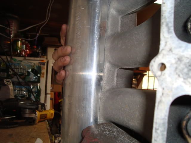

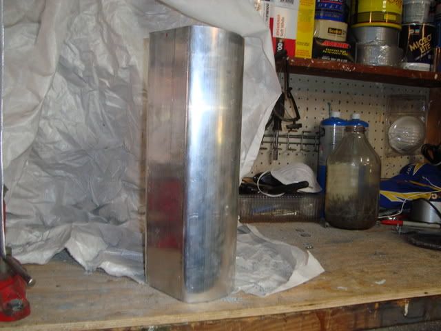

and started fabbing up my intake mani.
im not sure if this is the BEST way to do this or not, idk if there is even a better or not so good way to do this, but the most convienent way i saw was to just chop the stock plenum off and keep all the runners in one piece, then just chop the D plenum off at the bottom where the stock runners will go a tig away.
vagrant_mugen
Post by vagrant_mugen »
that is prob. the best way. it wont warp too badly and it'll ust be 2 nice seams to weld, make sure tey come out nice and you can just leave em.
looking good!
you gonna have an elbow between the plenum and the TB flange??

It looks nice man. I would just use the base of the stock manifold, and then cut your d-tube on the flat... Or you can ditch the d-tube and get ahold of some 4 inch 1/8" wall tube and just cut it to match the base of the plenum. That D-shape has 1/4" thick wall and that is overkill if you ask me. It looks like you have a lot of volume by the look of it, but actually the ID is only 3".
Either way, it looks like it will flow nicely!!!

Posts: 858
Post by Zerb »

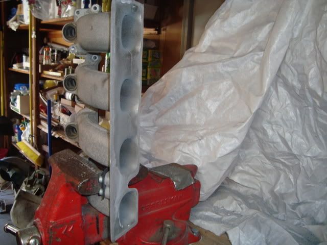

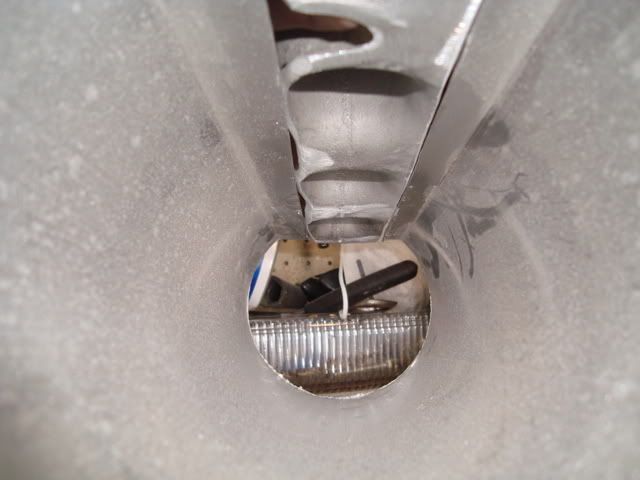

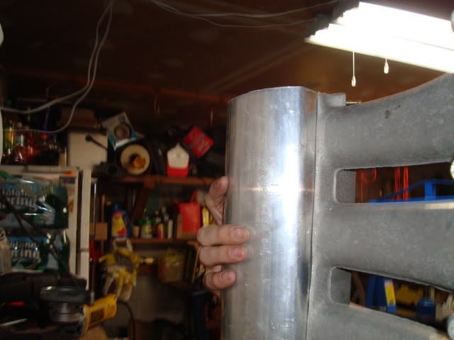

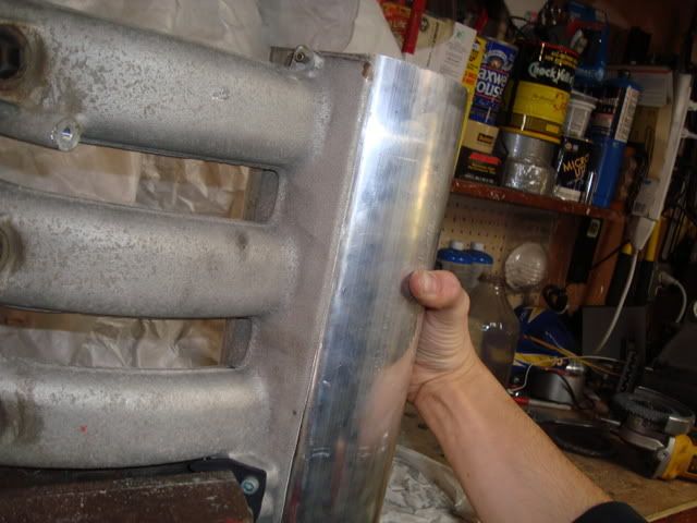

some new pics of how i ended up making the intake manifold. still need to get some more aluminum stock to make the section where the tb's going to go....but its getting there...
took a while but i angled the plenum one way, and the runner base plate another way, so that when the runners sit in the plenum they actually sit IN the plenum, and its a smooth-ish transition.
vagrant_mugen
looks good so far. youve got the idea.
will you be doing the welding?
