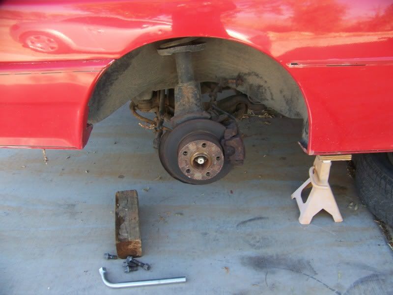

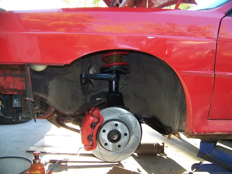

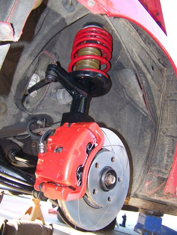

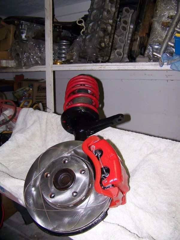

Time for a small update. I had a few days off this last weekend and begged off of a trip to Salt Lake to attend my 5yr old twin grandkid's birthday party to spend some quality wrench time on Her Urq. You would think that trying to make time for her car would score points.......NOT!! The quality wrench time turned out to be one of those one step forward two steps back kind of things, but my hands and back feel like I wrenched for a few days.

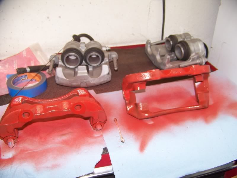

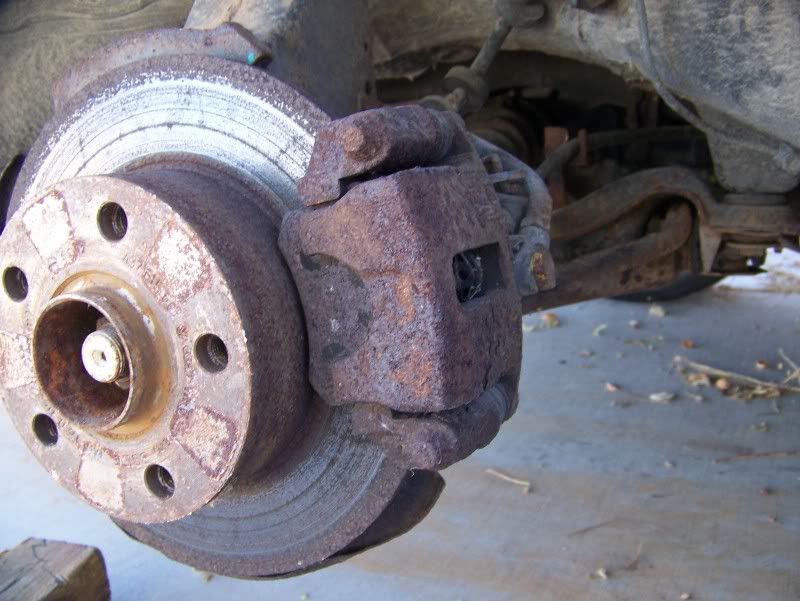

I decided that I needed to tackle the partially seized up brakes, both front and rear. They, like the rest of the car have been sitting for the last twenty years and before that spent the first 10 years in the Wisconsin roads. The calipers look like it along with control arms, sway bars, steering arms etc. I don't have enough time before the Oct. GTG to pull subframes, but wanted things cleaned up a bit and at least stop the rusting if possible.

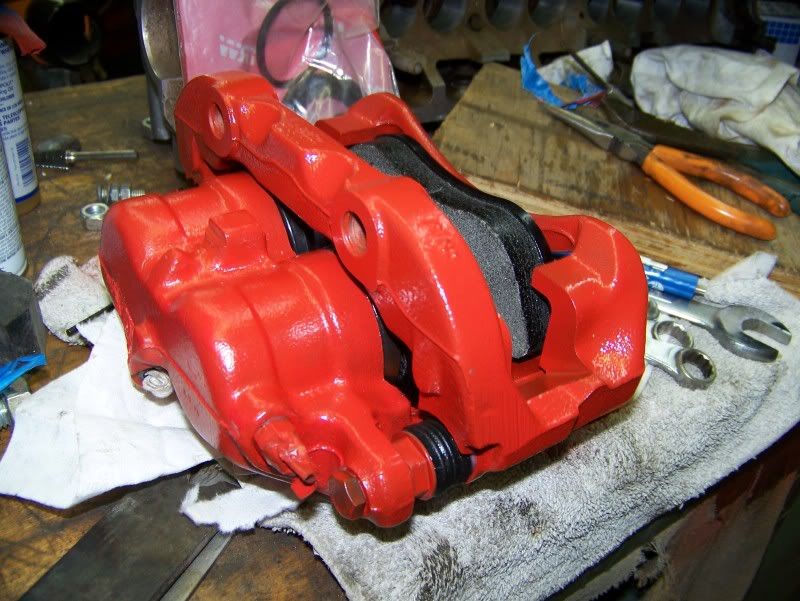

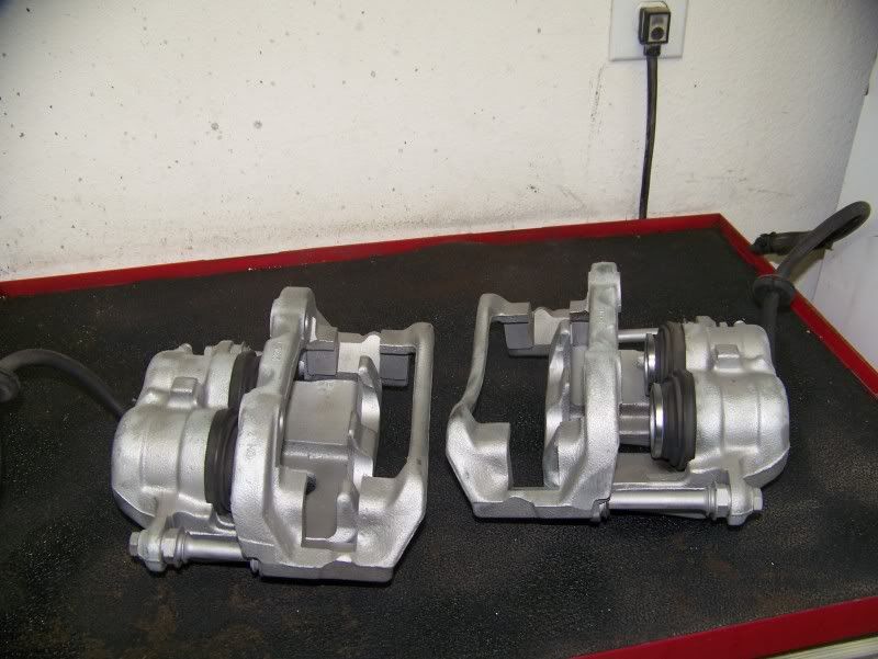

When Hank and Dave offered up Urs4 G60 front calipers and the slotted rears which are both bolt on upgrades I was more than happy to just ditch the original brakes. They were in pretty decent shape, but still had a few obvious miles on them and needed to be cleaned up.

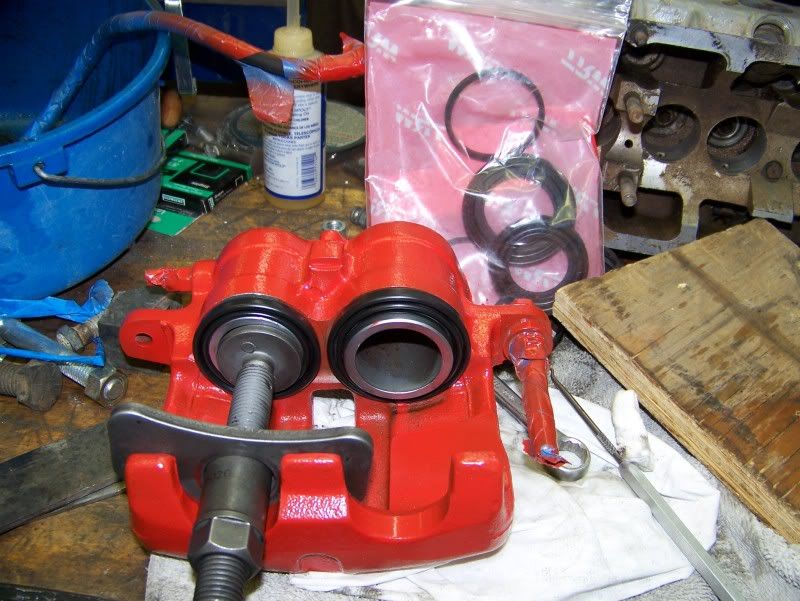

I first taped them up and hit them with the bead blaster figuring that I wanted to rebuild them anyway and any stray beads could get taken care of then.
I couldn't find a rebuild kit for the rears, but remembered that I had a brand new set in a box that had been intended for my Urq so I start searching, but in finding them I also find a couple of cans of Mars red touch up paint. I figured that it wouldn't take to long for raw cast iron to rust back up so.......yea you guessed it.
Painted and rebuilt with new pads.

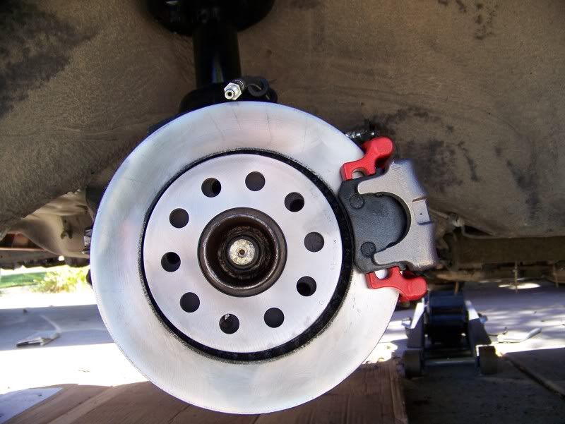

I also had a set of newish H&R lowering springs that were set up with brand new upgrade Spax dampers that were also on my Urq, but had got shelved in favor of coilovers. They just really seemed like the perfect upgrade for old wore out suspension on a stock Urq and I figured that with two Urqs I can't afford to pick and choose as much and needed to use these along with Sean's original blue strut mounts that can't have many miles on them. He is going coilover with solid up front.
One corner cleaned up, painted, and coils installed along with rebuilt G60s and some brand new rotors. (Thanks Hank)
And on the car

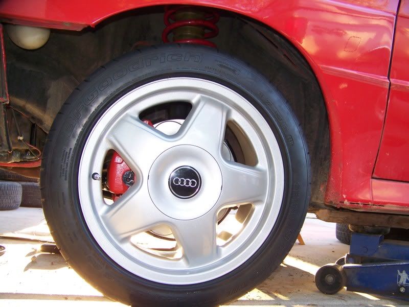

And with the newly finished Urs4 wheels and new 225/45/16 tires.

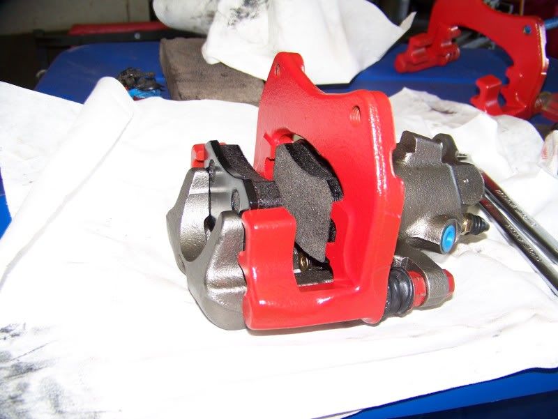

I did a little bit different approach on the rears since they were new in box calipers, but needed the S4 carriers. I wanted to protect the carriers, but didn't want to paint the new calipers. The new rotors that were with the new calipers ended up not fitting, so I had to clean up the used S4 rotors. Not bad for old rusty rotors.
Ok this brings me to a question for those of you that have done the rear V8/S4 caliper slotted rotor upgrade. I have always been told that the emergency brake setup from the Urq won't work and that I would have to source a 4kq setup. First off does anyone have a parts 4kq that they would be willing to sell the emergency brake setup from? Next question - I think I remember a thread not to long ago where this was discussed and I think it was Peter that said his original small chassis emergency brake cables worked. I remembering thinking how did that happen. Well I happened to put the driver's side caliper on the passenger side strut which puts the emergency brake lever on the bottom and the brake line on the top of the caliper. With that configuration I think that it would be possibe to run the original cable. So does anybody see a problem with running like that? I think that the Emg lever/spring setup is going to get a bunch of crap tossed up on it no matter if it's on the top or bottom. I will try to get some better pictures of what I'm talking about.
And on the car

Looks fantastic. Did you turn the rear rotors or did you use the ones from Sean?

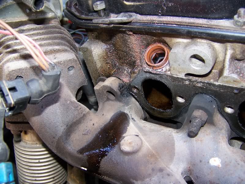

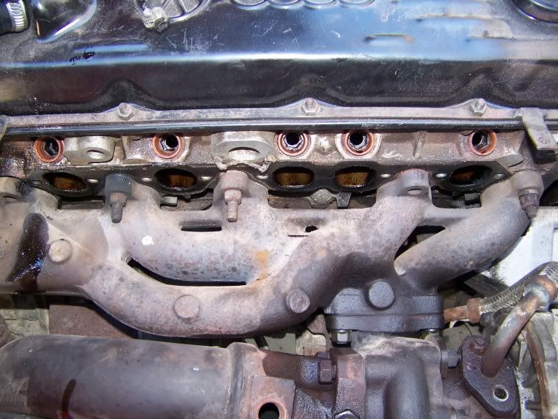

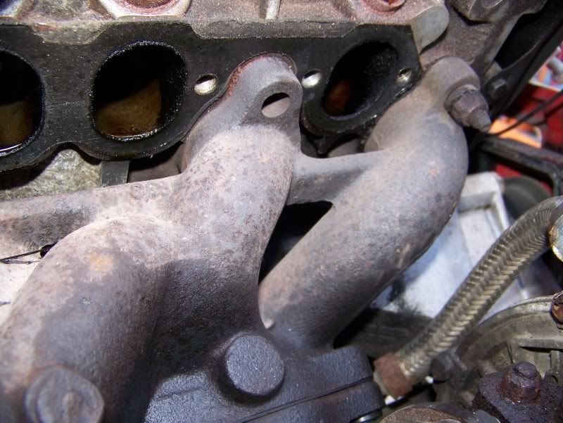

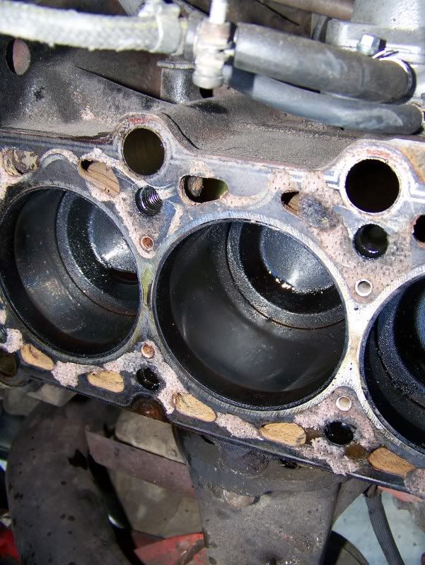

Above I made mention of the one step forward and two steps back. The steps back came when I decided that no matter how much prettying up I did the huge exhaust leak from the manifold area was never going to work for me. I decided that after wire brushing rust for a day or two that I would change directions and pull the CIS back out, pull the intake manifold, and see if I could determine the leak. I figured it would be a cracked exhaust manifold and although finding one that is not cracked is getting pretty hard to do, I was in luck because I already have one. Primed with that knowledge I dove in. I had just been there a few weeks ago trying to get it to run and idle well. :frustrated:
What I found was what looks to be a perfectly good manifold, but one that is missing two studs. :(
I then thought that I would try to make as much room as possible to MAYBE drill and easy out them with the head in place. Yea I know, wishful thinking, but the thought of pulling the head just didn't sound good right now. You know that time and money thing. Well while making room by pulling the rest of the studs out I broke the other #5 stud which looked to be the hardest to get to and at that point I rolled up the tools and went back to suspension and brakes. I then went in and ordered studs, intake,eshaust, and head gaskets. It looks like I will be pulling a head when I get off work tomorrow morning . I hope to get it off before I go to sleep. Trying to get the studs out on the bench will be a good enough trick I think and if not I will have to replace it with an old hydraulic head tht I have. I really didn't want to have to make the decisions of whether or not to rebuild heads or not.....I just wanted to fix a simple tic tick tick exhaust leak. Oh Well!! I guess I'll have to decide whether or not to upgrade to a water cooled K26 while I'm at it....I have one or two sitting around from 5ktq days.

The rotors from Sean that came with His Urq won't work for either. I don't know what they are for, but they aren't deep enough to reach the calipers, so I just cleaned up the S4 rotors I got from you. Yea I know they were pretty rusty....I can still taste it.

Brakes look good, I hate broken exhaust studs...

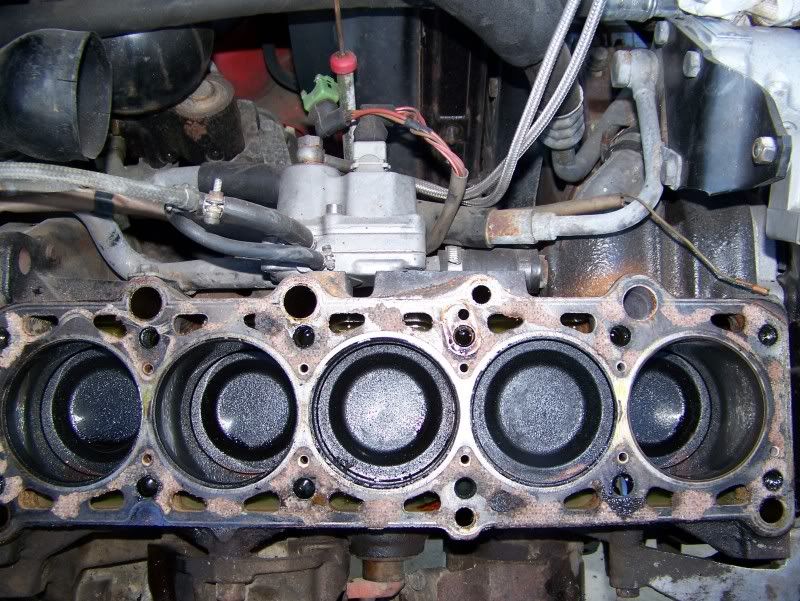

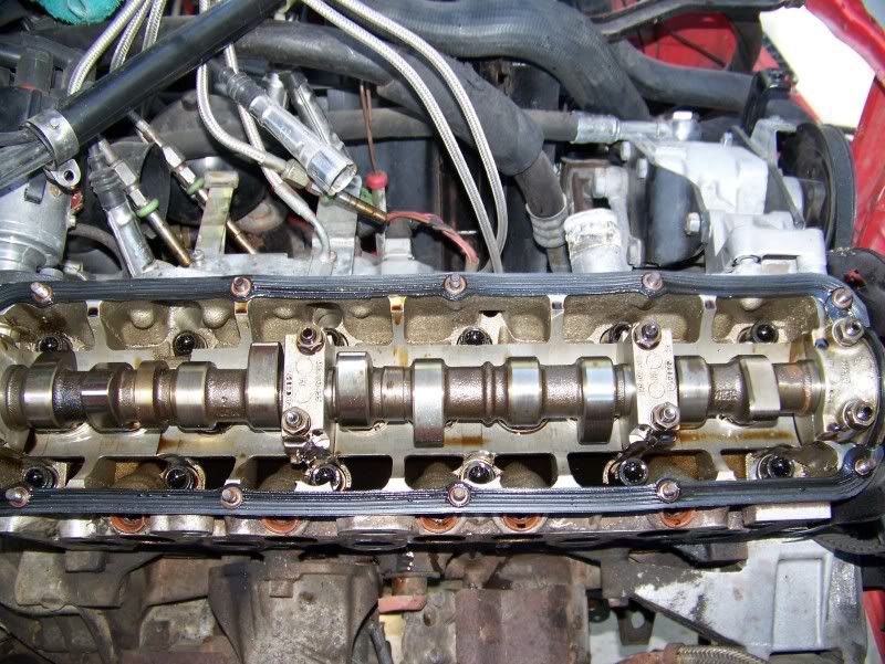

Ok.....the head is off and on the bench!
It's amazing how easy a head comes off when you already have the exhaust, intake, CIS, and major stuff already removed. I only had to remove the timing belt, cam gear, distributor, and disconnect temp sensor wiring. The engine condition still amazes me at how clean it is. There is hardly any varnish in the head itself and the bores look great with just a very slight bit of ring ridge, and that is mostly carbon.
I cleaned most of it off in the #1 cylinder with a rag and some carb cleaner. What was left is mostly just a stain. It really is too bad the head has 3 broken studs. :(
I will first see if I can remove the studs and then decide what direction to go then. If I can successfully remove them I will probably just clean up the head, hand lap the valves in, and reseal the valve guides. I probably should have the seats and valves resurfaced, but then with the solid lifter cam it all has to be reshimmed and that sounds like a pain and time. I'm probably jumping ahead of myself, but does anyone know how available the shims are?
