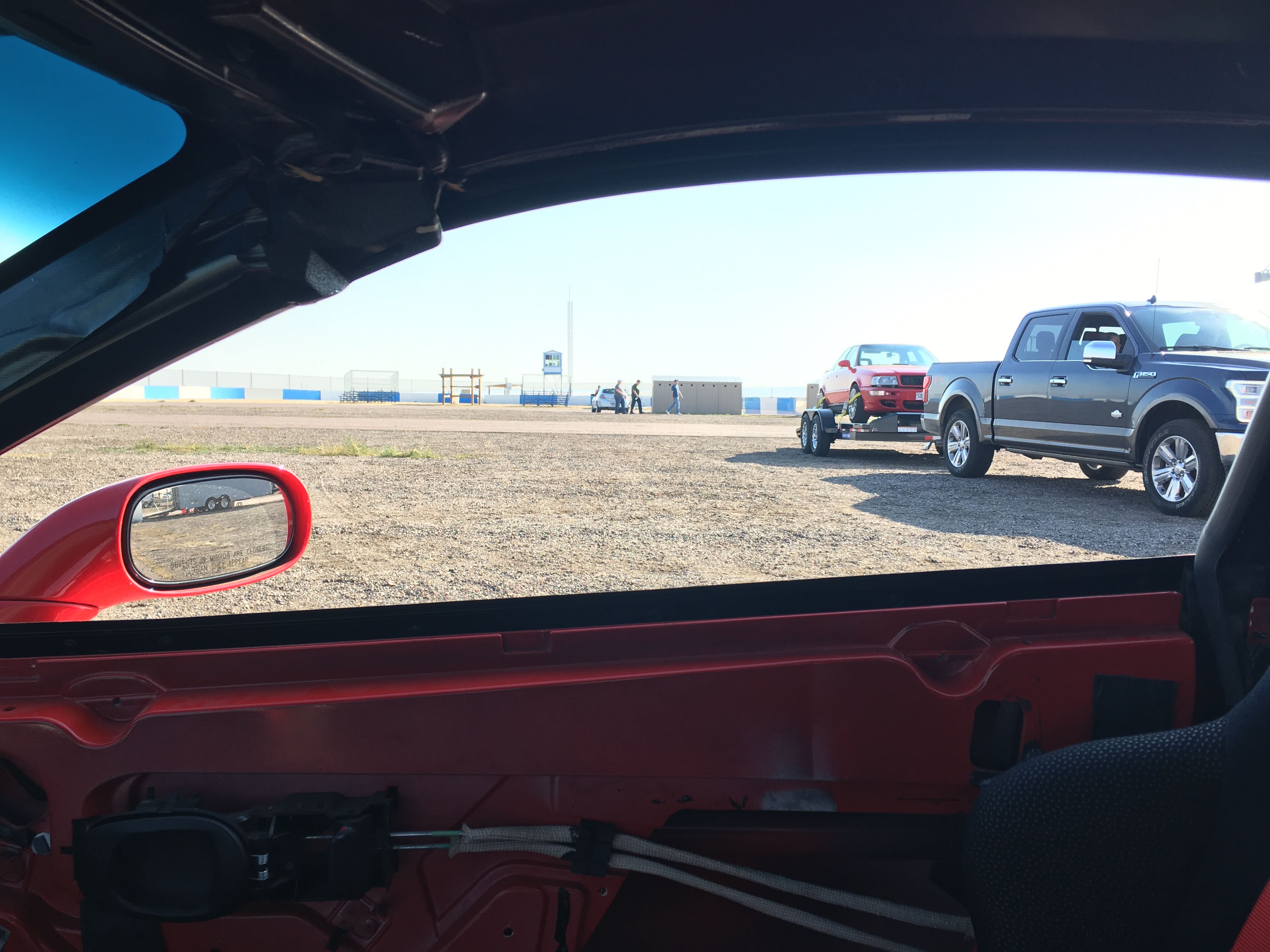

Well, finally went to the track... lasted 4 laps

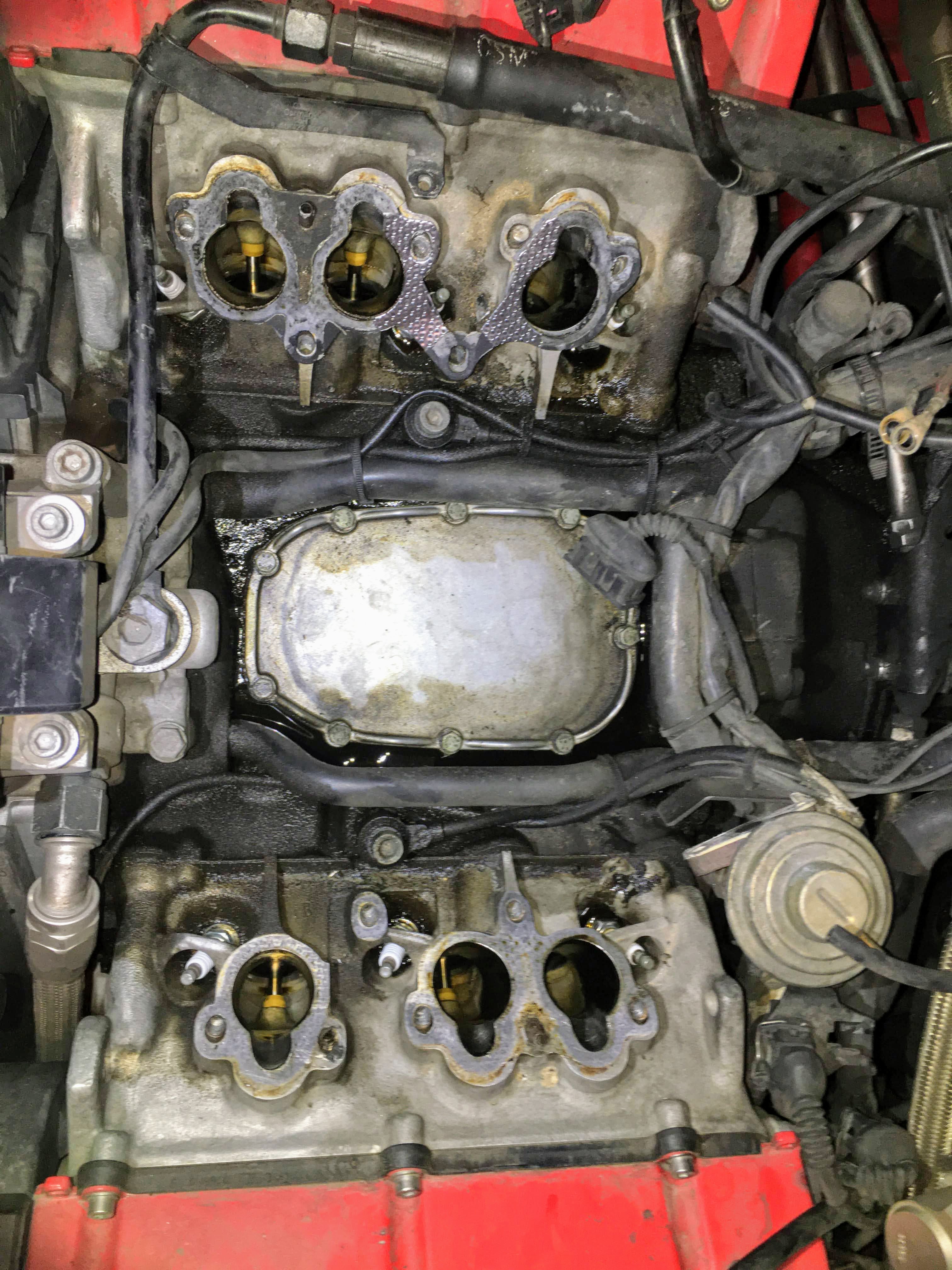

When I finally had to get ready I decided to pull the IM to inspect a persistent oil drip, ended up being a larger leak so I re-did the valley pan as it had been a few years.

Lead follow starts out fun, lead car is a C6 vette, the 90 feels good but focusing on learning the line and trying to keep up with the group. Since almost everything has more power than the 90 it was challenging to maintain momentum through corners while the rest of the group really could rely on powering out of every corner and down the straights. Still, I made due and felt better once I got to the front of the line where I was only subject to the instructor's braking. About half-way through the next lap, I was back at the end of the line, something felt odd and under breaking for turn 8 (a nearly 180º left) a wheel locks hard. Luckily I was in the back and kept control to pull to the apron. I figured, hoped, it was a flat but the flatbed driver didn't see one. Once back in the paddock, it was quickly obvious that the caliper was not where it should be
I scrambled to pull everything apart and see WTF happened and I found a broken aluminum adapter bracket. I'm fairly sure I would never have noticed the corroded bracket during a routine review so I felt less bad about running out of time.Since it was early and my friend's wife was just hanging out, I started calling parts stores thinking I could pull the adapters and downgrade to stock B5 S4 rotors. We found a set, and pads, at the closest town so we headed to grab them. By the time we got back it was lunch but I started trying to bolt things together after a quick bite. To my dismay, the rotor was not lining up with the caliper. At the time, I figured the issue was a variant in S4 rotor and since there were no others in the area we decided to we'd tow the 90 home and I'd pilot the C5 Z06 track car back to his house. At some point, I rode along for half a session in the Z06. Seems like a nice base for a track toy, he's basically stripped it to install the harness bar and seats and added some heat management.

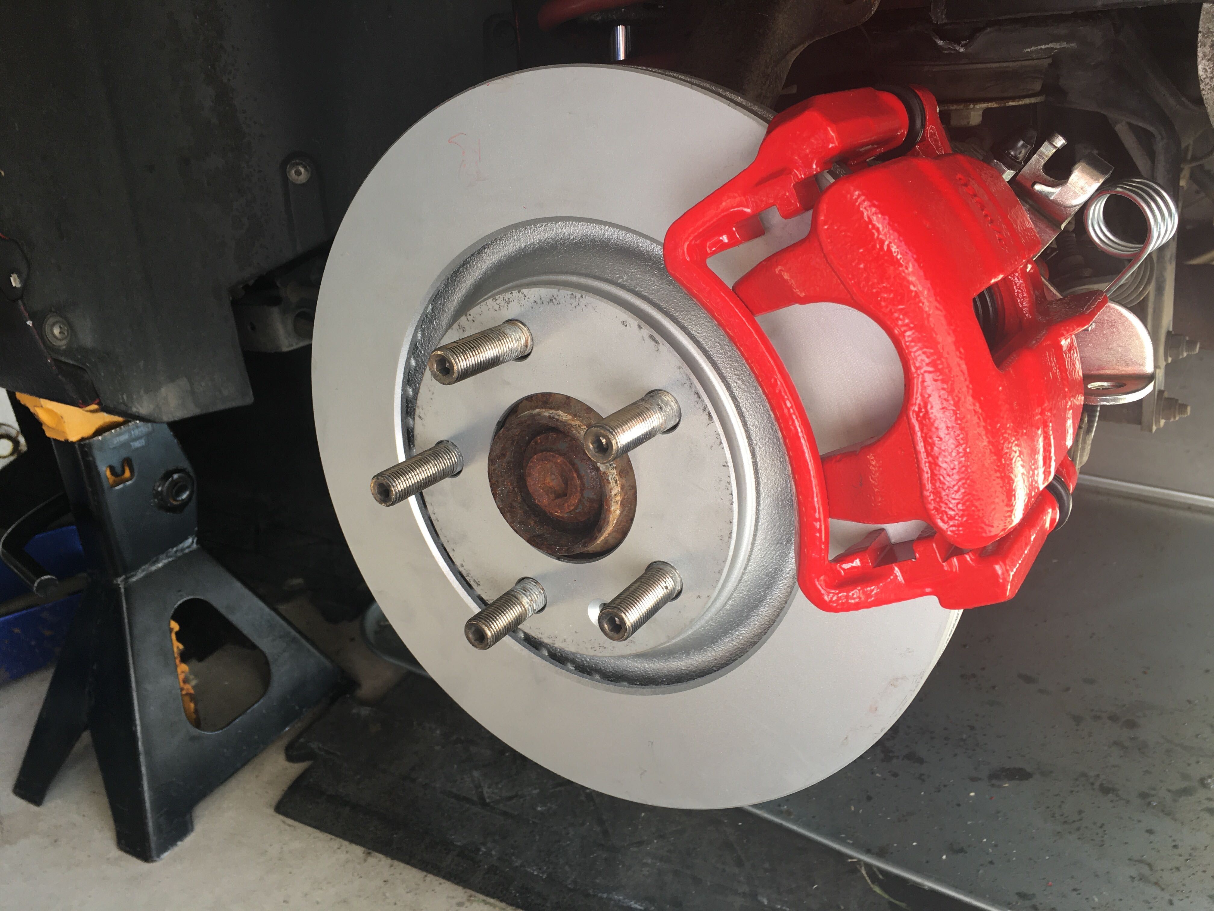

Here is a shot of the B5 rear, the issue is my S2 Sedan hub rotor mounting surface is closer to the caliper carrier than the B5. Given my experience with custom brackets, I'm leaning toward a no adapter solution and reselling the apikol kit. I already have the B6/7 rotors and the ECS rotors I have are close to end of life.
I did think about bolting the carrier to the inside of the adapter but I'd need to tap the adapter and that is the rough side of the the carrier. Might be too much offset anyway. KISS.
Re: 1PissedOff90

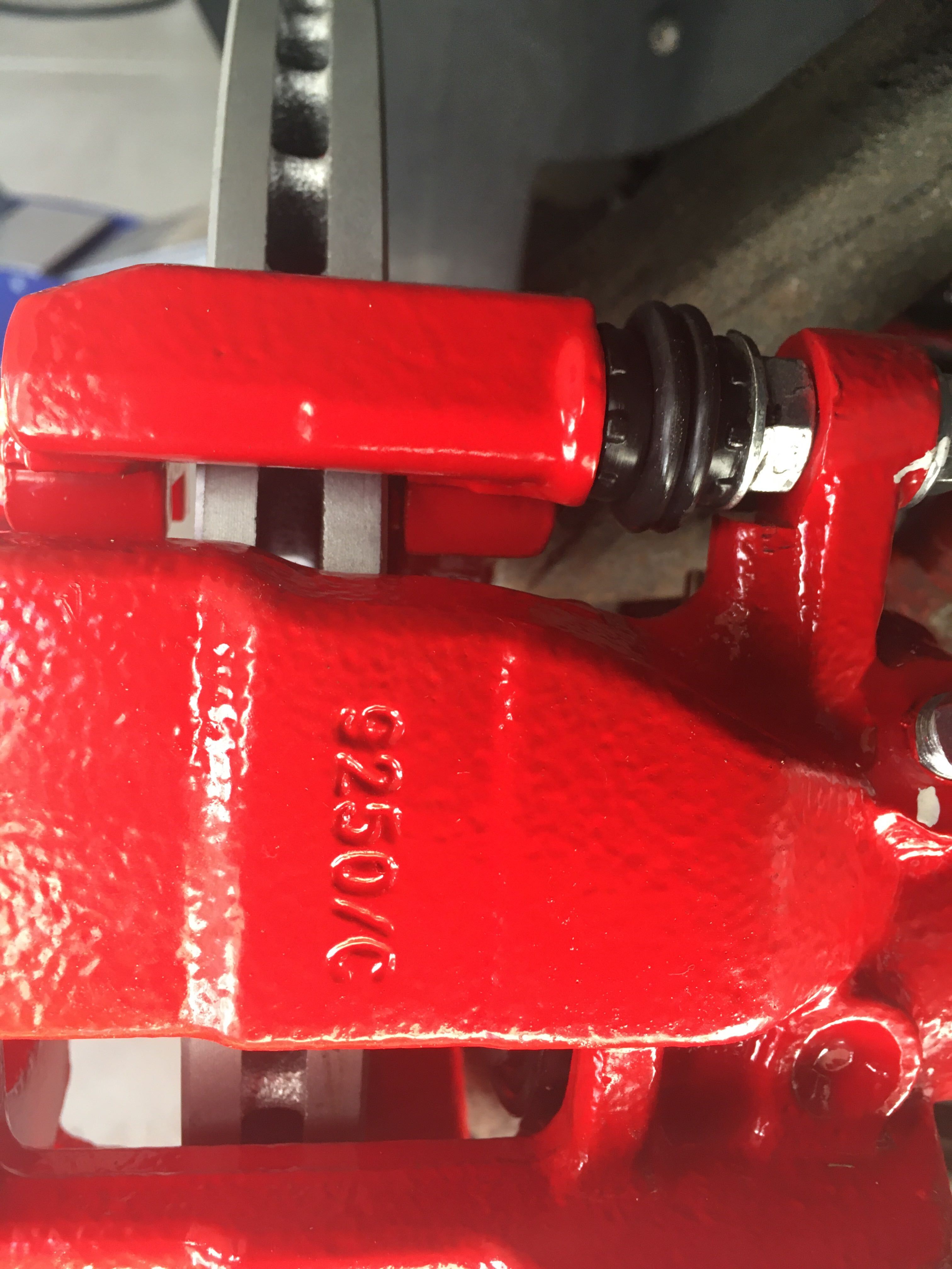

Finally ended up buying Powerstop B6 calipers, looks very good to me (we'll see how the finish holds up). Just need lines (the B6 is a larger banjo) and pads.
