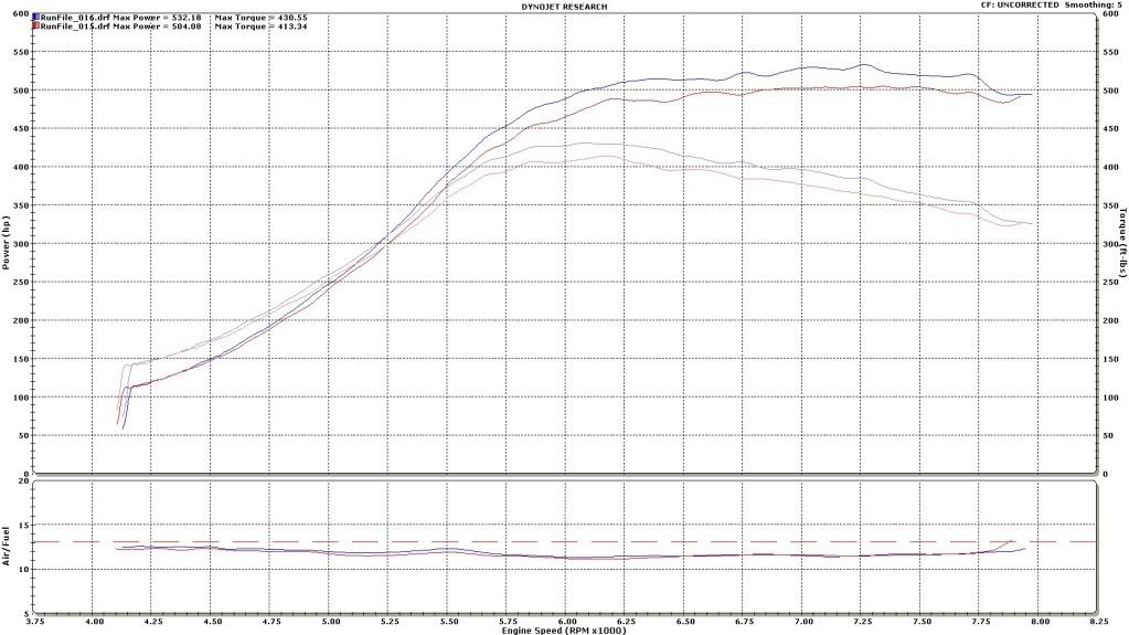

Mike has his dyno pulled in 4th gear... mine has only ever been in third gear. and we ALL KNOW that 4th gear is the better gear to pull with on the dyno....
and sure, we can set mike as the goal for the 4cyl, its top dawg for 4cyl Quattro cars AFAIK.
speeding-g60
Posts: 2152
Post by speeding-g60 »
here is a couple 3rd gear pulls.... THIRD GEAR.

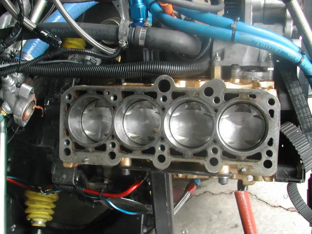

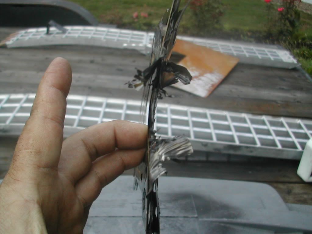

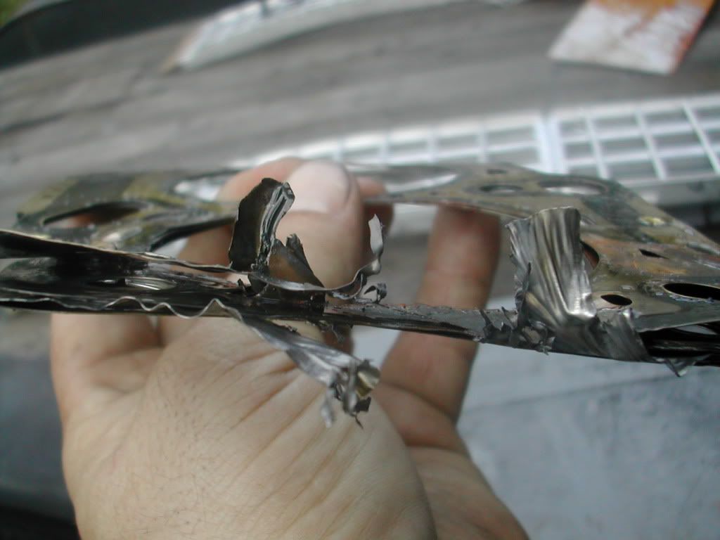

so i pulled the head. and i need a new head again. :(
check out my radiator. it used to be flat/straight... now its bowed a little LOL.
and this headgasket. hmmmmm....
dang that thing got toasted hard :frustrated:
