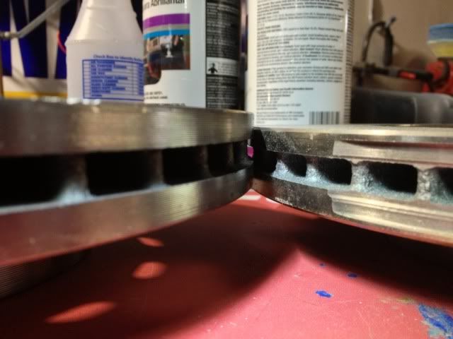

On a side note here. I swapped a CQ hub onto my car to see if the different offset versus my stock 90q20v hub would allow these 275s to clear in the front. And they did just that. Not by much, but the tires do not hit the steering arm now. I think I may take the grinder to that arm though and just get a tad bit more clearance, because as it is you can fit a few pieces of paper in there, and that's not enough.
This is pretty much how much offset was gained from going to a CQ front hub and rotor versus my stock 90q20v hub and rotor.
