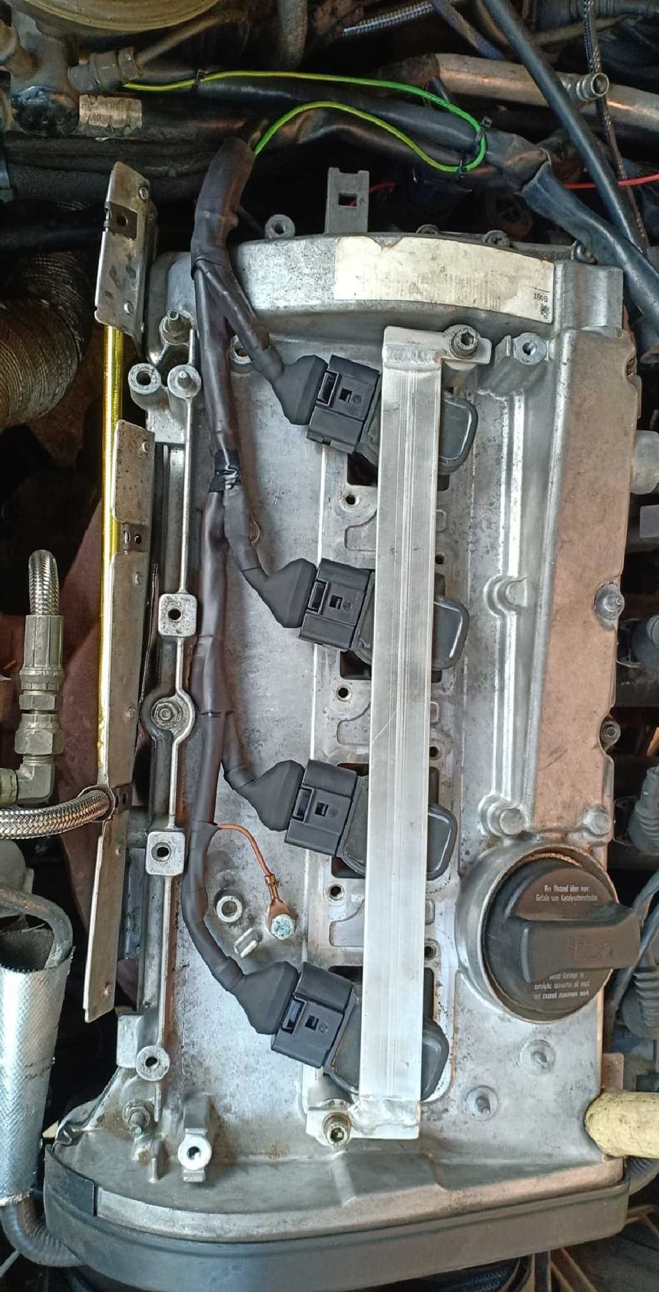

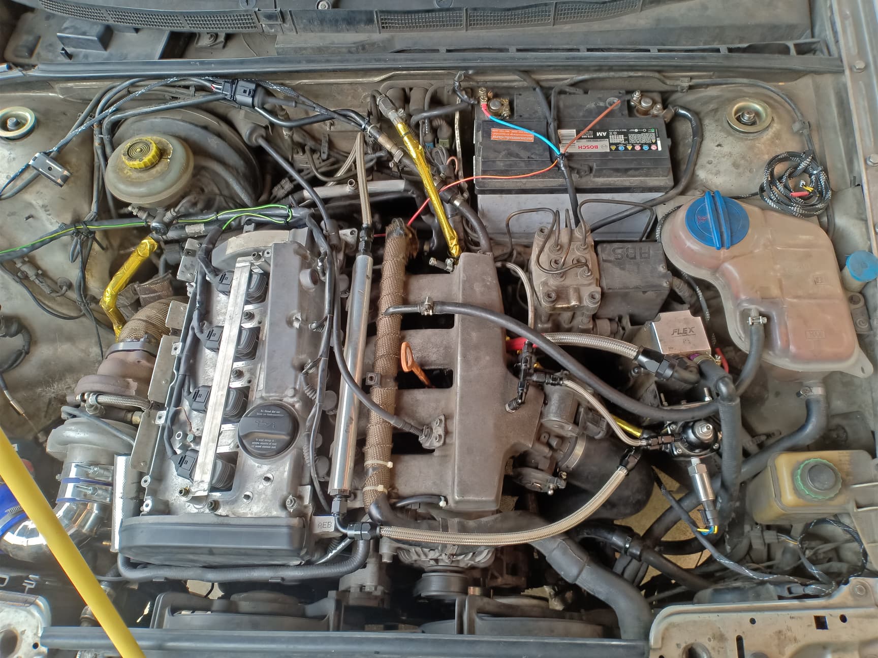

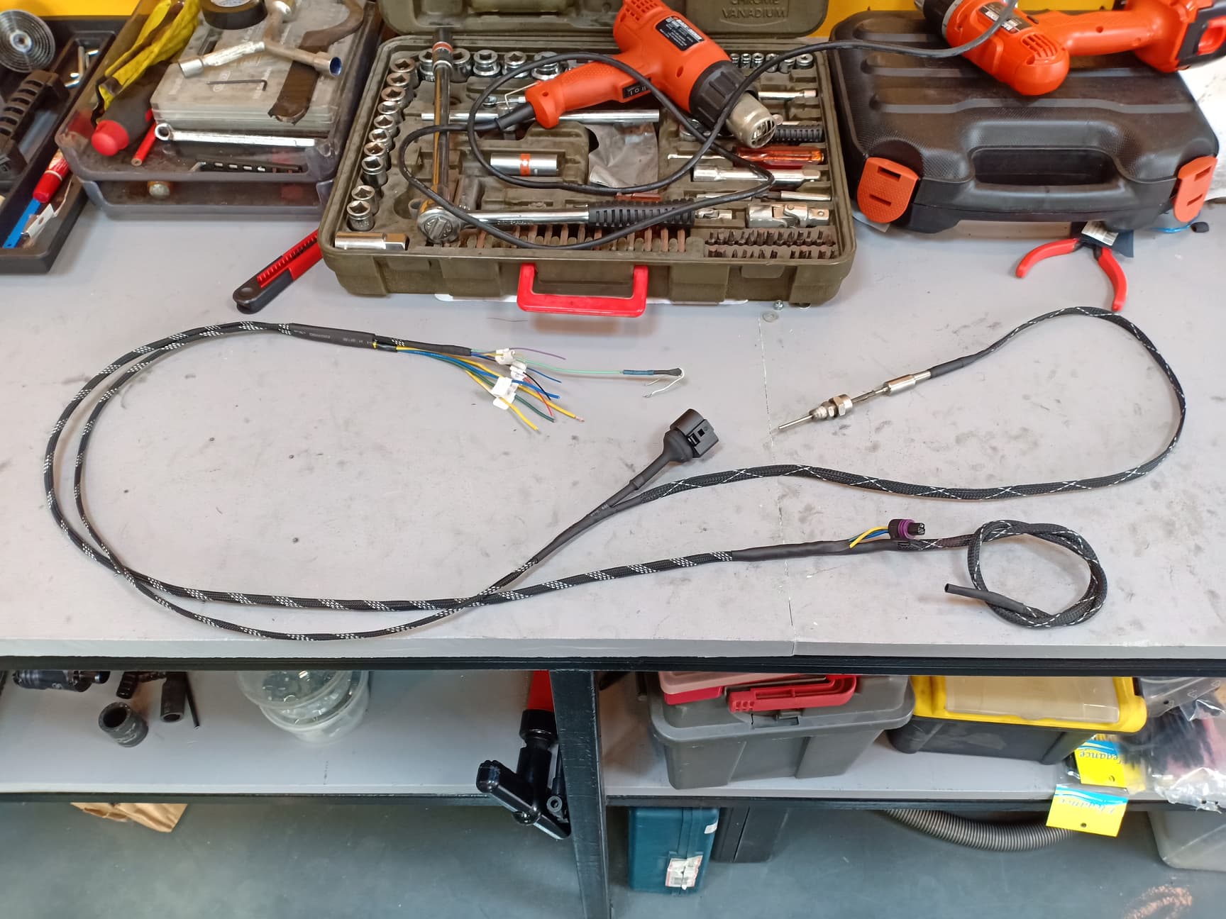

Been working hard to rewire a bunch of things on the car.
-Coil harness.
-Fuel pump wiring. Found toasty wires in the relay holder from the bad pump pigtail.
-engine bay subharness (WBO2, Fuel pressure sensor, K-type TC for post turbo temp, aux analog in).
-Motronic to VEMS adapter harness. A serious PITA, but had to be done. See pic of old adapter. It worked, but on inspection it was clear it needed replacement.

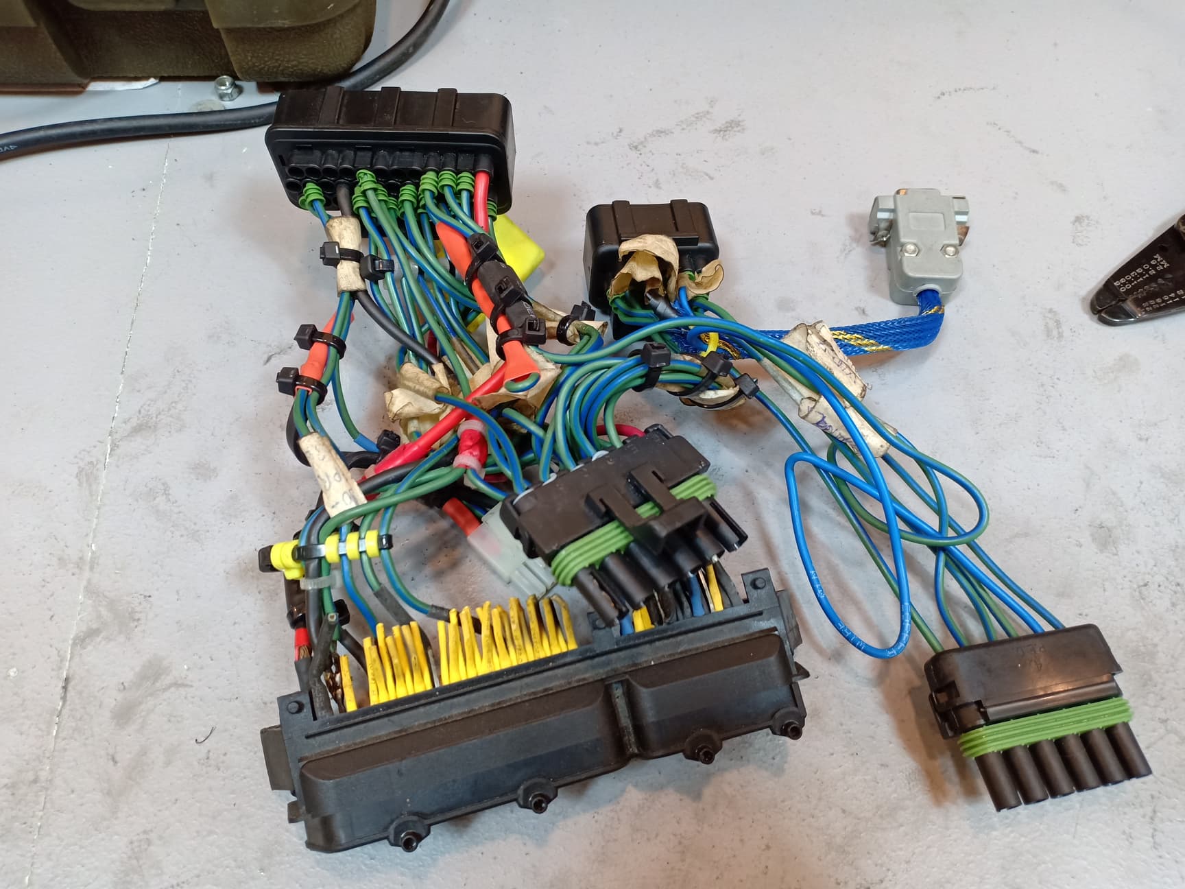

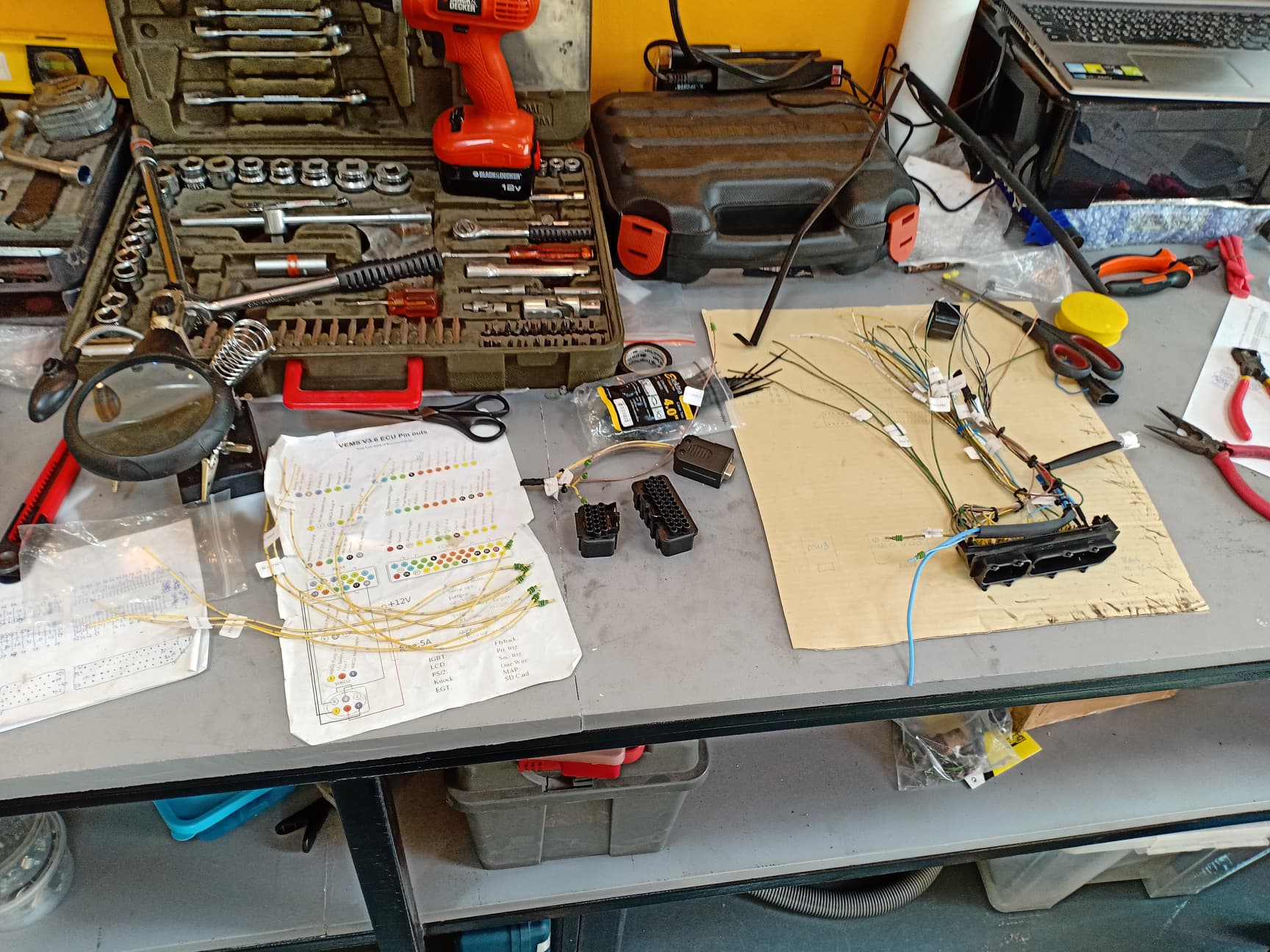

Several issues with the adapter harness, but got it to work properly today. Worked for two days to build it. Fucked up a few connections, but managed to fix them all.
I forgot to take a picture of the new finished adapter... :roll:
old adapter harness.jpg (212.62 KiB) Viewed 63069 times
building new adapter harness.jpg (281.37 KiB) Viewed 63069 times

I need to develop he patience to build nice harnesses like that . Btw what is that material (not the heat shrink but the nylon looking cover)?
Posts: 875
Location: Bangkok, Thailand
Re: B4Q 80-AEB TD04HL-15T; Loads of rewiring!
Post by ChrisAudi80 »
Afterthought wrote:I don’t buy the diverter thing either . I think they criticized the plastic in order to market the billet ones.
I remember when the b5 guys were all going to forge diverters and later down the road people were having issues and going back to 710N . I was running over 600 WHP with those 710 and never a problem with the plastic ones, some seasoned runners argue they react faster, and they also don’t stick or require any servicing .
In that same car I ran two fuel pumps (dual 044 ) which was overkill I think. If sitting in traffic with a tank level was on the lower side (3/8 or less) it would actually heat up the fuel enough that it would cavitate because the fuel was just taking a free ride in a circle to the rail and back to the tank.
It is called expandable wire sleeve or something. You can find it on Ebay. It does take a lot patience and planning. Make diagrams and tables. I'm still a n00b.

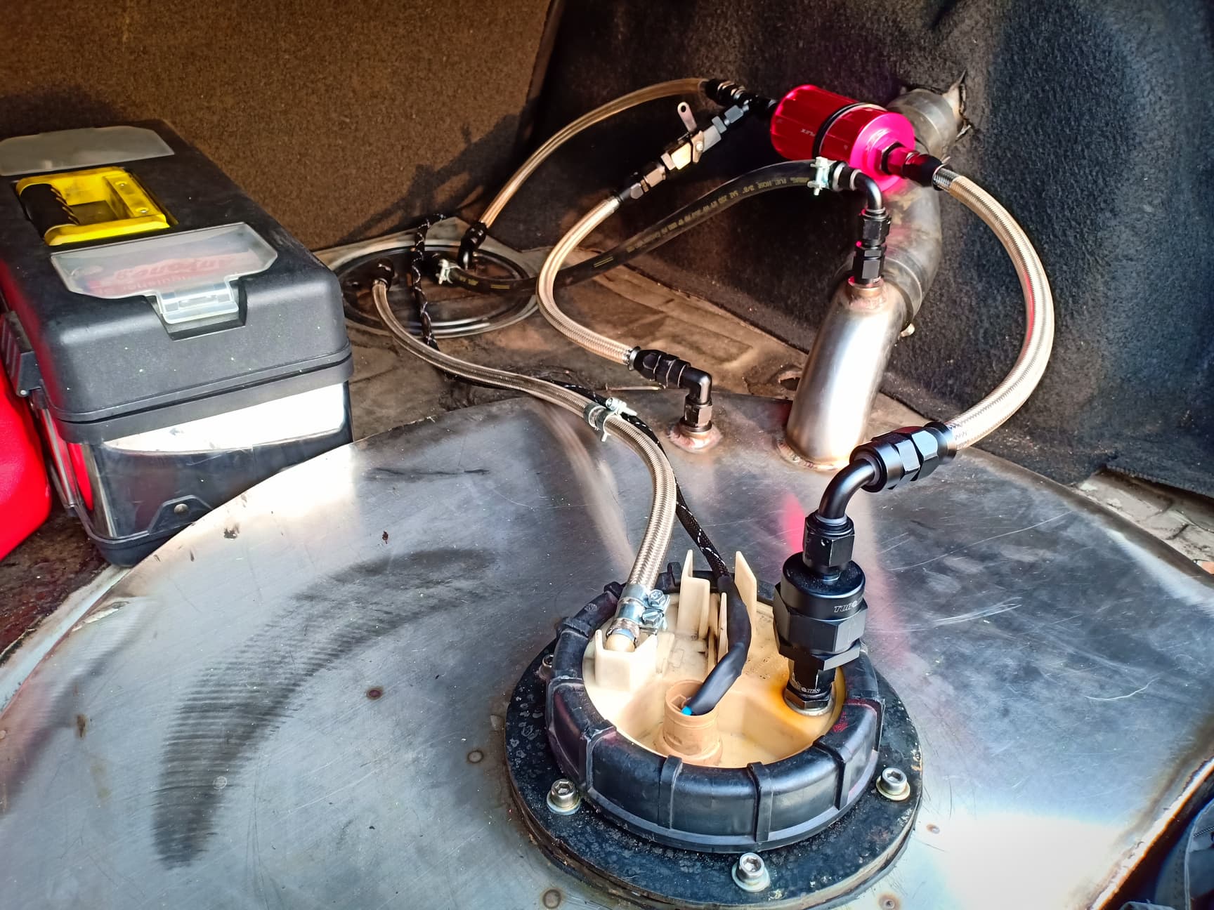

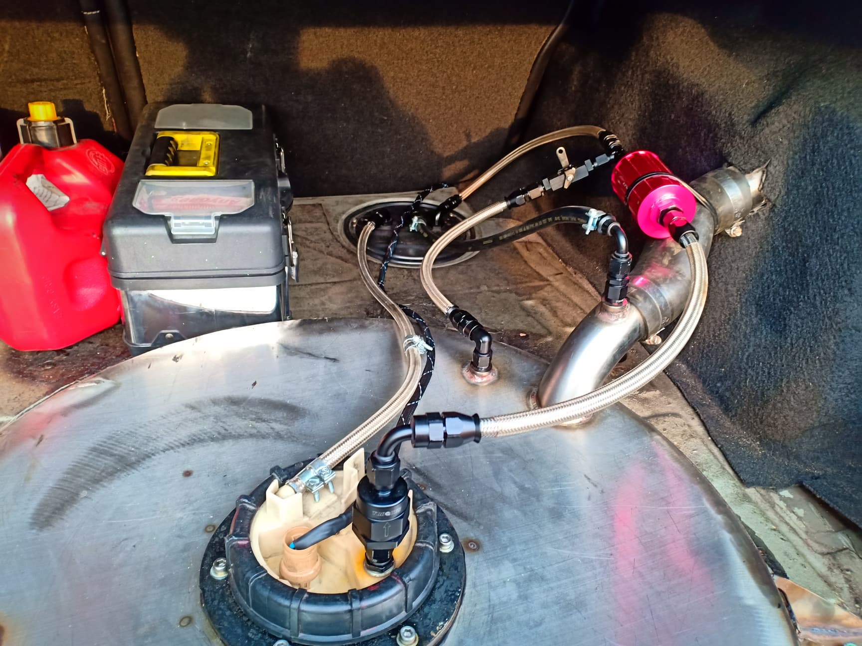

Decided to redo some of the fuel lines.
The feed now goes into the rear of the rail instead of over the block through a 180.
Return much shorter from the front.
And most importantly shortened the signal line to the Fuelab FPR by like half. Hope this makes a difference with control and eliminates the small ridge at around 2800 in the VE table.
See pic. It looks way cleaner than that stupid shit I had before.

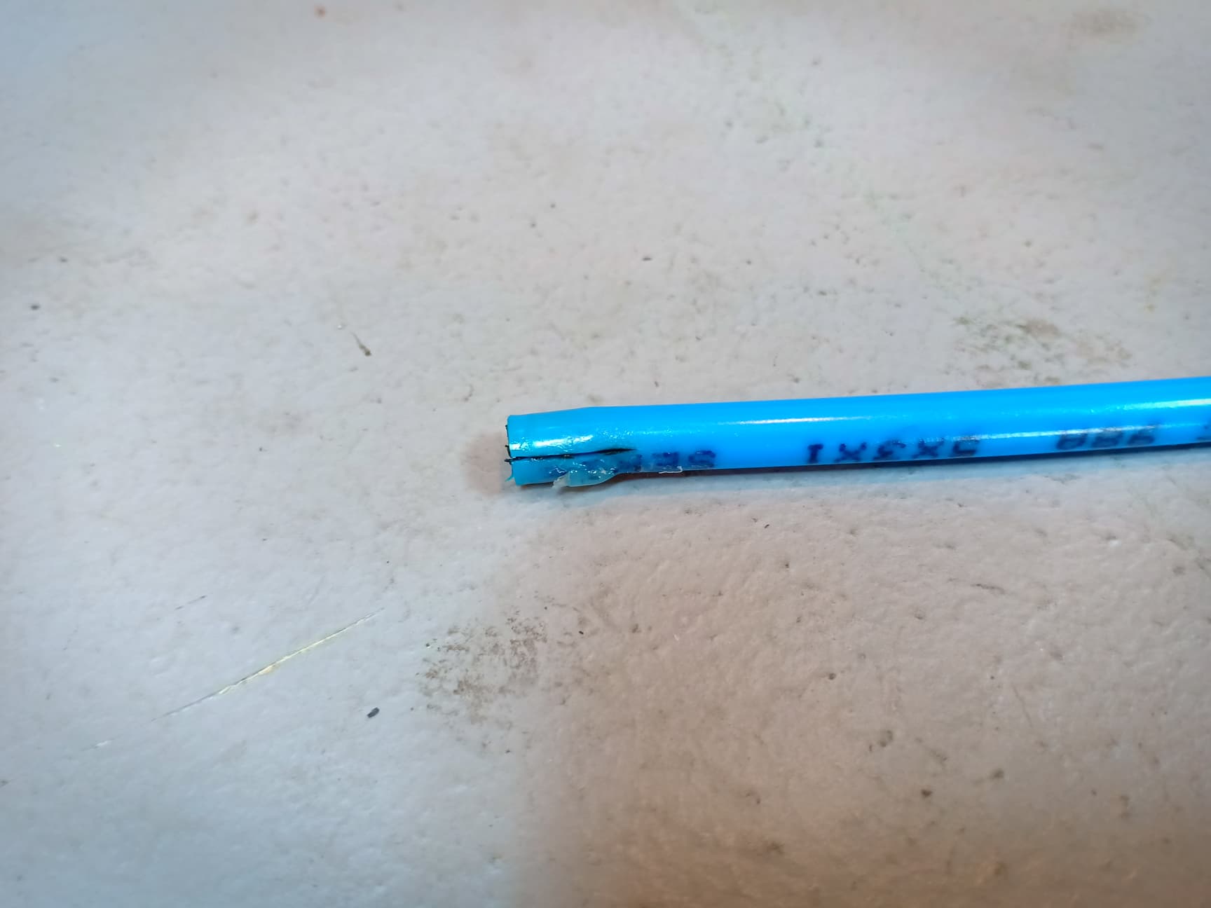

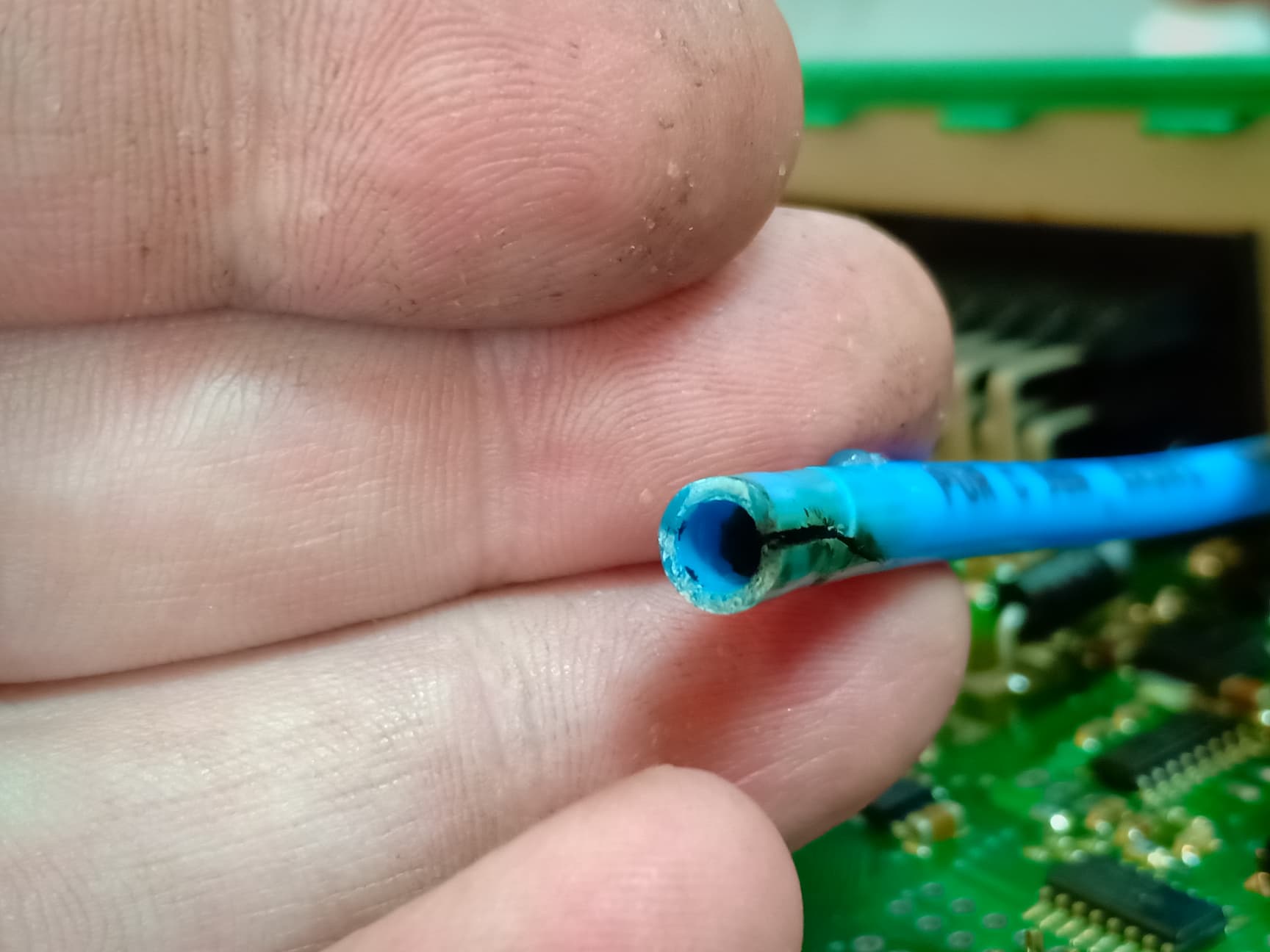

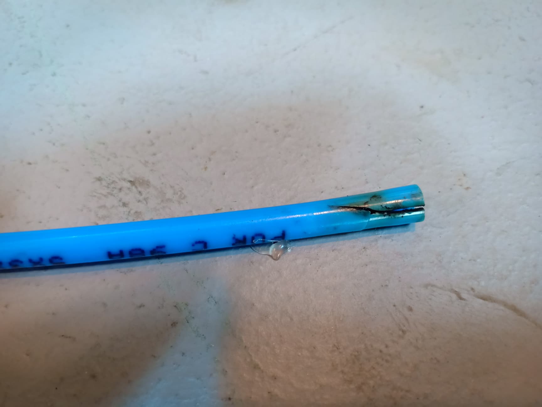

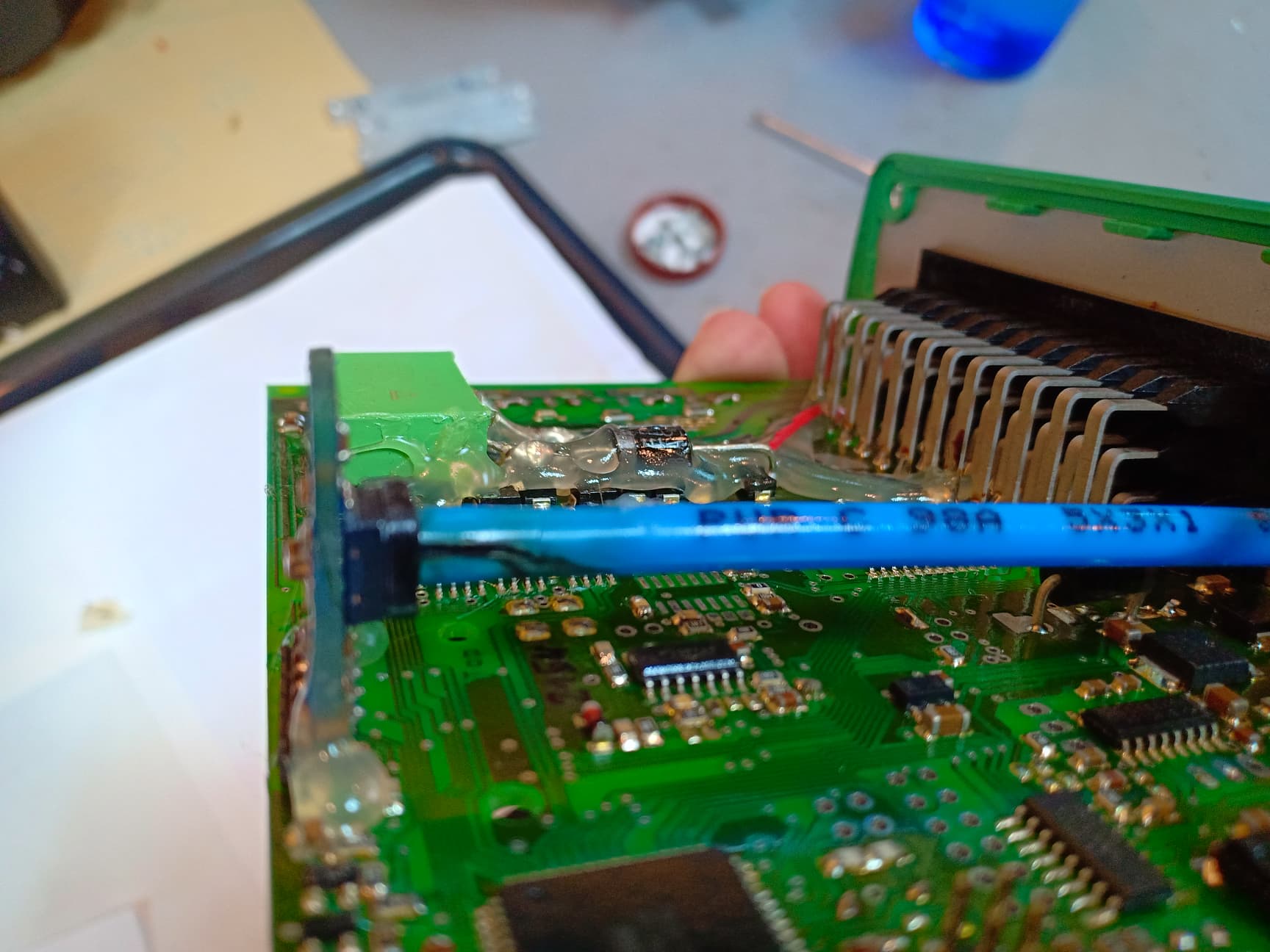

A small but critical part failed. This cause me to chase my tail for a long time even though it ran OK, but could not really maintain boost target. I put that down to the wastegate actuator being 0.5bar stock. I had been hearing a hissing sound from the ECU for a long time, but thought it was normal. Silly me.
However, it tuned out that the little tube inside the ECU to the sensor was borked big time. Luckily, a tuner I have befriended recently from Lithunia is visiting Thailand so, after fixing the issue by just replacing the tube with a silicone hose, we went for a drive where he live tuned the VE table because it was completely wrong.
Before, it idled at 60kpa, now 45. Cruise on hwy before 76kpa, now 60. Boost for days. Maintains 200kpa flat to 6000.
See pics of culprit.
cracked tube 3.jpg (105.56 KiB) Viewed 62757 times
cracked tube 4.jpg (160.53 KiB) Viewed 62757 times

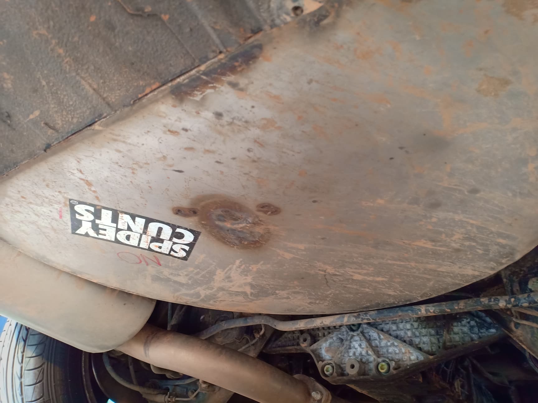

Forgot to post these shots. If you compare the fuel pump wiring from before to now, so much better and cleaner. I spent a lot of time on the previous config too. Shit house :shame:
Moar better now. The relay and fuse are under the back seat now.
Bottom of fuel tank looks bad, but it's just dirt and weld discoloration. No rust.
The sticker is from a hilarious YT channel called juiceboxforyou. Some dudes in Ireland who are crazy about AE86s and other JDM cars.

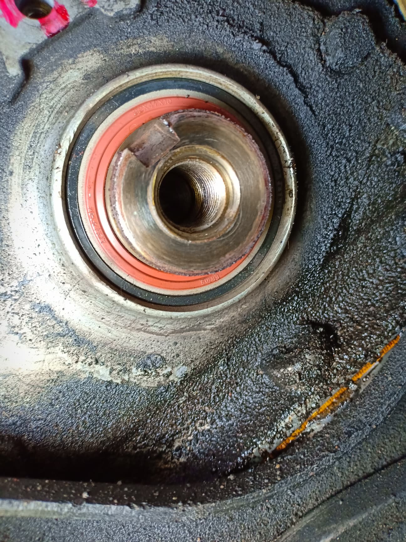

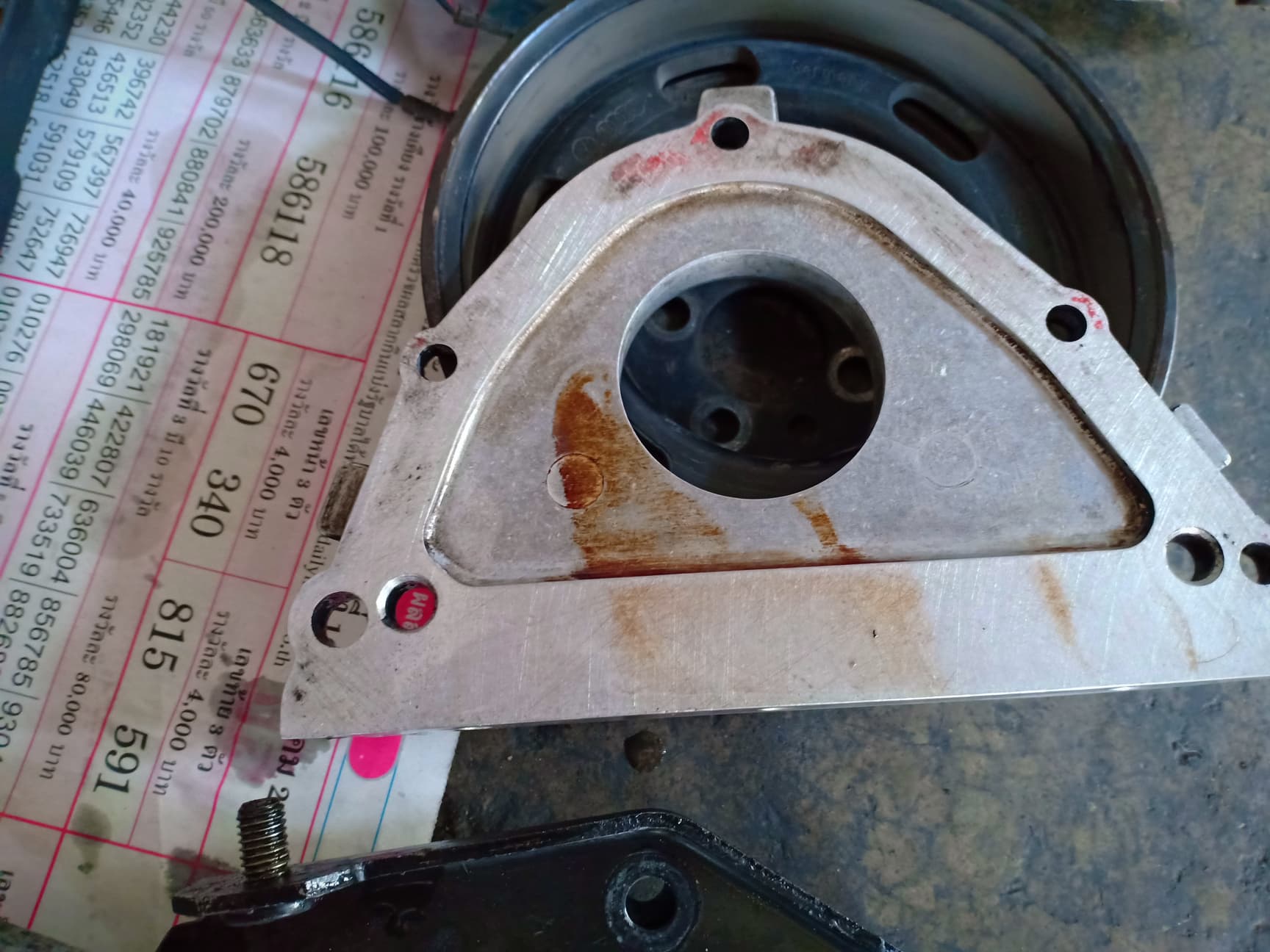

Some maintenance. Had an annoying oil leak for a while. I was fairly sure it was the front crank seal. Not quite.
It was time to do the timing belt set I figured. Good thing I got it done. The water pump belt was about to go. Dry rotted and cracked.
However, it was not the crank main seal that was leaking. I had that replaced about 3-4 years ago, so thought it weird it would leak so soon.
Turns out i was the gasket between the block and the bracket that holds the front main seal.
So, while in there, changed out the timing belt, idler, tensioner and accesory belts.
Pics... Includes gratuitous picture of my dog.

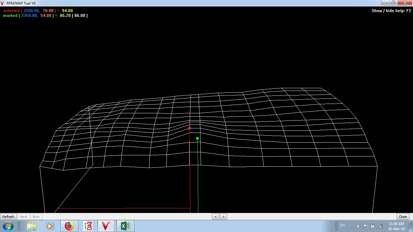

After 3410rpm stable and back to a reasonable VE value. It wants like 7-10% more fuel in that rev range between 50 and 90kpa.
So, I get a hump in the table.
I guess next step is to switch back to a as short a silicone hose as possible for MAP signal to see if the harmonic moves up the rev range.

It is starting to look like it's not MAP signal related. Fuel pressure and MAP is stable everywhere. However, lambda does suddenly look like a saw.
Target VE is stable, but corrective VE is also jumping. So, it would seem logical that EGO corrective VE follows the saw tooth pattern of actual lambda.
This leads me to believe there is some kind of resonance in the down pipe. I would have to tap in a pressure sensor right next to the WBO2 to check.

Because I am a data geek and love coming up with overly complicated stuff, I am working on a study project that will take some time.
Have been ruminating about the hump in the VE map, so thought "what if there is some kind of resonance in the DP? How would I find out?" Ah! Measure pressure next to the WB sensor! So, down the rabbit hole I go...
