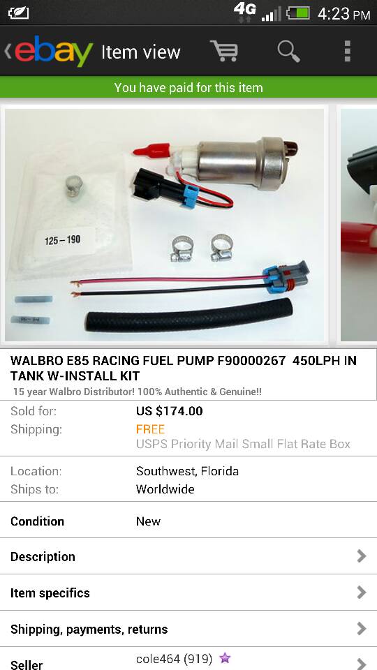

In other news (to divert my attention and keep things going) I purchased a vital piece over the weekend...

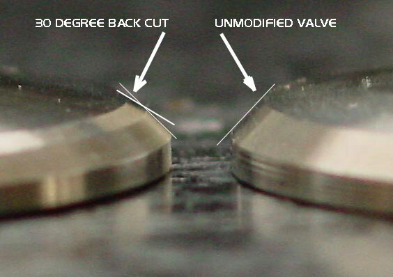

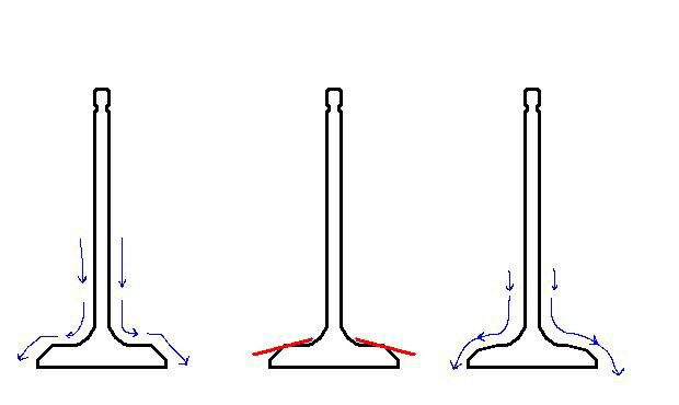

After much deliberation with shop, we've concluded!!!
The only possible way to use cut OEM seats on a +.5mm valve is by cutting them in a way where they seal on the bottom ridge of the valve... We've arrived at this by looking at soo many 20vt valve jobs on the internet that had this set up...
Now in essence this is NOT optimal (for flow) as the the idea is to cut open the seat as to seal on the outer most ridge of the valve as opposed to slightly under. In fact he actually feels as the end result will not be that much of an improvement over a stock valve unless you get re-seated.

Re: A tale of Rubí...PTE5862 .64 a/r Received, Head Rebuild
Your conclusion is sound, though the testing I have seen in the interwebs still shows a gain in flow with the seat lower. Ideally, the seats would be changed.
I'm sure there's some improvement but he feels as though a stock port, stock size valve that's backcut like soo...
... would flow better as there's .5 less valve area the that air has to move around as the overall port isn't enlarged, just the seat perimeter. He recommends this with super light diy porting as the best combo.
In my case I will no longer be able to backcut the valves as that's where they will now meet on the cut OEM seat. As opposed to seating on the outer ridge coupled with a larger seat and port.
In other words anyone who's put a bigger valve on a stock cut seat has just put a bigger door on a the same sized opening just modified to close properly. And if any gain has been measured it's probably more because the OEM seats now sit lower creating a marginally larger opening when the valve is open.
Heck he even went as far as saying that some people don't even measure cfm on a forced induction car, they measure airspeed instead... So yeah, I'm chasing that 10hp dream... :cry:

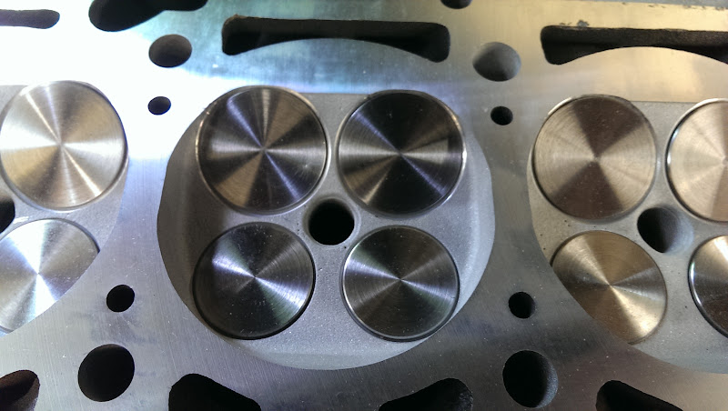

Re: A tale of Rubí...I've got my Head back!!!!
Post by S4Pirate »
Looks good! Did you give any thought before to a DIY port n polish?
Looks fantastic! Funny how fast adds up in a head!
that is a piece to be proud of, cannot wait to see this entire longblock in all it's glory. :beer:
S4Pirate wrote:Looks good! Did you give any thought before to a DIY port n polish?
Yes, yes I did...
The idea was to fully disassemble, port and polish then send to the shop with parts for the decking, flauxing, wash, new guides & assembly...While I was disassembling I battled going +.05mm in my head, I took it as far as removing the cams & lifters before I finally decided to go over size ... so I stopped there. I'm not sure I still wanna do a light PnP on it while it's half assembled,... What do you think?

Yeah I'm really happy, specially with the level of communication & professionalism from this shop when faced with the 20vt challenges. I'm super glad to see how free of cracks this head is too...
I might do a before & after using stock AAN cams first then swapping them out to see how much spool I lose...

Looks like its been blast cleaned?
Dry Soda perhaps?
If its been done with anything else make sure you check the oil galleries that run either side of the head and that feed the hydros- you dont want any media left in there i can tell you!
Blow them out with an air line (mind your eyes!) and see what comes out, theres usually grungy residue of some sort which i get out with carb cleaner as much as possible.
Dosnt matter so much about soda as it dissolves in oil. :)

mushasho wrote: Yes, yes I did...
You're basically ahead of me by 2 weeks. I plan on porting and polishing myself and then sending to the machine shop for oversized valves. I'm doing it beforehand so he can clean up the mess I'll make. I'm not sure you want to do that with everything assembled but others would know better than I.
Yes, yes I did...
Unless you remove the valves to access the short radius area on the exhaust side any work elsewhere will do nothing much really.
You cant really do much to the guide bosses on the intakes with the guides installed as you risk knocking them about with any tooling, probably best to run it as is. :thumbsup:
I'm just gonna clean the heck out of this one and see how it goes... I'll have a spare I could go nuts on if need be... but most likely not... I'll probably devote my future efforts on something 07k
