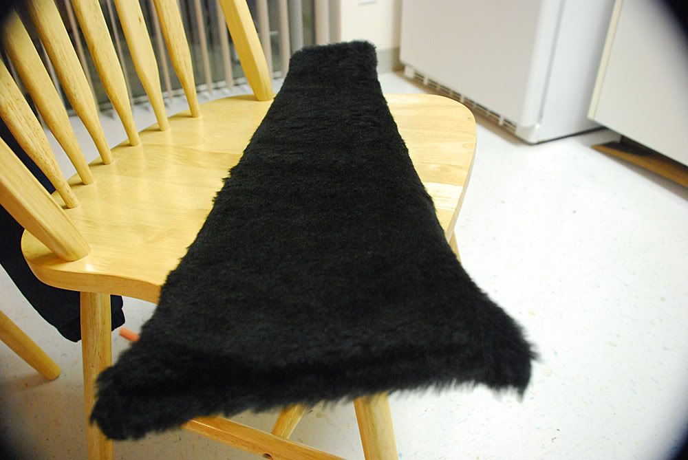

heh, I went to Jo-Ann today to get some fabric for my friend's E36 M3 headliner...I decided to use the same thing for my lower interior
We also chose to use some black corduroy for his pillars. It looks so nice.
I just need to decide where I want to separate the gray suede from the black fuzzy stuff in mine.
I think I want to do the dash in the gray suede. The upper pillars are all the gray, and the lower B-pilar is now in the black. The area I really can't figure out what I want to do with is the doors. There really isn't a good place to make a separation line. I was thinking about possibly splitting it in a sort of arbitrary place on the door...but one which would correspond to where the b-pillar switches over.
Ideas??
Ideas??

Interior is still up in the air. I got the two fuzzy lower panels in, and I'm a little unsure what I think of them...I do like them, but I'm not sure if they are right for the car.
Either way, I think I am going to go thru with it because its easy to re-do whenever I get tired of it or want to do something classier. It will look good though, and feel even cooler
I really want to avoid doing the top of the dash in the fuzzy stuff. I would so much rather do it in the gray suede. I think it looks much nicer. I was thinking I could do that gray, then the portion where the air controls, etc. are could be done in suede also. Then I would put the fuzzy stuff where the carpet comes up to meet the center console/air control area. Then the glove box and under-steering-wheel area would be the black fuzzy. I would then essentially have a gray stripe going down the middle which I think would be kinda neat.
The only oddball thing is the doors. There just isn't a good place to transition with them. I'll take a pic later to explain.

Fuzzy anything in any vehicle except a van is dumb looking IMO. I've seen some old vans that it "worked" in, but that was it. Kind of like when guys put fuzzy stuff on bikes they dumped, it looks :tard: . But that's MO.
I'd do suede with stuff painted high gloss black with some silver trim (like the gauge face trim rings?).
5k panels may work better for you if you want a nice two-tone/texture look.
lol I have to agree with you on this. At least part of me agrees.
All I know is that my friend's headliner is awesome in it, but thats a little different.
I am tempted to just make a blanket out of it haha. I would also love to just do the carpet in it, but I have no idea what goes into doing the carpet...and it would be a bitch to vacuum, etc.
I would do black suede on the parts where I am currently thinking about fuzzyness, but thats $22 a yard... :frustrated:
I may just have enough to do everything in the gray. That might well be the path I take.
I dunno. I am clearly interiorally confused.
I just looked and I have 9'x5' worth of the gray suede left...I think that should cover the rest of the interior (the reason I was going to do two tone in the first place was because I didn't think I'd have enough to do it. The only problem I run into with this is that I still have no idea how to get a seamless suede door panel without completely wasting a bunch of it for cutting out the middle. So far I have been able to waste very little. I just wish there was a good separation point.
