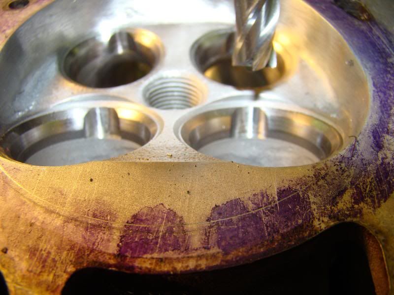

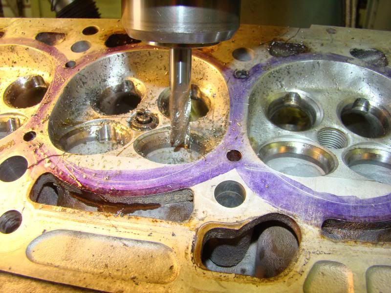

Got an update from Jeff Gerner:

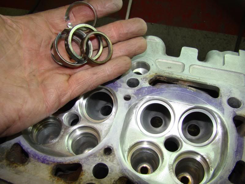

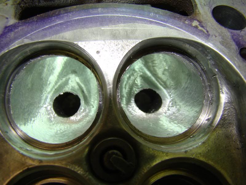

"Removing stock valve seats @ FRP"

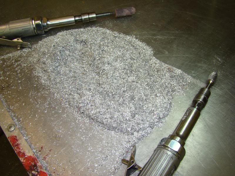

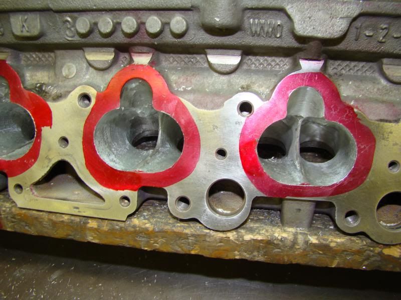

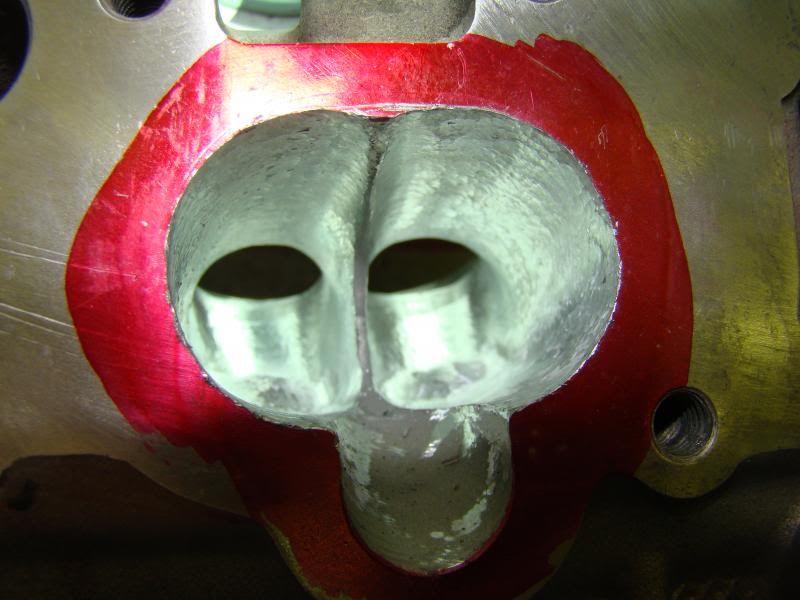

"Big port hi RPM intake ports @ FRP. This is the rough in phase with seats and guides out."

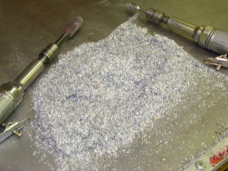

"This is why your head weighs less. This pile is 6 hours steady porting. At least this much went in my lap and on the floor!"

Well dang, I know that sight all too well as I have had shavings like that in my lap too. this car is going to be epic!
Re: Chris' 200 20v Revver Project
weight reduction !
UrSobsessed
Posts: 286
Post by UrSobsessed »
Whoa! That thing is gonna breathe!
Let the chips fall where they may...
I'm full on jelly right night.
