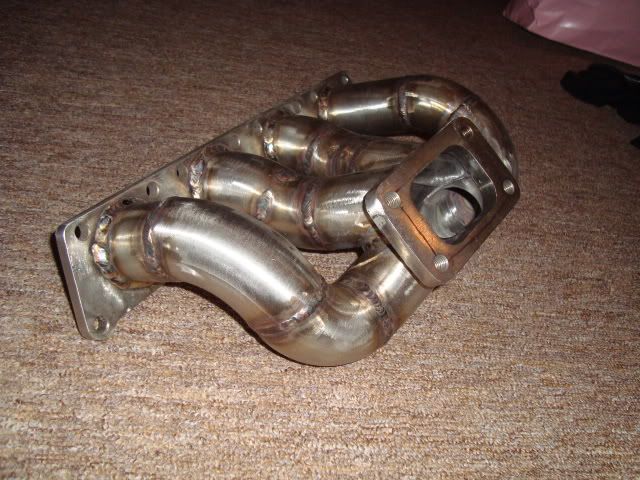

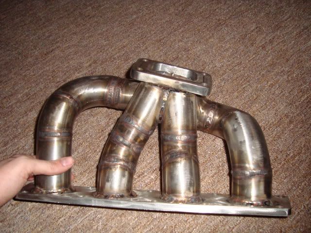

just fabbed up the exhaust manifold, enjoy.

im glad you went with the butt-weld method. homegrown turbo headers are a big part of a turbo build, i think. and are a part that actually make a motor sexy.
looking good. very good. keep up progress and maybe itll be before springtime, huh?? :bullshits:
Wizard-of-OD
Post by Wizard-of-OD »
He is going for the moon....will make 600+whp no issues now :-D

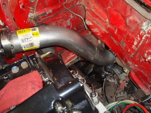

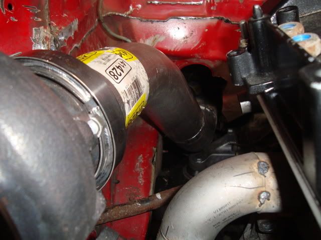

downpipe making up.....
cut this last 90 a biiiit to short, so that needs to get fixed and then another 90 will attach to that and go down the tunnel.

vagrant, how did you weld your header? TIG? I like it
Zerb, are you finishing the welding on yours? I notice it says 'Vibrant' on the header piping, where did you get it?

q20v wrote:...I notice it says 'Vibrant' on the header piping, where did you get it?
Here's a good place:
http://www.vibrantperformance.com

rs beat me to it. i got it through work (napa) but its made by Vibrant Performance

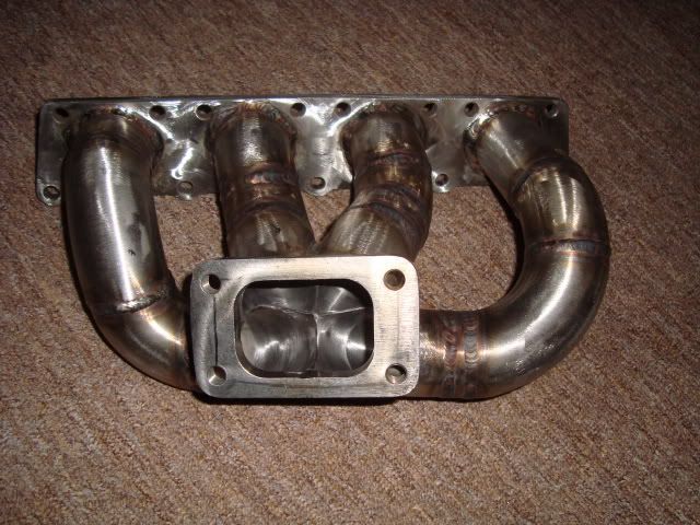

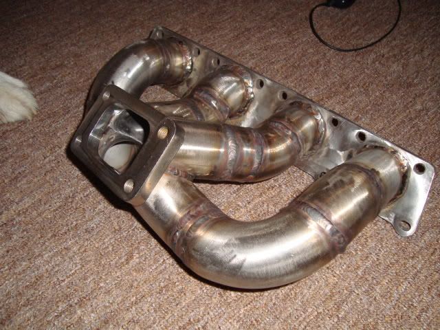

got the exhaust mani back today, yes...there is no external wg flange/tube on there yet. and yes....i am aware that i need one. looks pretty good if you ask me, will most likely be getting ceramic coated @ swain tech once the builds nears completion.

hmmmm. i wanna see it on the car. give me some ideas. i think i want mine more towards the front of the motor.
and it looks like it warped the crap outta the flange. you may need that doctored up some.... mine on the rabbit was that way....
vagrant_mugen
Post by vagrant_mugen »
holy shit! hes right. that head flange looks like its out 3/8"!
you gotta bolt those things to the head, turbo and wastegate when there gtting welded. i saved both the head and wastegate flanged from warping at all by bolting them down.
Zerb
Posts: 858
Post by Zerb »
the flange that sits on the head is perfectly flat, it was machined after it was all welded up. it was done with it bolted to a spare head that i borrowed from someone, but it still did end up warping just a bit.
