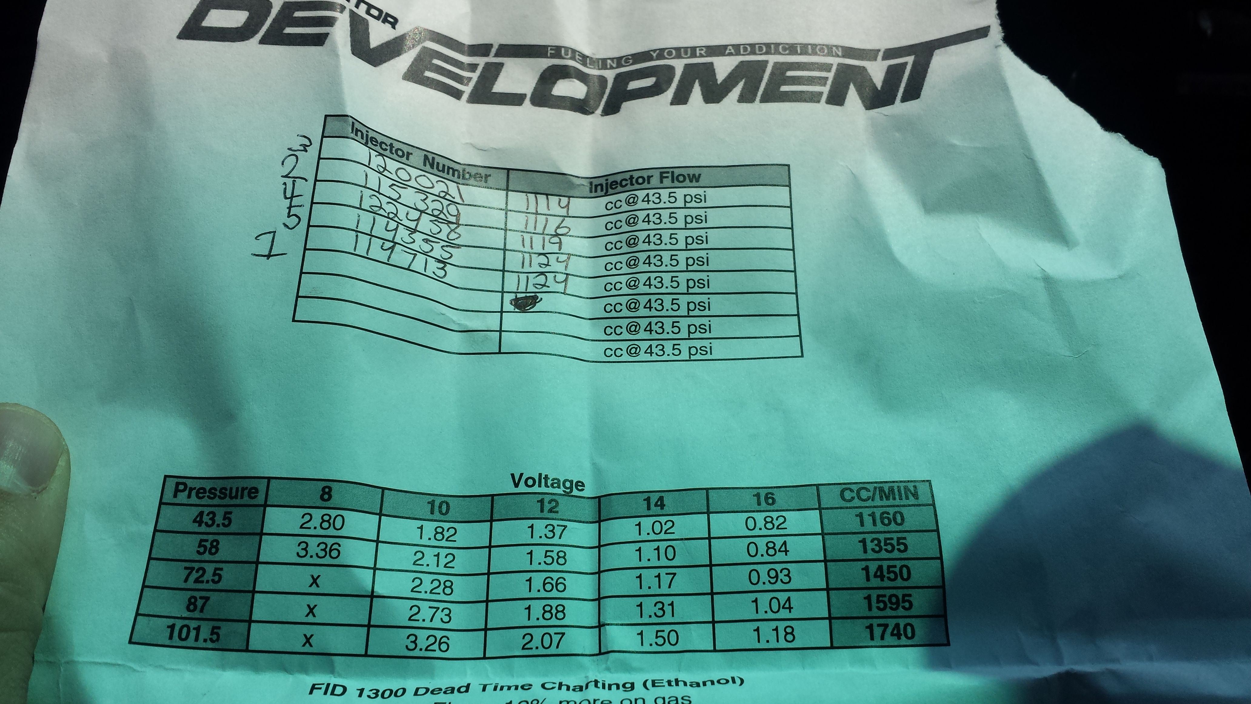

Not really sure of how to use this settings area along with the paper included with the injector. Somehow I feel like I should use the simplified tab for this fix. Not really sure here
- 20160508_120304.jpg (3.25 MiB) Viewed 38140 times
Or is this one of those instances where there's no direct correlation between those numbers on that table and the settings in vems? In that case I guess I would have to use the directions on the vems help site to determine the values
With some quick math, your "injector open time @ 13.2v" should be close to 1.21. all I did was get the average for the 12v and 14v dead times. It came out to 1.195, so 13.2 is 1.213. that's is a lot different than "0"!
Bahaha! That's hilarious! Thanks Dave
The units had me worried lol
Before you go throwing that in there, do some reading and see if VEMS uses milliseconds, or microseconds for this. I know megasquirt uses milliseconds, but not sure about VEMS.88a5tq wrote:Bahaha! That's hilarious! Thanks Dave
Ya thing that has me worried is there's no units on that table from FID. Not sure what they use. I'll call them I think.
I just did the conversion and it looks like 1210 u-seconds could be the correct entry.

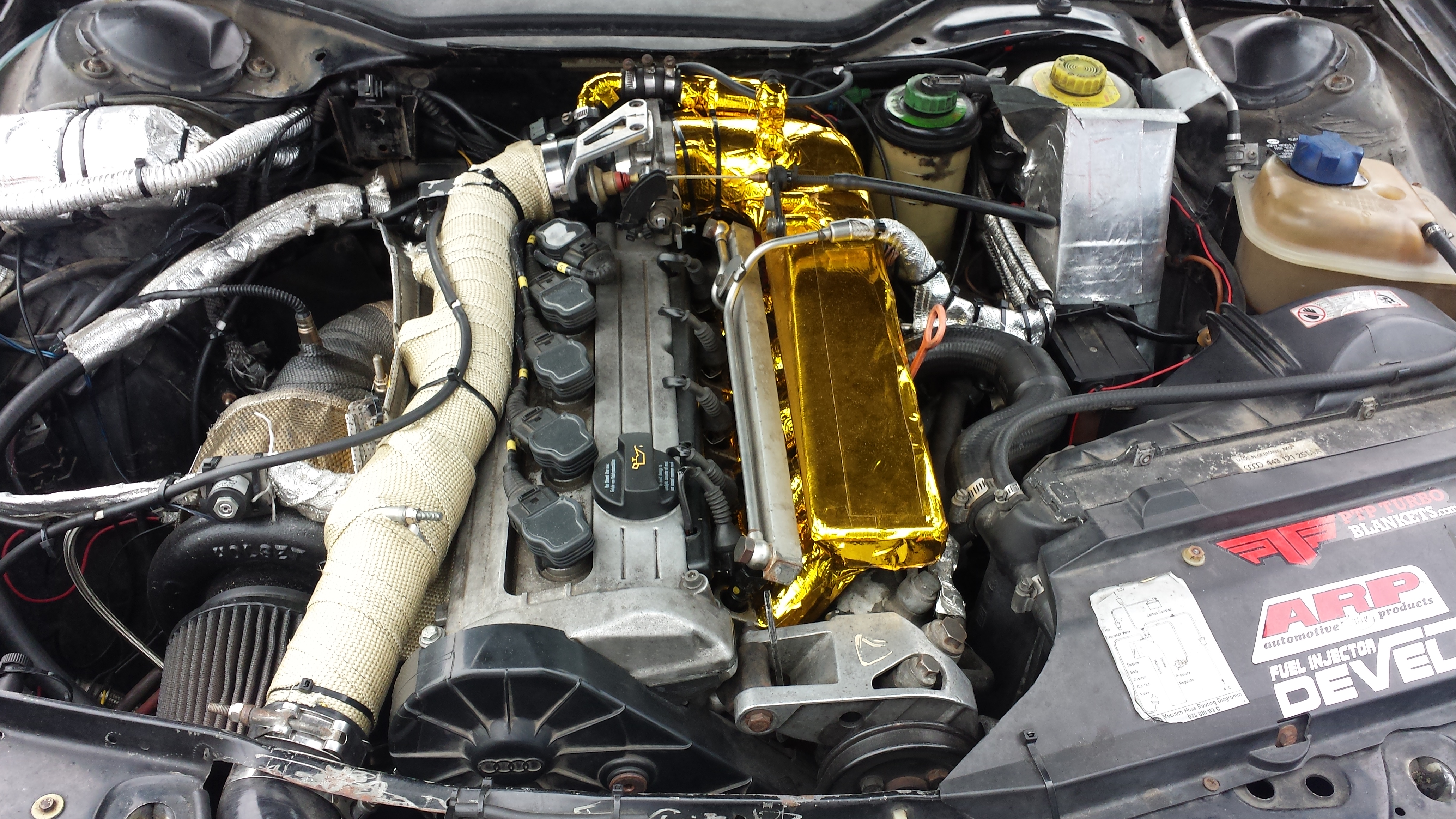

Some of you may feel like I've ruined my car but everything I do is FUNCTIONAL. Lol now look at what I've done!
The intake pipe to the left has reflect-a-gold as well underneath the header wrap. That trick was relayed to me by a local friend with a 1000 hp SL550. Although he did say titanium wrap and not the regular stuff from DEI
It is making a huge difference in preventing heat soak at lights and keeping temps steady. Coolant temps are even WAY down.
I'm happy with it.
NOW I am having a slight issue right now. When cruising my temp will be 30 C and then SPIKE way down to 25 and back to 30 C in a fraction of a second. This is at cruise. I have to check if it's doing this all the time or not though. I will change the sensor on the manifold shortly since I have another new one already.
Thoughts?

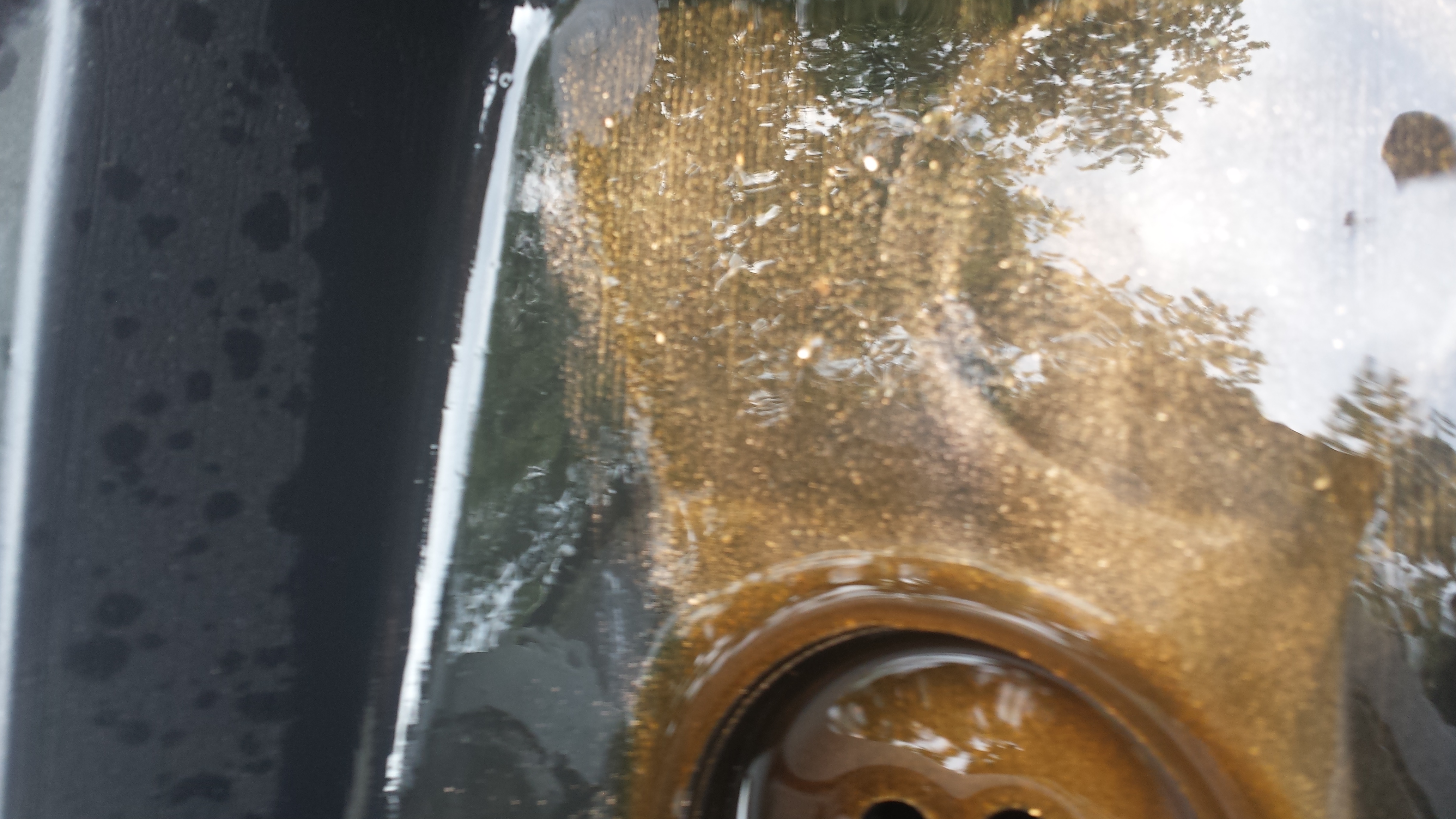

Spun bearing? I had put about 10 minutes on a brand new oil change with valvoline high mileage 20w50 before the awful noise of rod knock began after leaving a gas station. I barely made it home. Ya I drove it 12 blocks home too! Low rpm but it won't matter lol. Pretty sure the block will be junk. At least I have the other motor. I'd like to open it up and put these in it before transferring it over:

What is that a picture of? Don't get eBay rods man. Even scats are junk straight out of the box without a little work.

That's a picture of the oil I drained out before I did a very wasteful oil change
Not my finest moment lol. I was certain the noise I was hearing was from the valve train and even after I saw the bearing material I began the "nah" faze hah. In my quest to ignore a bearing about to go, I wasted a $26 oil change special which is all on me lol.

Wow! The pic didnt load for me last night. Looks like you drained glitter out of that thing. Very sad that it happened, but I'm sure you will get it back and better!
