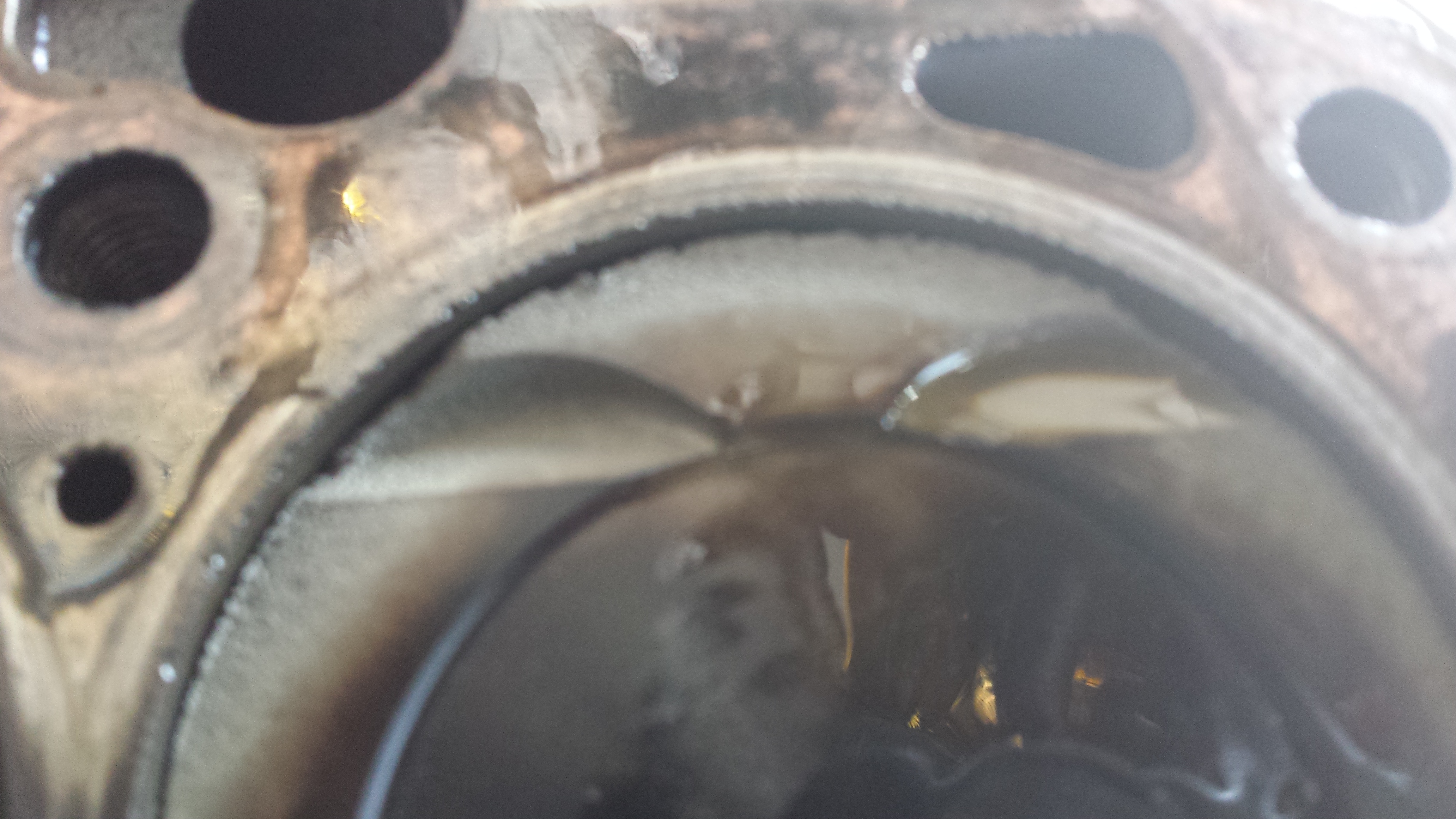

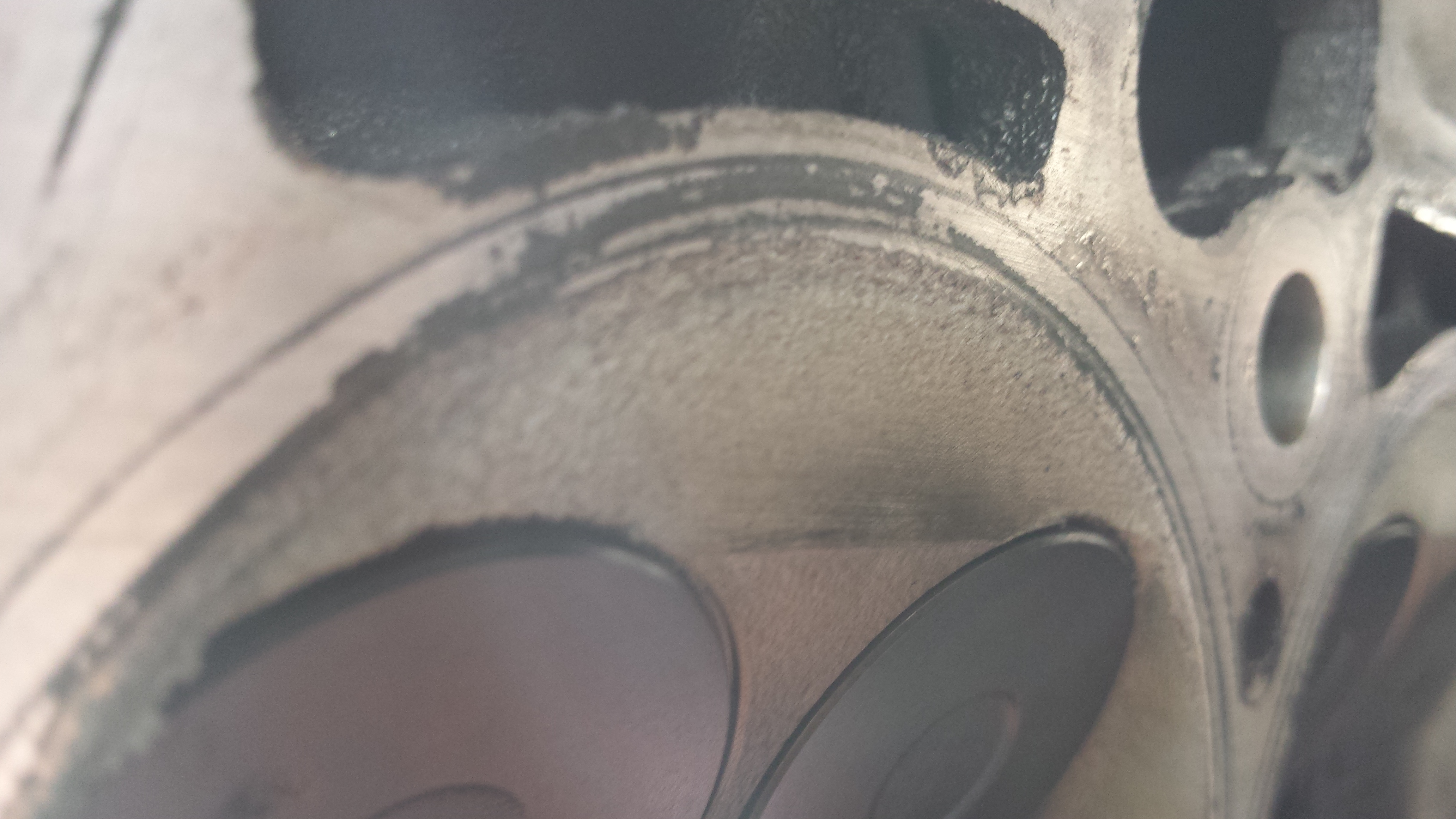

by 88a5tq
In a recent poll of middle-aged European motors, 4 out of 5 pistons admitting merely discussing launch control was enough to make them ill.
WTFFF!?
Yes you read right. 4 out of 5 pistons and cylinder head chamber areas directly next to the intake valves looked as though mice had been chewing on them. Cylinder head is scrap now. :wah:

by 88a5tq
Anything to do with overusing LC? I thought my ignition table was still somewhat conservative
