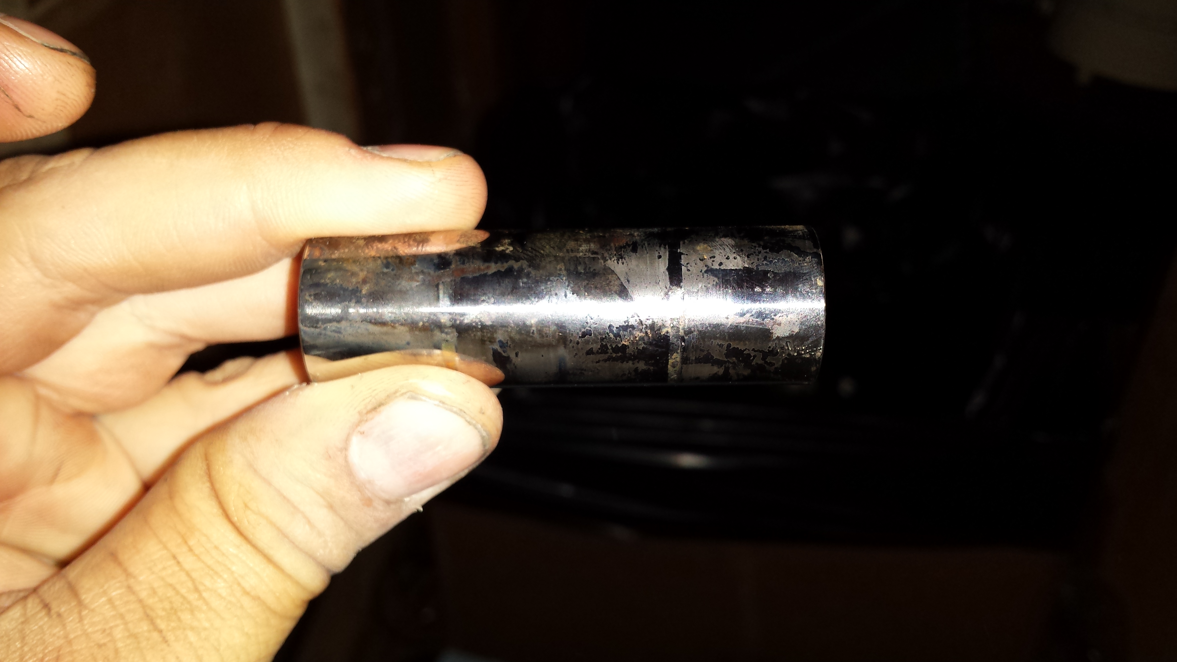

BOOM! Out, all by myself in fact. All my help kept falling through. So I'm stumped about what happened to the wrist pins from the spare motor. So weird but I let them soak over night in a box lined with a huge black garbage bag with a high mix of pinesol and water. It appears that the dye from the garbage bag transferred to the wrist pins where the we're laying on it or something. When I run my nail of the stains they seem to have more drag on my nail than the polished areas. Wtf am I supposed to do with these to salvage them? TIA Above is after sitting in paint thinner all day
I test fit the pin into a rod with no problems at all. No resistance. Seems to spin quite well in there
Run em?
Run em?
I would definitely not run them unless you don't mind the possibility of having the engine out again.
They looked perfect before I put them in the pinesol except for the oil lines left. I will try to clean the crap off before I go looking for new pistons. I don't think those pins are sold separately

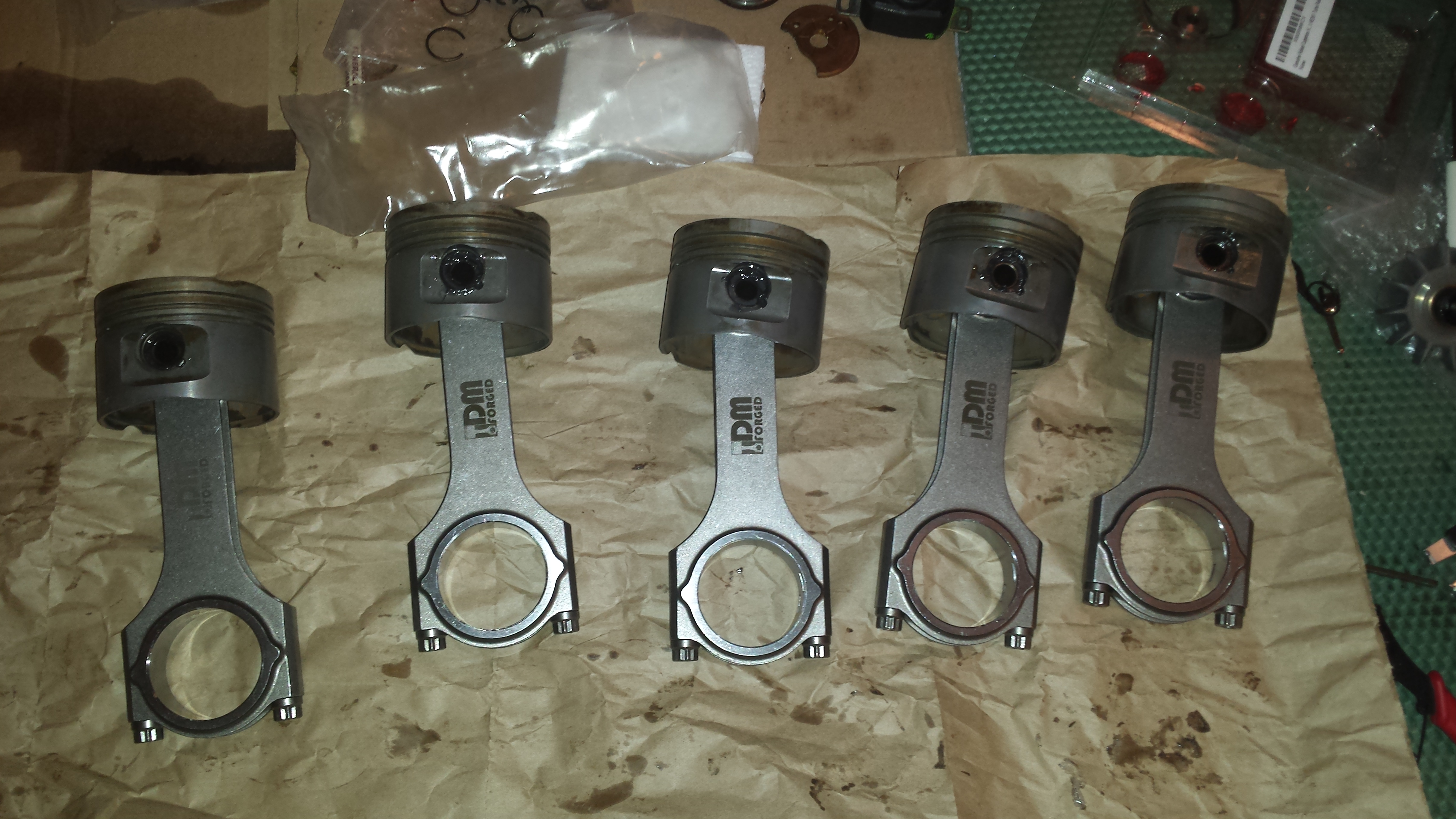

I recovered my blown motor's nice wrist pins. Thank god they survived unscathed! Once I got that motor torn down I found ALL 5 cylinders had broken oil control rings. They were broken in a very uniform fashion that had the bottom portion fully intact but the top of the ring was broken in an eerie manner that looks like equal lengths intact and equal lengths broken away, one after the other. Very weird to see while tearing away at things lol.
These will go in soon but first getting re-ringed at the shop and tolerances checked.

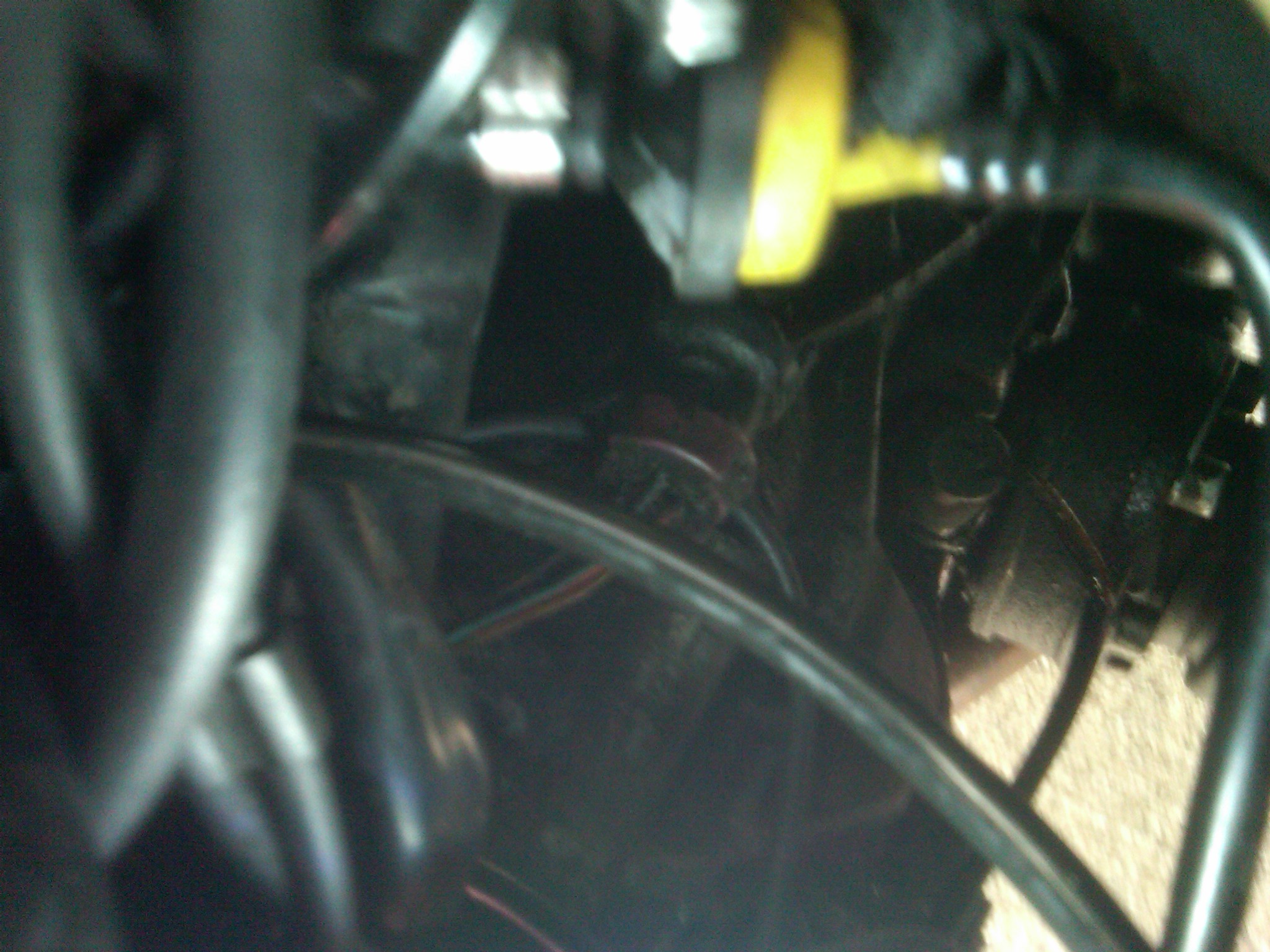

Help! Just did first start only to be greeted by an oil pressure warning. Car barely idled probably because of fueling but I did find oil at the turbo feed line outlet. I hope its polarity of the gauge sender unit (which had no reading at idle) as I've switched the wires on the terminals. I will test again shortly. Pretty certain I reused all the good sensors from the blown motor
Anyone seen this problem be caused by a grounding issue?
I feel like it could be related to the intake spaxcer and a grounding issue possiblu. I hope
I just got a stabbing pain in my brain lol. That centered connector is disconnected hah
