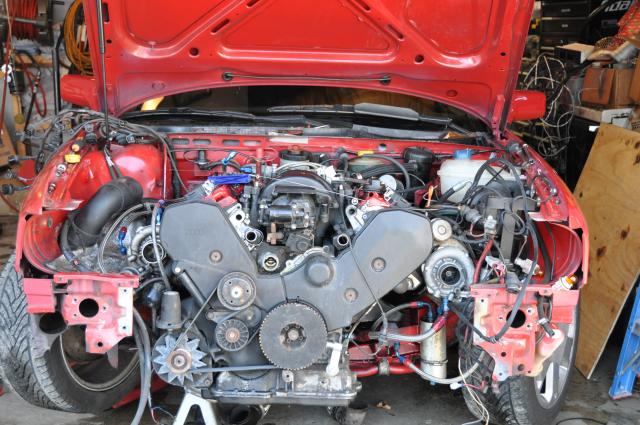

torqued the head studs and cam caps down tonight. Also modified the tool I built to rotate the cams at the back of the heads (little slot at the back of the cams) to be a bit stronger.. with the stiffer valve springs it was bending the metal at the end of the original one I built!
Next step is to really think out my drain locations on the block. My turbo drains that I setup on the 3.6 work fine, but the problem is that I need another good drain location for crankcase oil return. I've got a few spots on the block in mind.

a4kquattro wrote:while disassembling I discovered a rather significant exhaust leak on the drivers side turbo. This *might* have affected spool on that bank
Marc, when I took apart the white 2.6L stroker S4, my GT30R literally fell right off. Tony @ EPL told me when he was tuning it the car kept loosing power on the dyno, even when he raised the boost, wouldn't be surprised if you were loosing lots of power due to the same issue. Anyways, looks good!
yeah, when you track high HP turbos the heat and vibration plays hell on the fasteners. I used high temp loctite on the fasteners, in this case it was the studs securing the turbo to the manifold that started to back out (the nuts were still securely in place). next step is some nice mechanical locking tabs I seem to recall seeing in the 034 motorsport catalog
