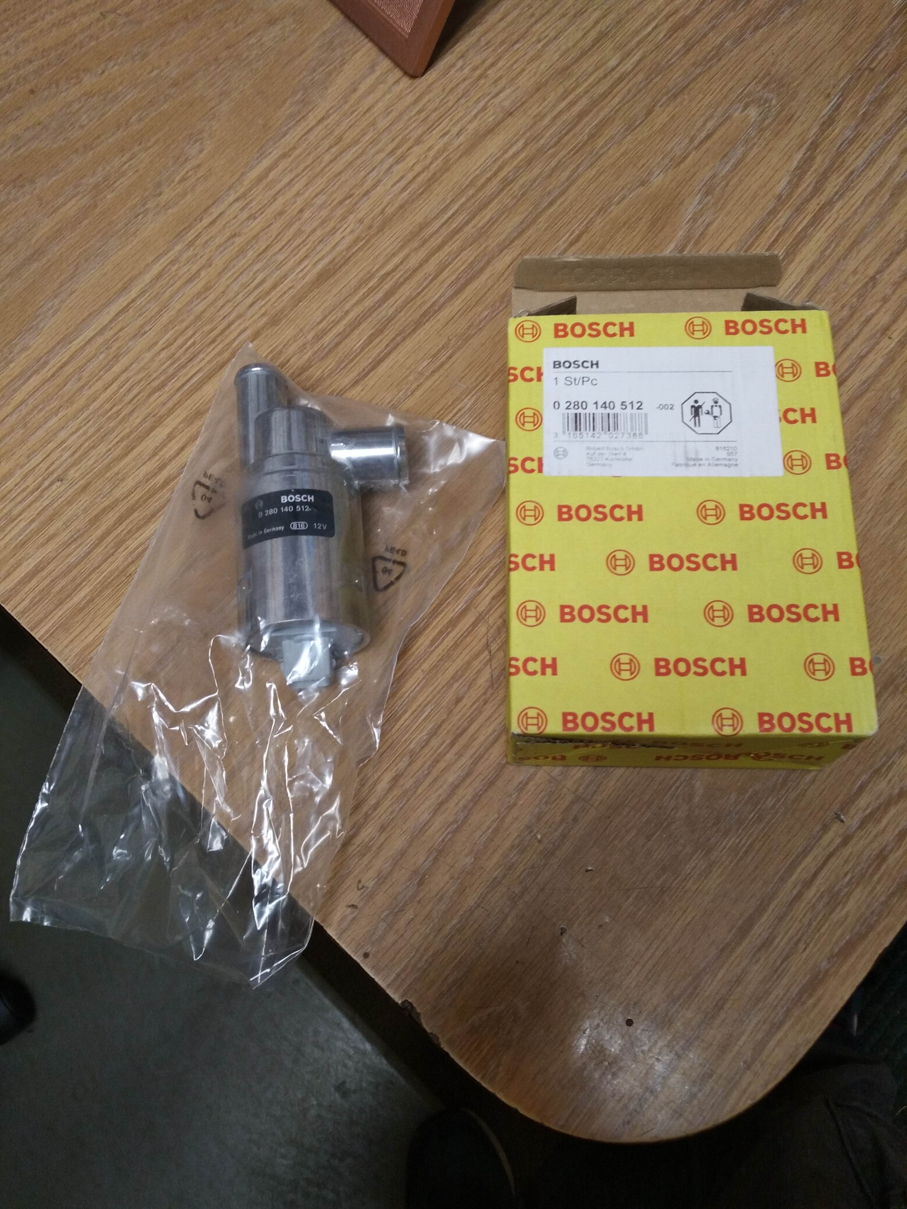

Post by 88a5tq »
Just this week alone:
One defective IACV from eBay
One defective m1-205 oil filter Frome Autozone (had a rattle internally)
:idunno:
I quit buying non oem stuff a while ago for this reason!

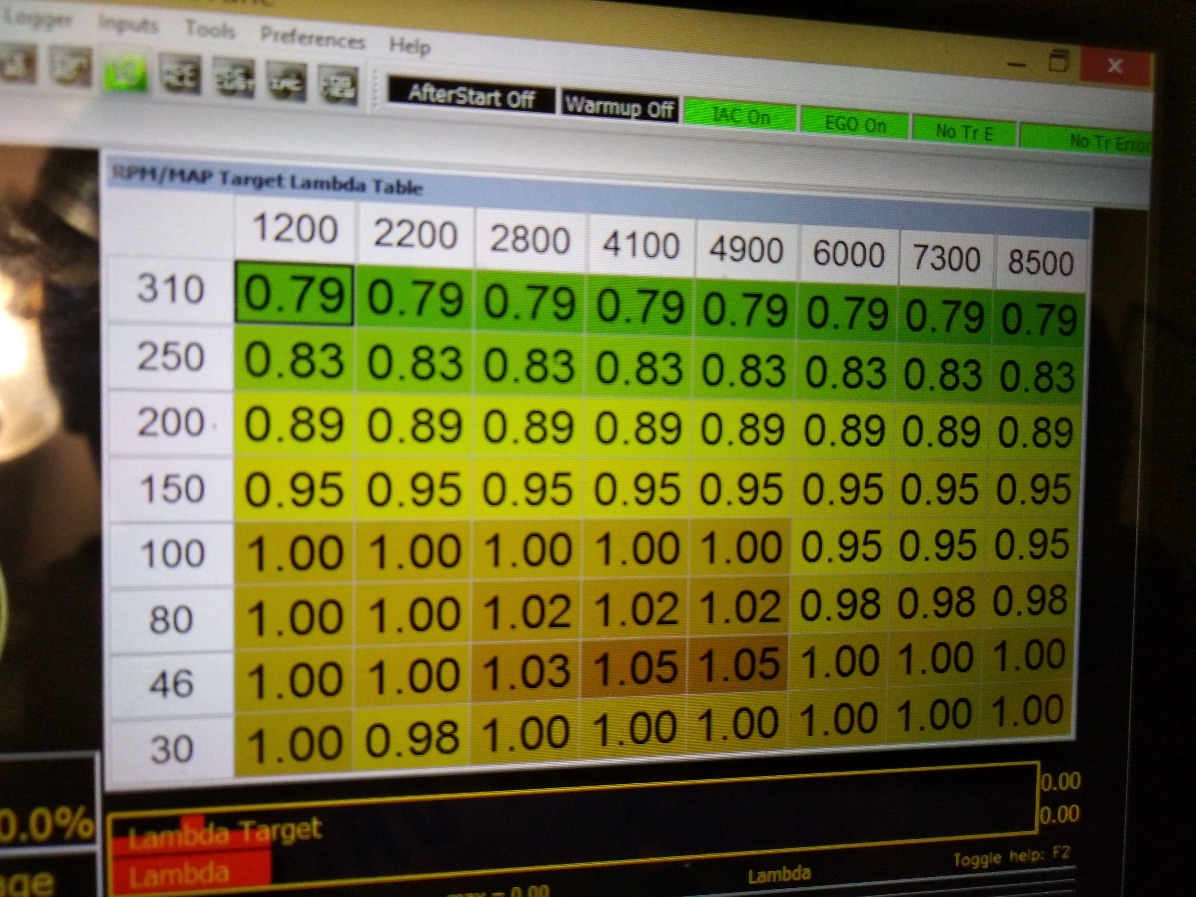

Is this reasonable you guys think? 0.79 lambda at 30 psi seem too rich or good? This is with the new direct port meth injection spraying. Feels very healthy at that afr.
88a5tq
Posts: 1553
Post by 88a5tq »
Marc says this all looks good for lambda target. Happy Thanksgiving everyone!
Yeah doesn't look bad to me. Happy Holidays
