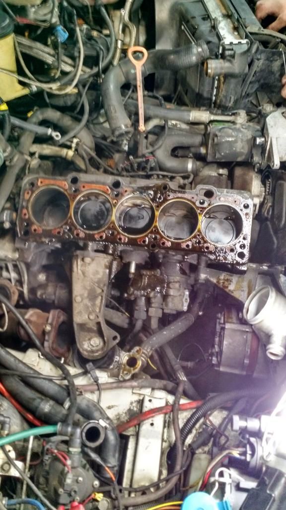

Vegas is at, what, 2000 feet? so a little altitude. The car is down with Colin in Southern Nevada for a little while now. He had plans of driving that daily for a little while, but seeing as the headgasket picked an ideal time to esplode, looks like it needs some stuff and things done before that happens.

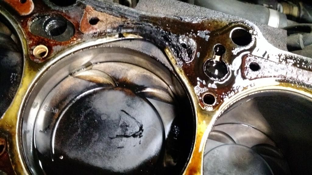

So, some things have been happening.
- IMG_20150201_160650273.jpg (2.19 MiB) Viewed 46168 times

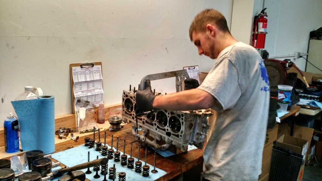

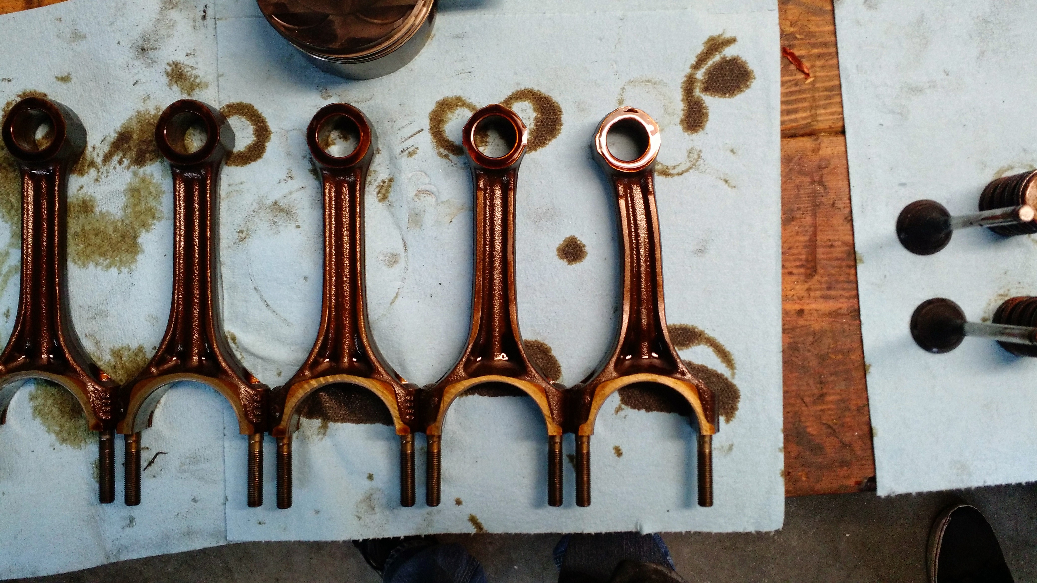

So. Found a bent rod, found where the gasket blew up, got the steering rack swapped out, found a decimated pilot bearing, rebuilt the head with new Valve seals. Among not shop things, the mule DESTROYED a 335i, had some delish food, Got some fun rides in a quick car, saw some bad-ass projects, and had some fun times with Colin and friends.

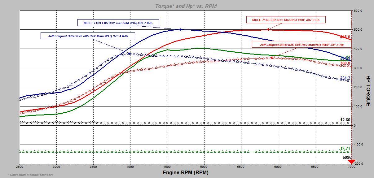

Nice! What is the mule running now, an efr kit?

Re: Phil's 20vt 5ktq, Get Bent
That is where the FB EFR graph came from, I think... (the mule)
Wait, what?
Which EFR are we talking, for those of us not on facecrack?
Nice work, that's the turbo I picked too.
Can someone post the graph? (Do I have to ask?
I don't know why it wasn't put here in the first place.
I can do it tonight, travelling with the family today.
I can't make my phone do it.

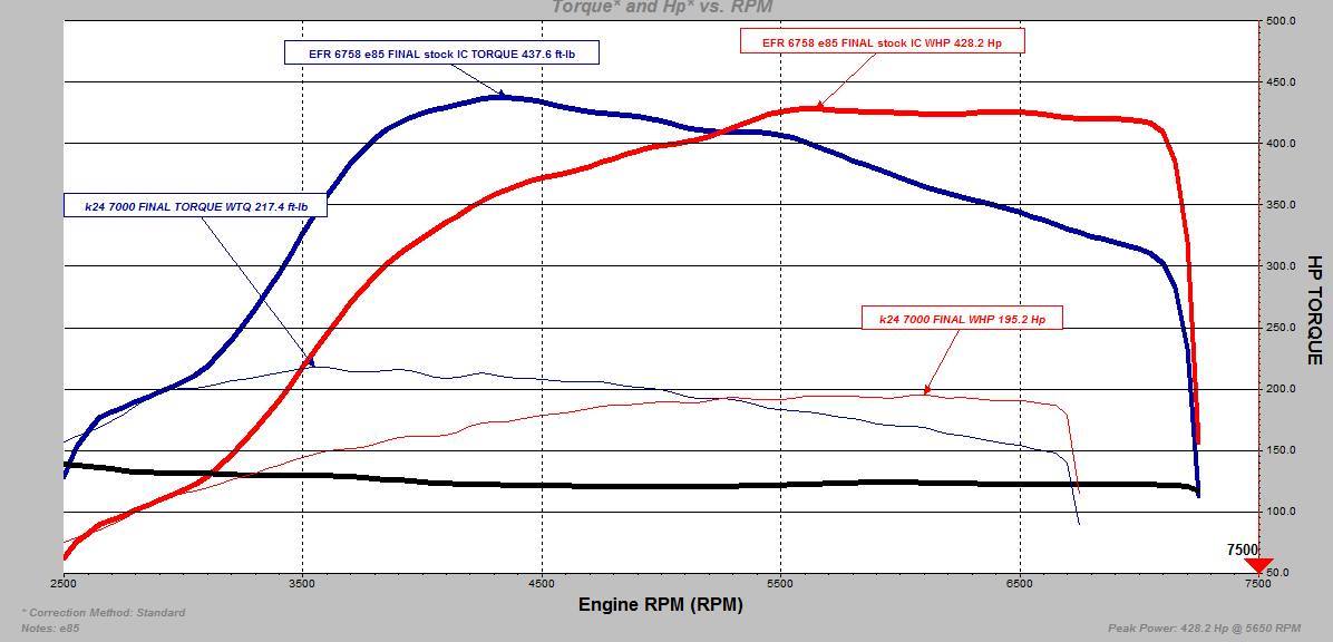

Mule on 6758
and currently mule on 7163
That is hilarious. Hank is going to have to get a new dyno that reads below 2k at the rate this is going.
Stock ic too. Corn is amazing
Both those pulls were on the stock IC, He managed to fit a bigger FMIC in there recently, albeit a not very good one.

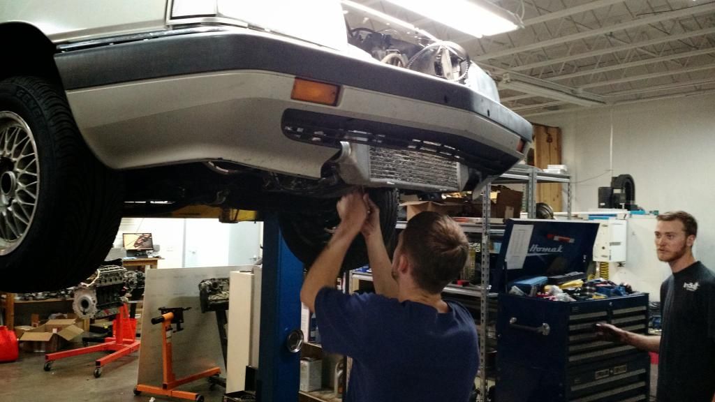

Definitely made a lot of progress this weekend on Phil's car! Could have gotten more done probably but Phil wasn't down here that long and birthday celebrations and hangovers put a dent in motivation. Plan at the moment is a 6758 on the 5K. I've got almost all the parts to start putting it back together, just need to do it! And swap new trans and diff in aswell but that's a one day ordeal.
Dyno numbers were stock IC, The Mule has an FMIC now. (That is probably much too small, but way mo' better than stock)

If I had kept the 4k I think it would have seen an efr with qsv eventually. Damn I wish I had the money to buy that car back lol
Those graphs are awesome. So the 6758 spools like a k24 and the 7163 spools very similarly to an rs2. I would really love to see some pump 93 dyno pulls.
Spools nearly the same, transient response is (far) superior on the EFR. Especially the 6758.
I'd like to see some pulls on 91 octane for us poor saps stuck with it, 93 would be good too though.
