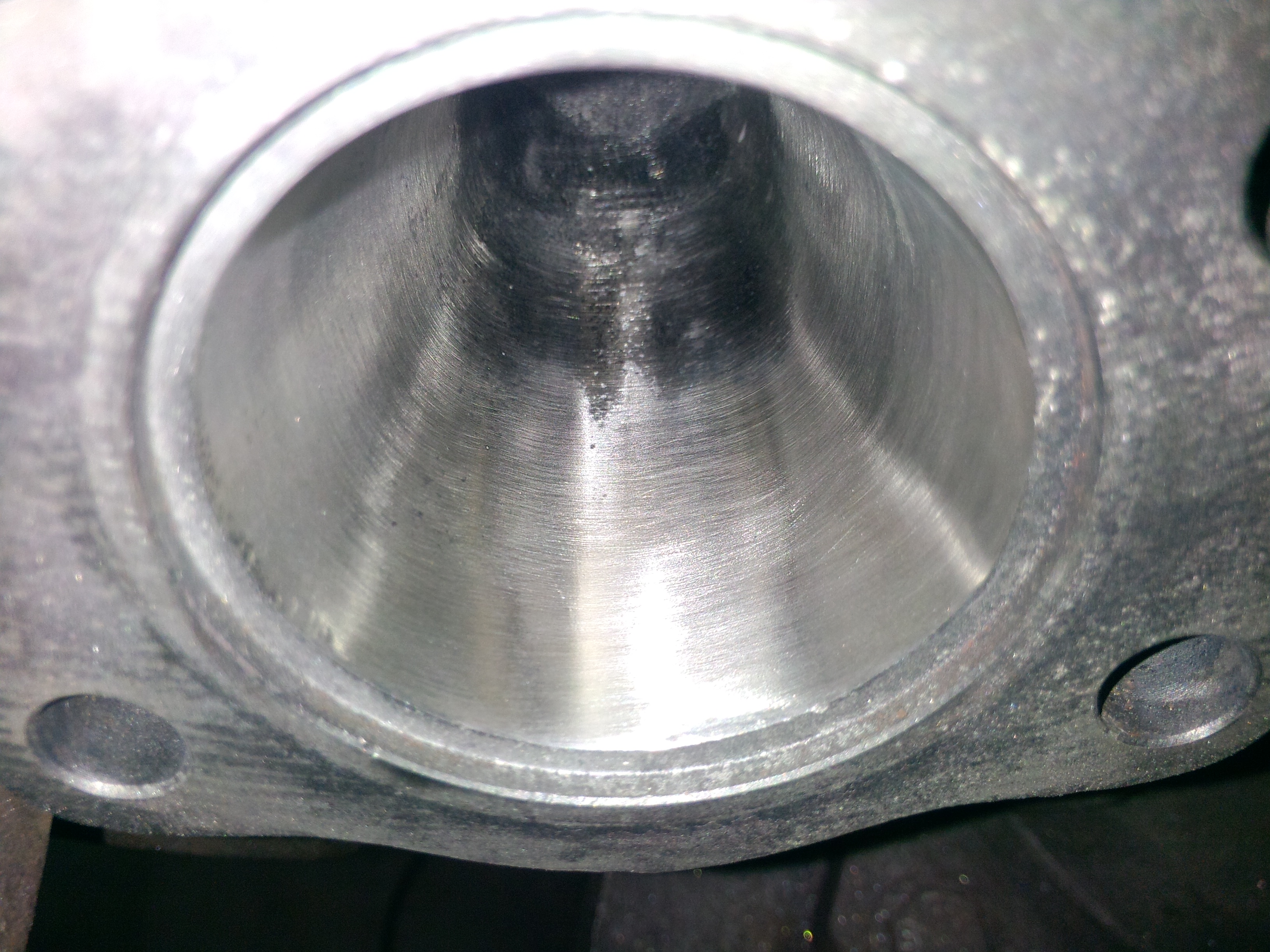

did you already finish the polish?

got mine good and started.

What did you use? Or did you just hand sand it?

6 inch long shank (flame) cutting burr. 60 grit tapered sanding cones, and 120 grit flapper drum. thats not done yet either. it will be a mirror if I have the time to do so. I got maad skills.
