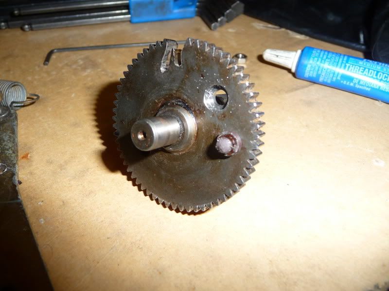

mwuhahaha, VGT is now functional 8)
Link to video
(hint, watch the video with good speakers for the bass note in the exhaust when the vanes are open

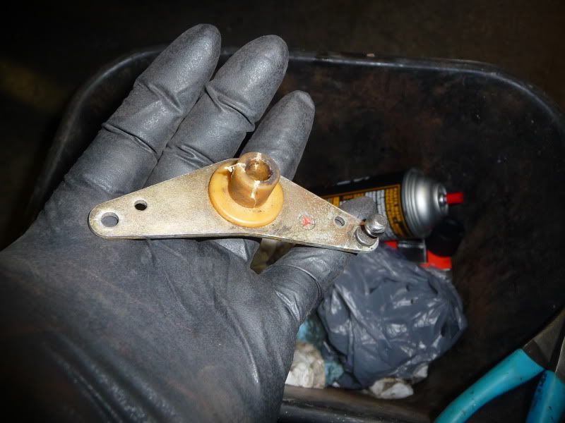

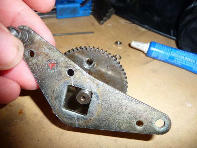

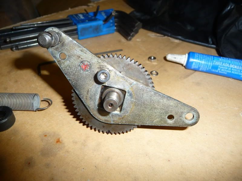

I have two of these turbos, and i butchered one actuator assembly to come up with this concoction. Aaron found a thread on some other forum of a guy using just a spring to hold the vane assembly closed, and the backpressure opens it automatically. The electric motor is geared down through two gears to give it torque over the actuator arm, I ended up ditching one gear and modifying the main one(which rides in two bearings in the actuator housing) with a throttle linkage from a mercedes.
original arm with plastic bushing molded in
knocked out the holset magnet that's used for locating the gear so i could put a bolt through that hole. these gears are hardened something tough!
collar for one last measure of keeping it on there
i've been pretty busy otherwise and still haven't had a chance to figure out my computer communications problems, but the good news is, the range where this thing runs... it RUNS! the turbo spools hard! i'm still blown away for 15psi of boost
Link to video
)I have two of these turbos, and i butchered one actuator assembly to come up with this concoction. Aaron found a thread on some other forum of a guy using just a spring to hold the vane assembly closed, and the backpressure opens it automatically. The electric motor is geared down through two gears to give it torque over the actuator arm, I ended up ditching one gear and modifying the main one(which rides in two bearings in the actuator housing) with a throttle linkage from a mercedes.

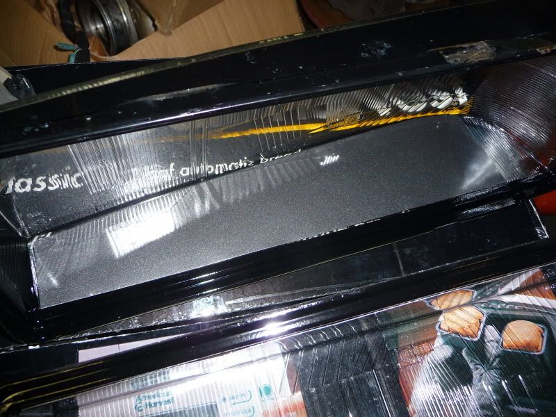

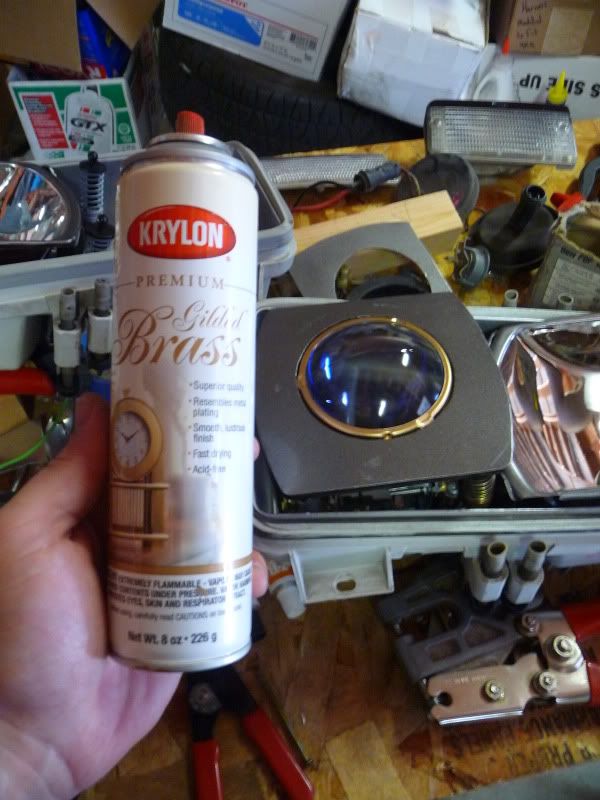

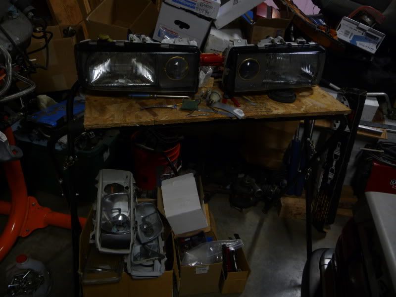

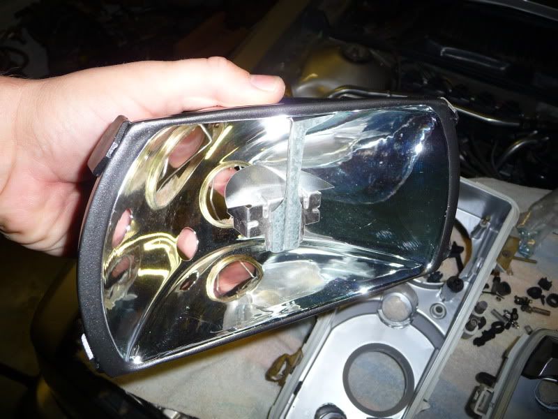

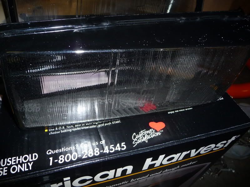

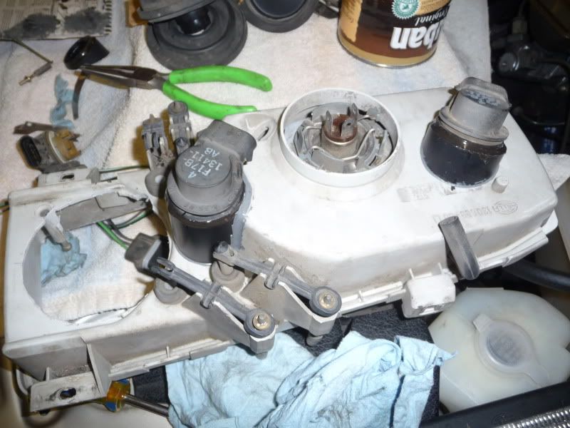

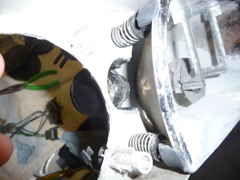

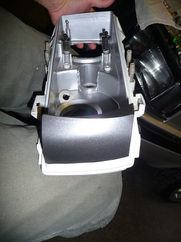

i've been trying to use my spare time to finish another project i started 2 years ago for this car... the HID lighting with bi-xenon projector housings. i cut a bit too much out of my other light housings, and never could get a mounting solution that i was happy with. luckily for me, my friend was out at a wrecking yard, happened across a set needing attention with a broken lense and whatnot, so i traded him my current set on the car, and took his for the housings to start over again.
since i made the front cross member/intercooler mount, it interferes with the front indicator lights and i can't put the bulbs in, so i came up with another solution. mounting indicator lights in the euro housings... i found some busted light housings off a ranger so i could cut the bulb mounting flanges and JB weld them to some ABS pipe, then to my housings, like so

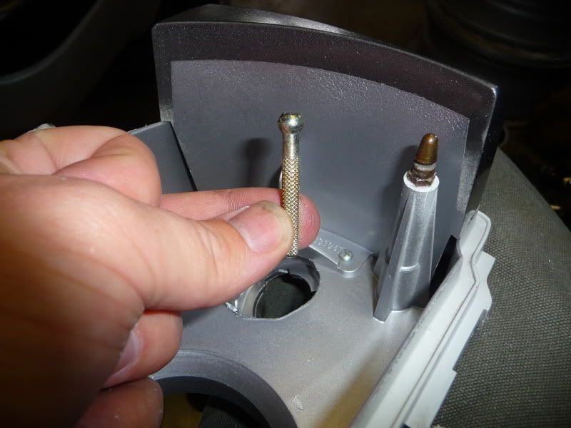

painted inside silver to help with reflection?
the main buckets were pretty fried, so i used the old ones i had, which are mint. thing is, i'm mixing Cibie with Hella's, so i had to change a mounting pivot.
this time around instead of all black, i decided to use a metallic gray. i think i like it so far.

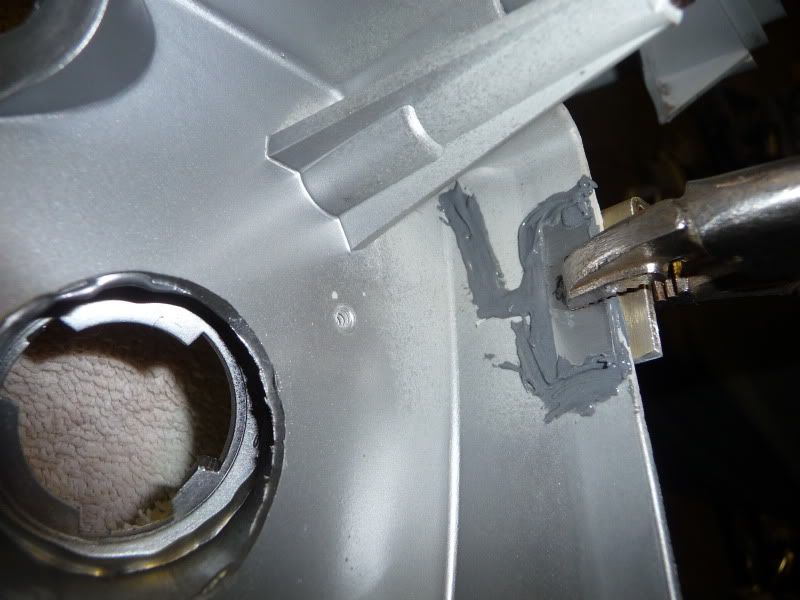

had to fix a crack :(
ok, hopefully i made the right decision on this... i was just trying to find something to set the little rings off..
i have to finish the backside covers yet, but then i can install them 8)

those indicators would never fly here..at least if the only ones you have on the front of the car? are they the only ones on the front?
dubsmith
Re: Derracudas zermatt 20vt 4kq project*vids*
Lookin good! I'd like to think i had some influence in your color choice for the rings. lol
Katman
Looks vey goo, and 'factory' too..!
What did you use as donor for the acutal projector assembly?
On the turn signals..
I was thinking of moving turn signals/parking lights into my eurolights. I was thinking that by removing the plastic 'filler' piece at the outboard, end, would make the perfect place to put them. Could be seen from the side then, also..

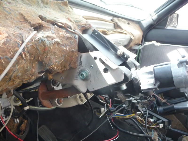

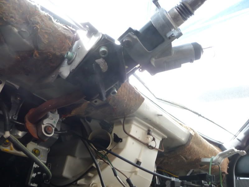

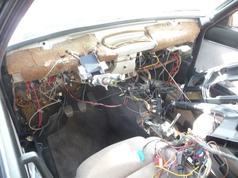

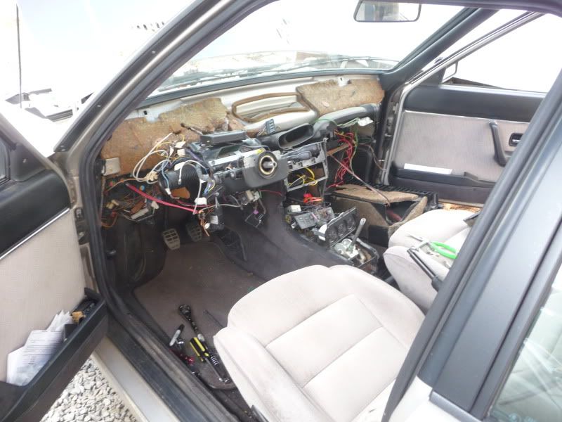

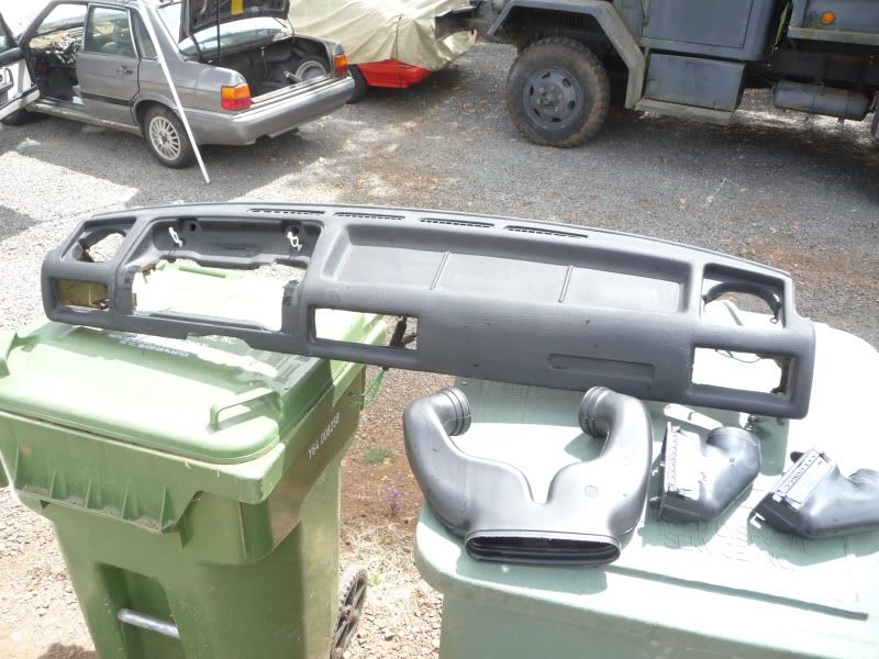

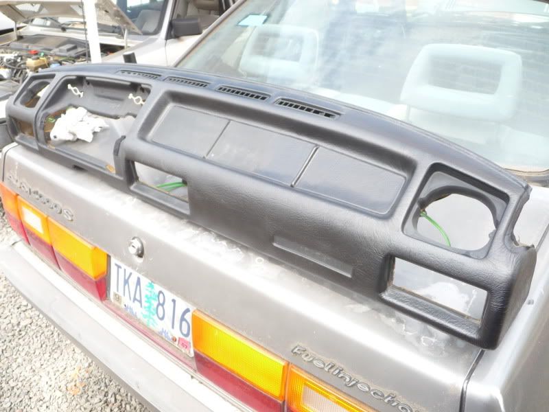

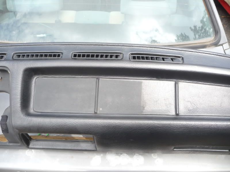

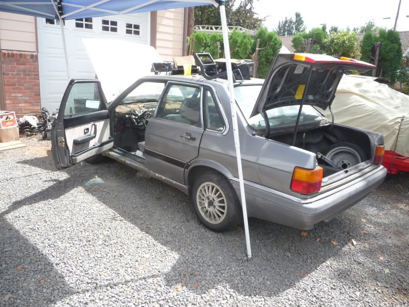

Soooooo, mission Back to the Future was a success. I ran across a 4ks parts car for cheap and i robbed the dash wiring harness and dash/cluster/etc out of it to put my car back to stock inside... where i would have been now if i never did the dash conversion and had an eye sore to look at for the last 2 plus years.
While things were apart, i cleaned all the ventilation ducts out with water, simple green, and brushes to get 25 years of dust out. Also re-dyed the dash to make it black and new looking again (used forever black trim restorer), and reconstructed the steering column bracket to put a 4kq steering column in.... which meant i could go back to one key for the door, trunk, and ign. (YESSSSSSSSS). now i have all the functioning dash warning lights, homes for the hazard,rear window defrost,and dash light dimmer switches.
hapless(helpless?) donor
clean up time
I've been dyin' to do this!
anger being removed!

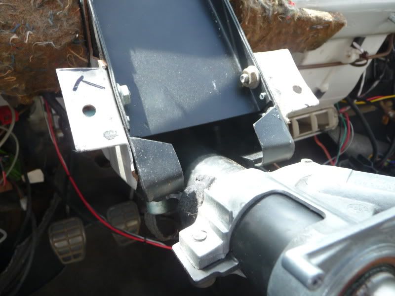

kinda naked without the harness in the left side. man, what a snake pit!
a bit of a headache to redo this bracket :(
rebirth *sigh of relief*
i also mounted the remote face/controller for the V1 if anyone can see it.
clean up time
Dr.Strangelove
The dash looks great. What kind of dye did you use? I'm thinking about doing the same thing to my seats.
