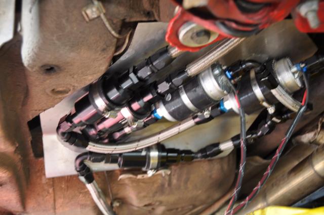

some updates on the fuel system upgrade today. I started mocking up the fuel pump tray with the pumps and filters. final version will include rubber insulated band clamps (IE not zip ties). I'm short one fitting, and I'm going to re-do the bend near the driveshaft to get a bit more clearance. all in all pretty pleased with the layout.

600 liters/hour or about 158 gph (@5 bar) is the capacity of dual 044s.oldsklaudidub wrote:Nice. whats your gph going to be?

Whoa. Having just spent some time with this most undesirable part of my car, I really appreciate that setup. Nice work. Are you going to clamp them down with something more permanent?
EDIT: I just read this:
Sorry, I was distracted by the picturesfinal version will include rubber insulated band clamps (IE not zip ties).

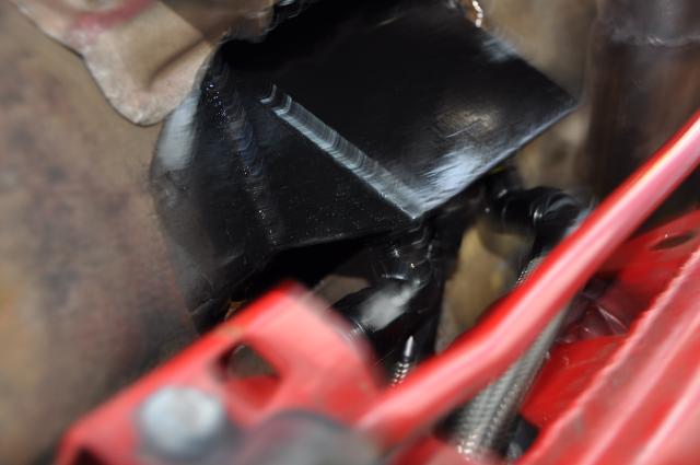

fuel system is just about done. just need to run the power wires for the pumps into the car. system is now leak checked and base pressure has been set
shot of the tray with clamps and rubber isolating the components:
(blurry) shot of the sump that sticks through the underside of the car, I used 1/2" NPT female bungs, two for outlets, one for return. the return line has a pipe inside the tank that directs the return flow away from the inlets to avoid turbulence.
engine bay side of the plumbing.

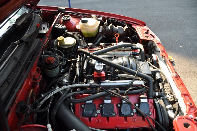

aaaand its back up and running! I had to fabricate a new clamp for my intake pipe as the old one interfered with the new fuel lines/rails. after finishing that (and christening my new mini-mill lathe in the process) I took the car for a rip up the road. Man I missed this car.
