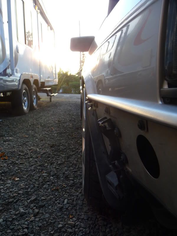

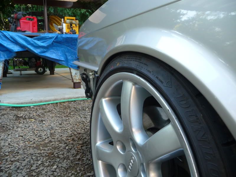

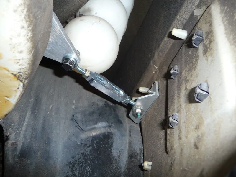

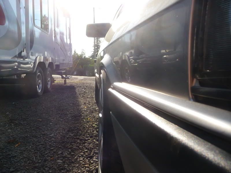

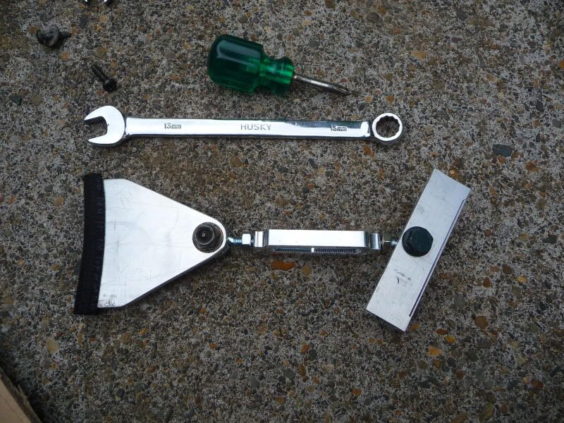

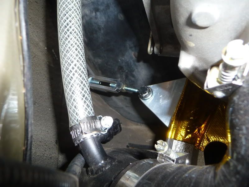

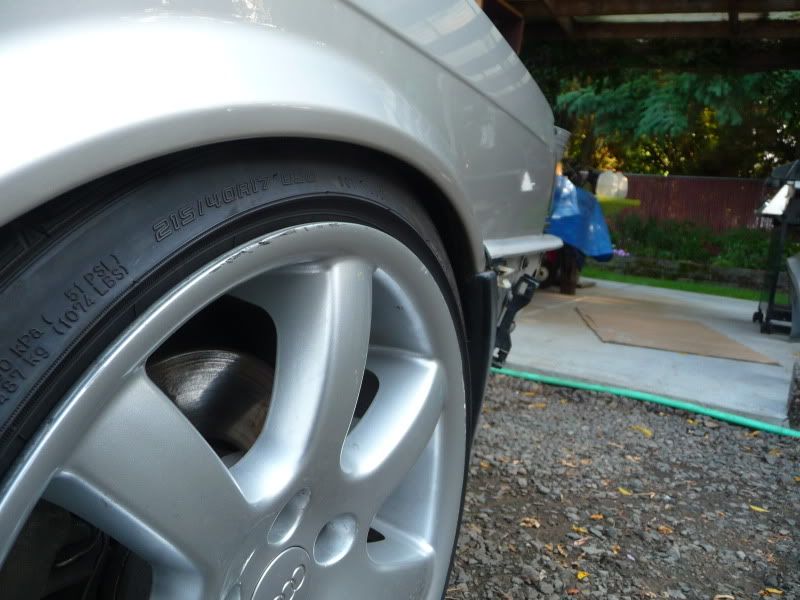

a long time ago i thought about a solution for front tire clearances that i finally got the chance to employ. it requires virtually no body work and gives about .5" at the top of the wheel arch, and at least 1" at the front side of the wheel arch, where it really matters because of how the arch curves in and on a wide tire arrangement, almost touches the tire.
this is a cheapo turnbuckle from the hardware store, some 1"x1" alu. angle, and a piece of .250" x3" alu. strap that is whittled out. it sits between the front sit of the fender arch, screw right behind the top bumper retaining clip, and the flat portion is just wedged into the crotch formed by the frame rail and upper fender support sheetmetal. there's a bit of rubber hose on the flat alu. piece to aid in chafe' protection. then just turn the turnbuckle out and lock the locknuts.
Before
After
it does make sliding the bumper on a little bit more difficult, but i think the added wheel space makes it worth it. too bad they didn't come like this from the factory. so many little things back then could have saved us so much trouble now...
