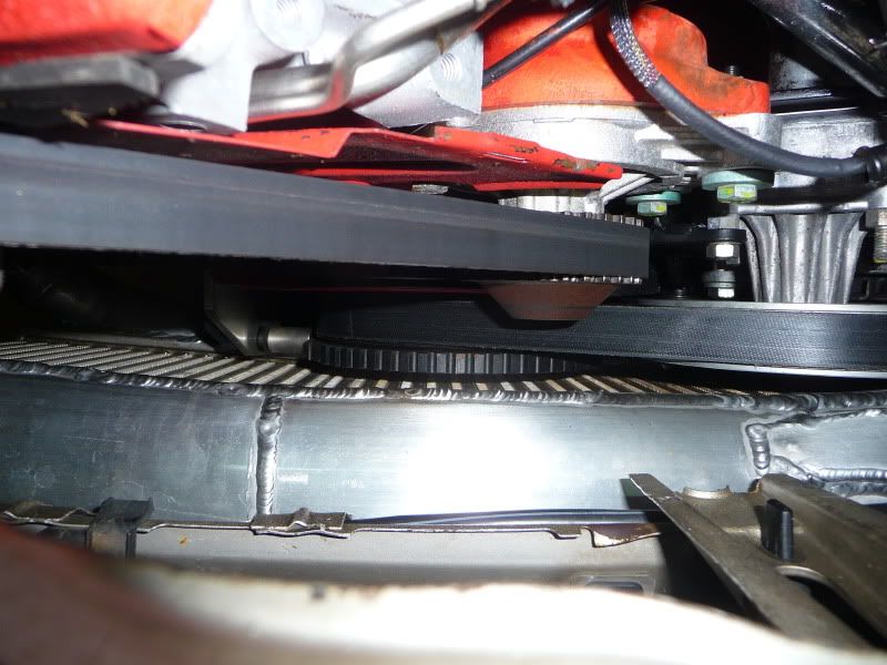

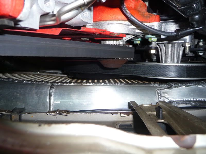

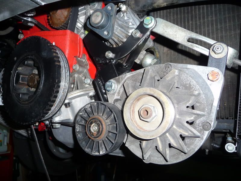

i finally took advantage of my 01E transmissions engine speed sensor hole and put the sensor there to read the tone ring on the flywheel.
before Image
after Image
sensor in the bellhousing Image

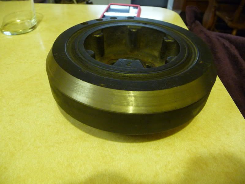

and i also took my new damper and had 1.5lbs machined off the outside face.
i do notice an improvement in throttle response :) i'm sorta toying with the TB wedge removal too.

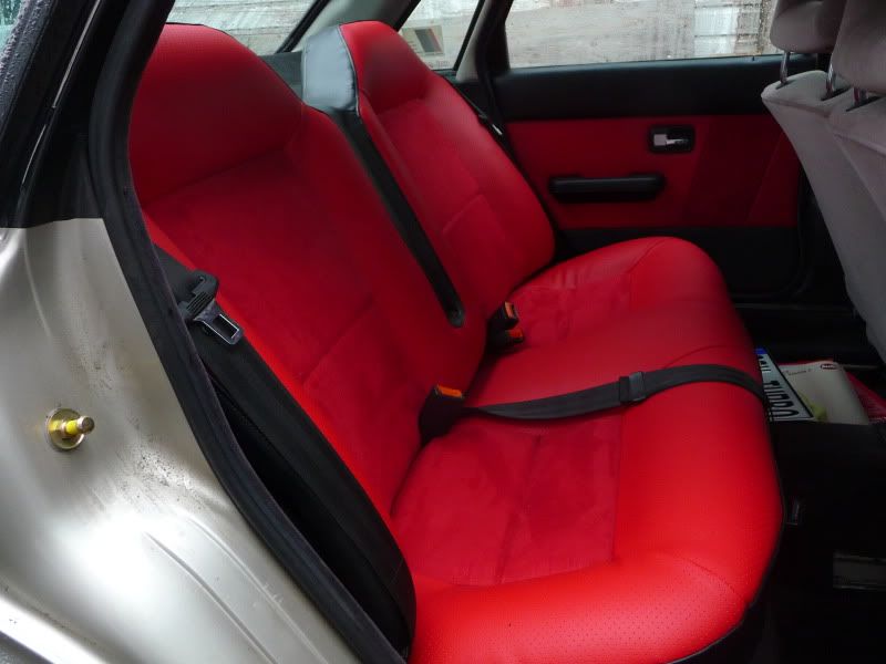

also, after over two years, i finally got the rear seat..
the door panels are together, but i have to change a the top half of the panel because with the padding underneath, it's too thick to stick in the window wipe trim piece :(
Re: Derracudas zermatt 20vt - 6spd - 20vt

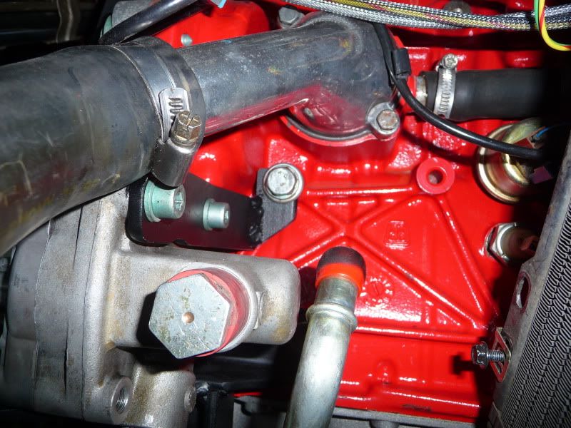

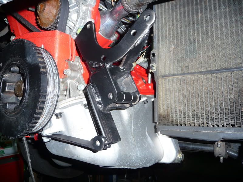

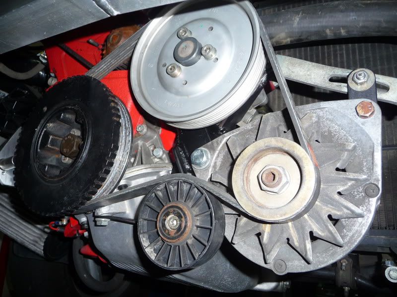

What brackets did you use to mount the PS pump Derek?
I like the removal on the dampener. I will do that tommorrow
PS, I am working on your pm reply.
derracuda
Post by derracuda »
PS/Alt bracket is Derracuda
Oh. I like that.

Those rear seats turned out great!

Way nice Derek. I like the serp setup and the seats turned out nice........and loud. :wink: You know what they say, if you got it flaunt it.

the seats aren't near as bright in person. red yes, but not as bright.

Saw it before but never really noticed. Thats not much "wrap" on the PS, does it slip? Nice work, keep it up!
derracuda
Post by derracuda »
PS pump doesn't slip that i'm aware of. it's as much wrap as i could get without an added idler, which i didn't want to fit in.

Porno red leather! Nice!!!!

Damn, that red leather is some sick shit, I love it. Very tastefully done (sez the resident CE nut) :)
