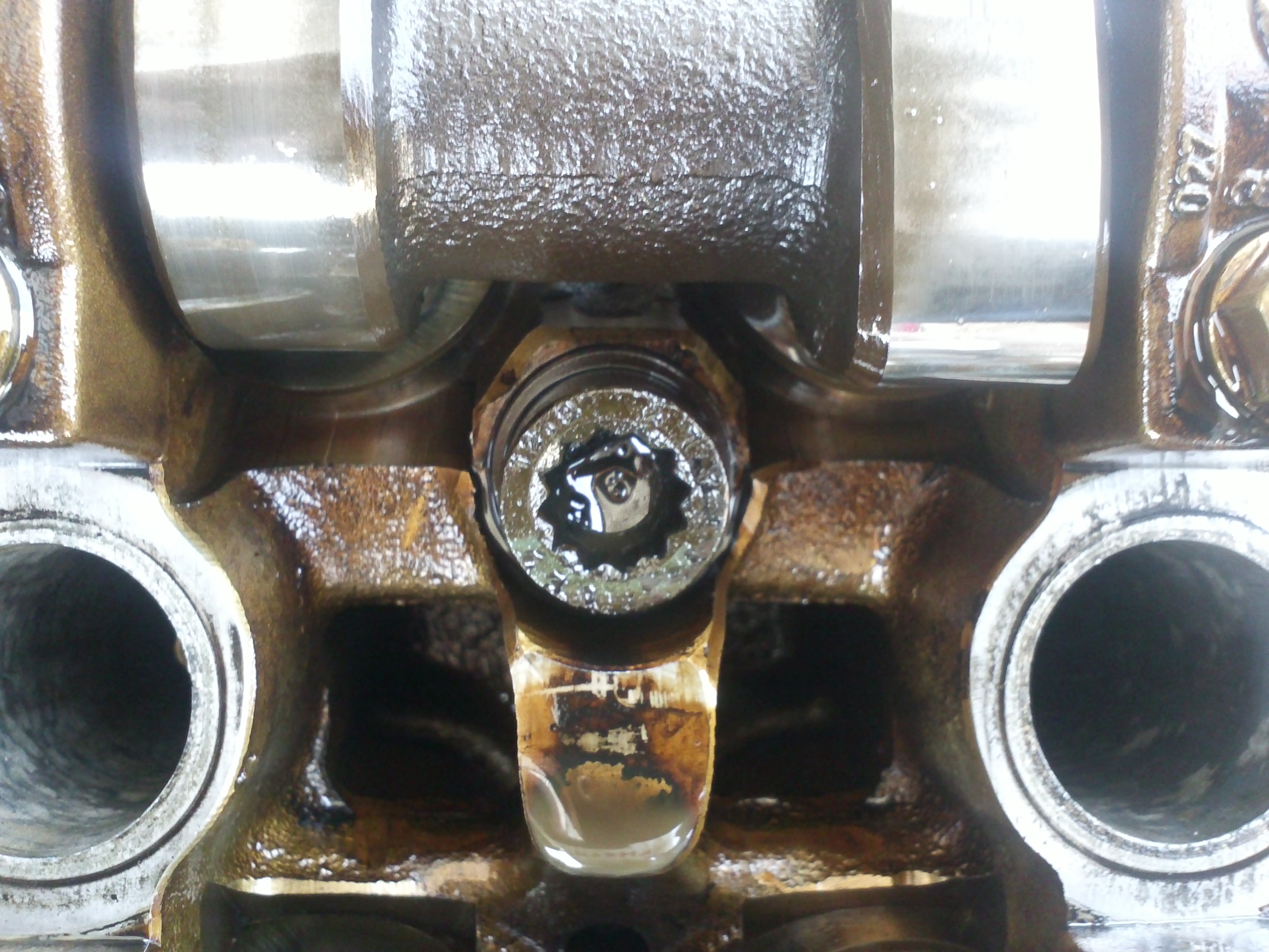

The standard head bolts are triple square not reverse torx. M12 xzn. Fat chance of getting vice grips in as the books are recessed into the head. $10 socket or hours of potentially fucking something? I know what I'd choose...
Birthday Beer!! this rolling rock has been hiding in my fridge since late 2013. Lunch... Right so 3 x 4 corners per a square seems legit. It's 12 points in the stud head. Maybe my mechanic friends have the bit

kieron_32v wrote:The standard head bolts are triple square not reverse torx. M12 xzn. Fat chance of getting vice grips in as the books are recessed into the head. $10 socket or hours of potentially fucking something? I know what I'd choose...
He said studs so I assumed exhaust studs. You really think I don't know the headbolts are a triple square design or that you couldnt get vice grips in there? I've done quite a few heads fyi. Forgive me for not reading "studs with crazy star design" as "stock headbolts"
kieron_32v
- Posts: 70
I didn't imply anything of the sort sir. Just stating the facts. Fwiw I've never seen exhaust studs like that on a 20v either.
Just go to oreilly or napa, or whatever and ask for "triple square" tool pack. It's like $5 for 4. Comes with the size you need for your CV axles too.
kieron_32v wrote:I didn't imply anything of the sort sir. Just stating the facts. Fwiw I've never seen exhaust studs like that on a 20v either.
I have before, but whether they are factory or not beats me. Going off of the words 'studs' and 'star', I only assumed exhaust studs. Lot of domestic vehicles use that style with a reverse torque, especially Fords. I tried converting my studs over to a chevy style stud that had that design but it didnt work out the way I planned.
