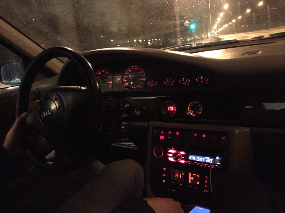

Dmitri's got the newer style (C4?) CC module in his 200! I'd be interested in finding out what's involved with that swap. Even without functional A/C, I'm about done with the GM unit.
- xPhnNAwWsaQ.jpg (110.58 KiB) Viewed 28665 times

Now we just need to learn to speak Russian so Dmitri can explain it!
I have a prefacelift b5 cc unit (new style, same as in C4?) and it doesn't fit without major modifications..
Got the unit for a cup of coffey.
The steel plate behind typ44 cc unit is too small for the b5 unit to fit. The wiring is also quite a bit different, but this could be altered I believe.
